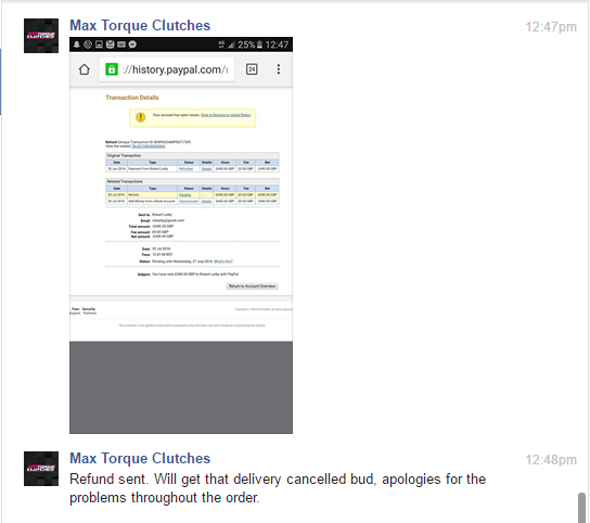

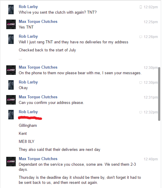

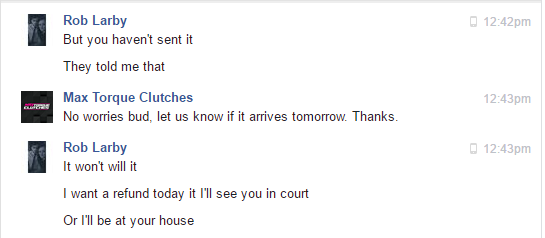

Ordered a Max Torque Clutch three weeks ago and got messed around and lied to, caught him out and now trying to get my money back! The refund is pending so I'm not sure if I'll even get it yet
