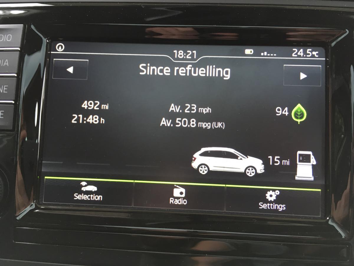

I have just had to fill my MY2017 Rapid Spaceback since filling it on collection 2 weeks ago. According to the MIB2 the adverage fuel consumption was 50.8, which I knew wasn't right having covered under 500 miles on a tank.

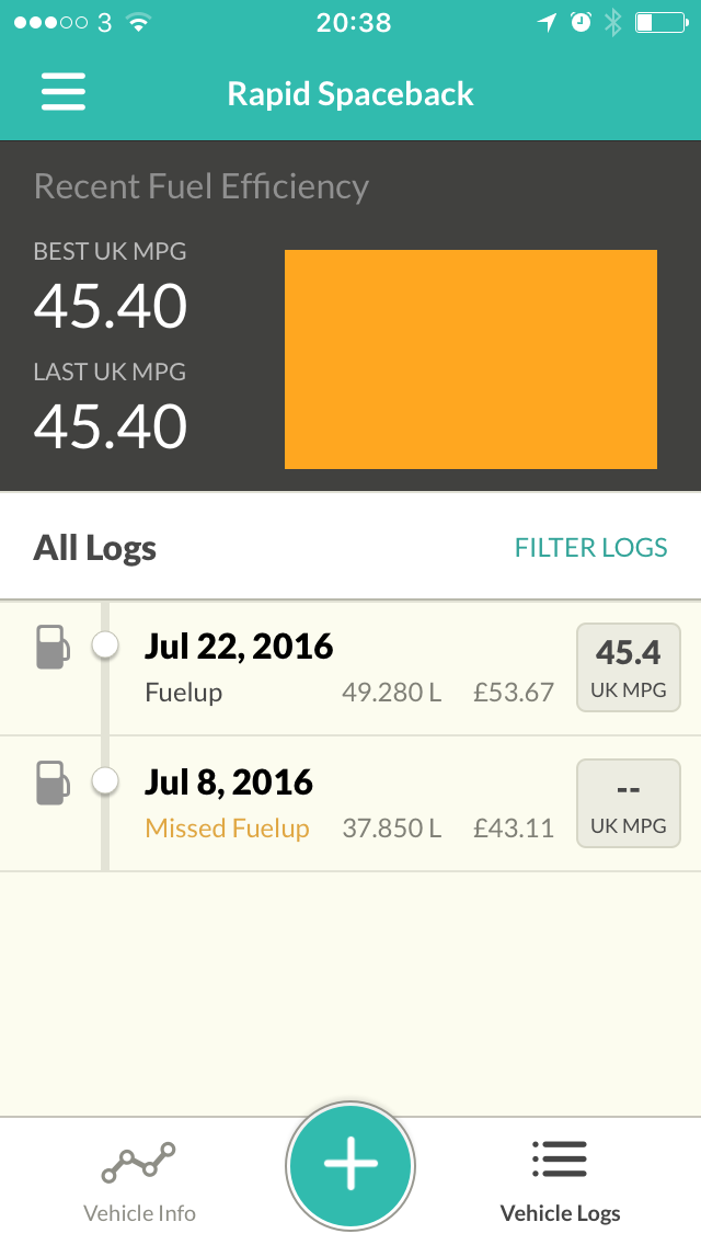

The actual consumption from this tank was 45.4, has anyone else noticed a huge difference between what the car wants to believe and the truth?

For true fuel economy figures just use Fuelly, or a pen and paper, and calculate between fill-ups. And don't forget...new engines etc are "tight" and do loosen up over some 000's of miles.
