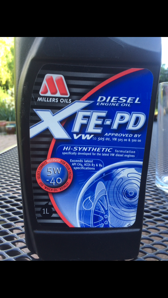

Is this oil okay for 2005 fabia vrs?
Hi
Can someone confirm this oil is okay for 2005 fabia vrs?
I've looked on a few threads and what I have read has confused me a bit.

What oil?
Look, it isn't rocket science, if it doesn't have the VW specs. on it then it isn't suitable.
Sorry my attachment didn't work in the first post
See where it says VW spec. 505.01?
That tells you it's perfect.

Thanks a lot
Topped it up
