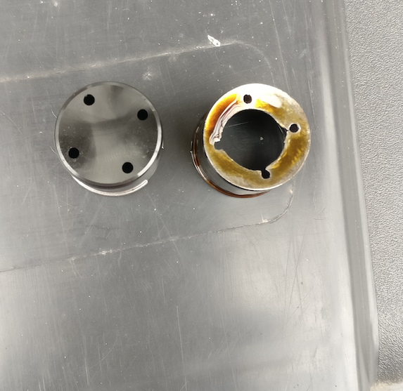

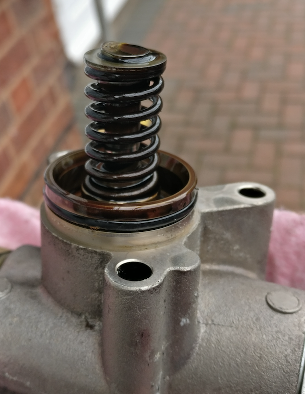

having done lots of research and searches i finally got down to inspecting my cam follower. I have had this mk2 vrs 2006 2.0TFSI for 6 months 3 owners before so unsure how it was driven prior or if its been tuned.
Much to my horror i saw that the cam follower was worn straight through and from the looks of it worn the hpfp lobe i believe? please see the pictures i have attached.
I'd like some advise on what to do next my plan  was to tune the car with r tech but i may need a new fuel pump that a side am i driving a ticking time bomb? or are there some simple repairs i can do to get it running well again.

With that sort of damage to the fuel pump and follower,I'd be very surprised if it hasn't knackered the cam as well ????
My fears exactly the only way I guess is to take the valve cover off and look? A friend of mine has suggested it however I'm sure it's not that simple?
I'd say at a minimum you'll need to replace the HPFP & follower, and the cam. Also drop the sump and hope the missing piece of follower is in there, and replace the oil pickup whilst it's off.

That's shocking. I replaced mine as soon as i bought it. Only slight wear on the follower fortunately that was with 51k. What mileage has your car done?
I bought the car on 80,000 I've done 6 6000 since so at the moment 86,000
It seems hit and miss the wear rate. Some have over 100k and just a little blackening. I can only presume your car has been driven fairly hard.

I really wouldn't use the car, as if the cam lobe has been damaged it can chew up a new follower in just a few miles. Your HPFP piston looks damaged which will also eat the follower.
Plus the top of the old follower is still floating around inside somewhere!
