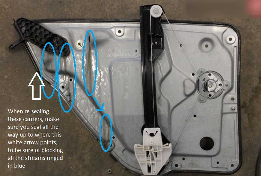

As you know, the real issue is the black plastic bracket in the rear corner which directs rain drips onto the carrier, giving the original foam-rubber seal little chance long-term, as it wasn't specced with this stream in mind. Arrows show the watermarks which every carrier which still has that bracket will have.
Hey, sorry for hijacking this thread but I wanted to say thanks for the helpful picture.
I'm about to seal my carrier aswell, while I'm at it, do you recommend to remove or do something about that plastic bracket? Or is it needed?

Your carrier will be riveted on, rather than bolted. This makes complete removal/refitting more difficult. The rivets are not a 'DIY shop' standard size, and their 'pulling pins' are larger than many rivet guns can handle.
If you do take off the carrier plate, it would be better to remove that bracket. Its only function - as far as I can see - is to allow the robot in the factory to fit the door lock in the same operation as fitting the carrier.
However, if you don't remove the carrier, you can still succeed in sealing it if you clean the surfaces well, and make sure that the sealant goes far enough up that rear edge.

Thanks for the explanation! How far up exactly should I apply the sealant? What read edge do you mean? (Sorry for the inconvenience, I'm not a native speaker)
  • Sponsor
No problem.  I can't find that picture I used before, so I've edited another one to show where I would suggest sealing to. Rear edge = edge of carrier nearest to back of car.

Great, thanks for the quick reply! That picture made things clear, I'll get to work on my carriers as soon as the weather gets better.
