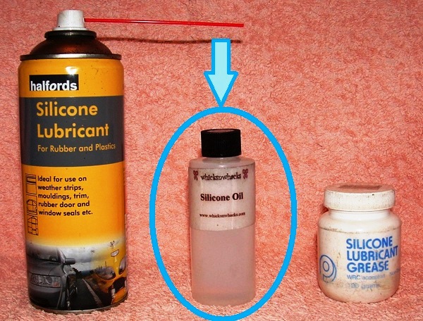

The GT85 is PTFE and fine on plastics and rubber seals but I tend to use silicone on rubber seals including AutoGlym Bumper & Trim Gel or silicone oil as in photo below.
Some feel silicone should be kept away from paintwork.

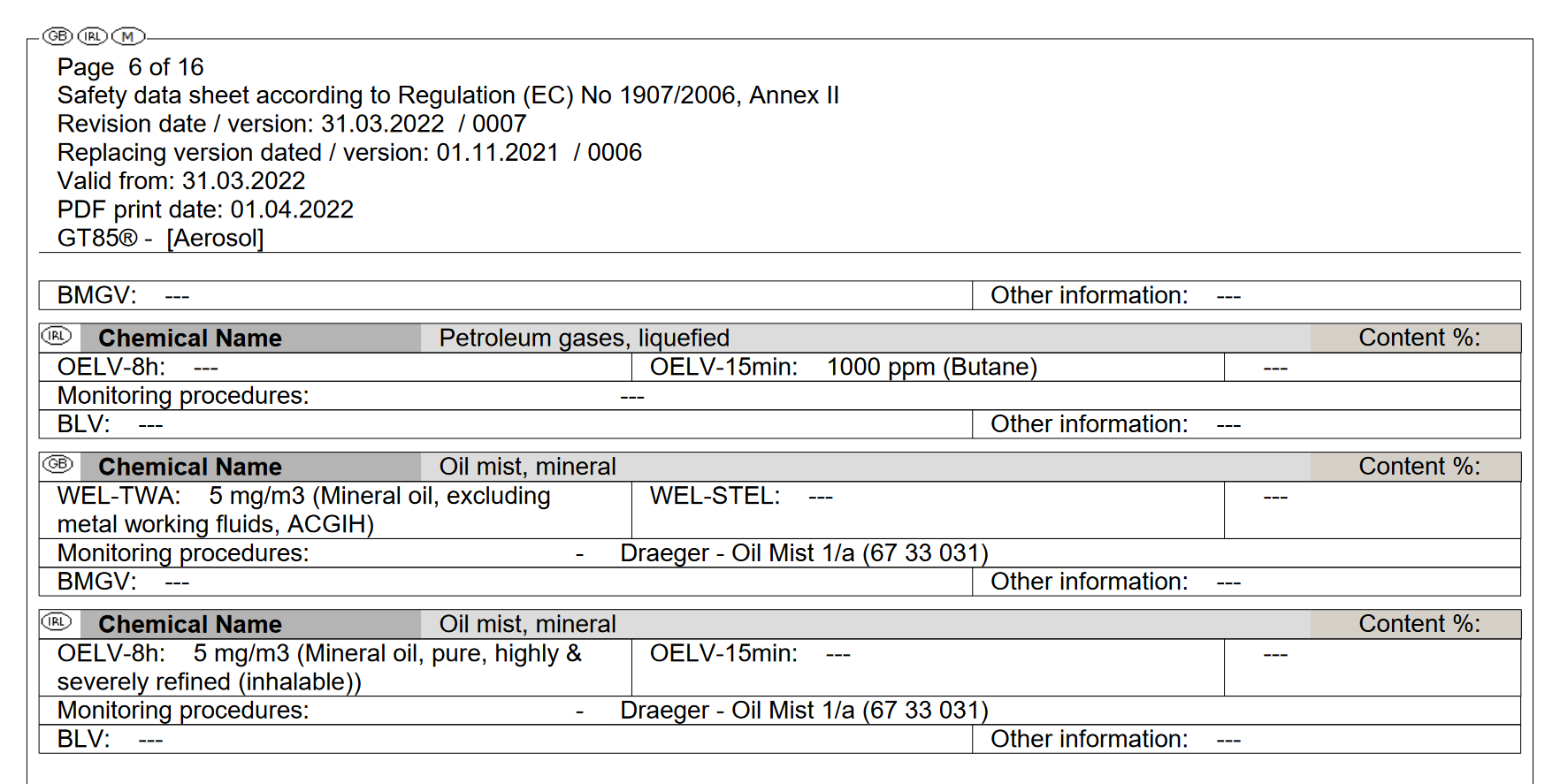

It certainly contains PTFE, but I think it's mineral oil based, judging from the safety sheet.
(That said, I can't say I'm an expert at reading safety sheets.)
https://media.gt85.co.uk/app/uploads/2022/06/01155628/F00270_EN.pdf
I understand silicone oil is more difficult to shift than mineral oil when it comes to paintwork, though.
