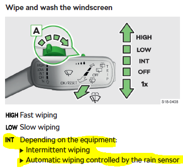

StEdmund, ask and you shall receive, excerpt from the owners manual. Thankfully I'm not blessed with some weird one off vehicle characteristic.
karoq windscreen washer.doc
Tried to print screen and attach to word doc. Might not have worked. It's in the manual, different manuals for the same car have it on different pages, it's under lighting and windscreen wipers in the index.
Edited by Canders
The position of the headlight switch has no effect on the operation of the wiper stalk.
The first position up from 'off' is either 'intermittent' or 'Auto', depending on the specification of the car.
If it has automatic rain sensing wipers then the wipers operate according to the mount of rain on the screen. The rocker switch on the top of the stalk alters the sensitivity of the sensor.
If the car does not have rain sensing wipers then the wipers operate intermittently at preset intervals. The rocker switch increases or decreases the time in between the intermittent wipes.
Final update, I had a short circuit in the mirror wiring, a wire was trapped, which prevented full adhesion of the sticky stuff. Since it's been sorted, as silver pointed out, I now have only the auto capability as noted above. I do now have another issue now though, the rear door open warning as posted on her. Oh well, onwards and upwards.
