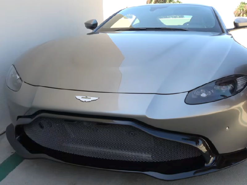

2019 Aston Martin Vantage front grille.
NO WAY !
