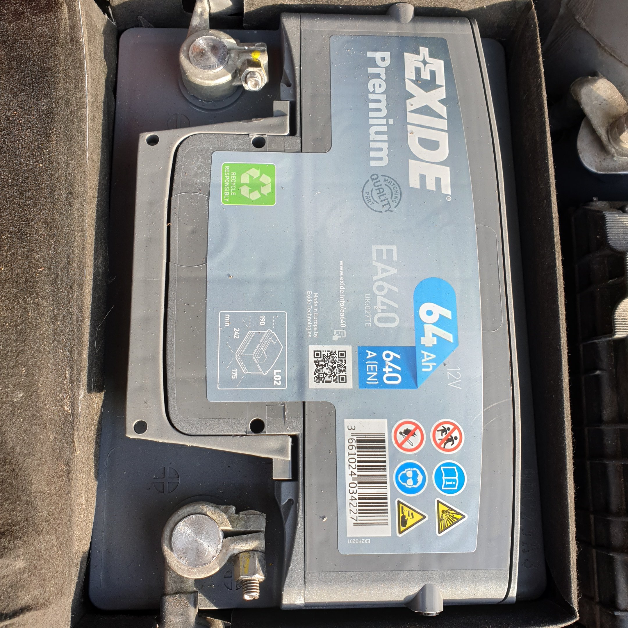

Don't rely on web sites to find out what the correct battery is.  Batteries can vary depending on model year, spec, and the month the car was built.  I have a 2013 Yeti 4x4 2.0 TDi.  All the web sites told me the wrong battery (type 96) based on my registration, and eBay told me the correct one would not fit!  The only sure way is to make a note of the product code on your existing battery, then look it up on Google.  Mine needed a UK type 027. Also, measure your existing battery and make sure your new one is the same size (give or take a few mm).  I bought an Exide Premium with 5 year warranty from a large eBay retailer for £51 delivered. Eurocarparts wanted £130 for the same one, even with their current offer it was still over £80 with them, but at least they knew the correct battery.
Very easy to fit:
  1. Remove the -ve terminal clamp first with a 10mm socket or spanner. You might need to prize apart the clamp with a screwdriver.
  2. Remove the +ve terminal clamp.
  3. Undo the retaining clamp at the bottom of the battery (and don't drop the bracket or clamp in the engine bay).
  4. Remove old battery.
  5. Clean out the crud from the bottom of the tray.
  6. Clean inside the terminal clamps with rolled up emery paper.
  7. Refit +ve terminal clamp. Don't over-tighten.
  8. Refit -ve terminal clamp.
  9. A few warning lights will remain on for a minite or two when you first switch on - that's normal.
