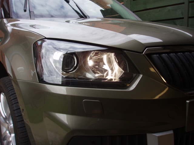

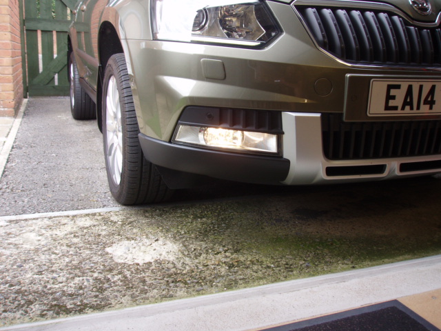

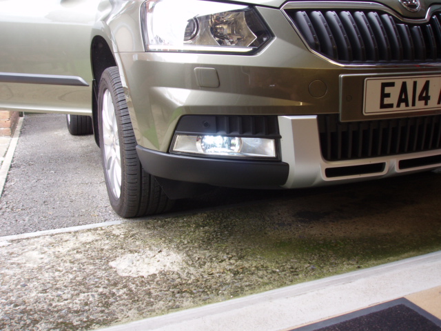

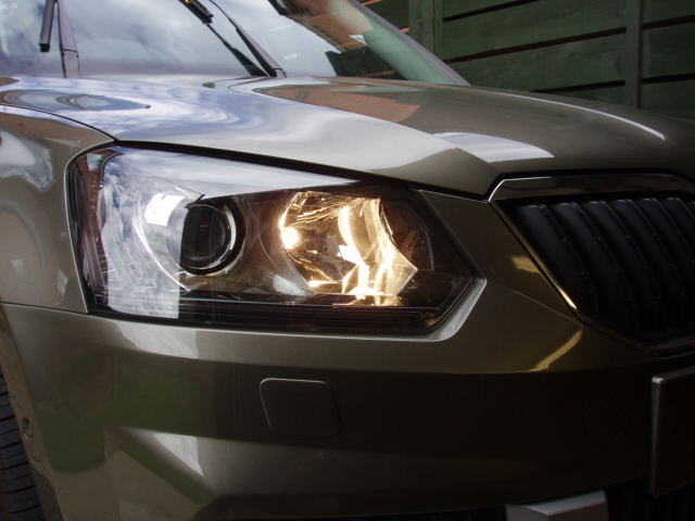

I know you've probably seen it all before , but I've changed the not so nice looking 'yellow' bulbs for some nice bright white ones .

What bulbs have you fitted, especially the fog lights?
Do the LED fog bulbs bring up a bulb fail warning and are they OK with the fade in and out on cornering function?

No bulb warning , and I'm going to test the cornering tonight when it's dark .
I must admit I hadn't considered the cornering function when I fitted these LEDs, and after initially not getting a bulb warning I tried the lights last night and as I went round a corner the warning light appeared, and the corner light didn't come on . The fog lights actually work OK, but because they bring up the bulb warning and the cornering doesn't work, they're no good, so the original ones are back in this morning.
So I guess you can't use LEDs in the fog lights.
