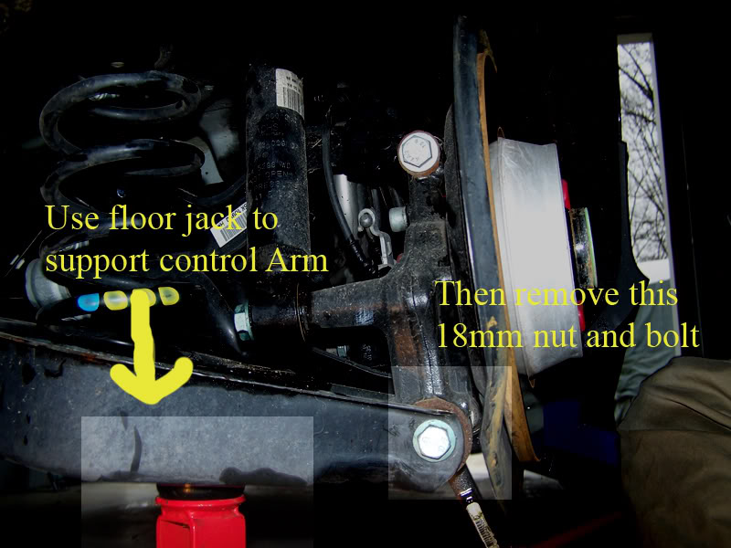

Has anybody had problems undoing the 21mm bolt at bottom of the shock absorber?
I have manage to undo N/S and replace the bump stop but it took lot of work to undo bolt.
Still having problem undo O/S bolt any ideas?
I did the job on my car today. Soak the bolt in wd40 and allow to soak for 15mts. I had jacked up the car on the sill with a trolly jack. Put an axel stand underneath just as an extra precaution then used a scissor jack under the bottom of the shocker just to jack it up a little and prevent any bouncing.
I then used a 21mm combination spanner (round end) on the bolt and gave it a couple of good whacks with a lump hammer. It worked perfect with no problems at all. Top bolts were a doddle and I didn't remove the wheel arch lining.
an alternative method would be undo the 18mm bolt on the spring tray and with a trolley jack below slowly drop the spring, as this will give you better access to the 21mm shock bolt to enable the use of socket and longer breaker bar.
Yes as Mike says jacking up the suspension arm will compress the spring and allow you to get a socket and extension bar through the spring.
Getting into a position to use a breaker bar on it is difficult if you only have the car jacked up, as you will have limited access. If up in the air on a ramp its a different matter.
Using a socket and extension bar on the bolt could be handy if you have the use of a good impact wrench.

I changed the bump stop without taking the shock completely off the car. I just undid the top mount and used a bungee cord to keep the shock compressed whilst I undid the top mount from the shock.
I began this at the weekend but had to put it off. I was counting on using a 21mm socket, but I couldn't find a way to fit an extension bar through the spring, however much I raised it. The lower arm got in the way of my spring compressors, and I didn't want to disturb the 18mm hub to arm nut & bolt without new ones on hand as they look fairly cruddy.
Are you all just removing the 21mm shock bolt with a spanner + lump hammer - and torquing it back up as FT as you can? It's meant to be 130NM+90degrees IIRC, that sounds like a lot for a combination spanner!
I could get some new 18mm bolts and drop the arm to remove the spring - though I'm not sure how much movement the inboard bushes will tolerate, they've done 80K miles but I have no desire to make this into a bigger job!
130NM+90 degrees or 2.5 good whacks with a big hammer :D
