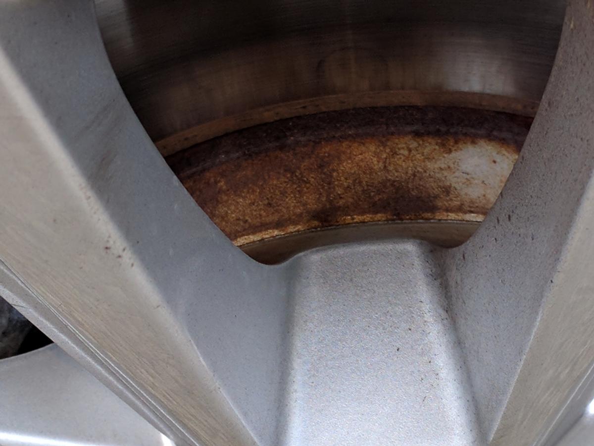

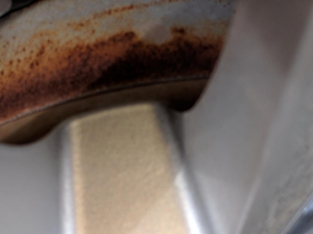

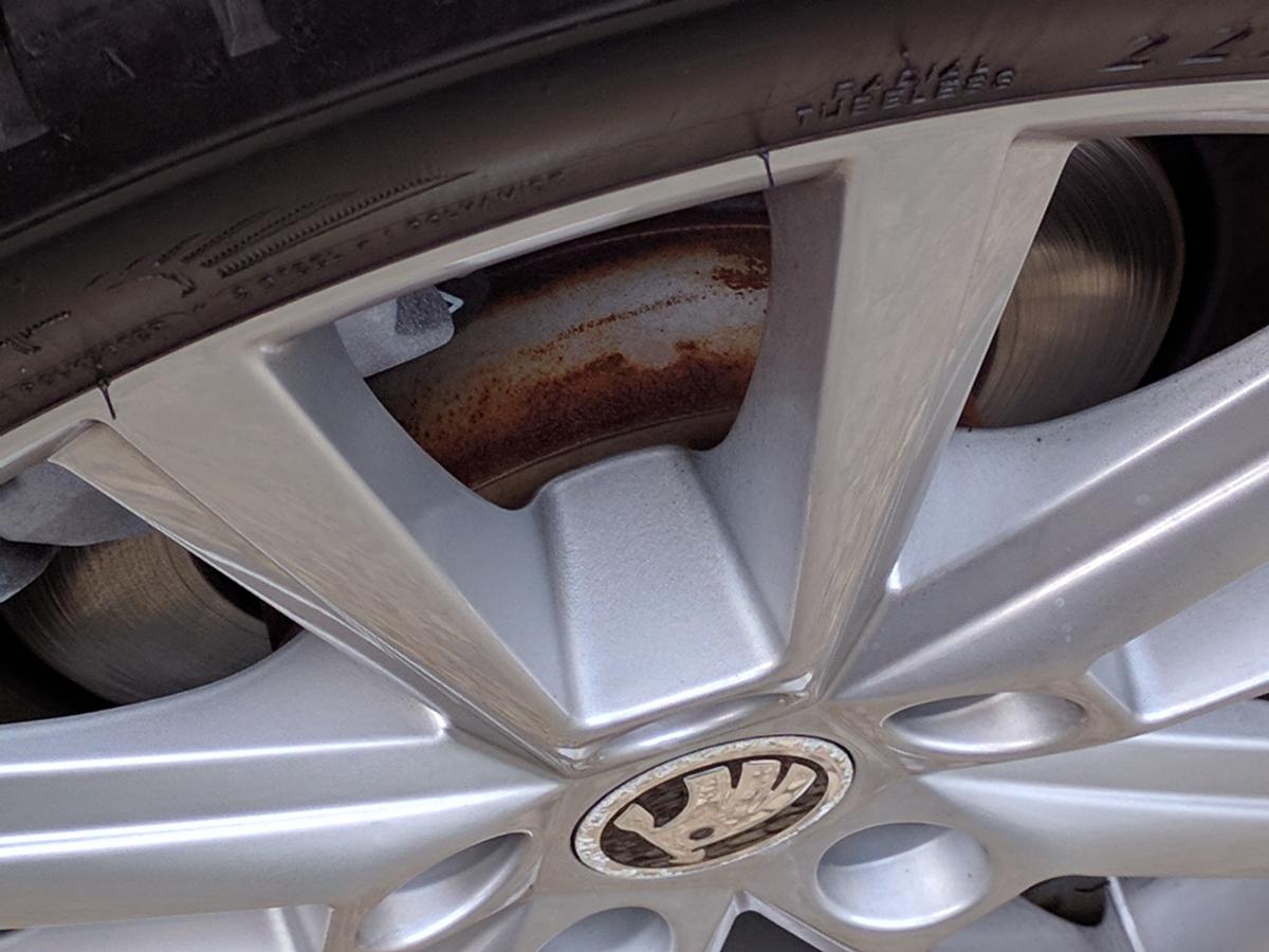

However, there are rusty looking areas on all of the wheels (couple of examples below).
The dealer (renault dealer, not skoda) said they were nothing to worry about and that's just how wheels go but I know nothing about cars so i wanted to see what you all thought.
Does this look fairly normal for a 3 year old car? Can it be cleaned off at all?

I wouldnt worry about the "wheels" rusting. It's actually the hub of the brake disc not the wheel thats rusting, and it's very common. If cleaned off it would be back within a few months.

The 'rust' can soon be sorted with silver Hammerite and as above, check your pressures and then press the reset button.

The actual rust is, as said above, just on part of the brake disk and is nothing to worry about. Some people have cleaned it off and applied brake caliper paint (or it's equivalent) to make it look better. The discoloration on the wheel itself is mainly just road dirt and brake dust, and can be cleaned off relatively easily with a good quality wheel cleaner.

Tunap and Wurth both sell a Zinc based spray paint that treats and prevents rust on metallic components. It's high temp tolerable too so it's suitable for brake applications.
My hubs started going after 6 months, I whipped the wheels off, painted the hubs with silver Hammerite Smooth and all has been good ever since.
