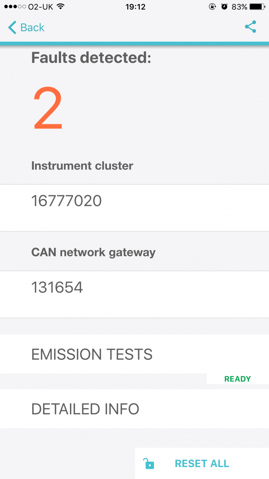

Carista?
Anyone know what these faults mean?

I'd think that the "detailed information" tab would tell you, though try Googling them.

It showed 3 Fault codes too - must go and see what they are -- 12307, 204290 and 233224 - all in "Central Electronics" Those 6 digit ones look odd.
