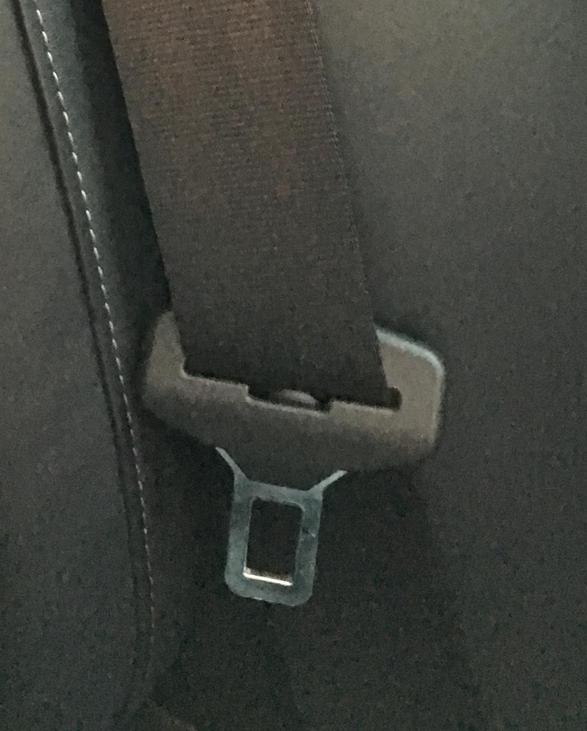

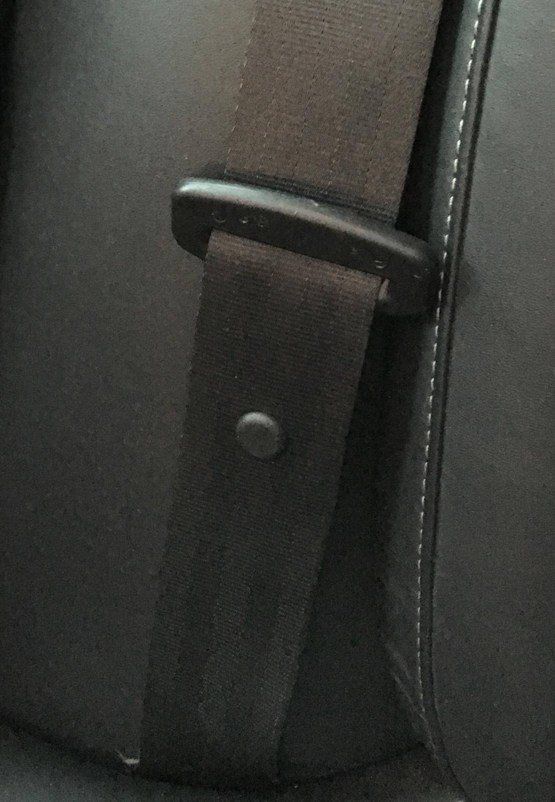

I found a mismatch on my back seat. While i try to put the child seat, i realized the belt is twisted too much.
Then i found that the plugging on both side is different. Is that normal? I can not belive it could rotate somehow, there is no space for the belt.
Any idea? How can rotate back?
Looks like the belt got twisted around inside the buckle - happened on one of mine too. Bit of a faff to fix.
My car was the same - just on the front passenger seat rather than a rear.
I managed to fold it back on itself and get it the right way around. There was a crimp in it for a day but the material went back into shape.
How it got that way or managed to twist, I have no idea. At first I thought it must have twisted on the belt roller/tensioner - but that was perfectly smooth. PlusI had pulled the belt out all the way and there was no sign of a twist.
Does this help?
Great thanks! I'll give a try
Now it is fixed, very easy in this way! Thanks again
