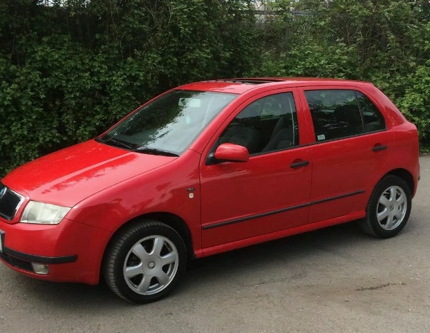

To cut a very long story short, I bought this car for a very cheap price on eBay back at the start of July when a 'make a best offer' that I put in was accepted by the seller. The first time that I've ever bought a car completely blind like that and knowing what I now know about the car I can see why it was so cheap! Here's one of the pictures from the advert:
I travelled over 150 miles to collect it, paid and then drove it home. It's a 1.9 TDi, ATD engine code and Elegance spec with a sunroof. It actually drove really nicely and didn't miss a beat on the journey. The heater did get stuck in the hot position though which I now know is pretty common!
