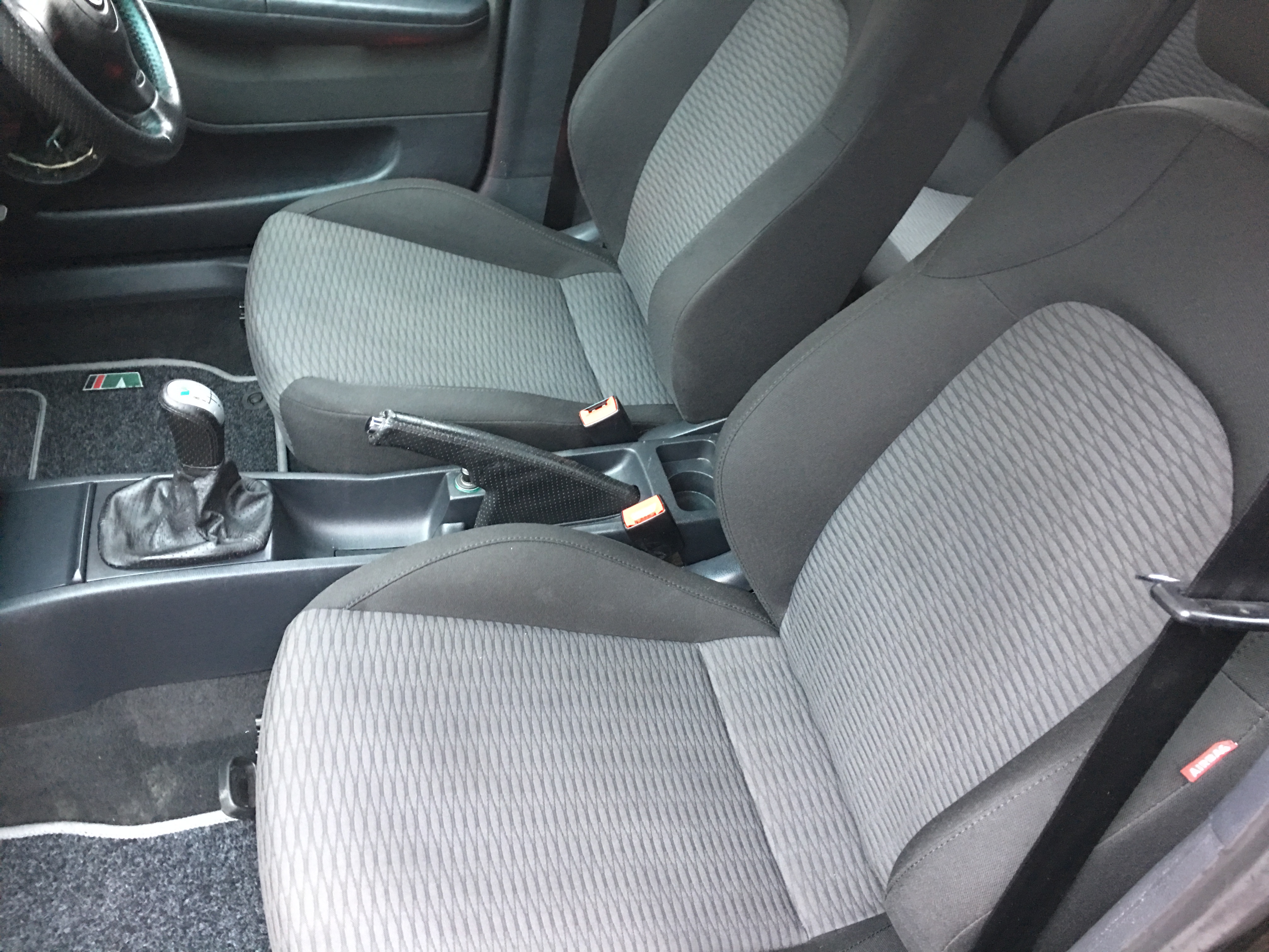

On 07/02/2017 at 22:03, Lofty said:

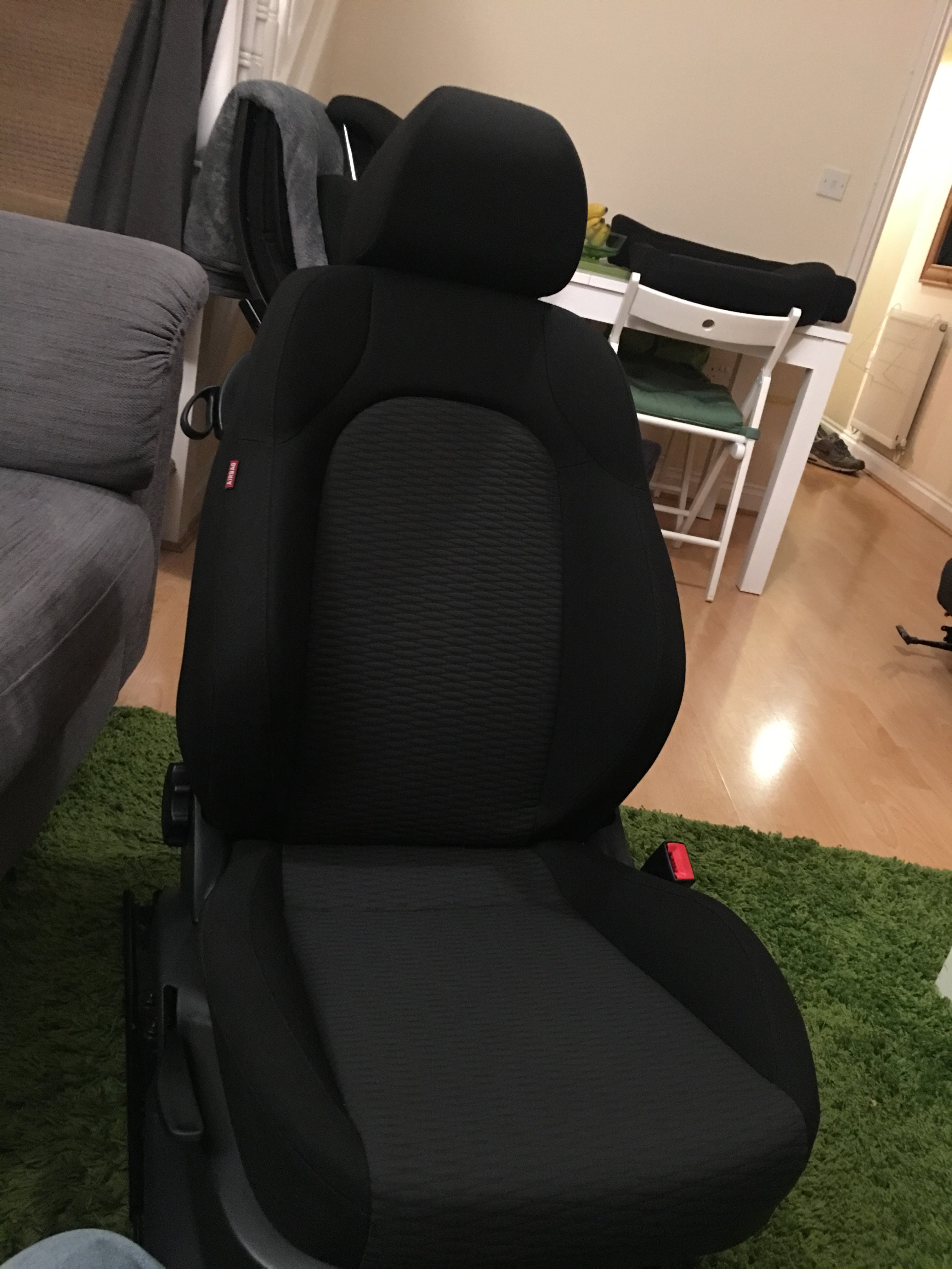

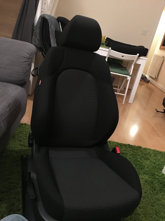

Seat Ibiza Sport seats are now here. A quick wipe over with a damp microfibre cloth and they're good to be fitted at the weekend.
Side airbags as well so hopefully they will have the same plug as the factory optioned side airbag seats that are currently in there.
Last question honest lol, does it matter if the interior is from 3 door or 5 door model, noticed yours has the side clip for 3 door, and thats the same s the interior ive seen, thanks
A 3 door seat in a 5 door car is fine.
A 5 door seat in a 3 door car is a problem as you cant tilt it forward to get in the back.

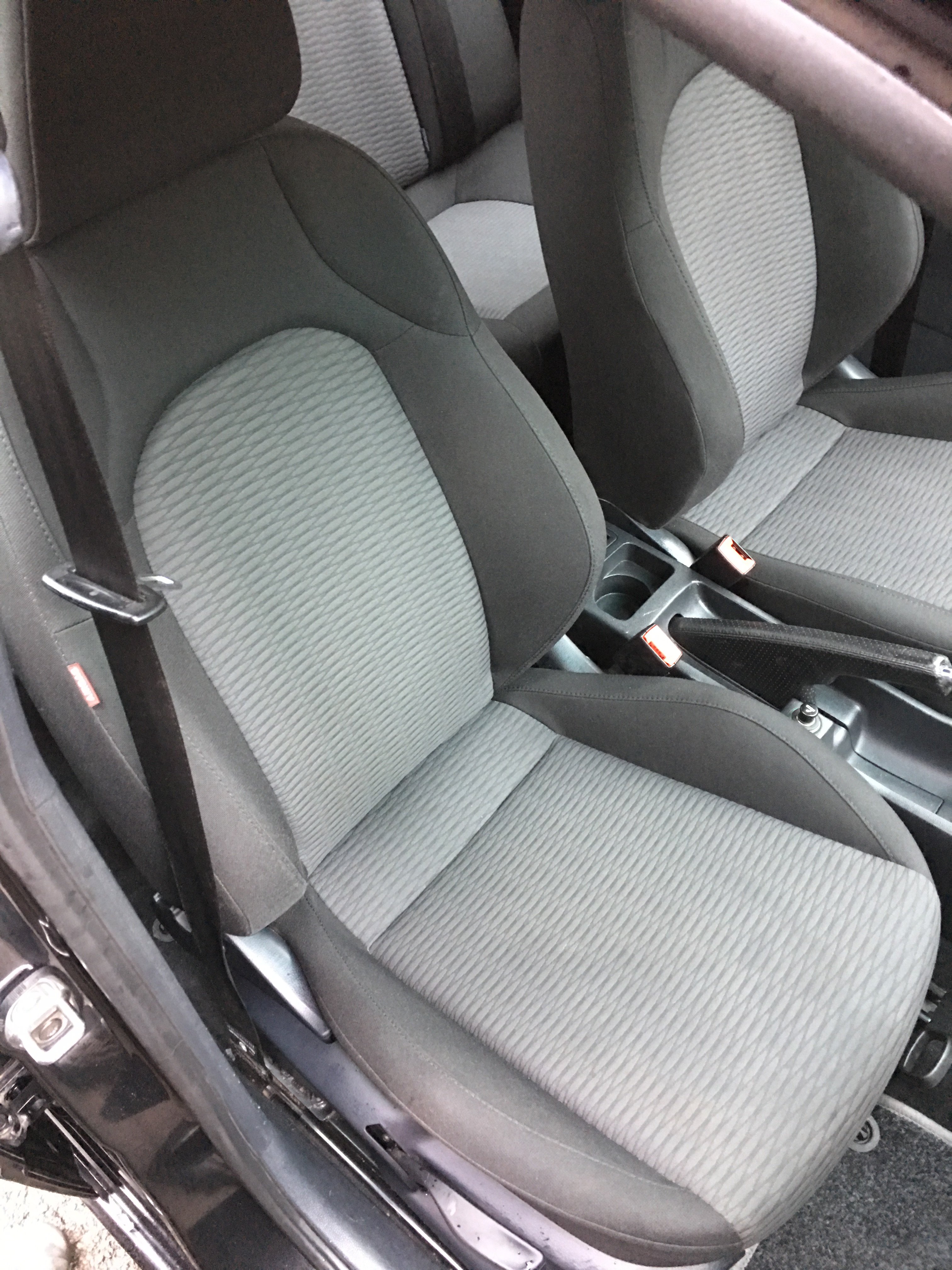

Seats quickly fitted this morning before the snow showers start again. The airbag plugs are exactly the same on these as the fabia which I understand is a rarity but fit they do and no lights on the dash!

Those seats look way way way better than the stock cream ones. (cream seats in a black interior stick out like a sore thumb). I'm going to keep my eye out for a set from a 5 door A1 sport and have fun fitting the rear seat :) I'd loose the heated option tho :( I guess you could retro fit heating pads but I'm not going through all of that.
- I need to figure out how they made those speaker covers for the 6.5" woofers. I had to space my woofers out so mis the windows, I put sound deadening in which does help, keeps sound sound in the cabin and the outside sound out also reduces the metal panel vibration. The speakers I went for are the Focal PS 165 FX which sound amazing, pricey but I figured I could keep them and move them from car to car or sell them. (I wasn't happy with the sound until read about audio/sound processing for time alignment and slight eq'ing. So rather than going out and buy an Audison Bit Ten from Ebay for around £150 I bought a £15 JBL MS-2 which quickly sets the time alignment out and puts in some basic EQ. It does sound a little artificial but I would recommend them.
Anyway the seats look very nice, good job!

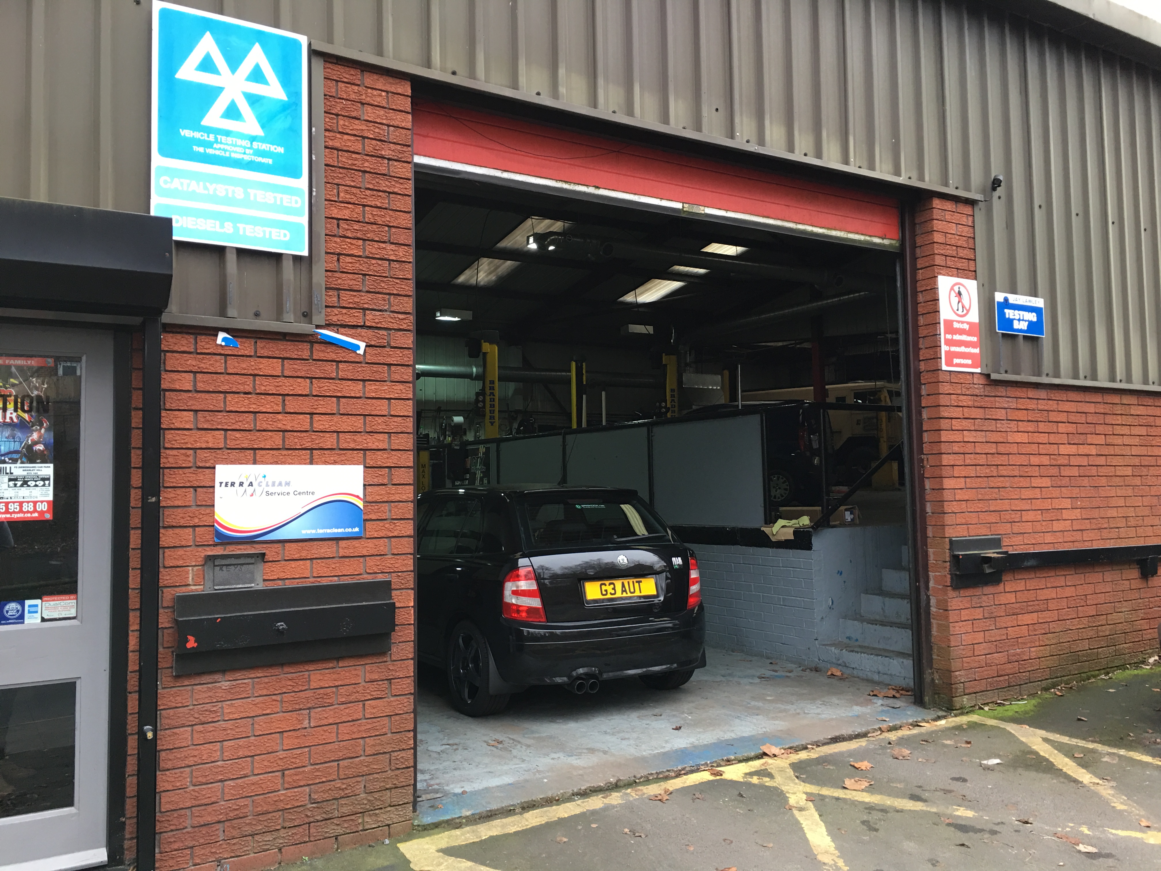

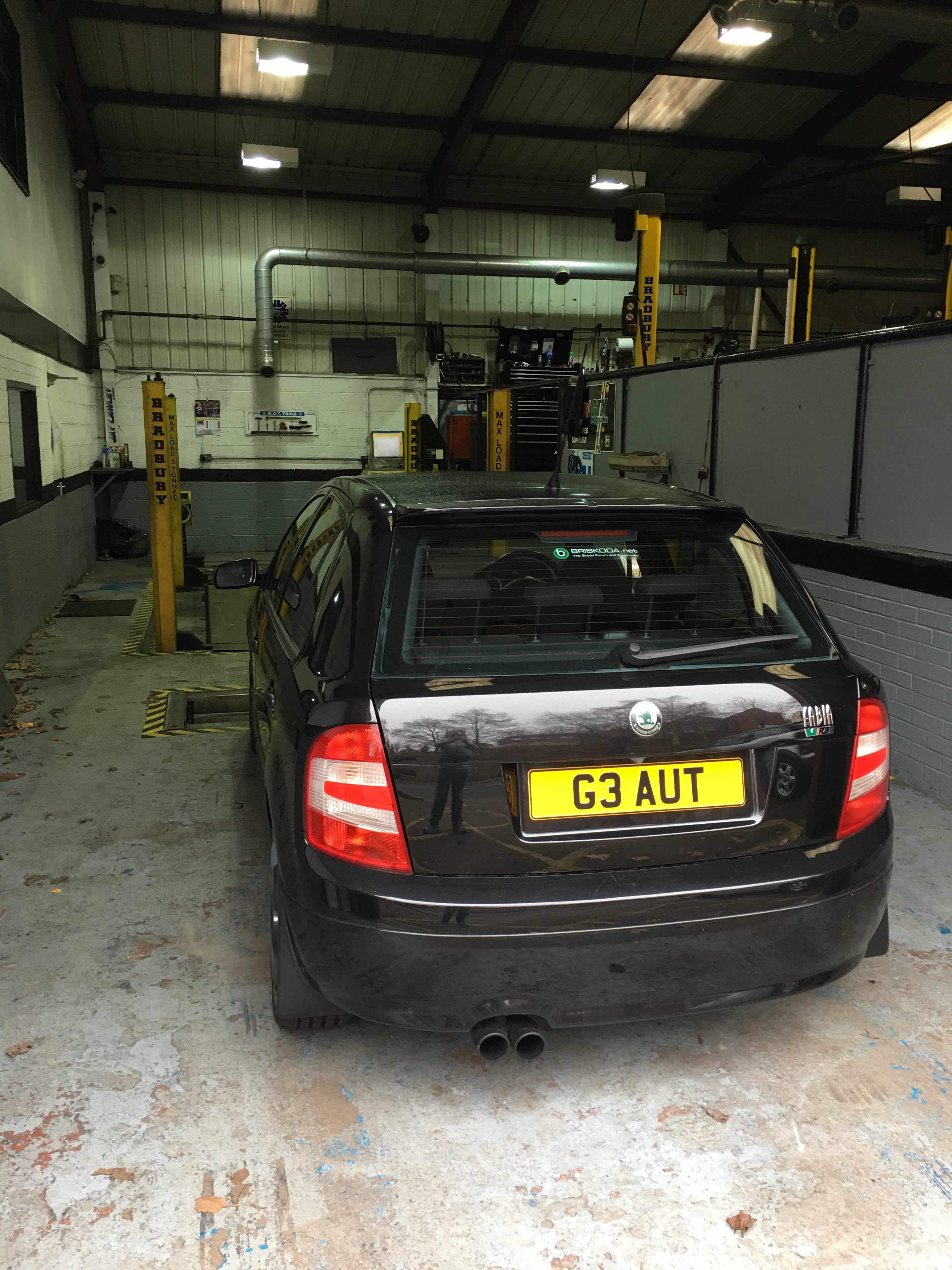

Front bumper going on tonight and fresh MOT at 8.30 in the morning.... wish me luck:emoticon-0101-sadsmile:
well despite the car the car looking like a complete shed, it passed the MOT with flying colours. A note to change the handbrake cables in the summer was made as they are looking worse for wear. Smoke test was fine and despite the brakes being rusty from standing it was all ok. Going to put some miles on it this weekend and next week to shake it down and see what else falls off...

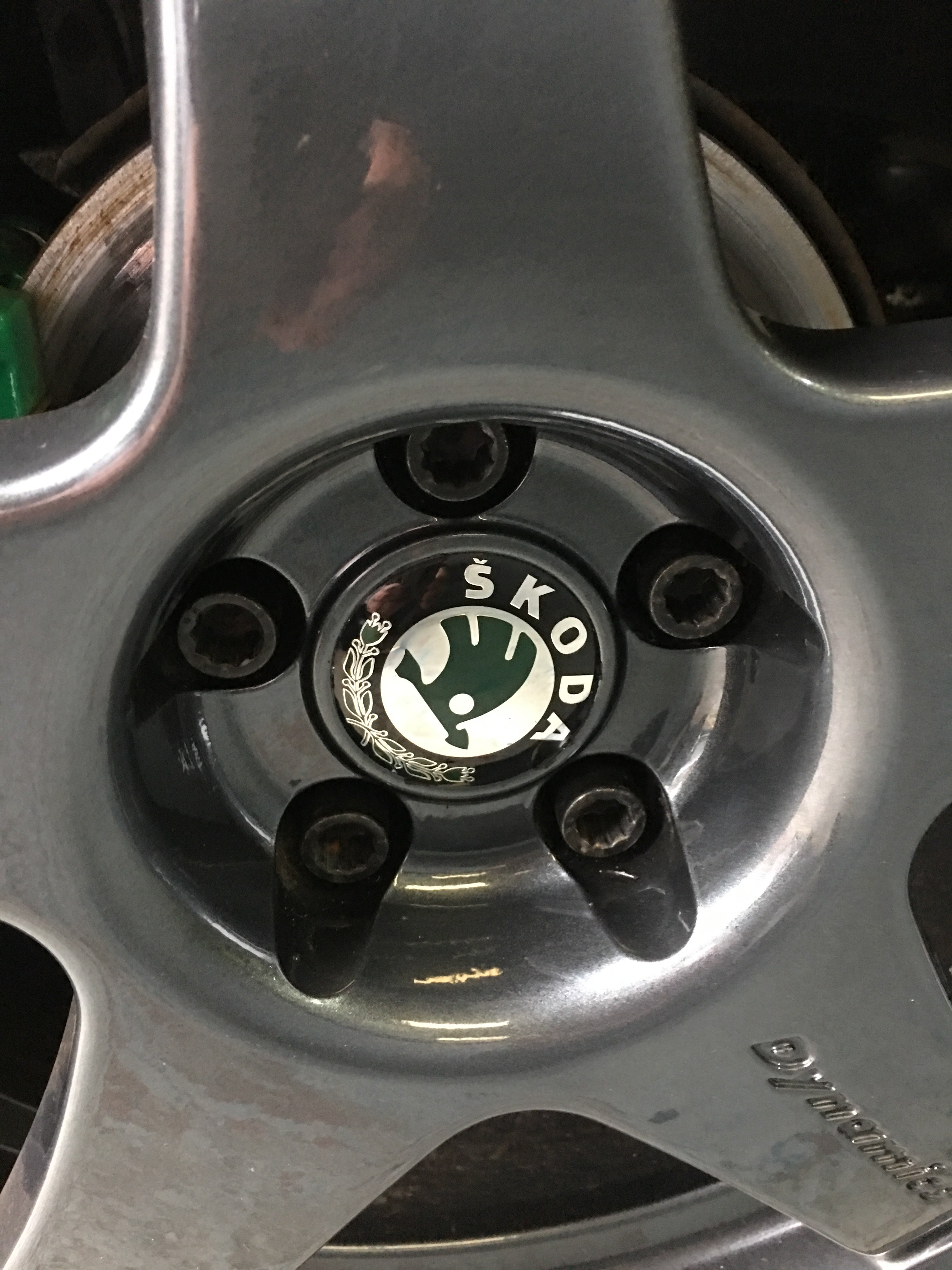

The new wheel centre caps arrived from china so they were popped in, look better than the team dynamics ones imo..

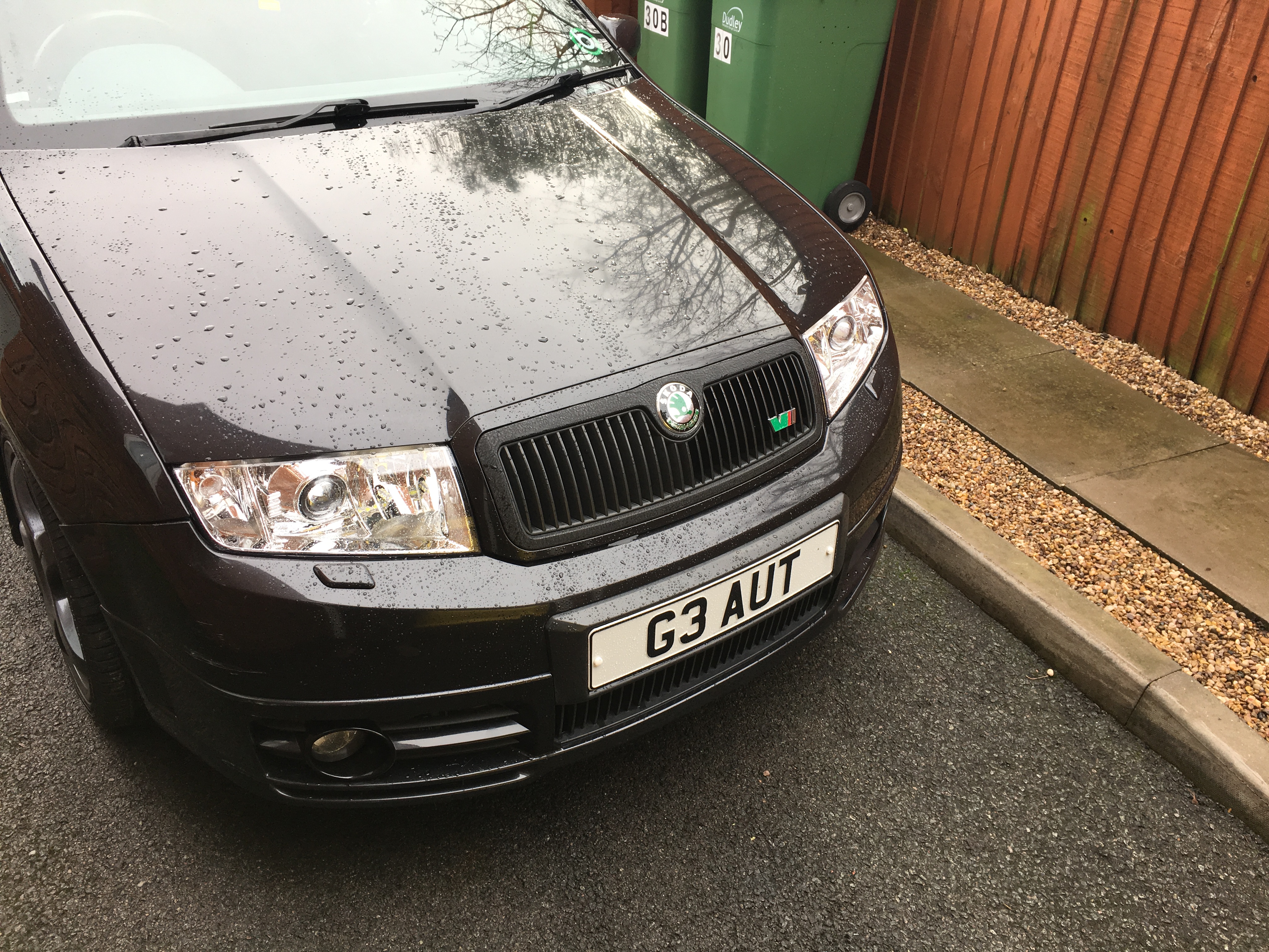

Done nearly 300 miles in the black one and it's proving to be economical and quiet, so with the weather being too gash today to get any detailing done I painted the grille instead.

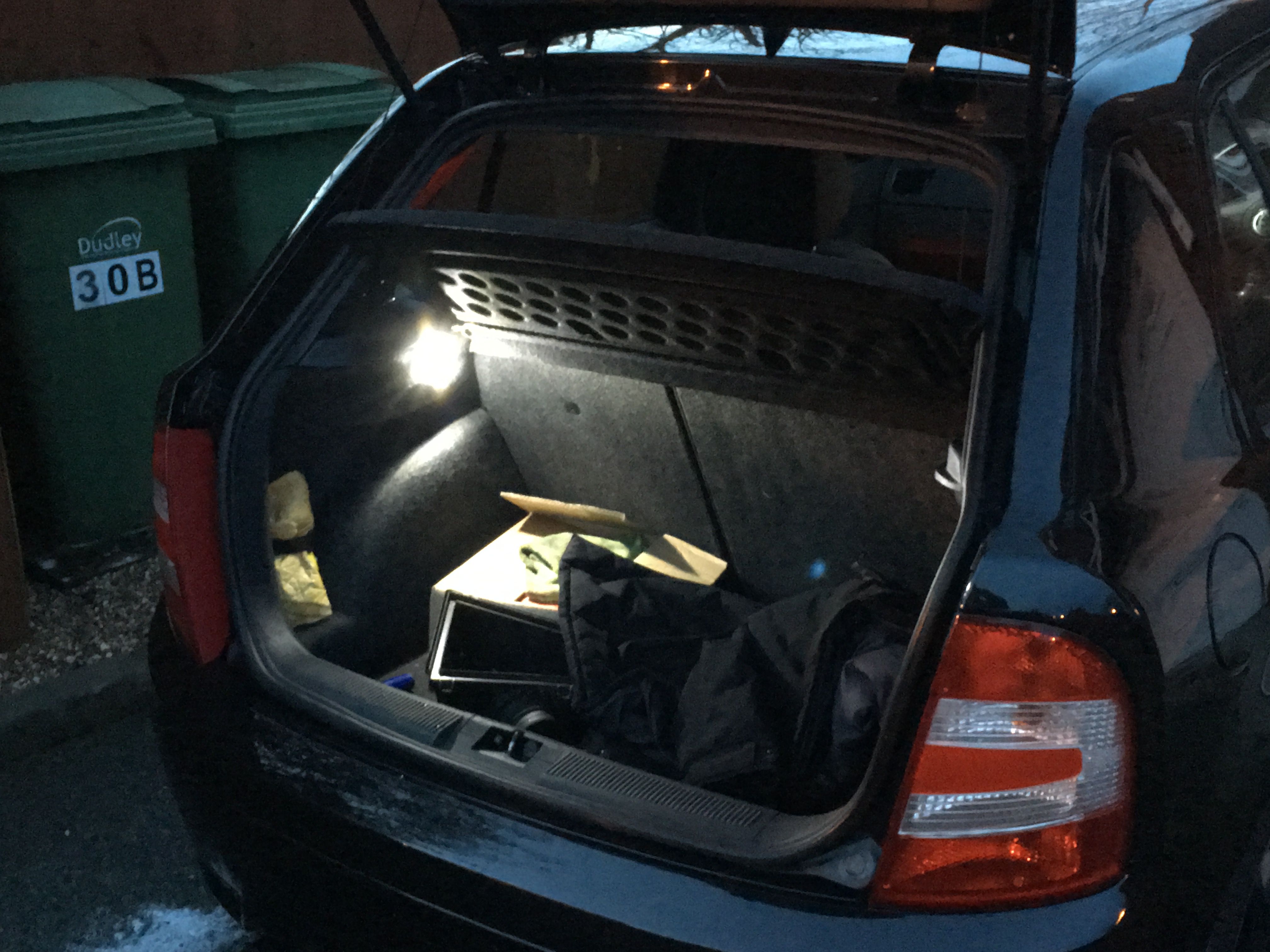

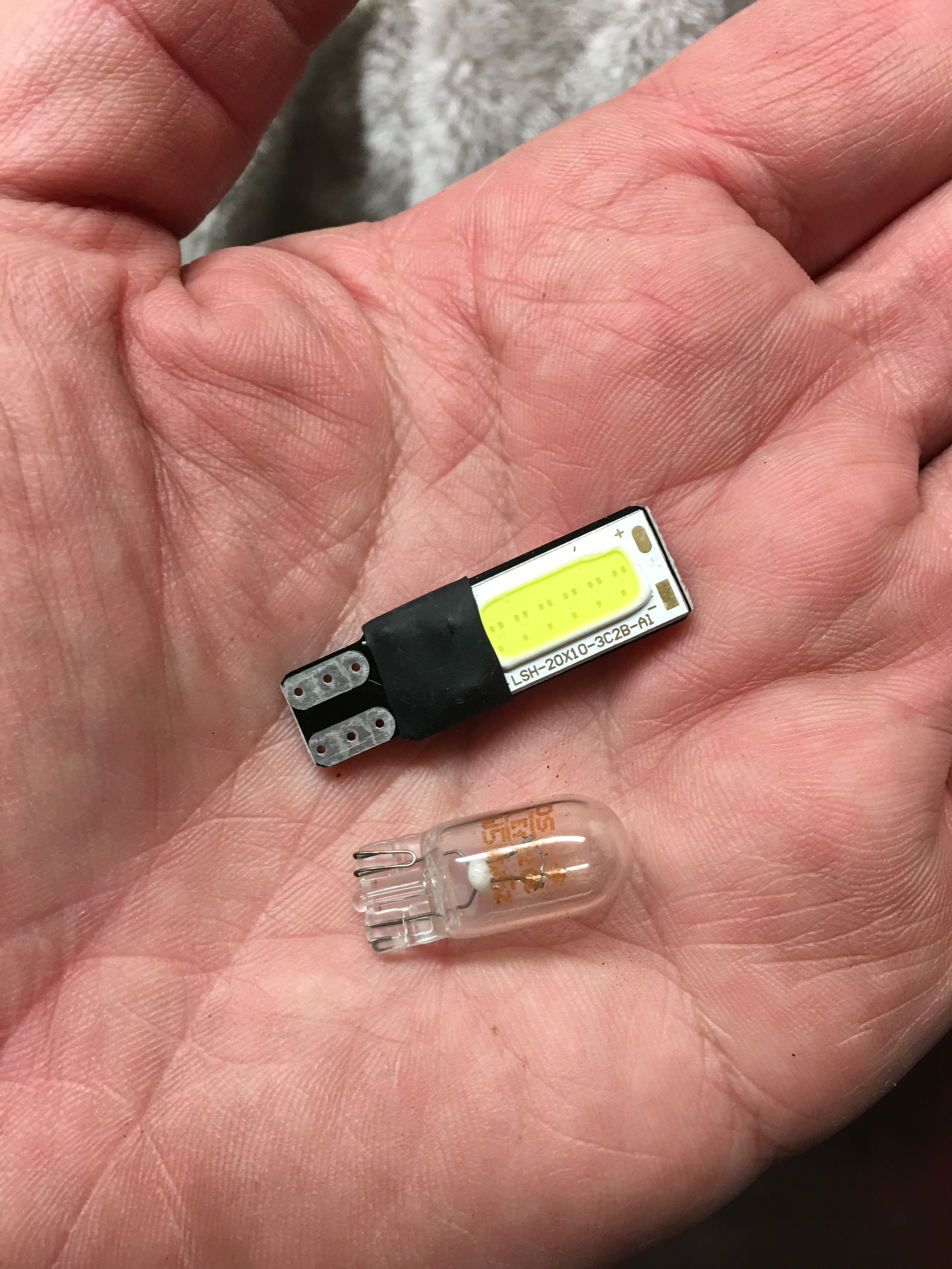

I also changed the gloomy 501 bulb in the boot for a much brighter SMD LED.

Please could you post a link to the LED's you bought for your boot light? I haven't had much luck with COB LED's in the past, the ones I have tried just get really hot, start flickering, then die! lol.

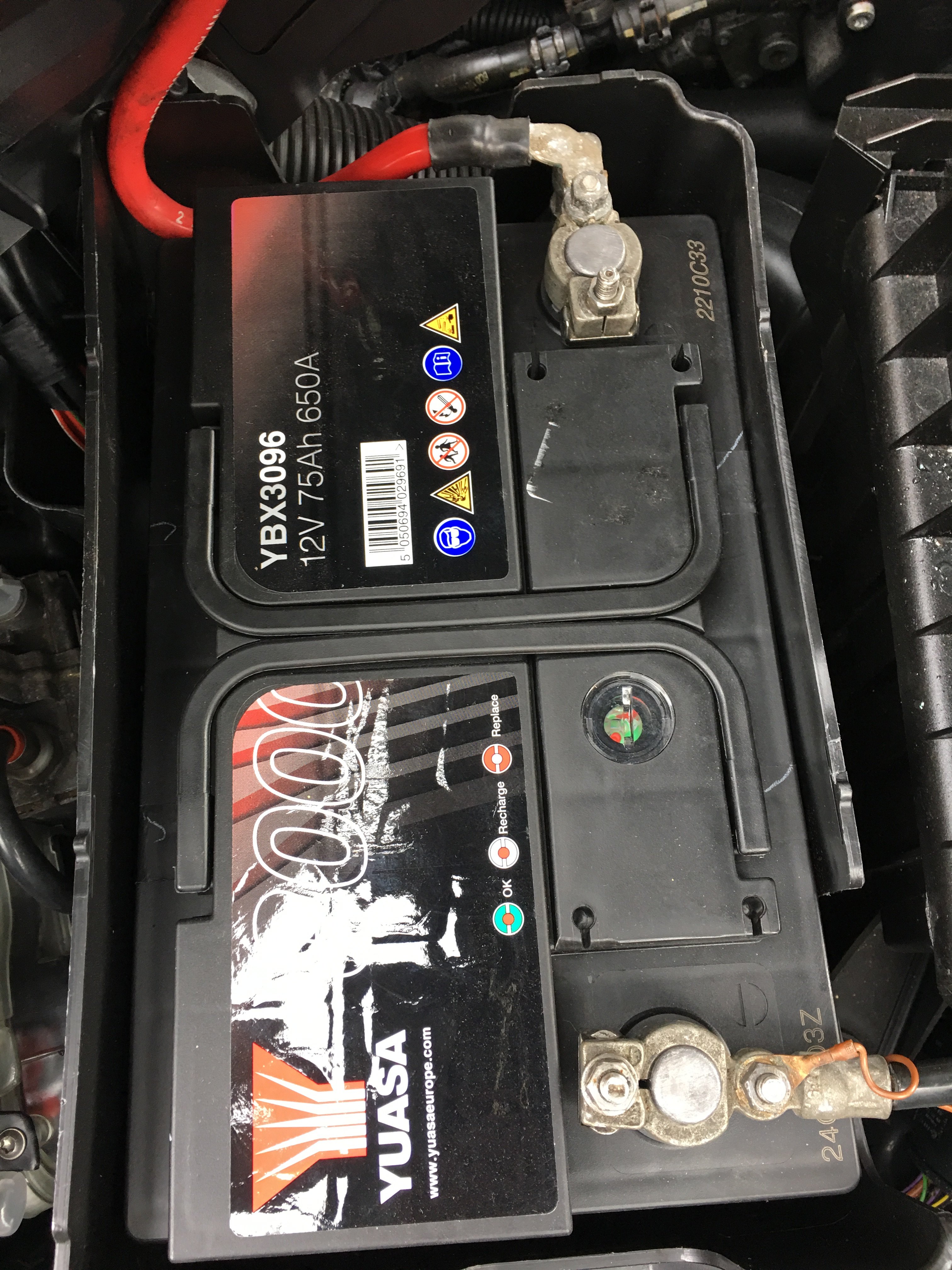

Suspected the battery that came with the car was getting a bit passed its best so sourced a new one with a 4yr warranty on from TPS.
and the tired old one..
Starts instantly now, much perkier

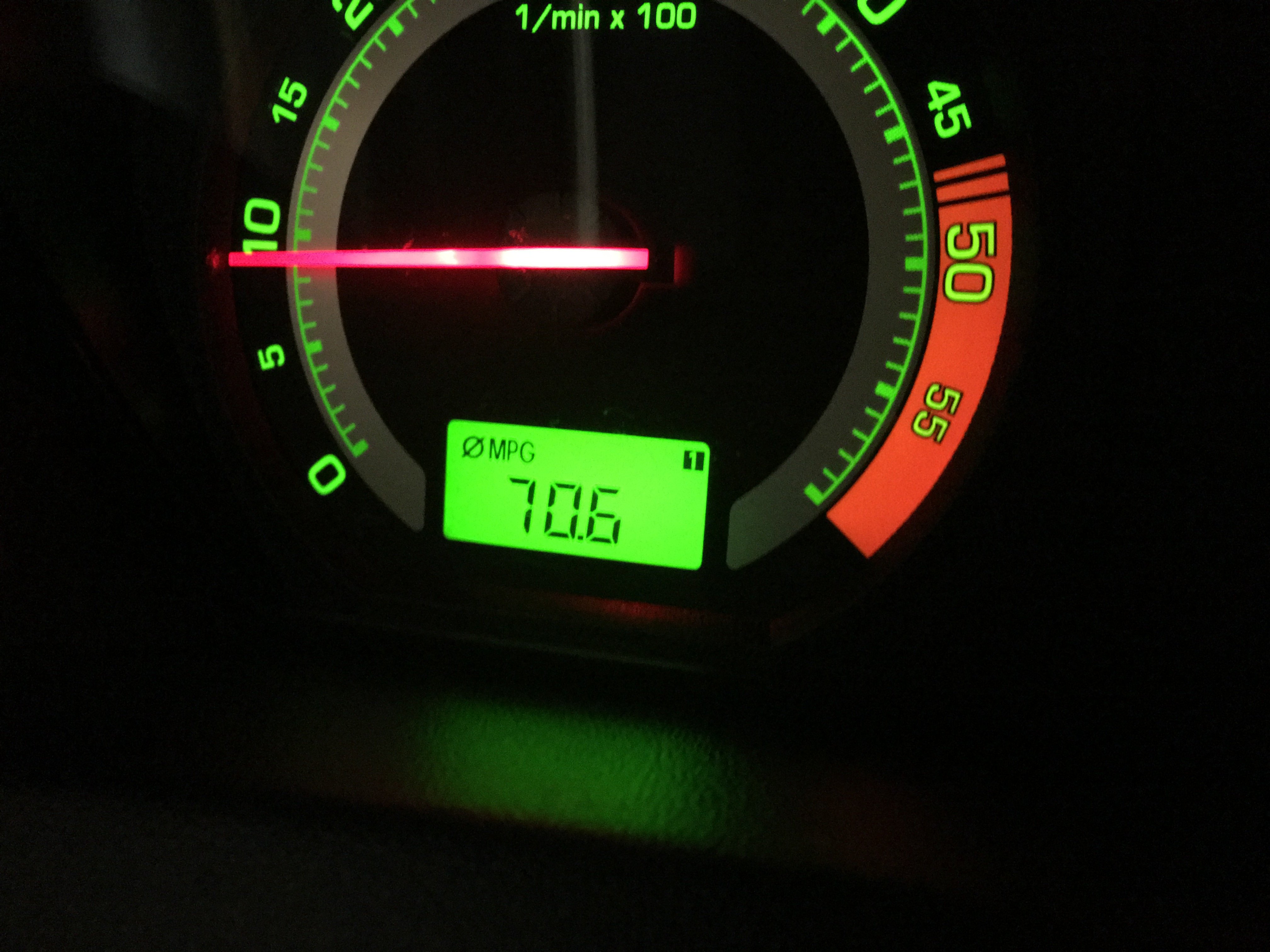

The black pig has been pressed into service as of this morning, makes a frugal commuting snotter and I'm not unhappy with this....

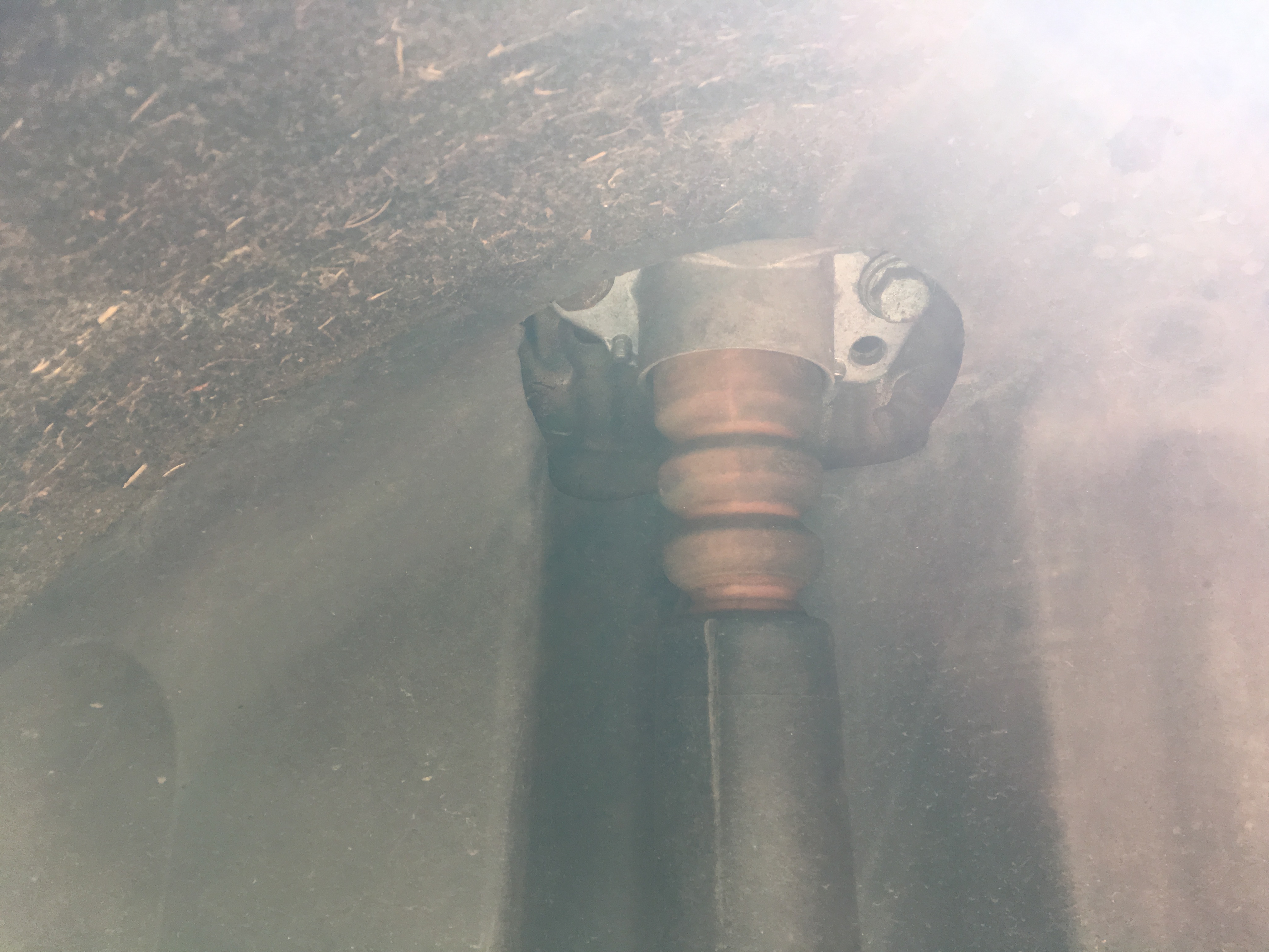

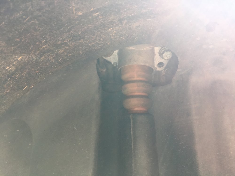

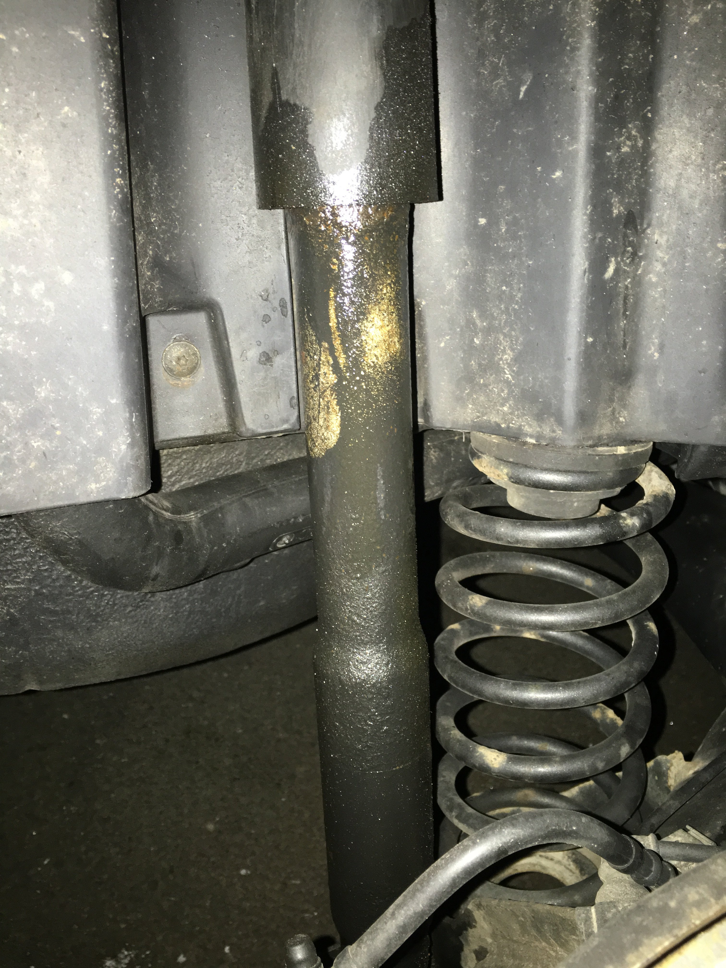

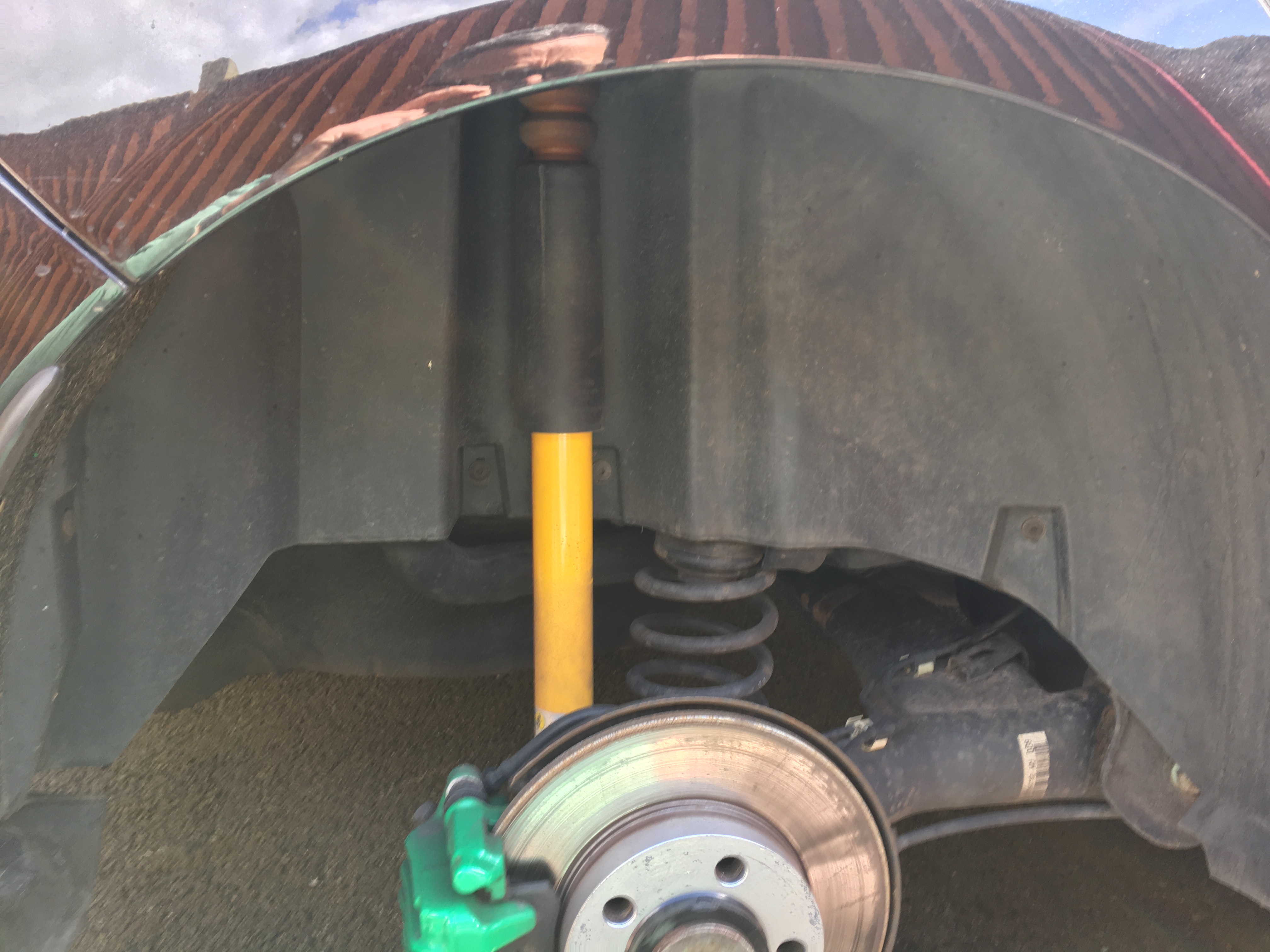

Ive noticed the last couple of days a few spots of fluid around the drivers side rear of the car, I put it down to filling the car to the brim, then filling the vent space up as well, so I jacked it up yesterday thinking I'd find fuel collecting somewhere but no I found the drivers rear damper leaking oil... bugger. Now the dampers that are on it were fitted in about 2008 by Jabba and are actual Eibach dampers. Can't complain after nearly 10 years of use so the plan is for the yellow car to donate its Bilstein B8 front and rear dampers to the black one.

One very poorly Eibach damper..
Daft thing is the damper was complete rooted, the piston rod just flopped about in it but it didn't crash or bang on the road.

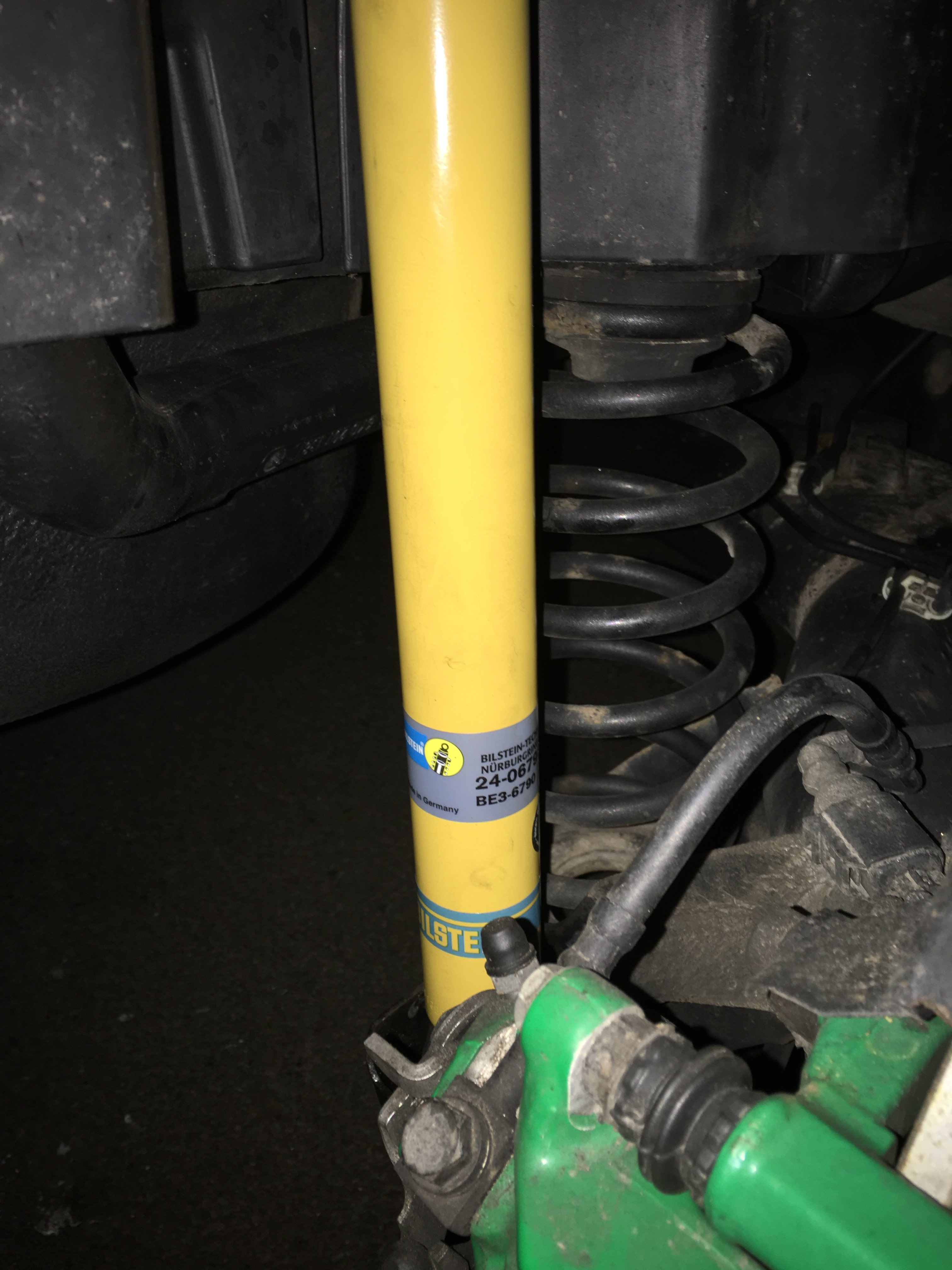

The daffodil had the full Bilstein B12 kit, meaning B8 dampers, with eibach springs.
When i fitted it to the yellow one, it had new genuine top mounts, bearings, bump stops and dust shields. These have done less than 2500 miles so are being swapped over to the black daily.
The front legs/hubs complete are stripped off the yellow one and are having new wheel bearings and ABS sensors and will go on shortly.
The passenger drive shaft on the black one will need a new outer CV boot so I've got enough of those to change them on this one as well as when I Refurb the shafts for the yellow one.
I'll see how the black one fairs on tomorrow's commute.
Another evening of essential maintenance on the black beauty lol.
Fitted the Bilstein B8 front dampers, eibach springs, new top mounts and bearings, new front wheel bearings/hub flanges, new front ABS sensors, new bottom ball joints, new drop links and new track rod ends.
Thankfully it's cured the wheel bearings that had just about become a constant howling, and cured the knock knocking from the tired top mounts as well. Ride is lovely now..

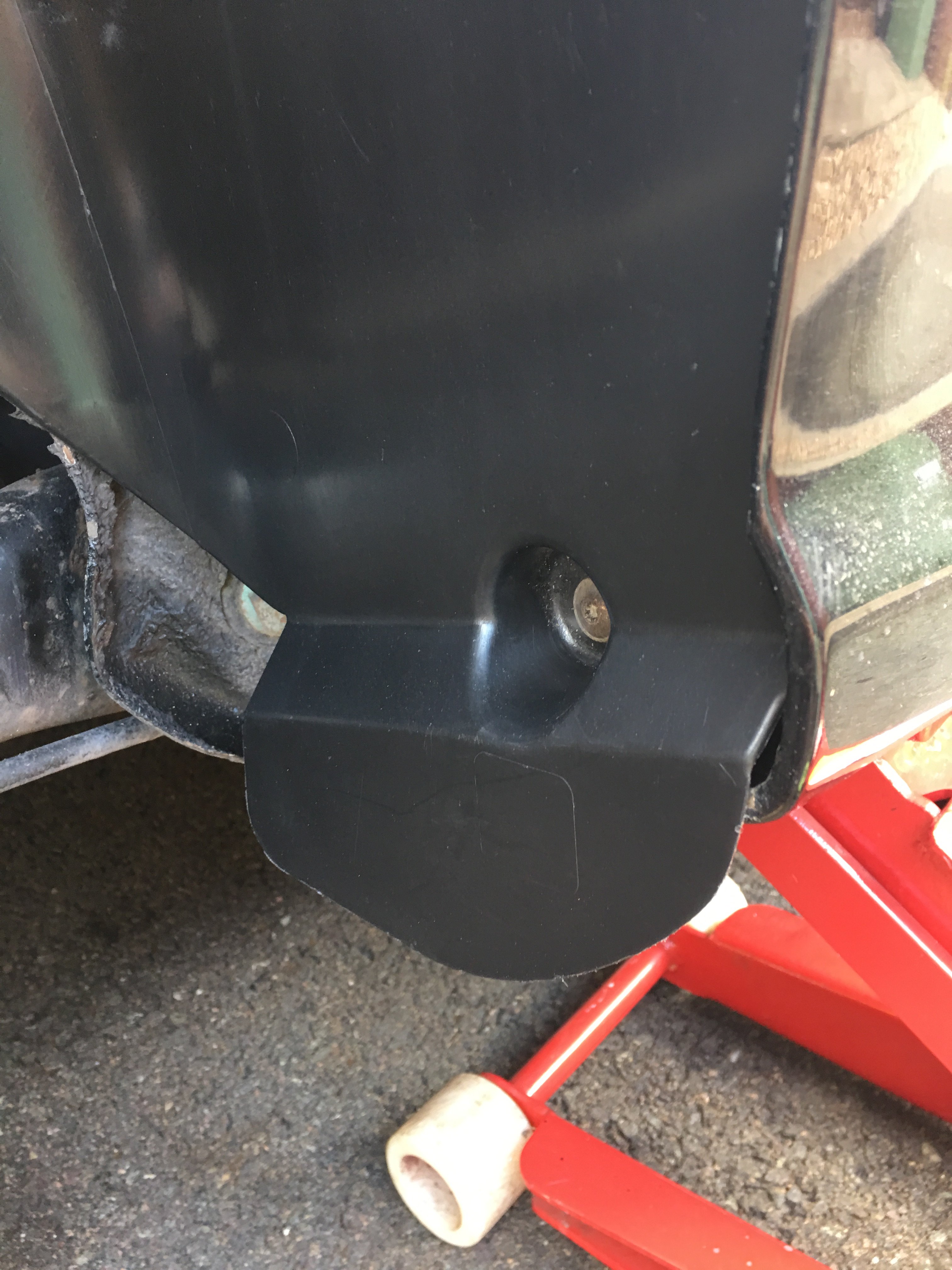

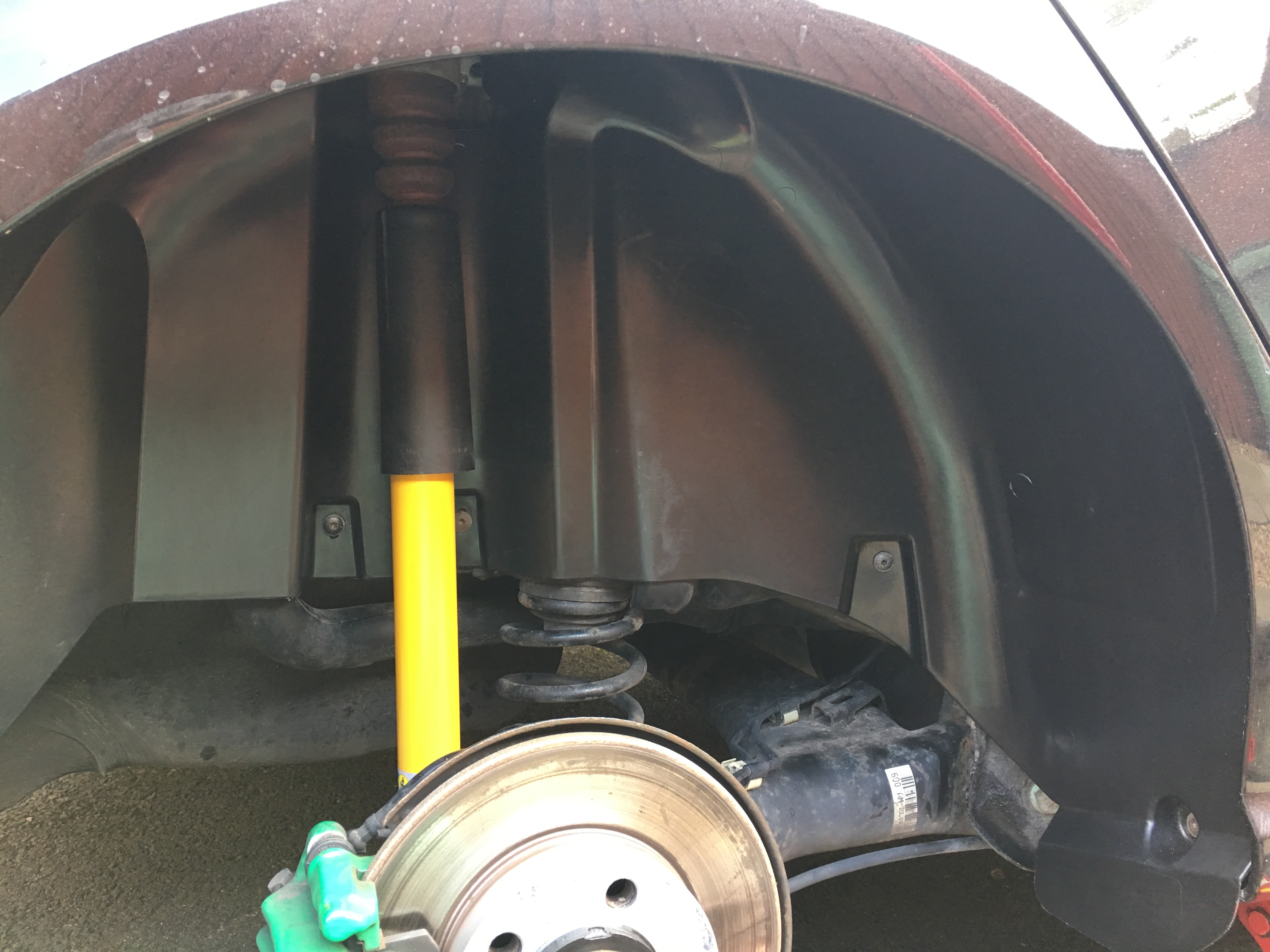

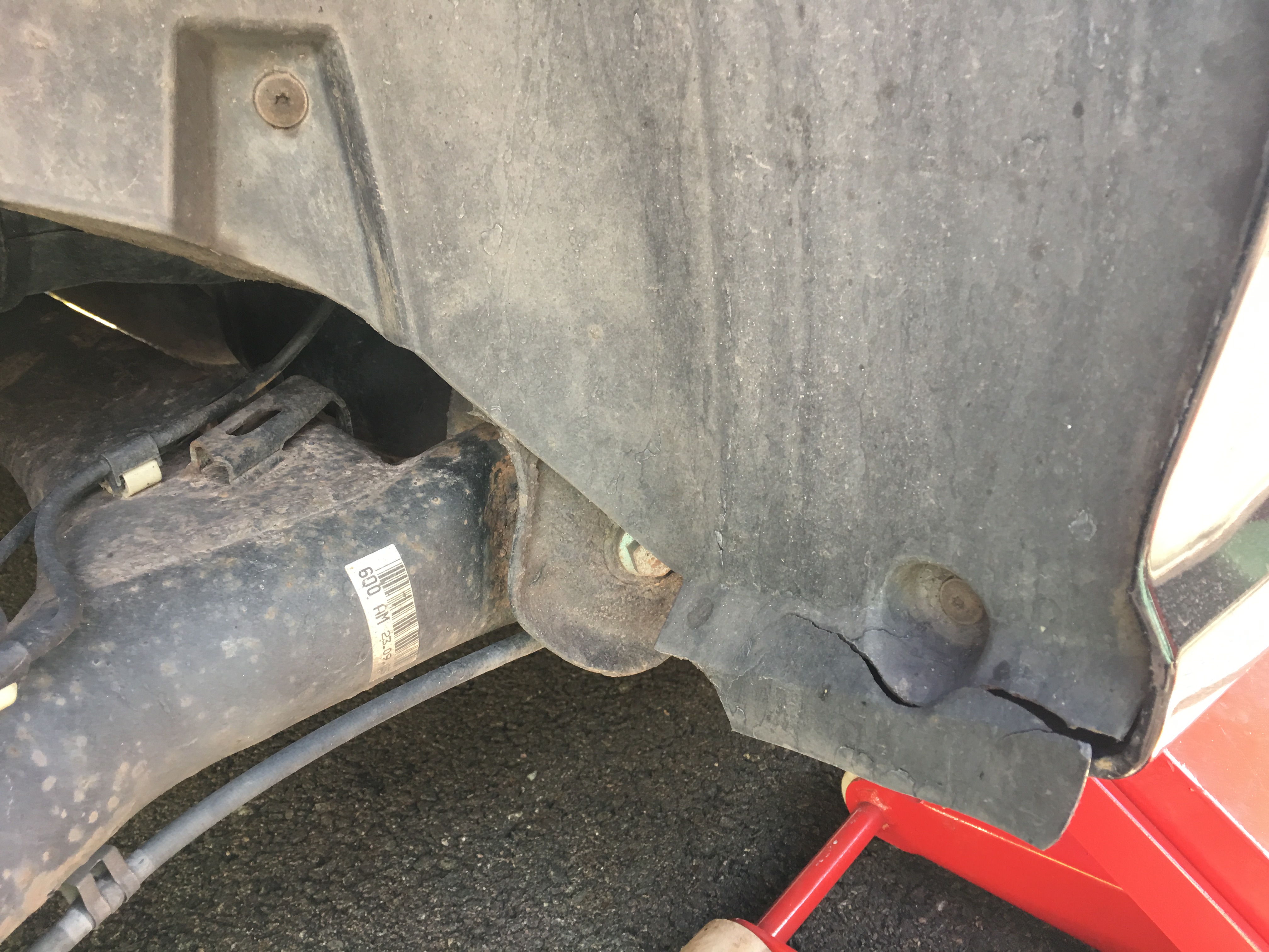

The rear dampers were both changed recently and the state of the rear arch liners was distressing to say the least. Both were broken on the lower leading edge and I can only assume that whoever fitted the original uprated rear dampers had brutally chopped the top section out to get to the top mounts, downside to such butchering is all the road dirt and rubbish goes behind the liner.. kind of defeats the object!??
New liners were bought from TPS.
Some before..
Shiny new one!
