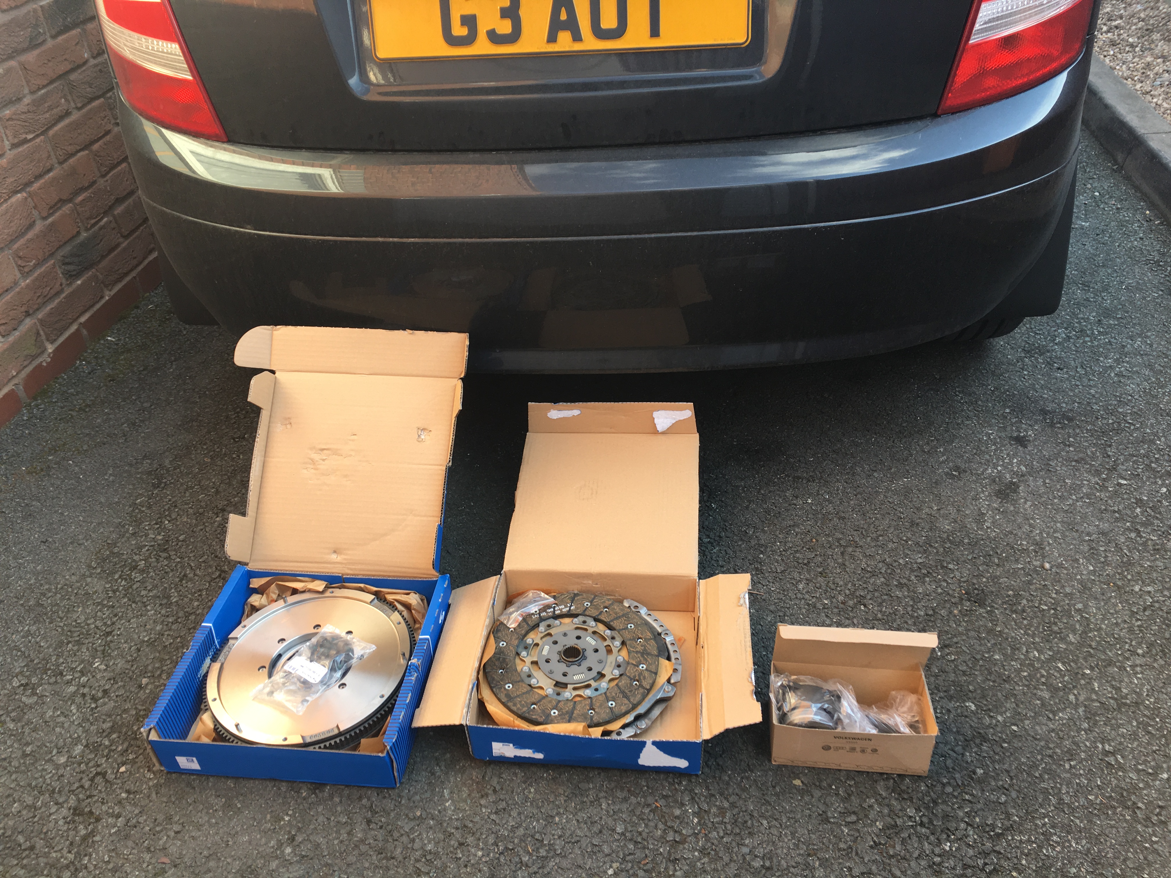

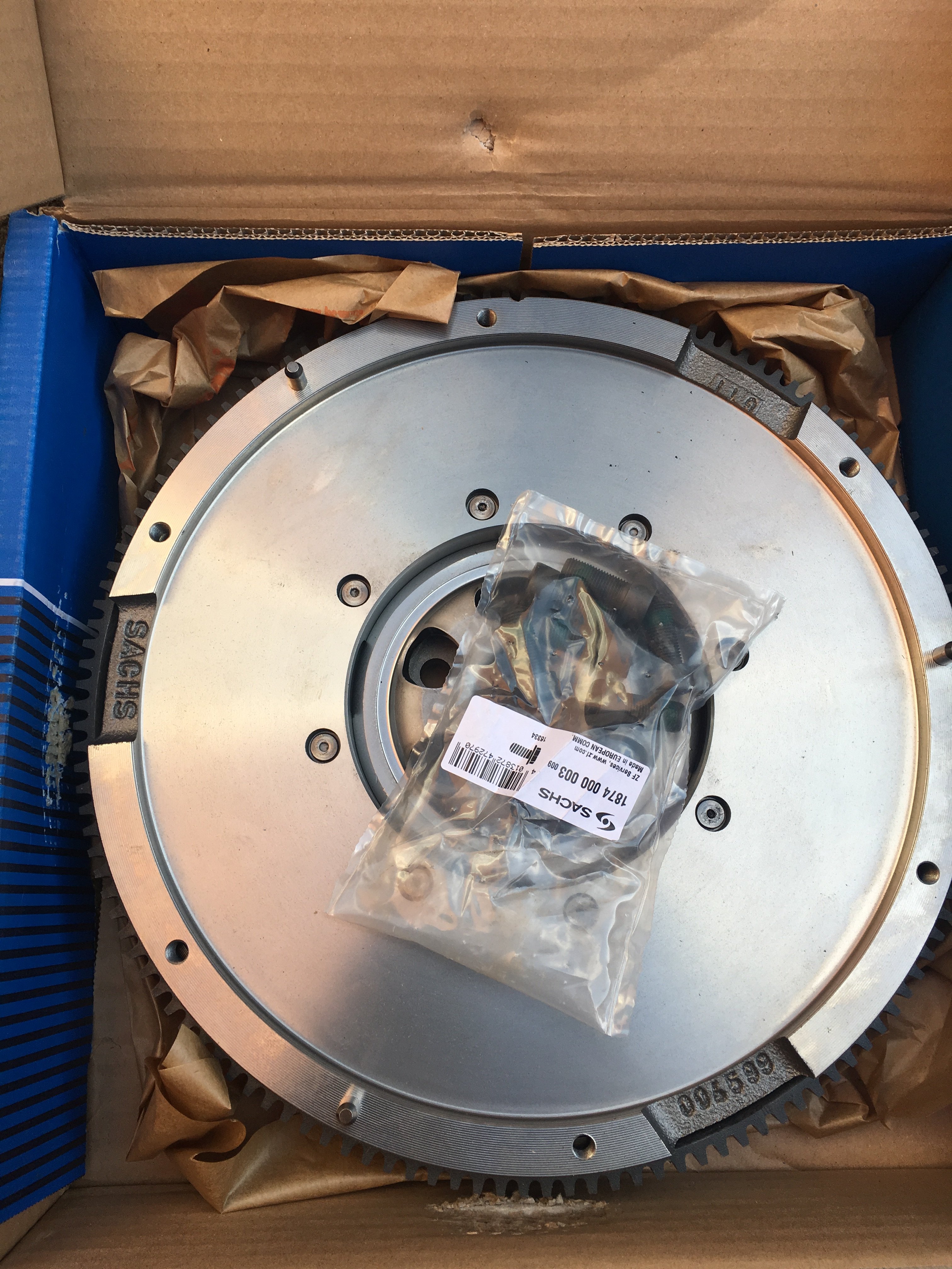

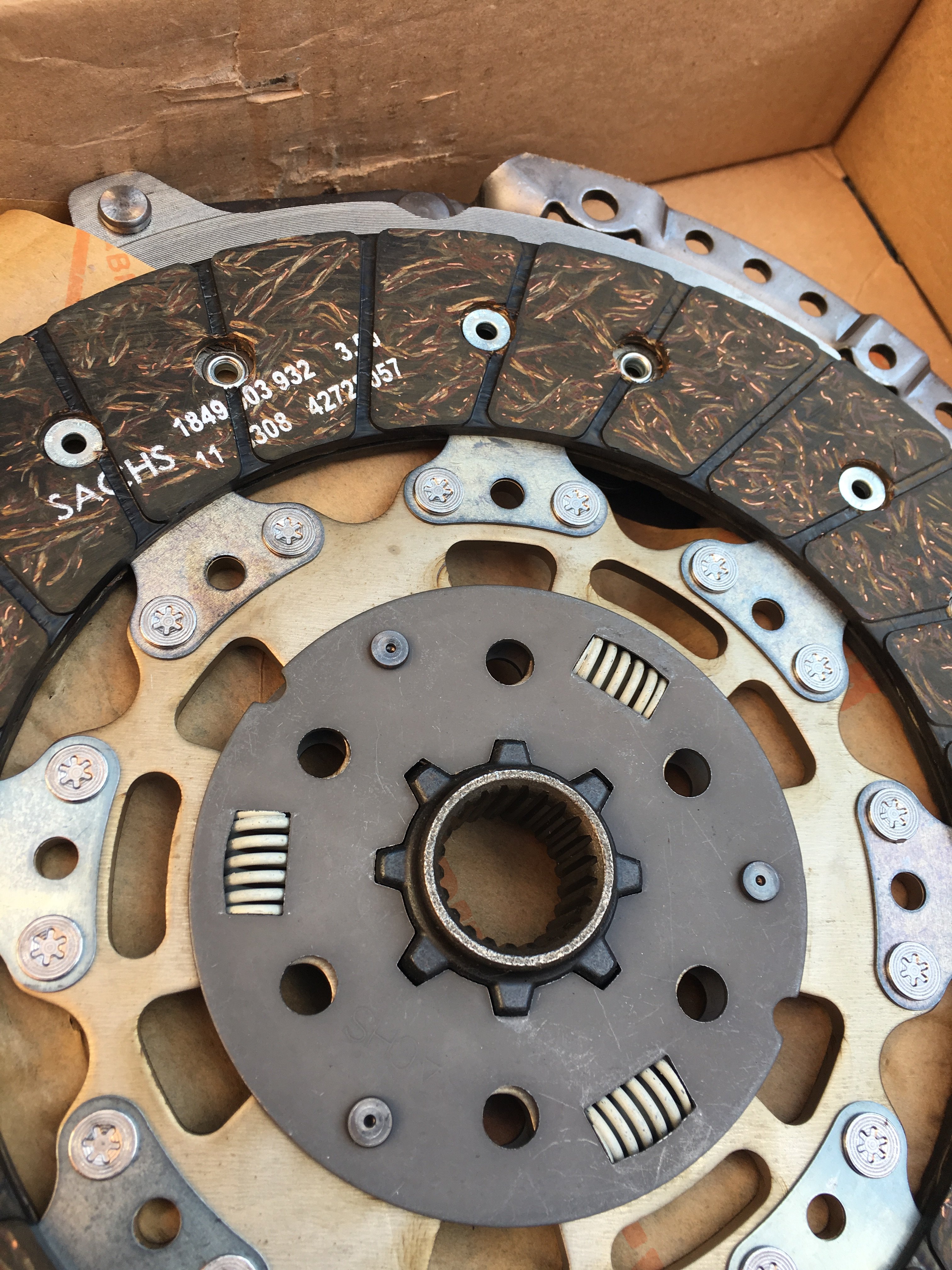

The dual mass flywheel is protesting with a heavy vibration at certain loads, transferring the vibrations through the bulkhead and even making the accelerator pedal vibrate. The clutch itself appears fine, no slip or difficulty engaging gears, but with the miles I'm doing I can't afford to be stranded.
So a genuine OE fit Sachs dual mass flywheel, clutch, pressure plate and genuine Clutch slave cylinder are going in on Friday.
No complaints from me with the original clutch, it's done 113k with the last 14k miles at well over 200bhp, done some trackdays as well.

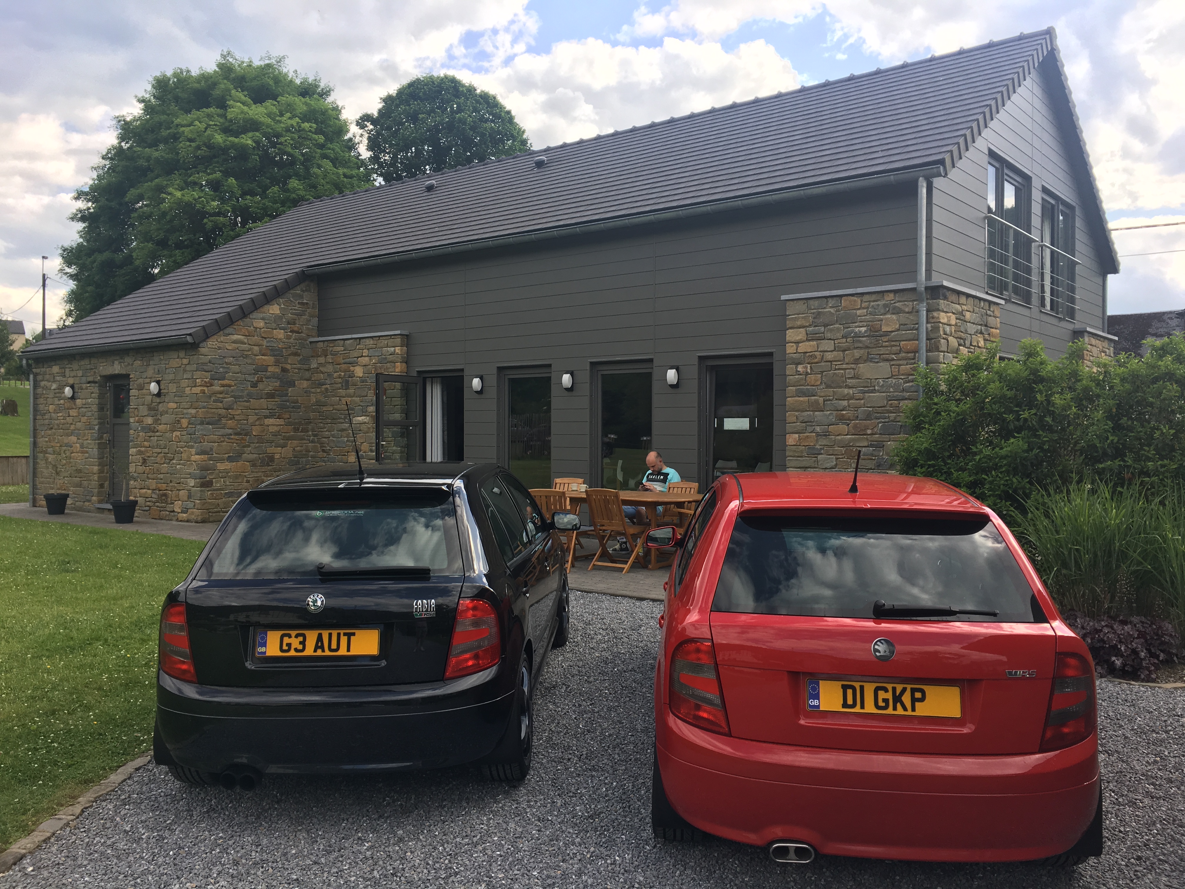

Rich off here joined us as normal and the cars look quite good together outside our rented house for the week.
Loads more miles planned for this week along with the usual ring laps etc..

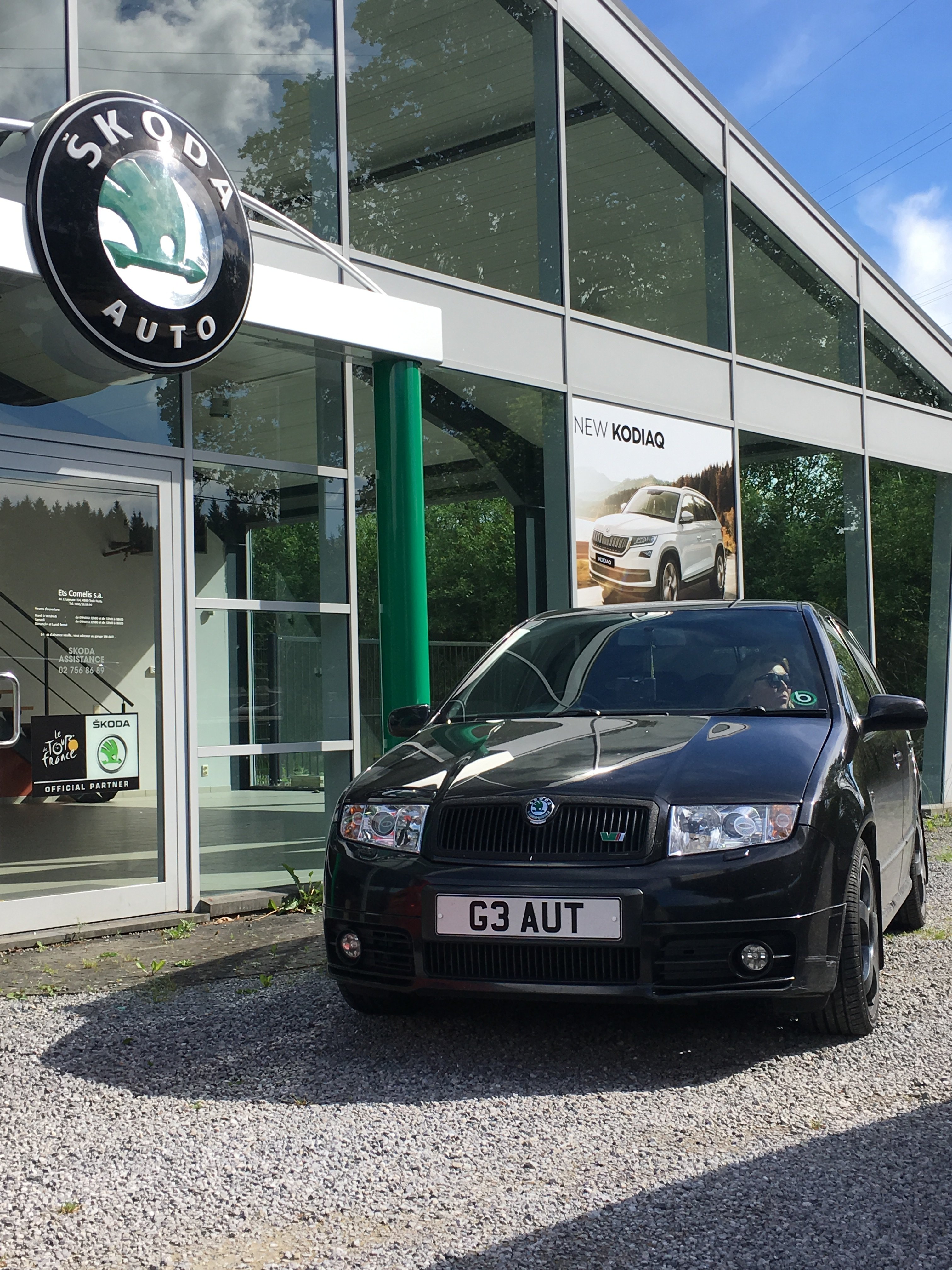

Been exploring today, come across a very recently abandoned Skoda dealership...

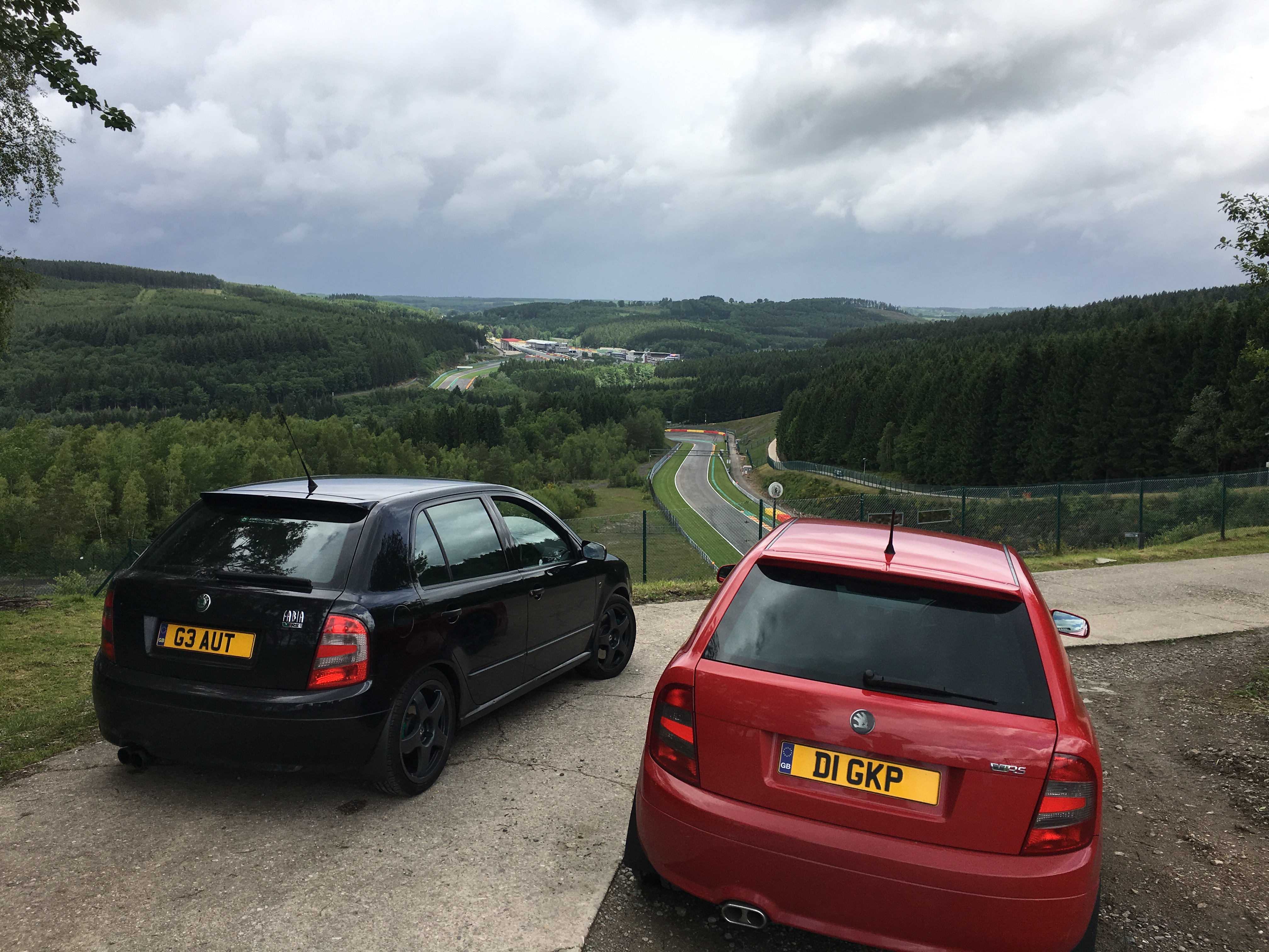

Off to Spa francochamps circuit tomorrow for a track day, hope this good weather holds.
Spent Wednesday at Spa-Francochamps with very changeable weather..
As always even in the rain it's a beautiful place, a real treat for petrol heads. Mrs Loftys first time there and she was dead excited lol

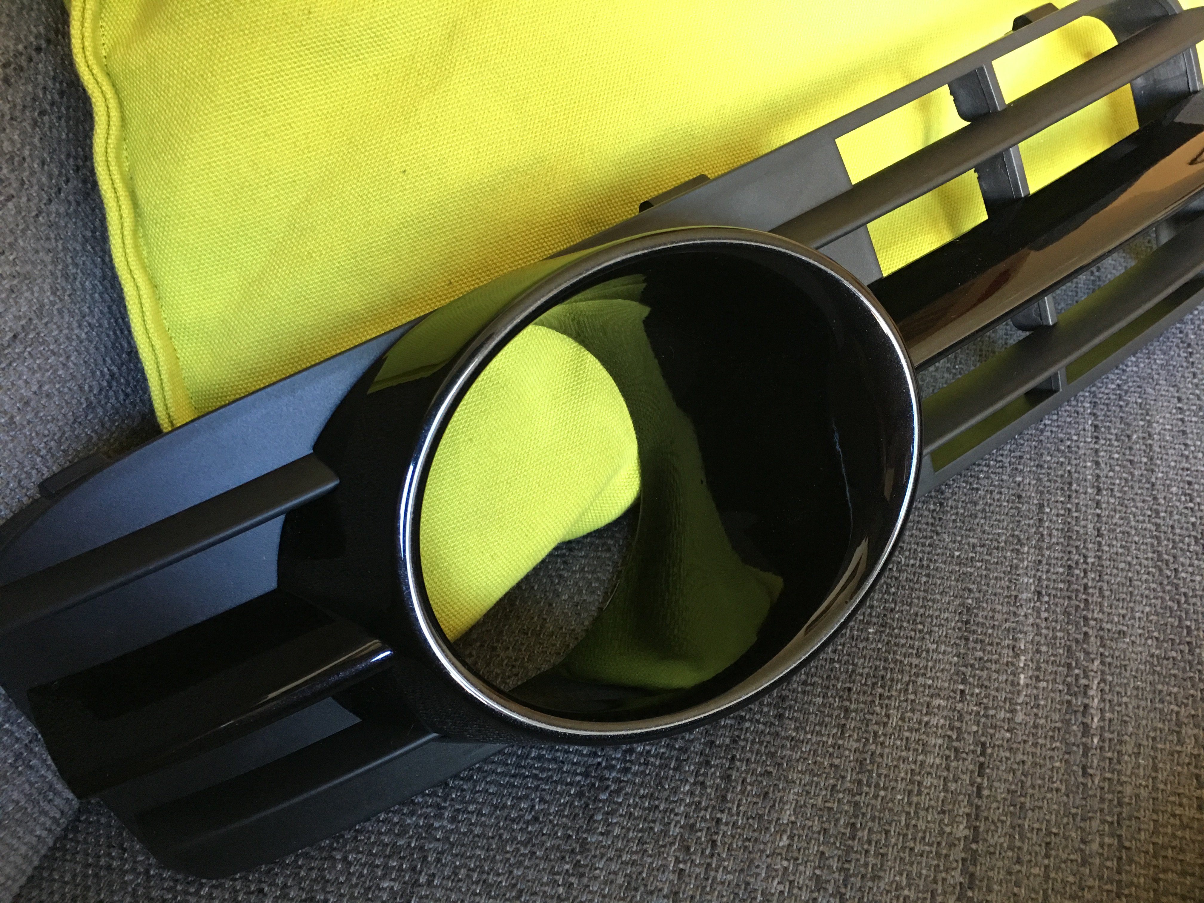

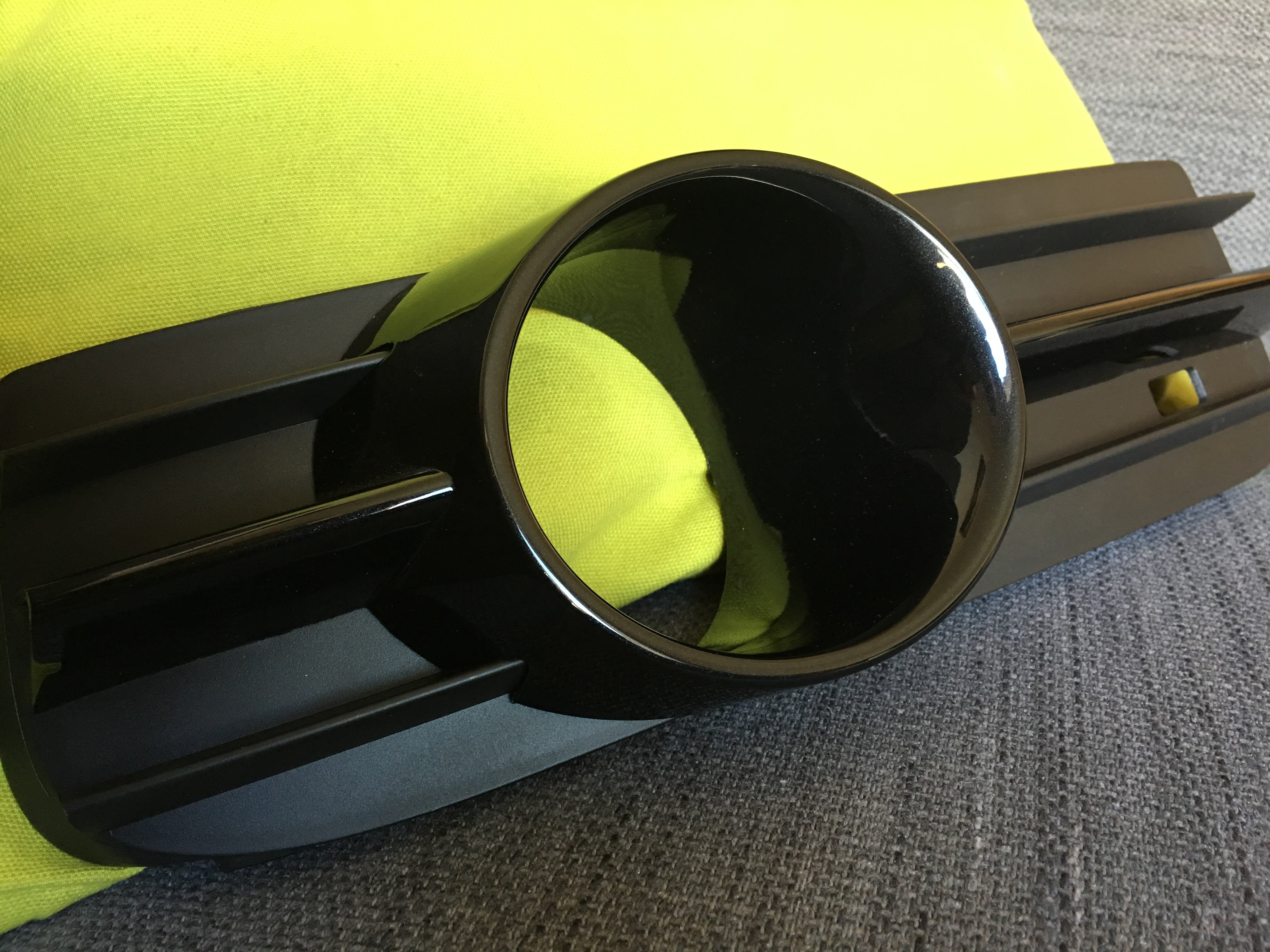

The original front bumper was in a mess. Scuffed both sides, chipped, and damaged on the lower left bottom corner. Being a factory xenon fitted car means the bumper is unique to that version and second hand ones just don't seem to come up. Plus nearly every used bumper is just that - used so would need repair and repainting  at the very least, so I've bought a brand new bumper from TPS. This is currently at the body shop being primed and painted fresh Black Magic Metallic.
I've bought new foglight surrounds and backings, and the surrounds are being painted at the same time.

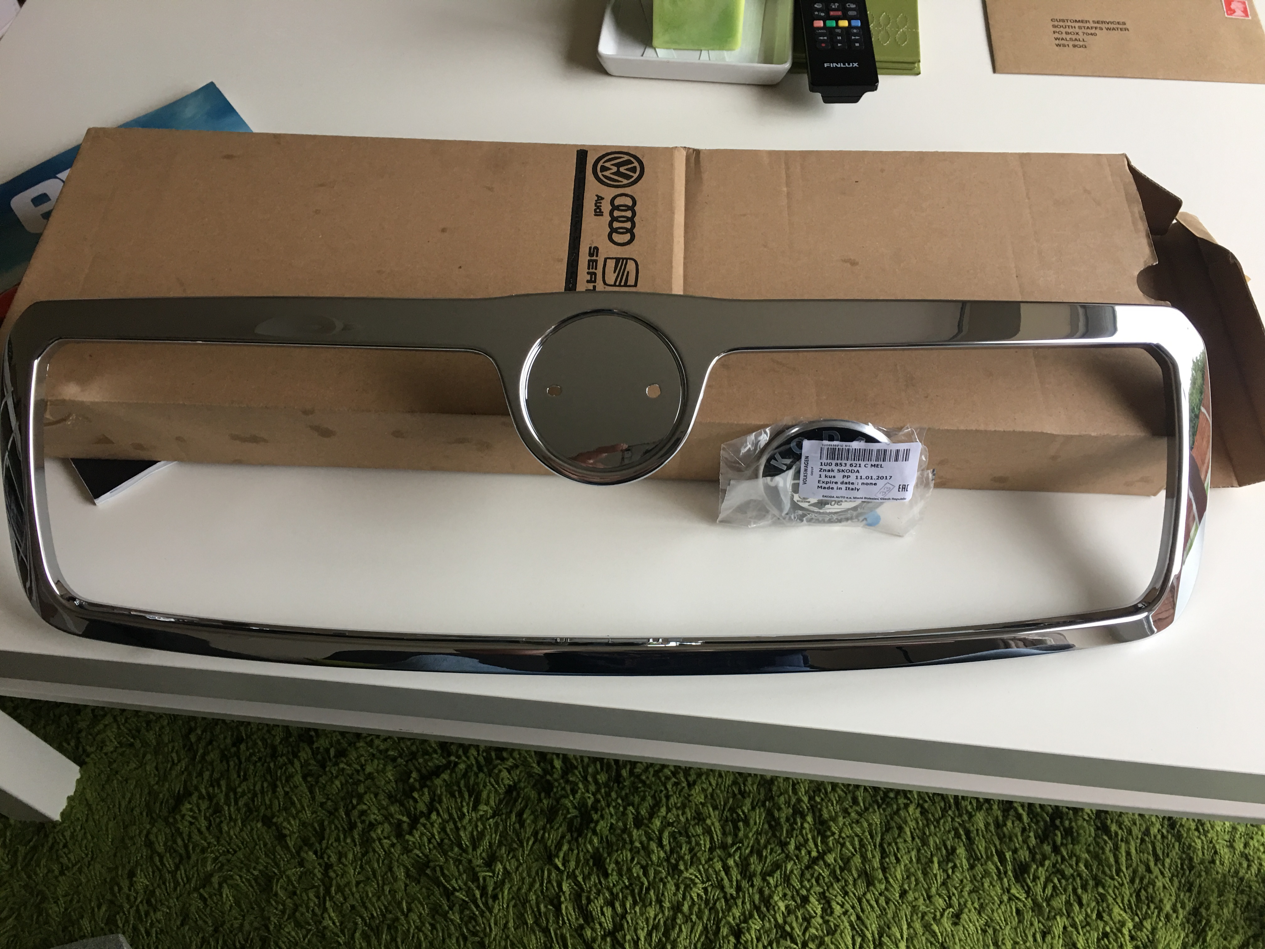

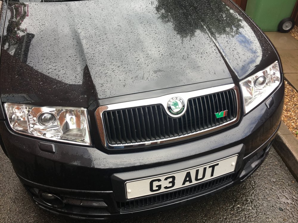

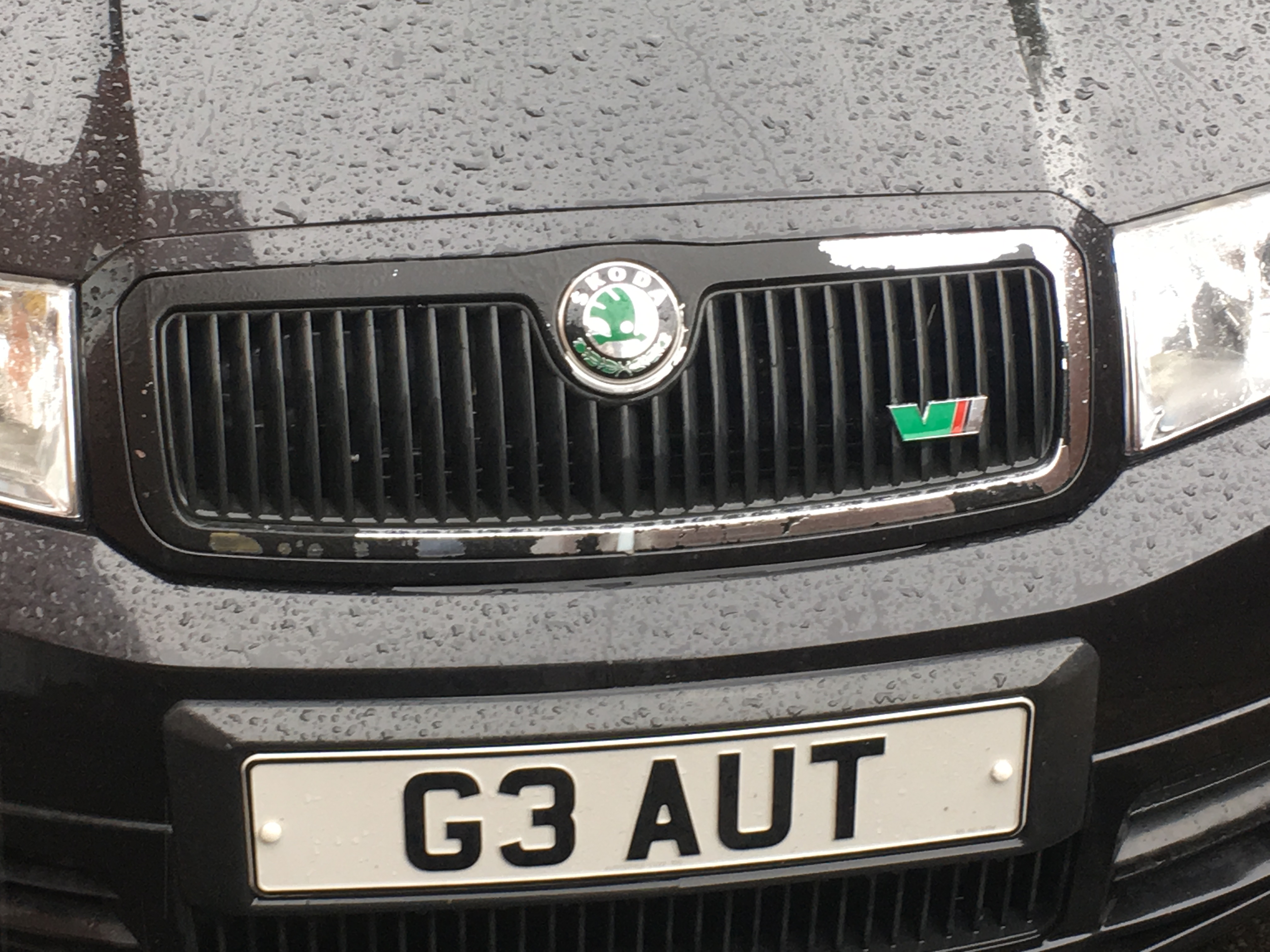

The temporarily painted black grille was also suffering with mileage and stone chips / subsequent jet wash damage...
Not a pretty sight. I bought a new chrome grille surround and new Skoda badge, keeping with the OE spec badging
Built it all up in between the today's thunderstorms
Much better and will be staying chrome.

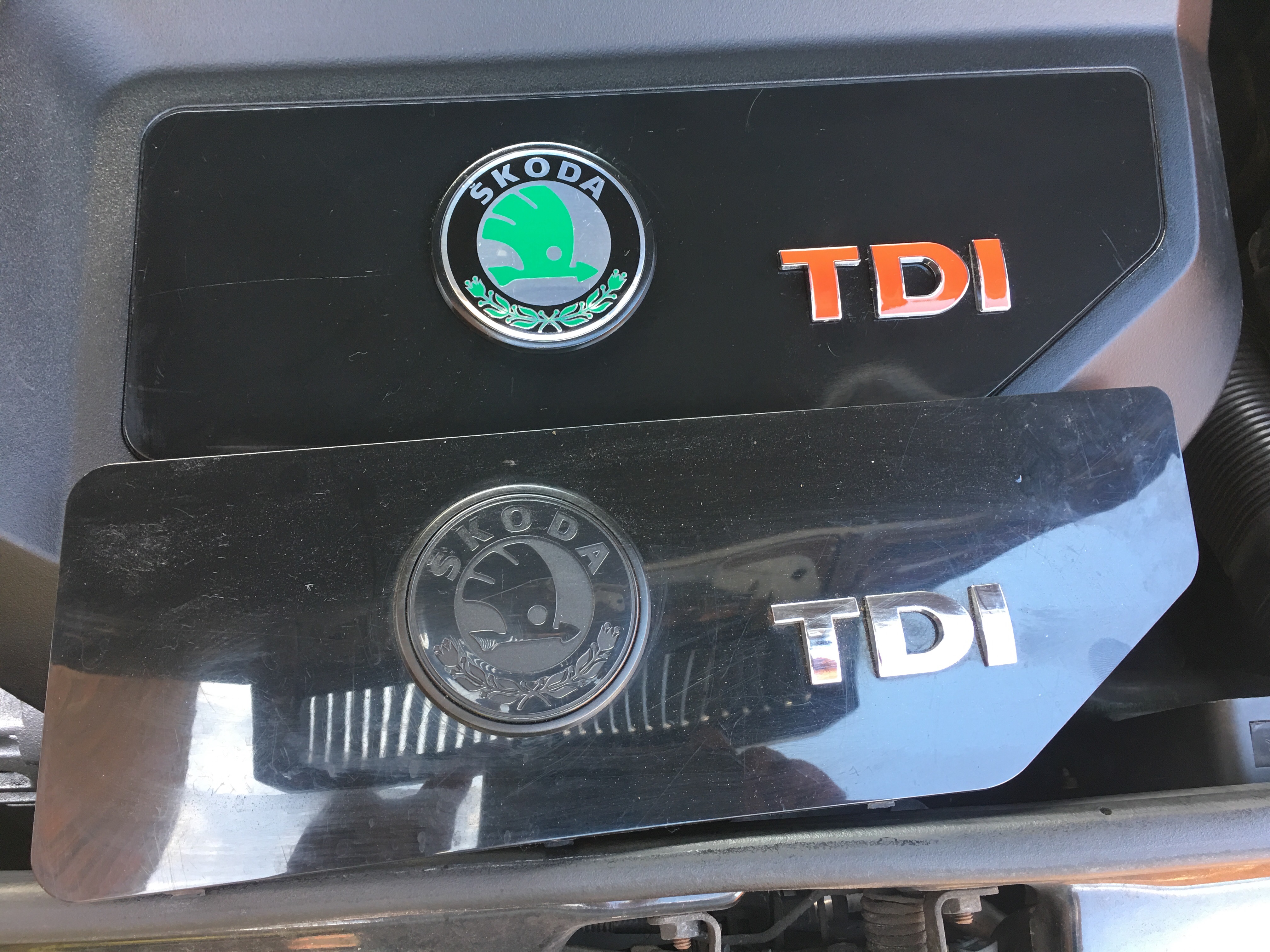

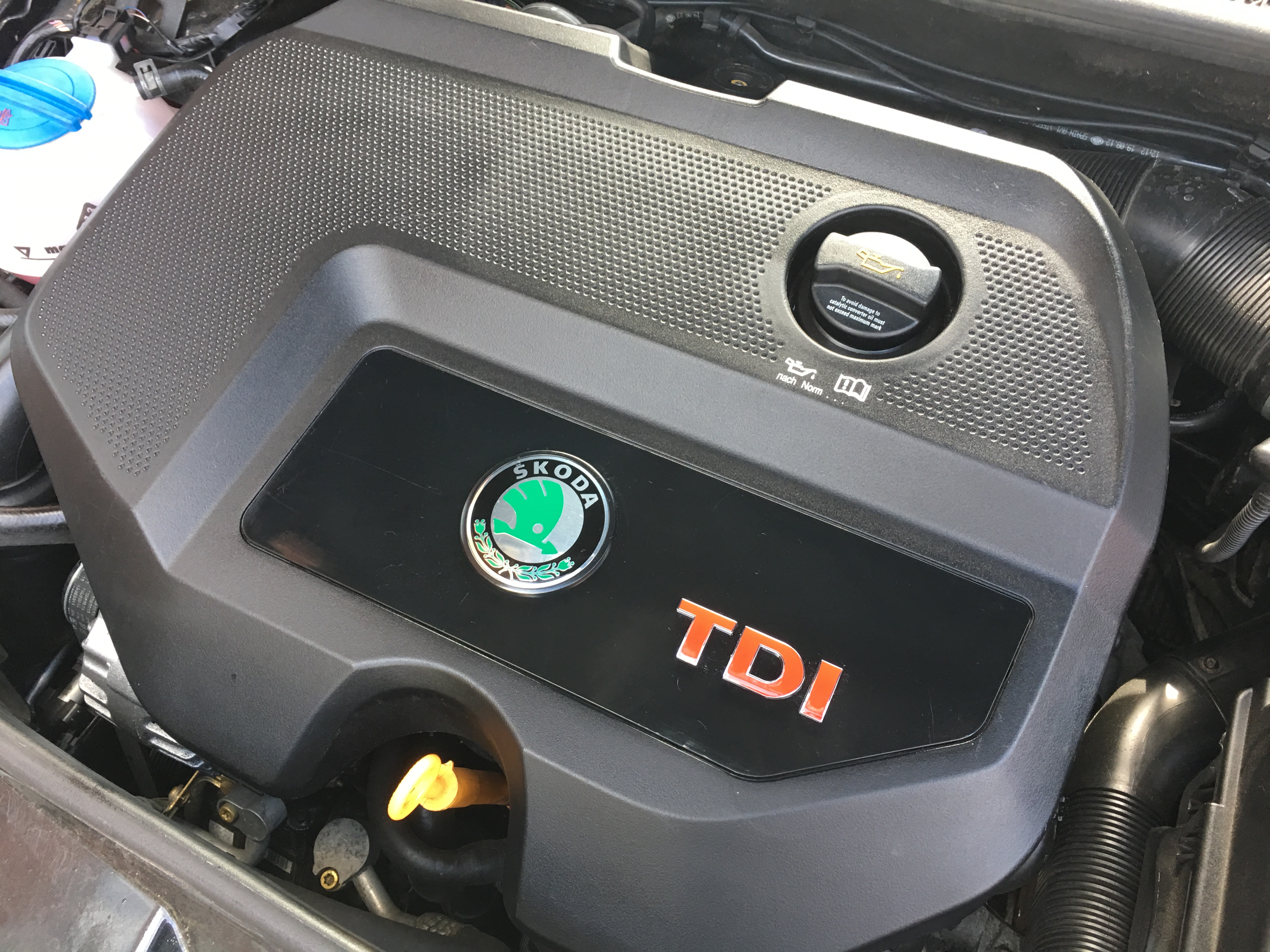

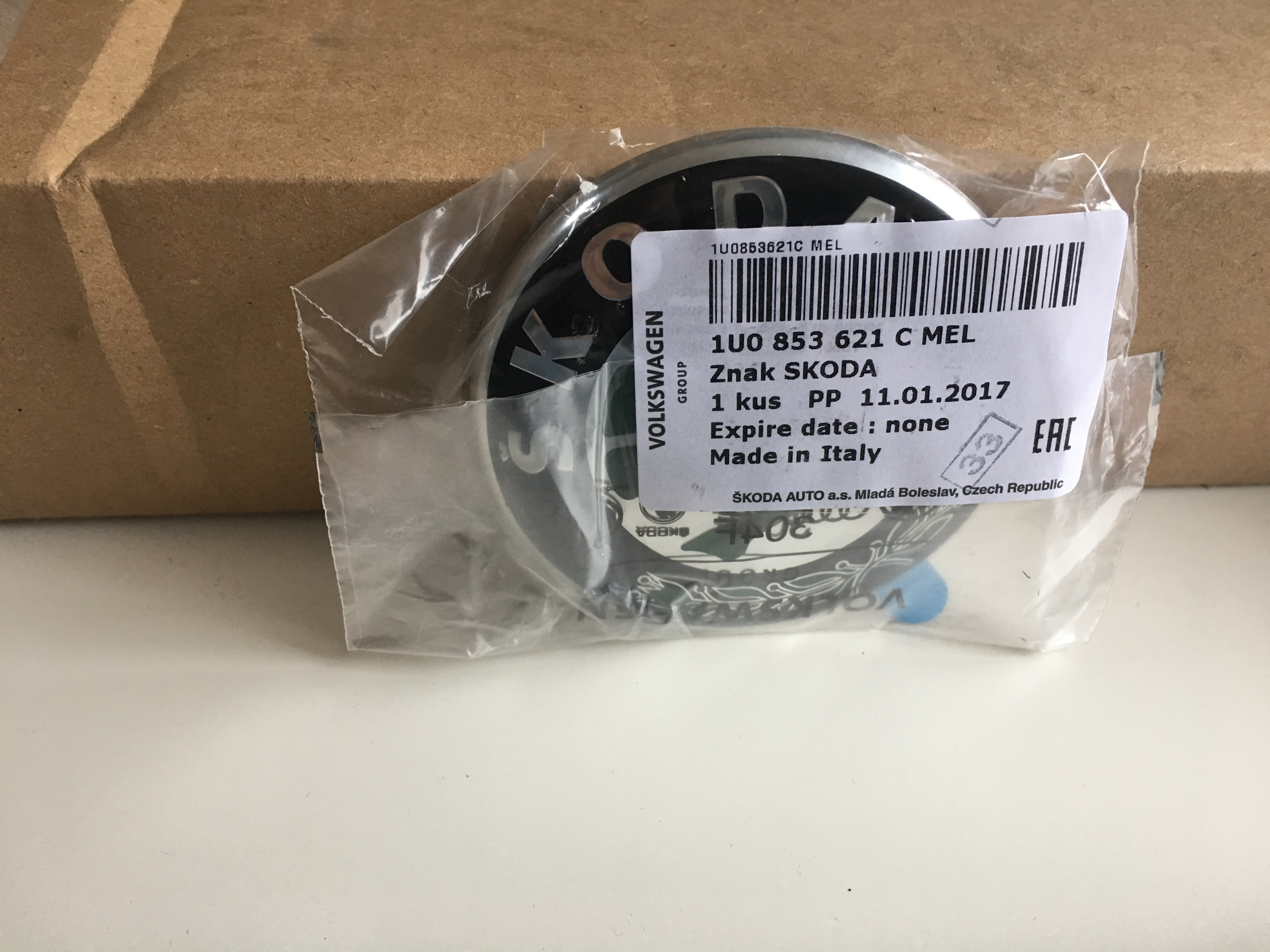

The BLT engine cars came with the engine cover combination of black Skoda badge and silver TDI lettering. Bit dull and boring. I did this same mod to the yellow ones engine cover so at least they will look the same side by side at a show with the bonnets open..
The early Mk1 Fabia's with the ATD PD engine had a cover with a full colour Skoda badge on and the red DI of the TDI. The securing pins on the back of the green and all black badges are in different places so you can't swap one badge for another, you have to swap the entire engine cover insert. I then bought the full red TDI script off a Mk4 Golf PD150, as that's more befitting of the turbo spec etc...
BLT bit at the bottom, my "hybrid" one above

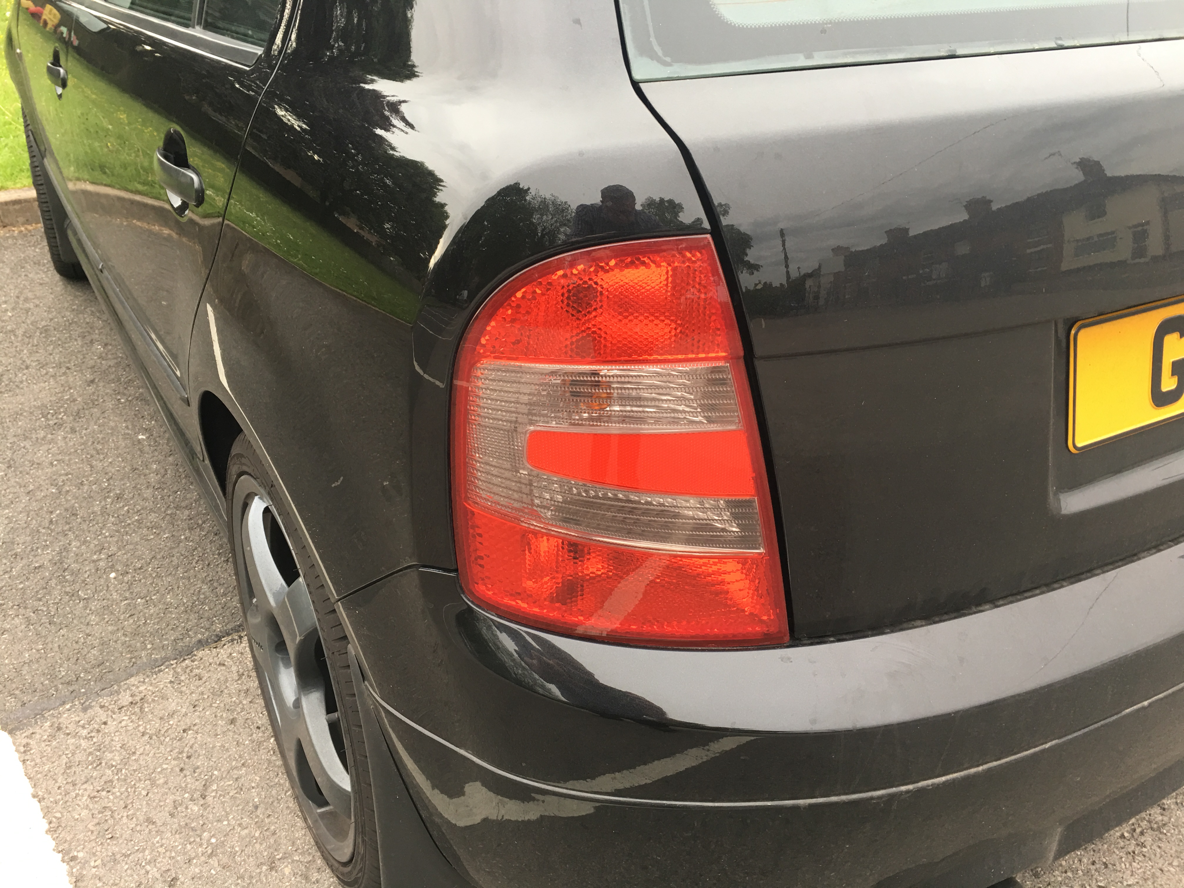

Lofty! Can i ask what was used and how you tinted the clear sections on the rear lights? I like.
Easy peasy! I used a very very light tint adhesive film off eBay, apply over water and squeegie it down, trim the bits overlapping the red bits with a sharp blade, and bobs your aunties live in lover
Perfect mate! Don't suppose you have a link to said film? It's just right tint wise!
Nick
Nick
https://www.ebay.co.uk/itm/172764432054
that should be it

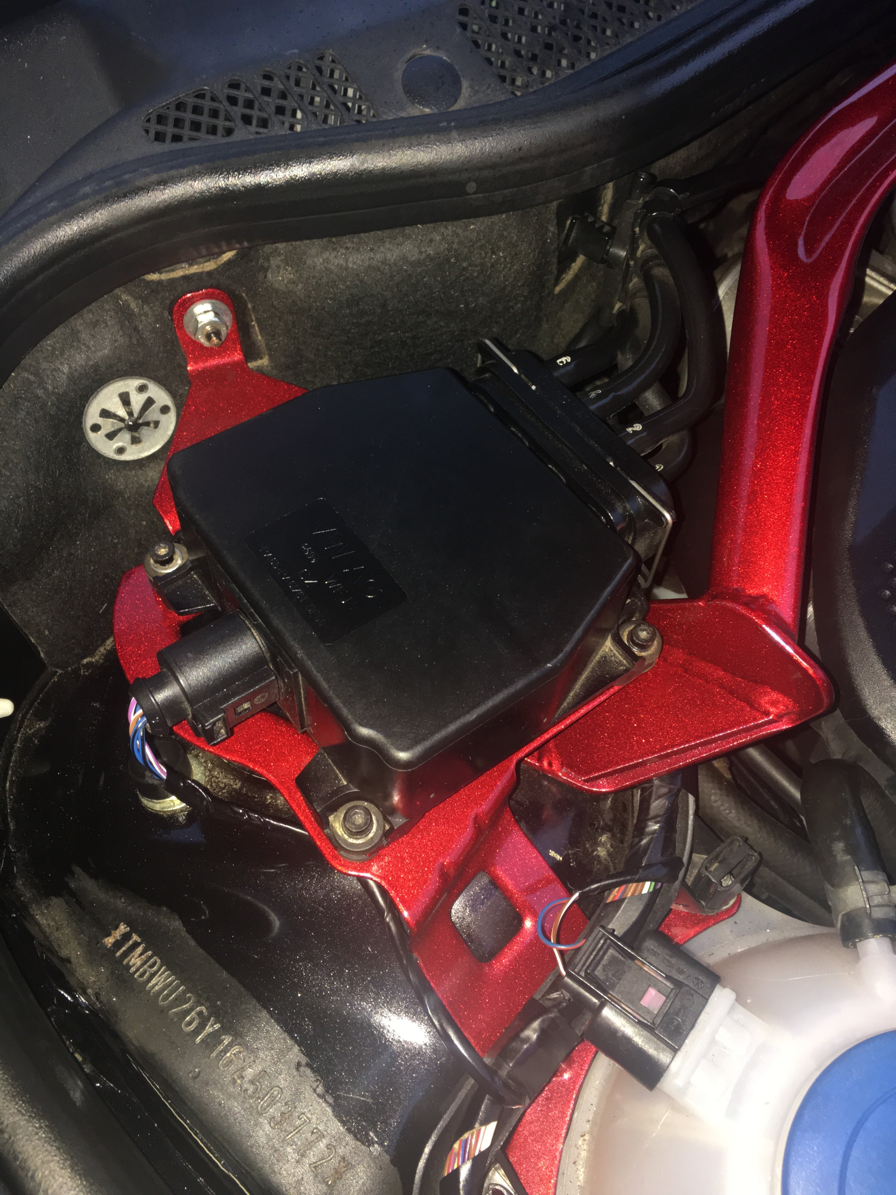

Few more bits collected to continue with the under bonnet tidy up

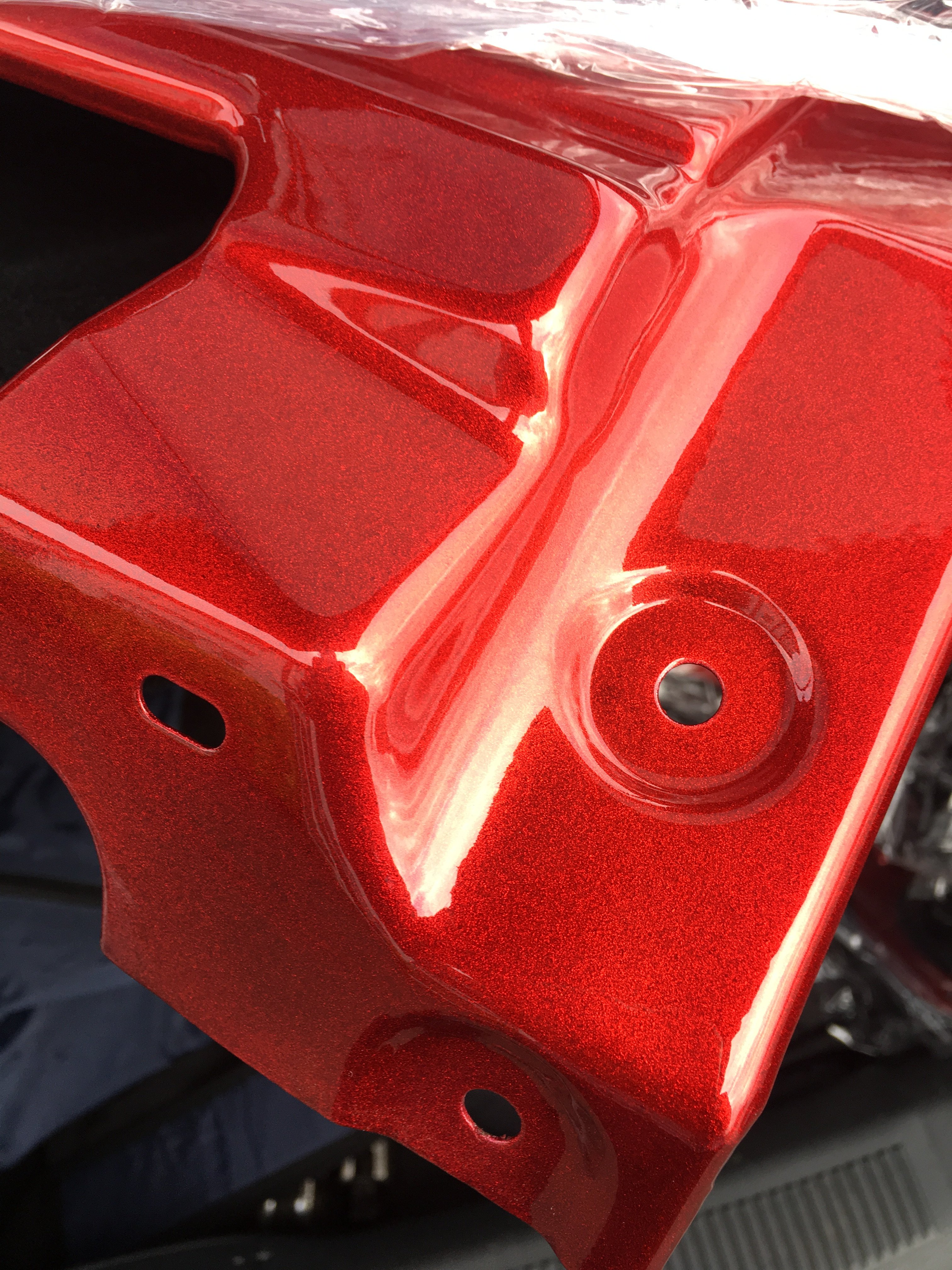

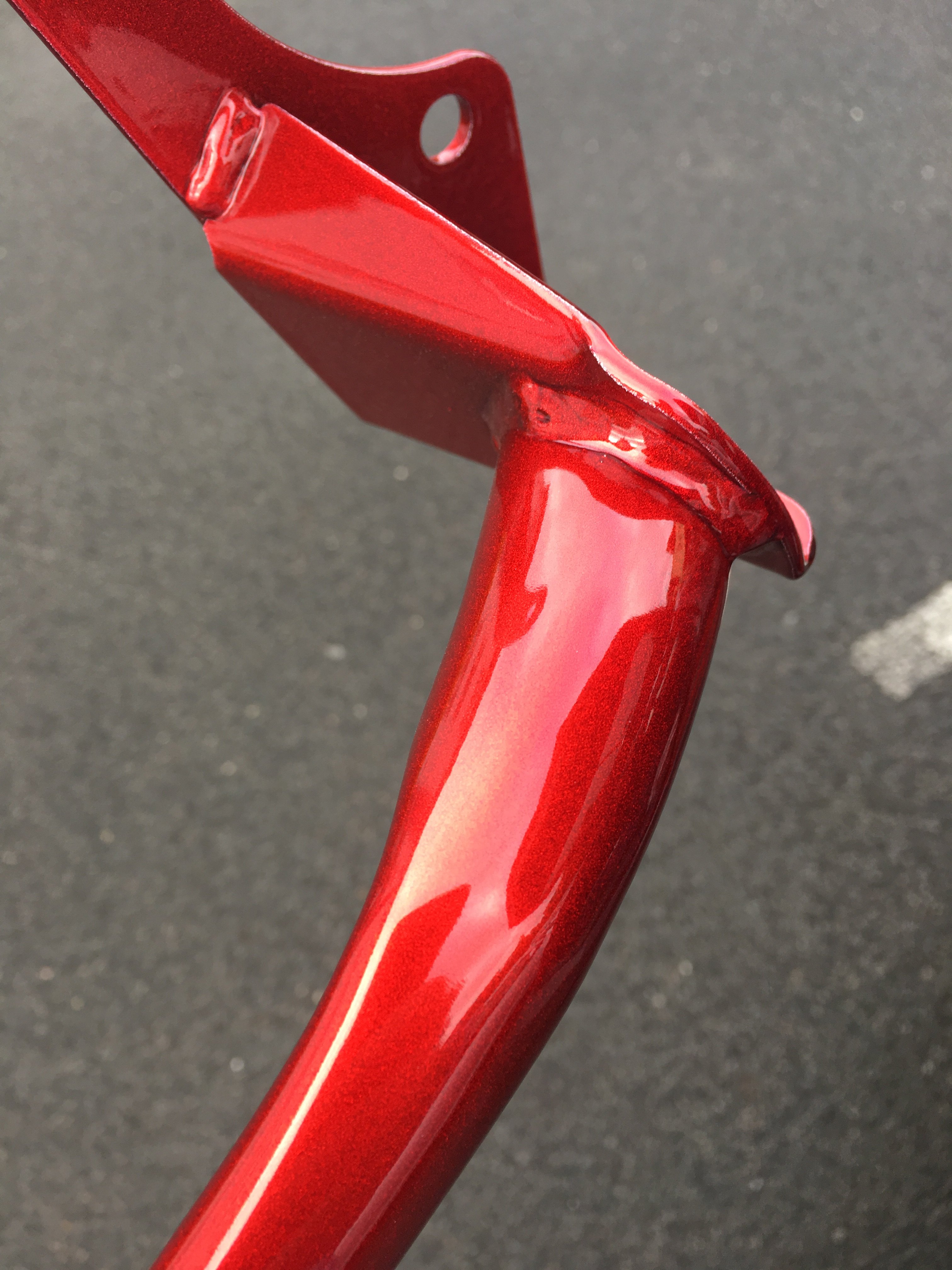

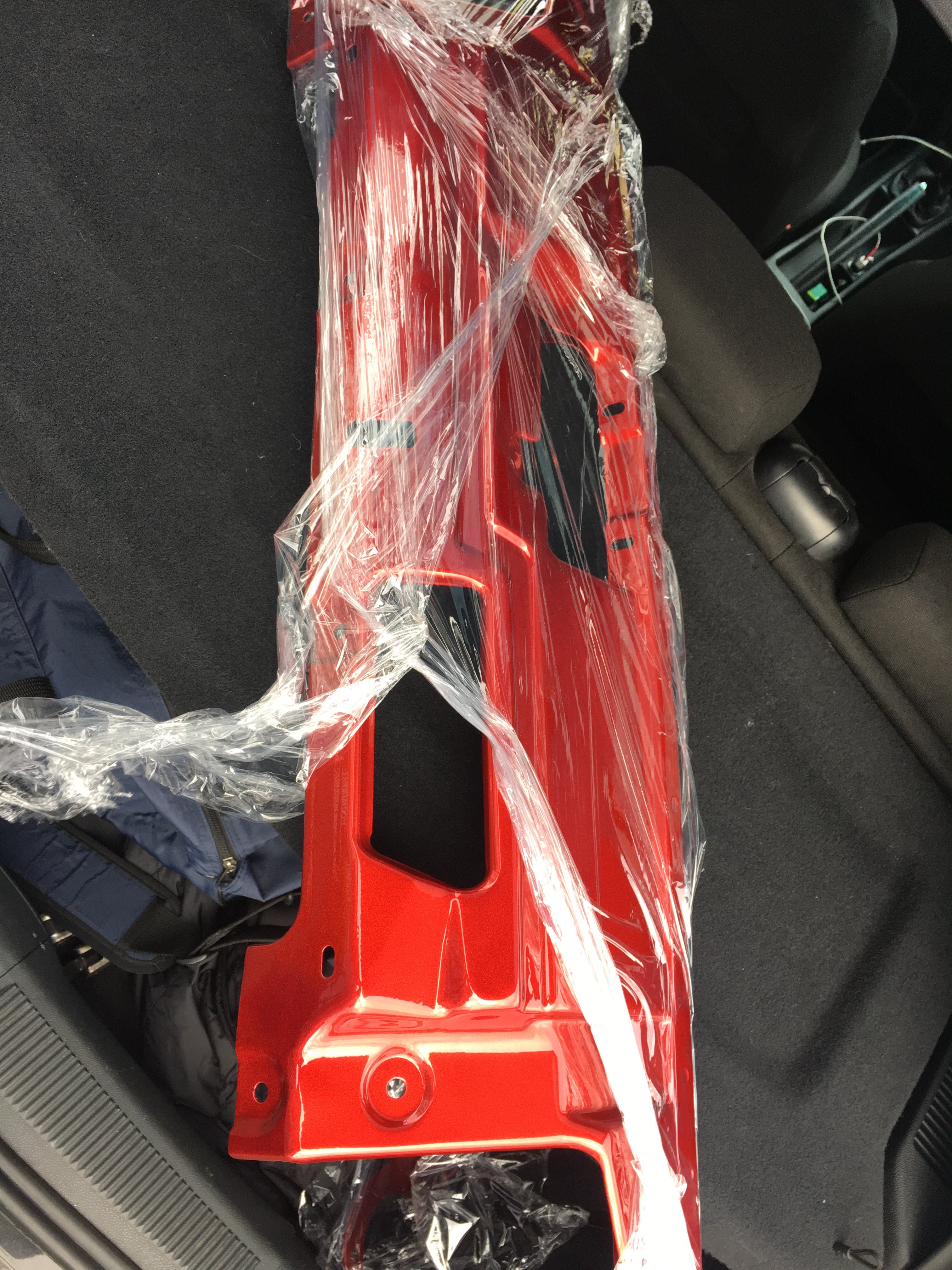

Slam panel powdercoated in candy red
Extremely pleased with the finish of it

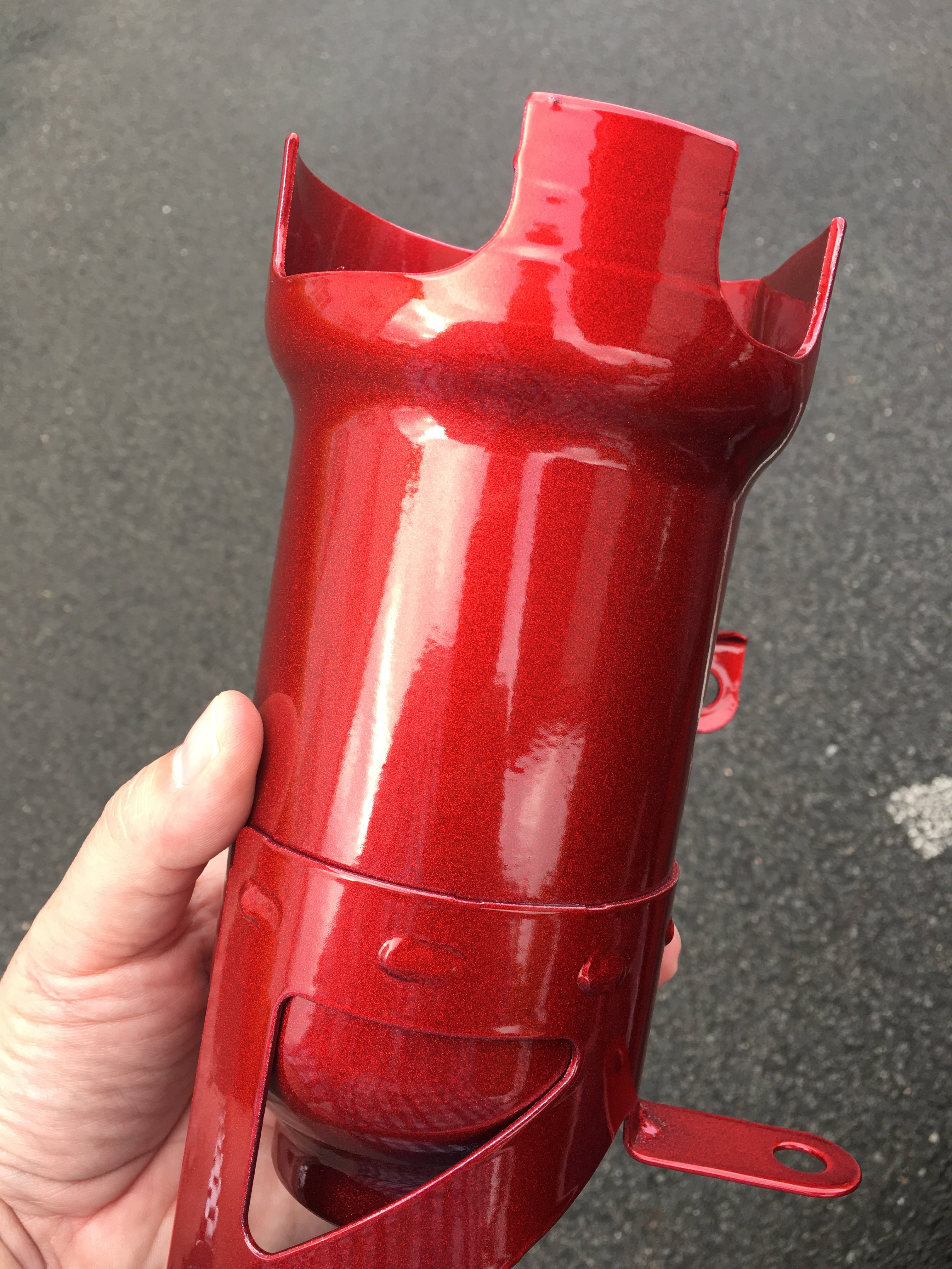

I struggled to find a reasonably priced used SEAT sport strut brace but they were nearly the price that I could get a new one so I bought new and had that powdercoated candy red along with the fuel filter housing
Need to source a set of hard pipes to get those done red as well..

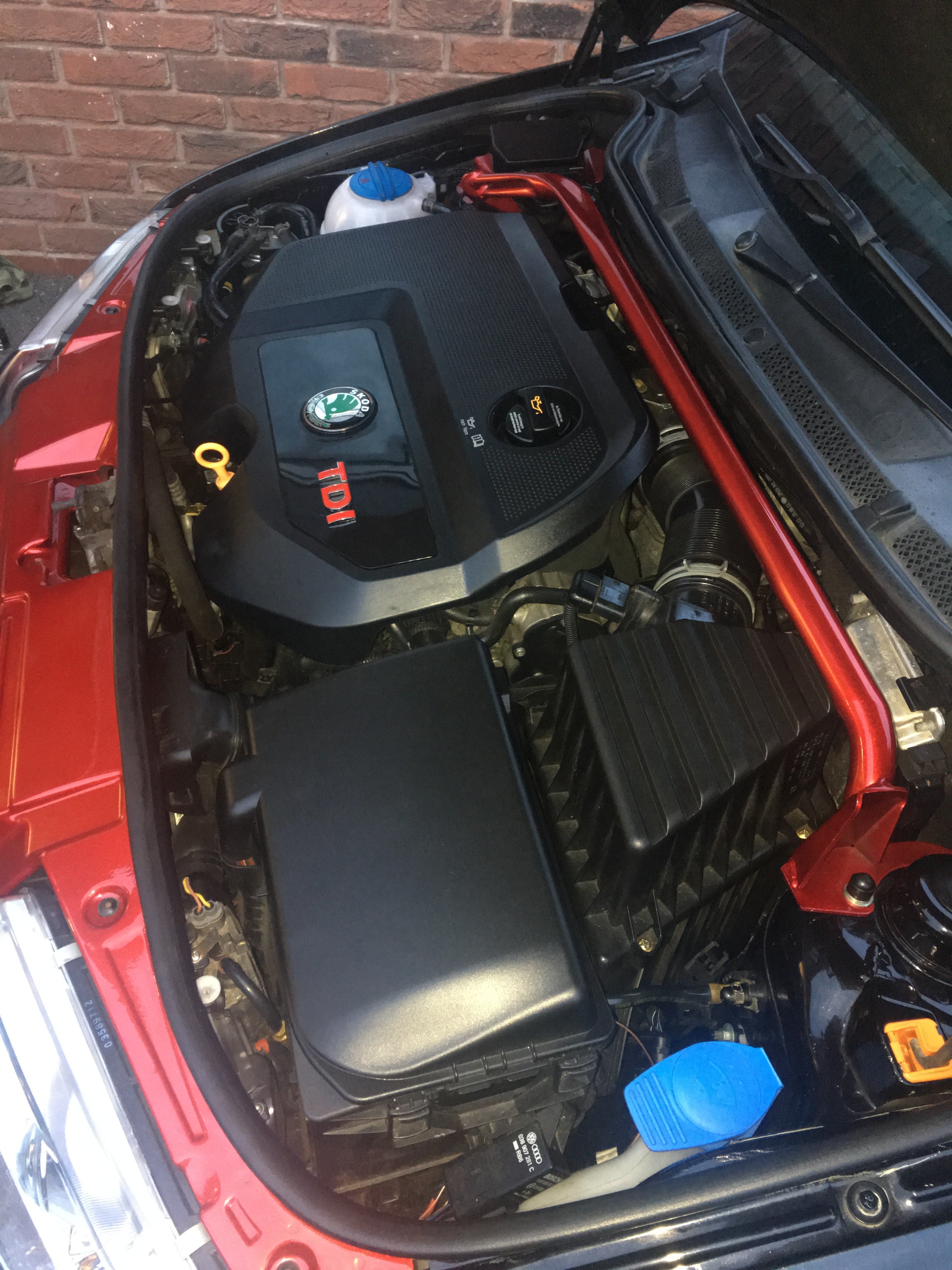

Done some work on the daily tonight. Fitted the strut brace and Vacuum box bracket..
Also fitted the slam panel..
And it's different for sure....

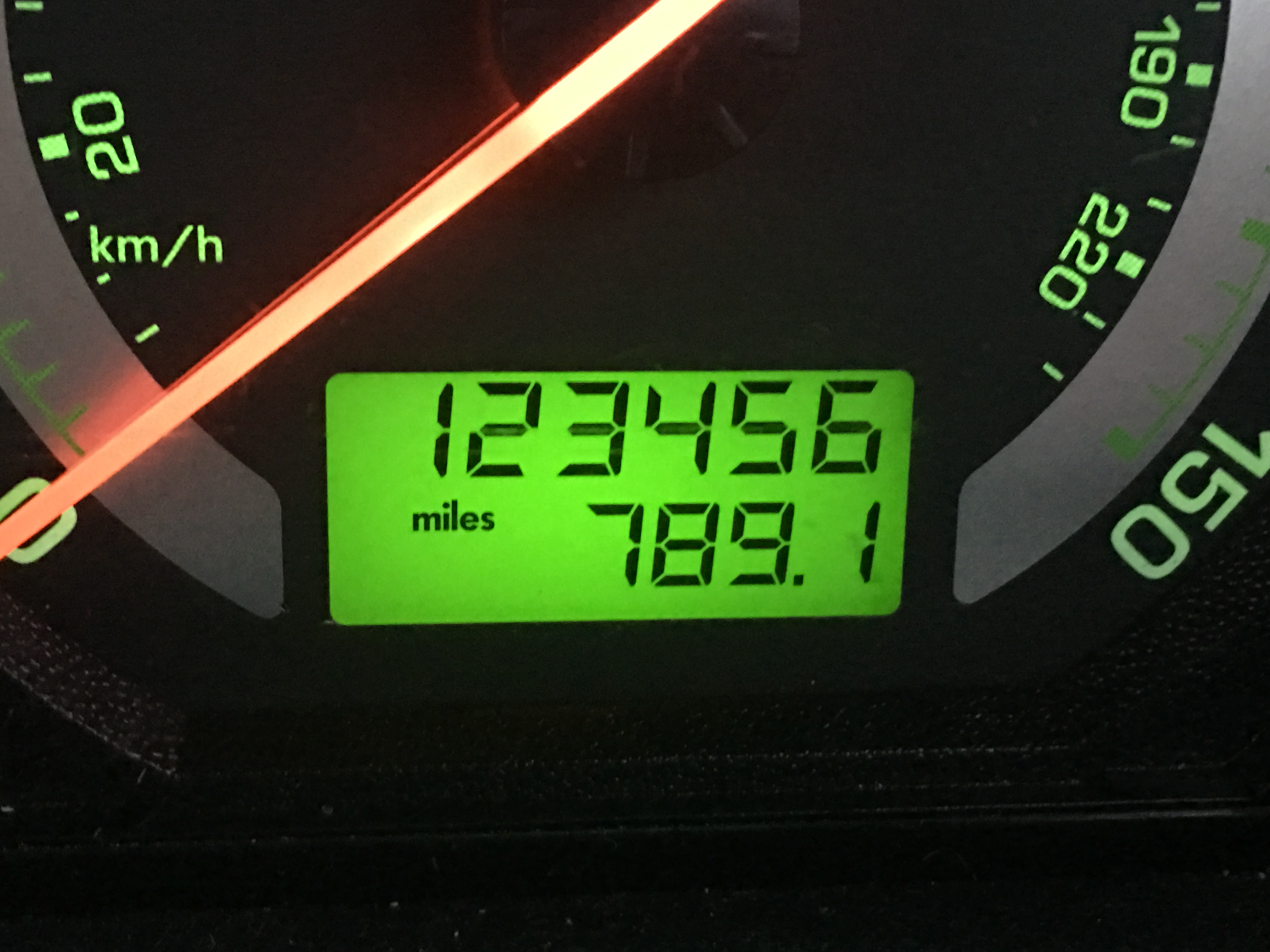

Another milestone...
Good effort ;)
Wow, good going. Must have taken quite a bit of calculating to work that out

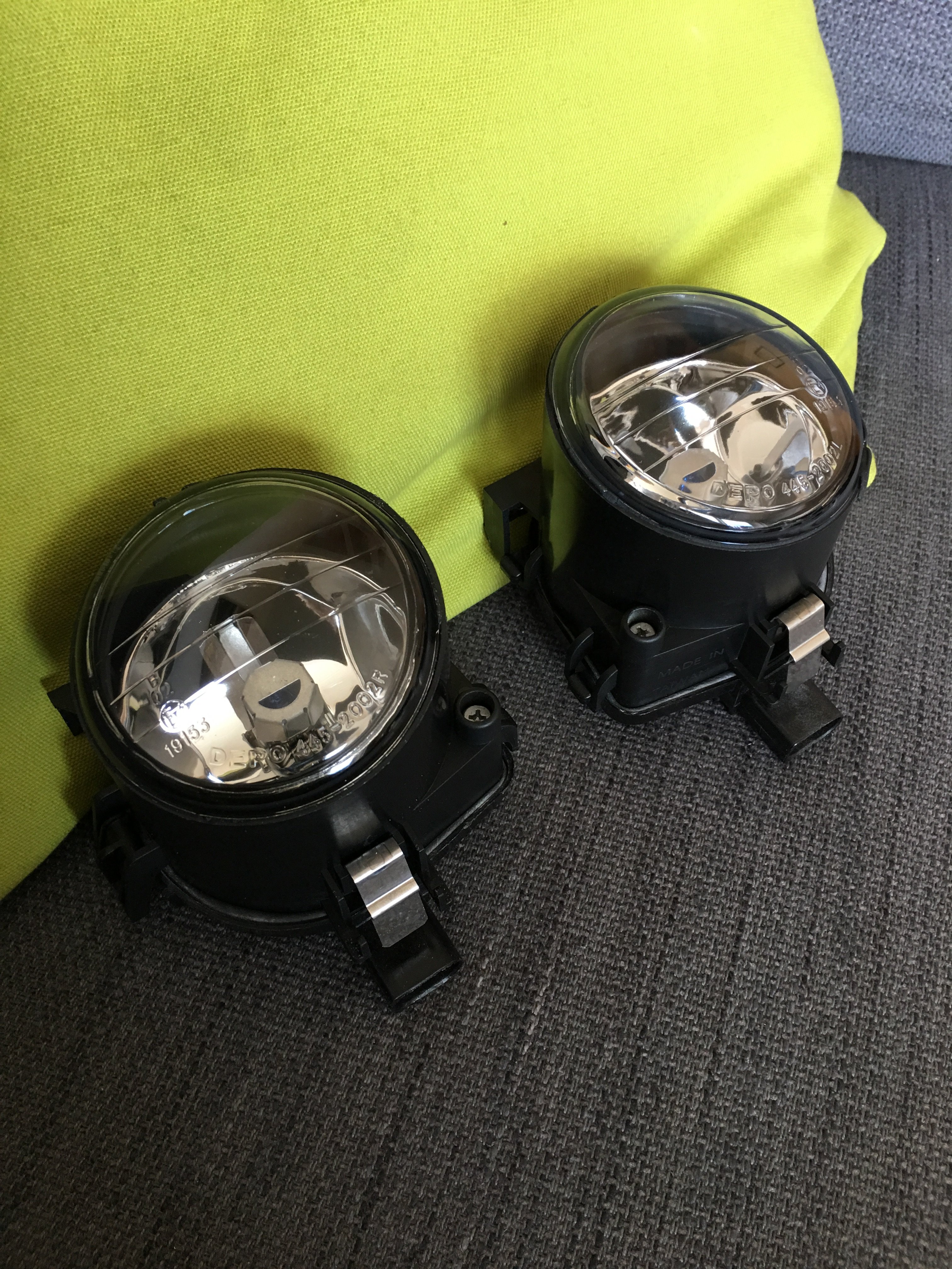

The fog light surrounds and backing pieces were so cheap it made no sense to repaint the old ones so Stu the painter did new ones of those for me as well.
New Depo Fog Lights to replace the old chipped ones.

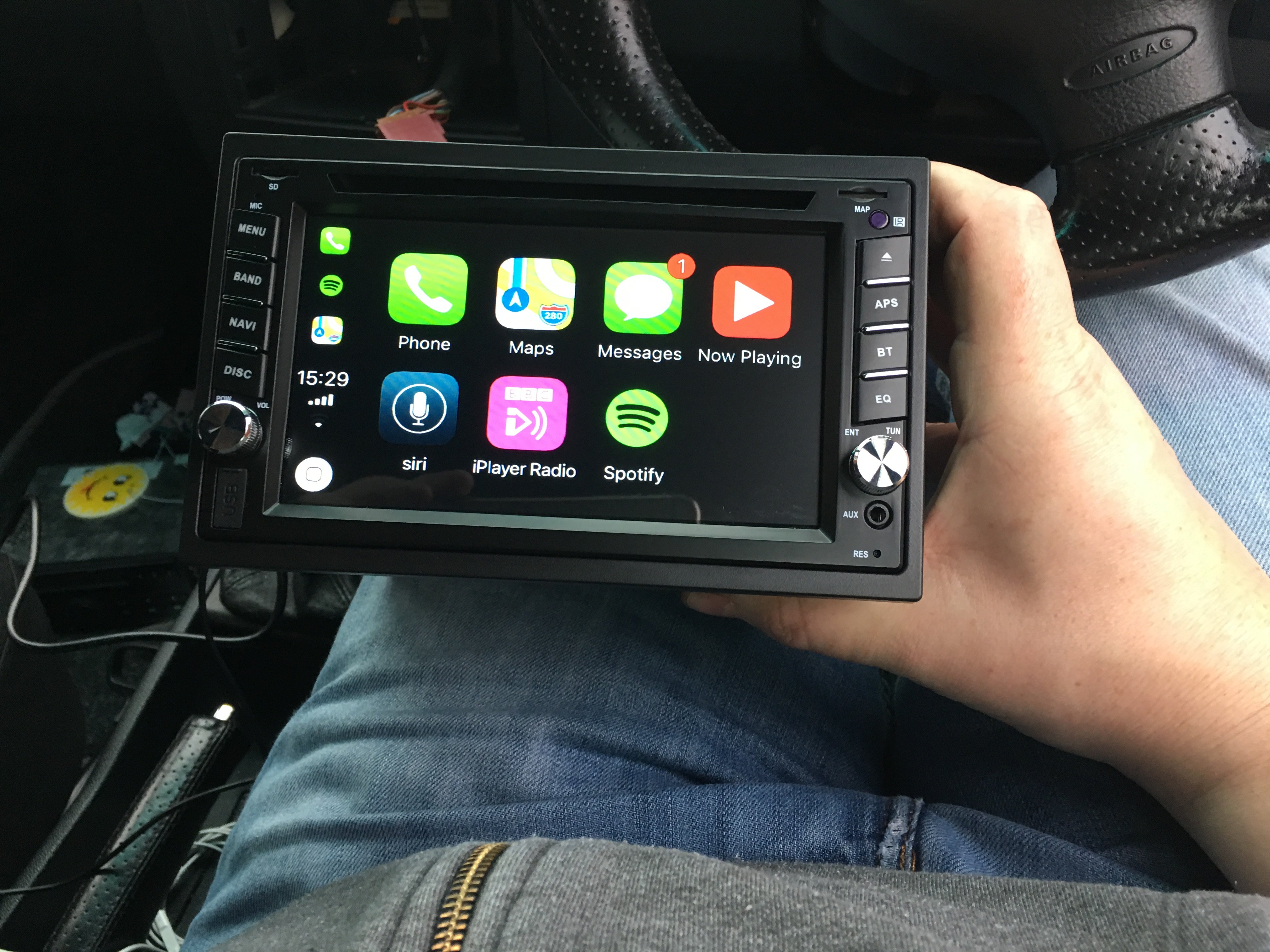

Before Christmas I was looking at maybe changing the stereo head unit in the car as the lack of Bluetooth and Spotify compatibility was hacking me off big time.

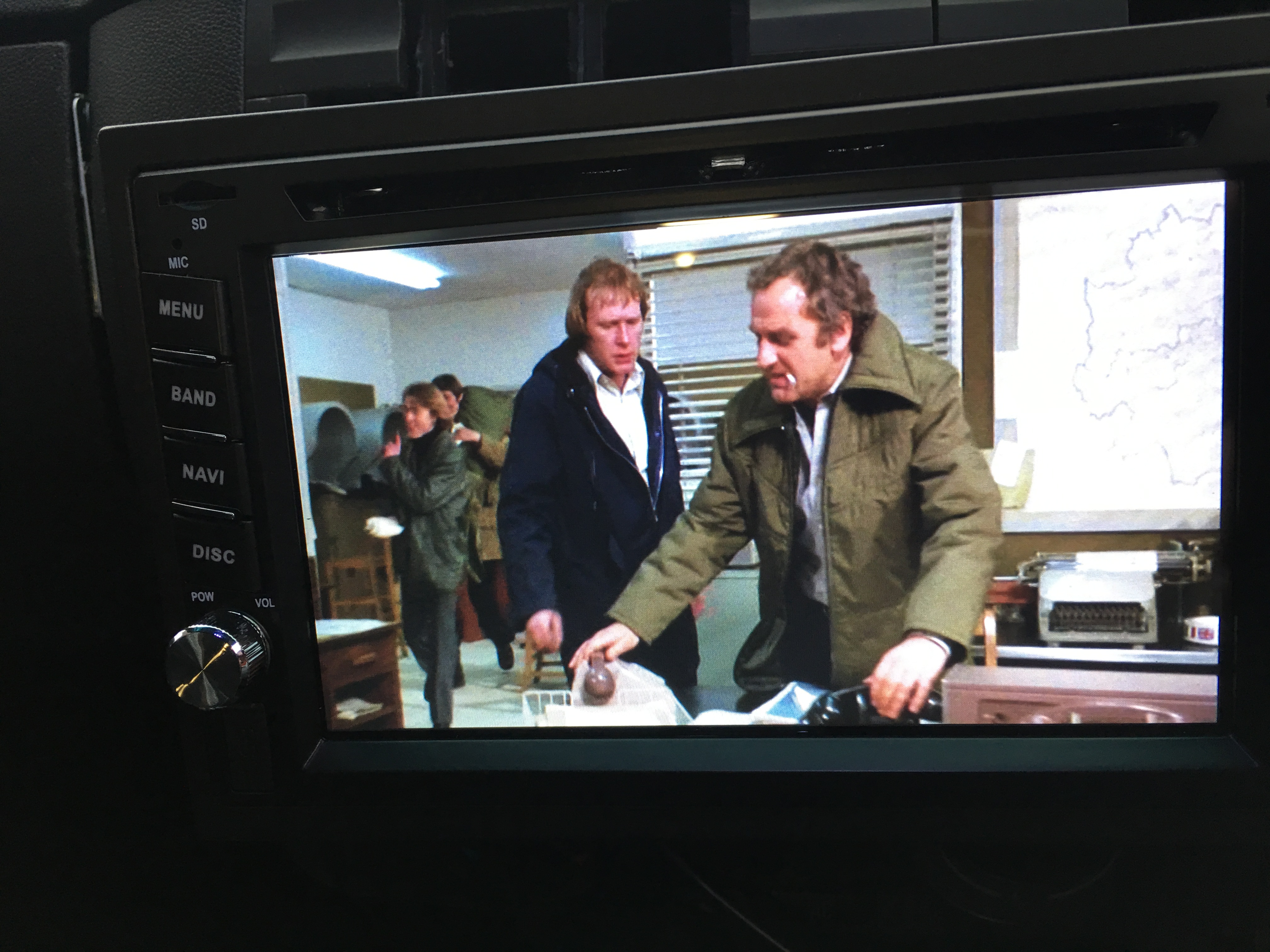

I took a punt on a Chinese apple car play double din head unit, reckoning that spending £500 plus on a pioneer etc one was overkill on such a cheap car, so a little over £100 got me this!
I’ve had to make a proper loom up for it and I’m waiting for an aerial adapter but it works spot on, it’s not got DAB but I can live with that as I only ever listen to Radio 2 on the “wireless”. The Bluetooth and Spotify control work brilliantly.
Its even got a DVD player for extra Sweeny moments lol
I’ll get some better pics when it’s all fitted and secure in the dash.
