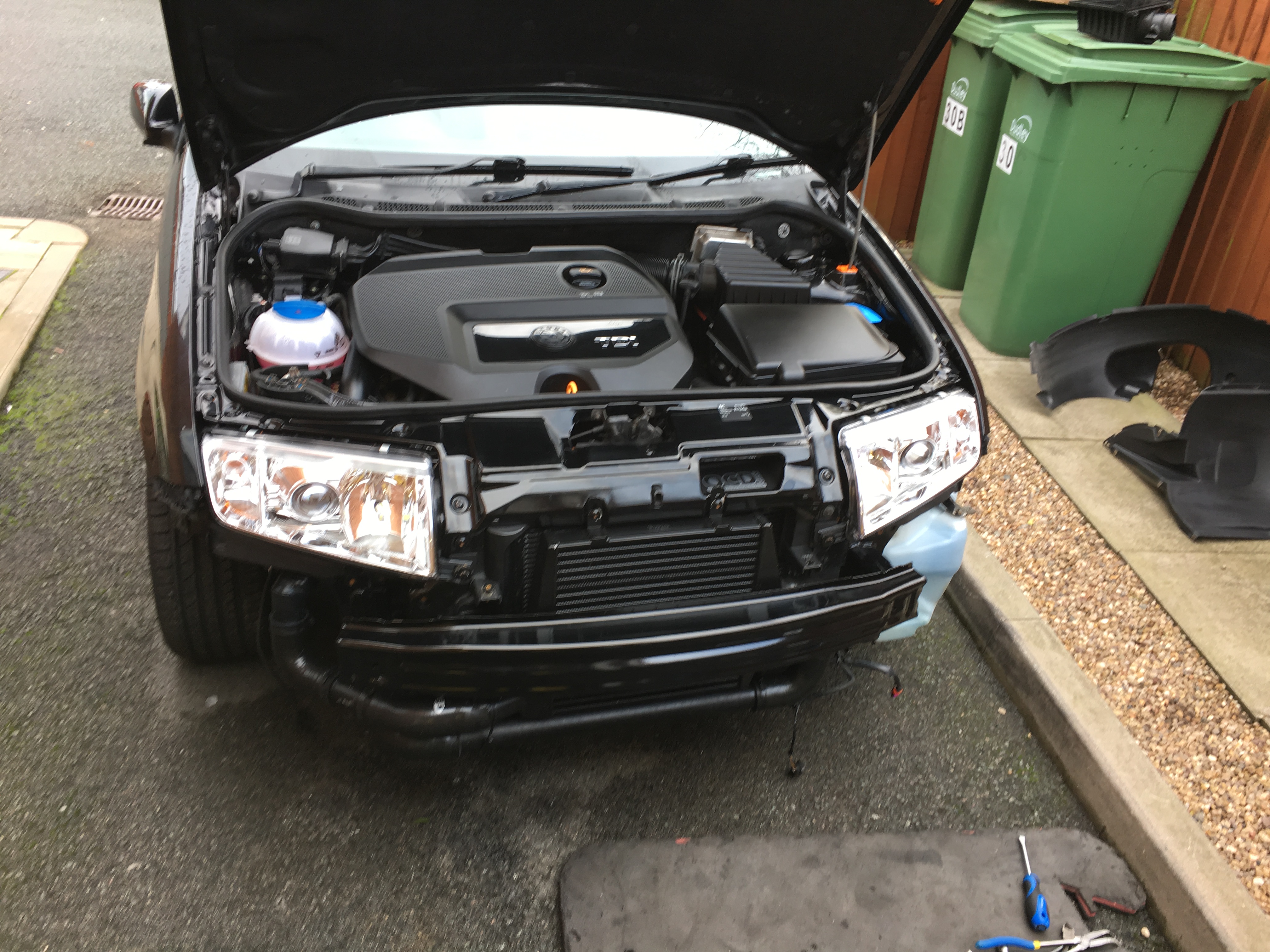

A very productive day yesterday, thankfully I've had the best help ever off a couple of mates for two days to break the back of the heavy work otherwise it's a lot harder work.
So, the engine and gearbox are now in, full Miltek exhaust and downpipe fitted and new fluids throughout. New genuine coolant expansion tank and cap and fresh G13 coolant.
Took a while to start, fuel filter was empty but fire up she did, noisily as there's no air box on at present.
F2241CB7-00A7-4C25-876A-E2283DE5511F_zps
Fitted all the front panel, new radiator and AC condenser rad, all new hoses and clips as well as the old ones were beyond scabby.
Newly powdercoated slam panel and crash bar went on
3212BDD9-FE7F-4B0B-9D53-506DC6B6B345_zps
Ran her up to temperature, bled the clutch again (that was a pig to do) and shut her off for the day.
Next jobs are fitting all the air box back in and intake pipes, replace the battery box (broken naturally) and then give it a monster clean under there. Scuttle panel and wiper arms are coming off as there's tonnes of leafs and debris under there, than can get the arch liners and undertray back on.

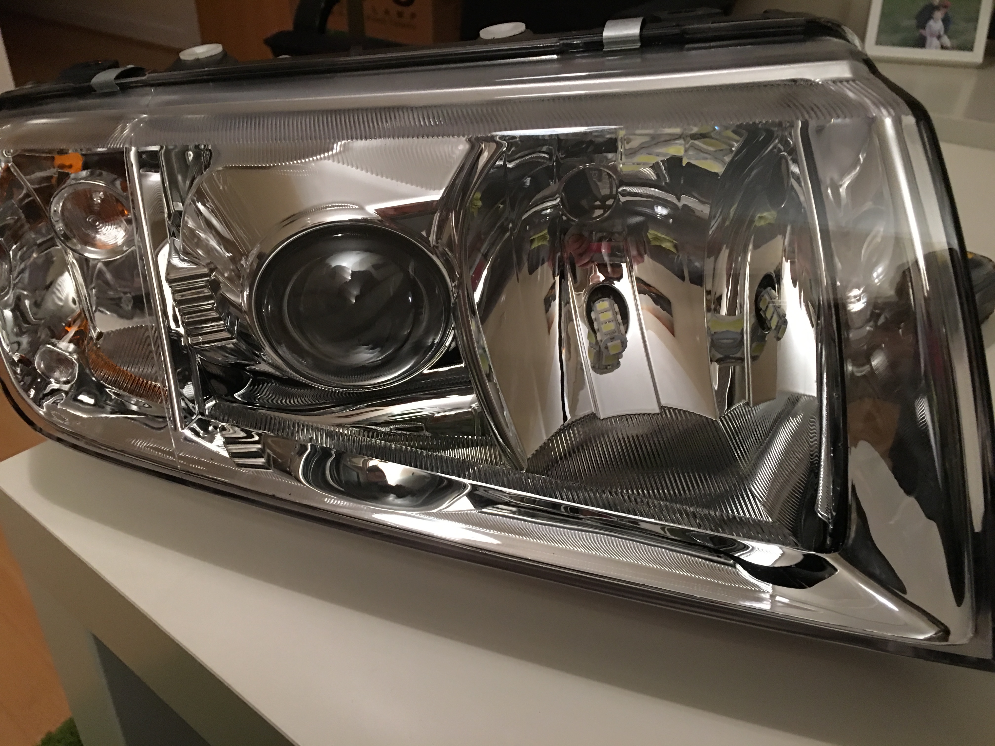

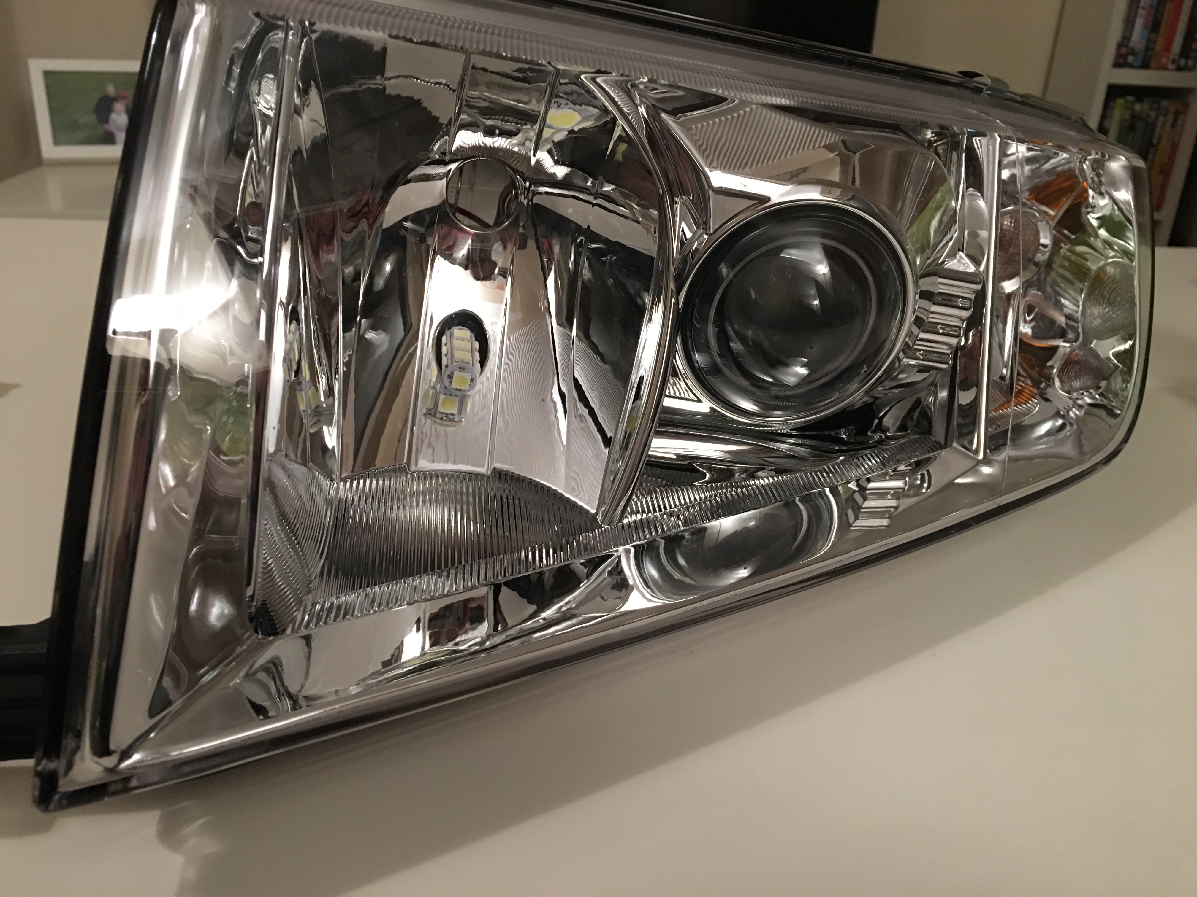

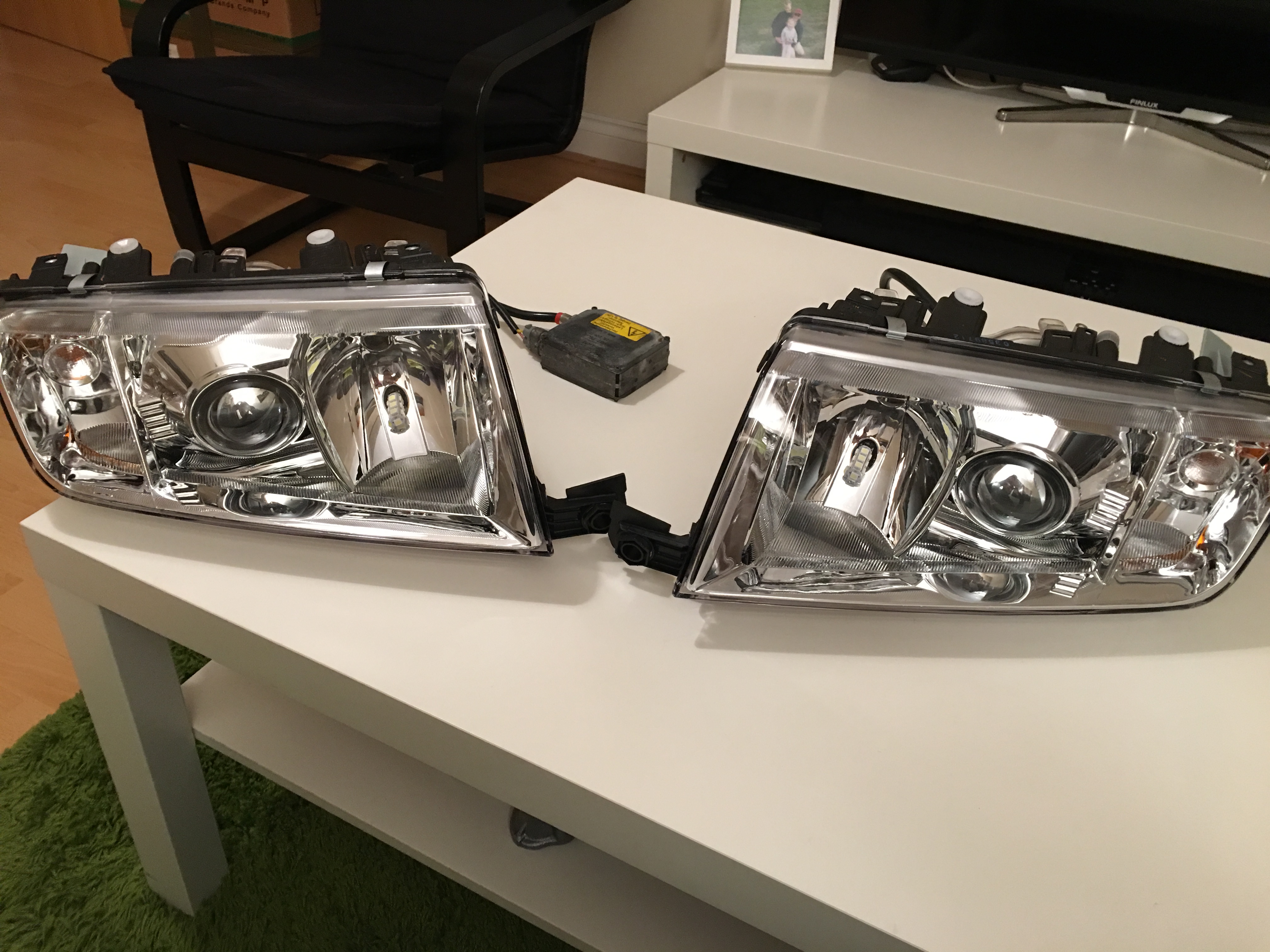

Headlights are being split and repainted, new headlight backs are on order at TPS as they're also broken, then its ready for some paintwork.
I'm on the hunt for a passenger front wing, must be mint and ideally black (give me a shout if you know to one please)
More pics when its looking prettier!!

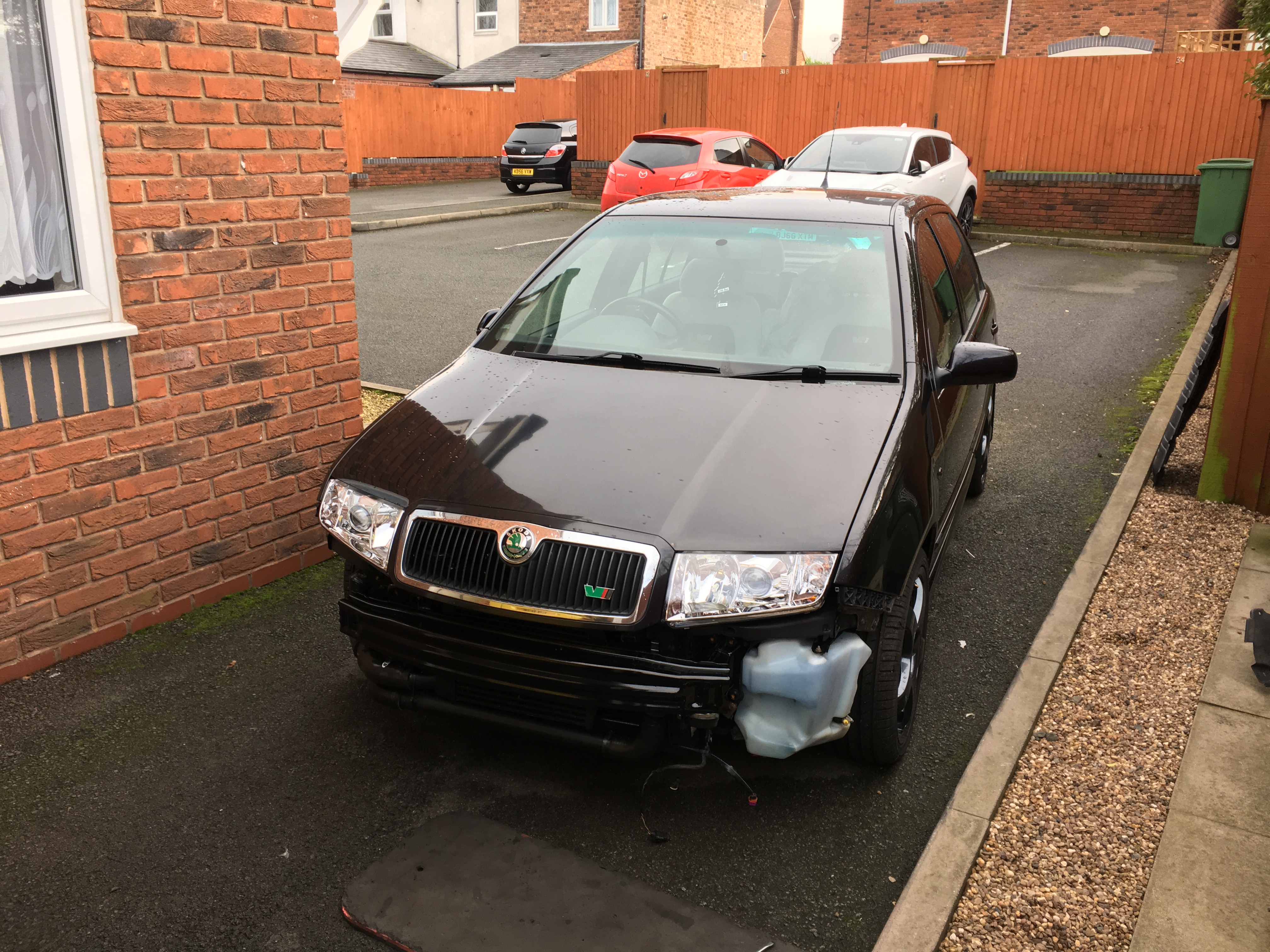

Progress has been very slow of late with this one. Plan was to finish it and let the missus use it as a daily, however an impending carrer move has necessitated it being pressed into a high mileage daily commuting car for me!
I'm starting work with a new employer on March the 1st and will be covering 25k miles a year in commuting so what better to use than a 12 yr old Skoda...
So, best get it something like finished. I took the plunge and sourced from Hutchy on here a proper set of RHD OE spec xenon lamps, they came yesterday so I built them up tonight with new long life orange VW indicator bulbs, some new Osram D2S HID bulbs and some 12SMD LED side lights.
I need to swap the screenwash tank from this one to the yellow one as they are both the same spec 5 litre Xenon washer/screenwash tank but the one on the black car already has the fitting where the meth injection draws fluid from.
Once that's done, I'll replace the NSF wing as it's dented and send it off for painting.
Get it out back together then all I need to do is a monster detail and a few silly jobs.

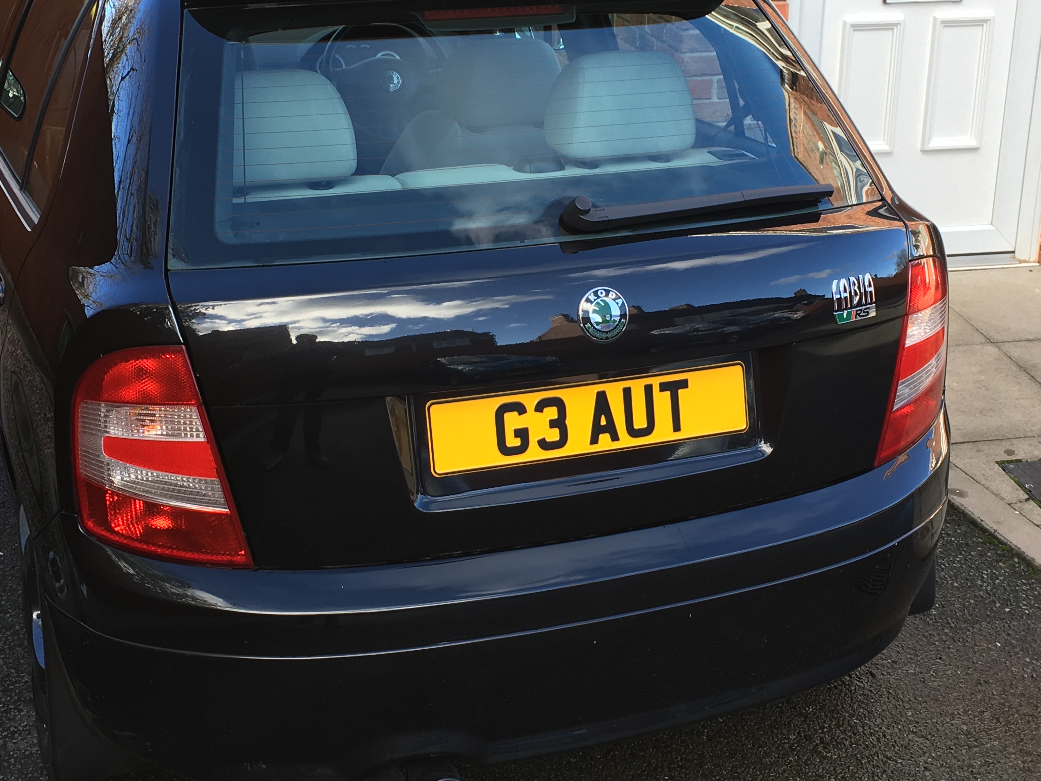

The paperwork for my private plate has gone off so I've fitted that in anticipation.
The plate was one I bought donkeys years ago for my old detailing firm, G3 Automotive, hence the other car having a G3 plate as well, this ones been on retention for the last 11yrs lol.

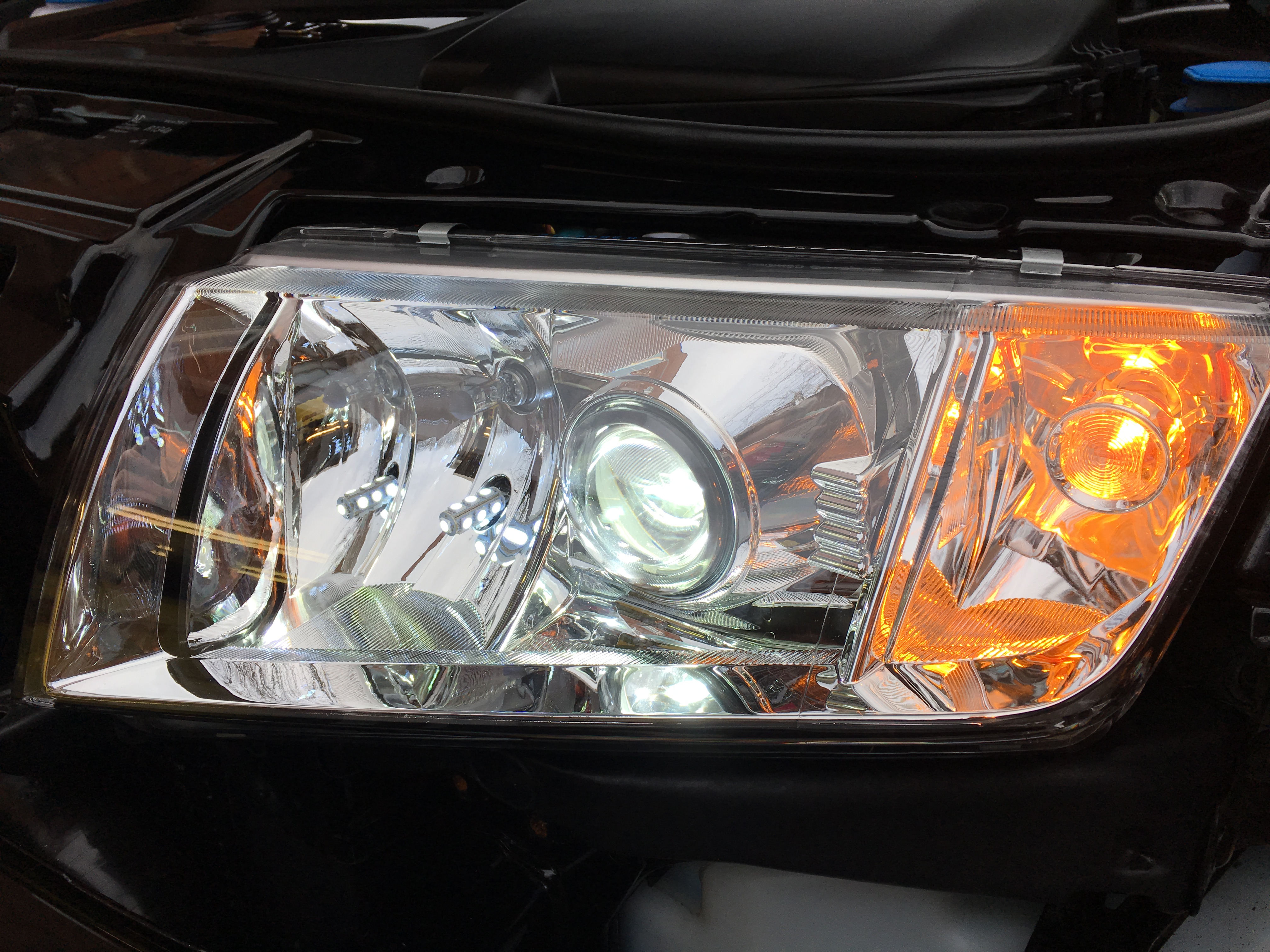

I fixed the screenwash bottle, and fitted the brand new Xenon headlights.
Osram 5500k DS2 dipped beam bulbs, multi SMD sidelights and some 80w osram main beam H7 bulbs
