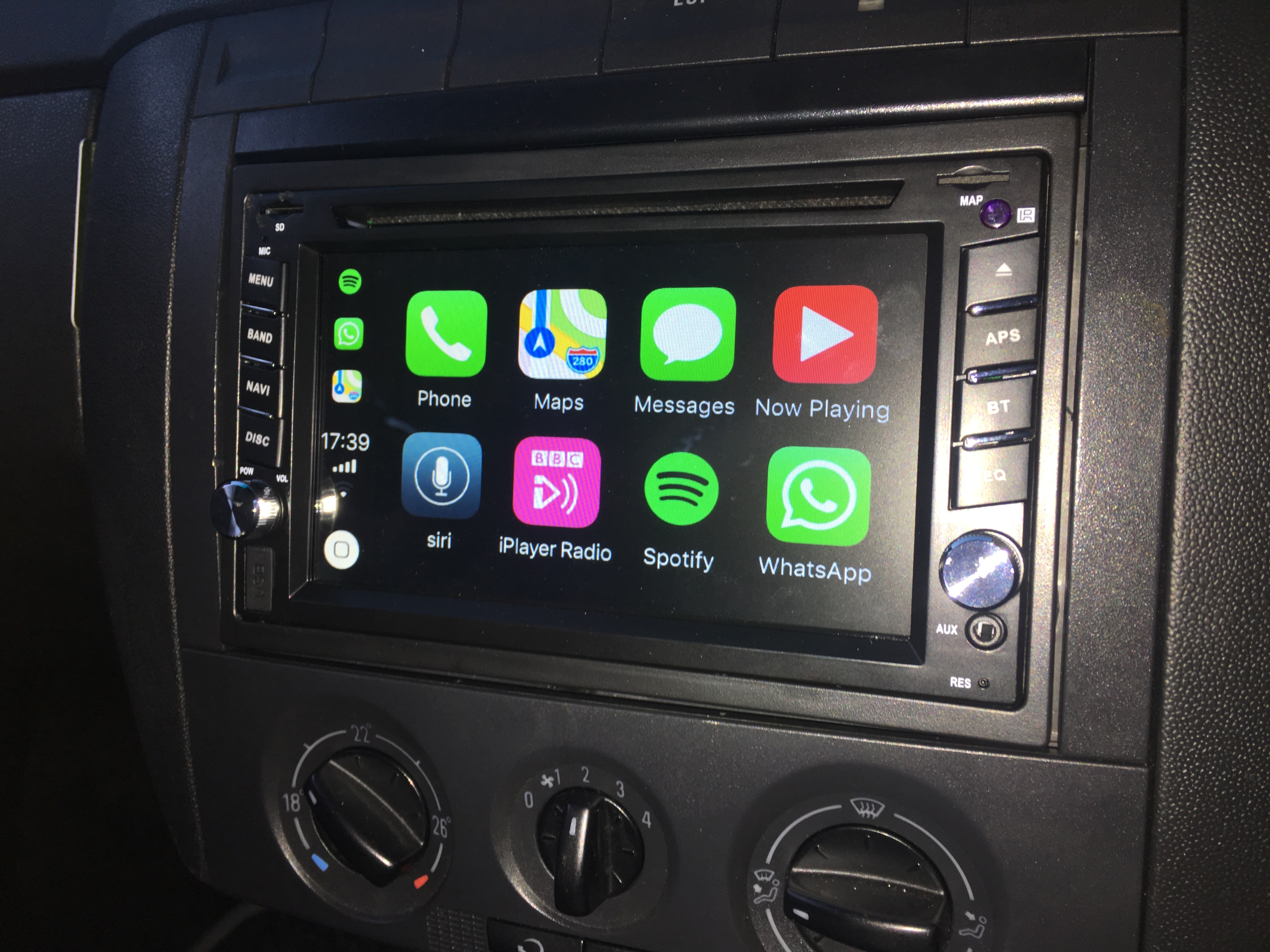

Finally fitted the Apple CarPlay head unit, works well, looks modern and has all the functionality you could ever need. Very pleased for the money.

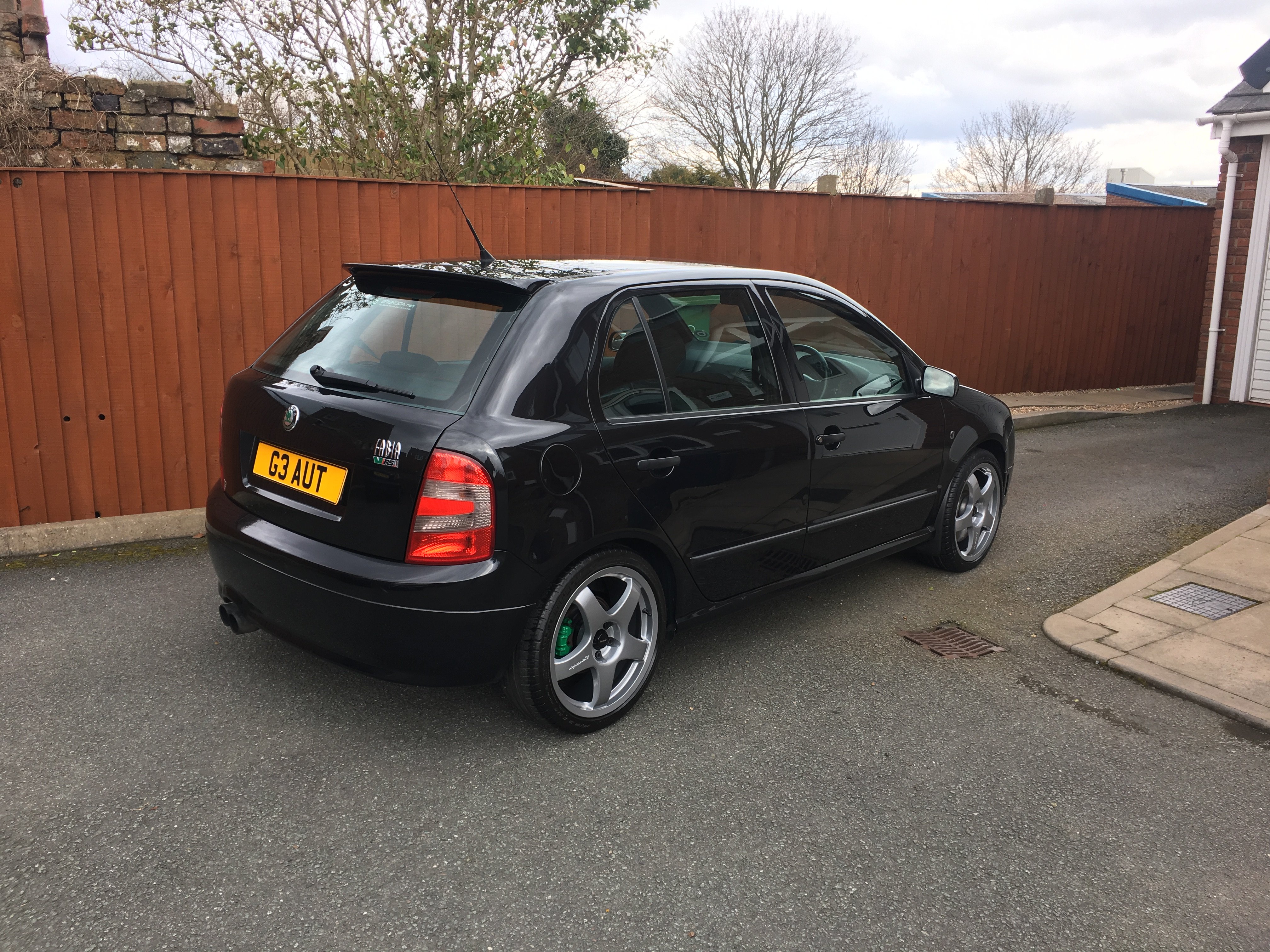

Car is fast approaching 140k service in the next few weeks, other than that still averaging 51-53mpg week in week out, some weeks doing nearly 1000 miles.
Waiting for the weather to improve before refitting the refurbished Prorace 3s in silver with summer tyres.
Nice bit of kit the apple far plays.
Ive yet to fit a Pioneer avic-f88 dab to my vRS.
Just got a defent dab aerial to put on the far first.
Enjoy!

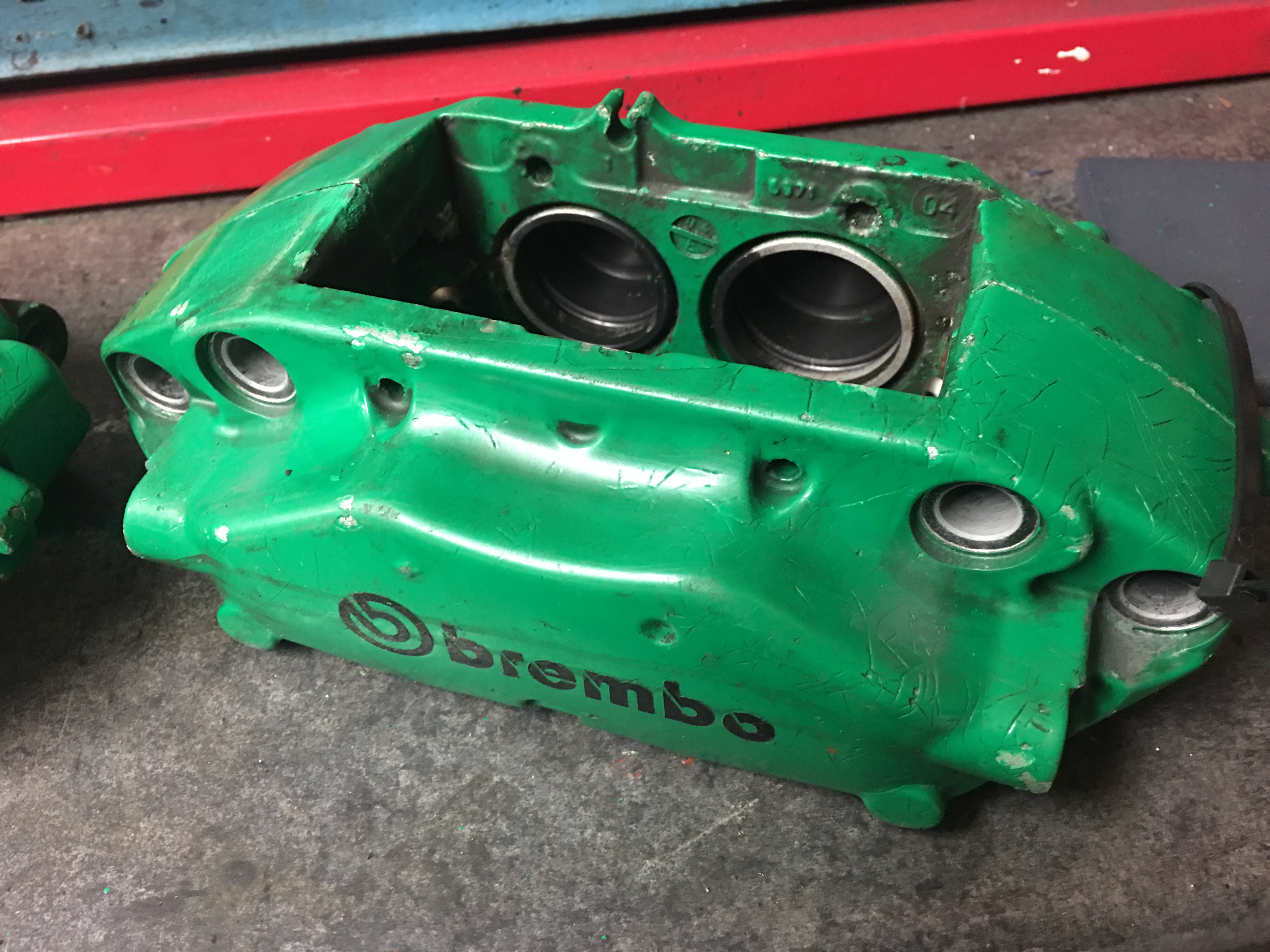

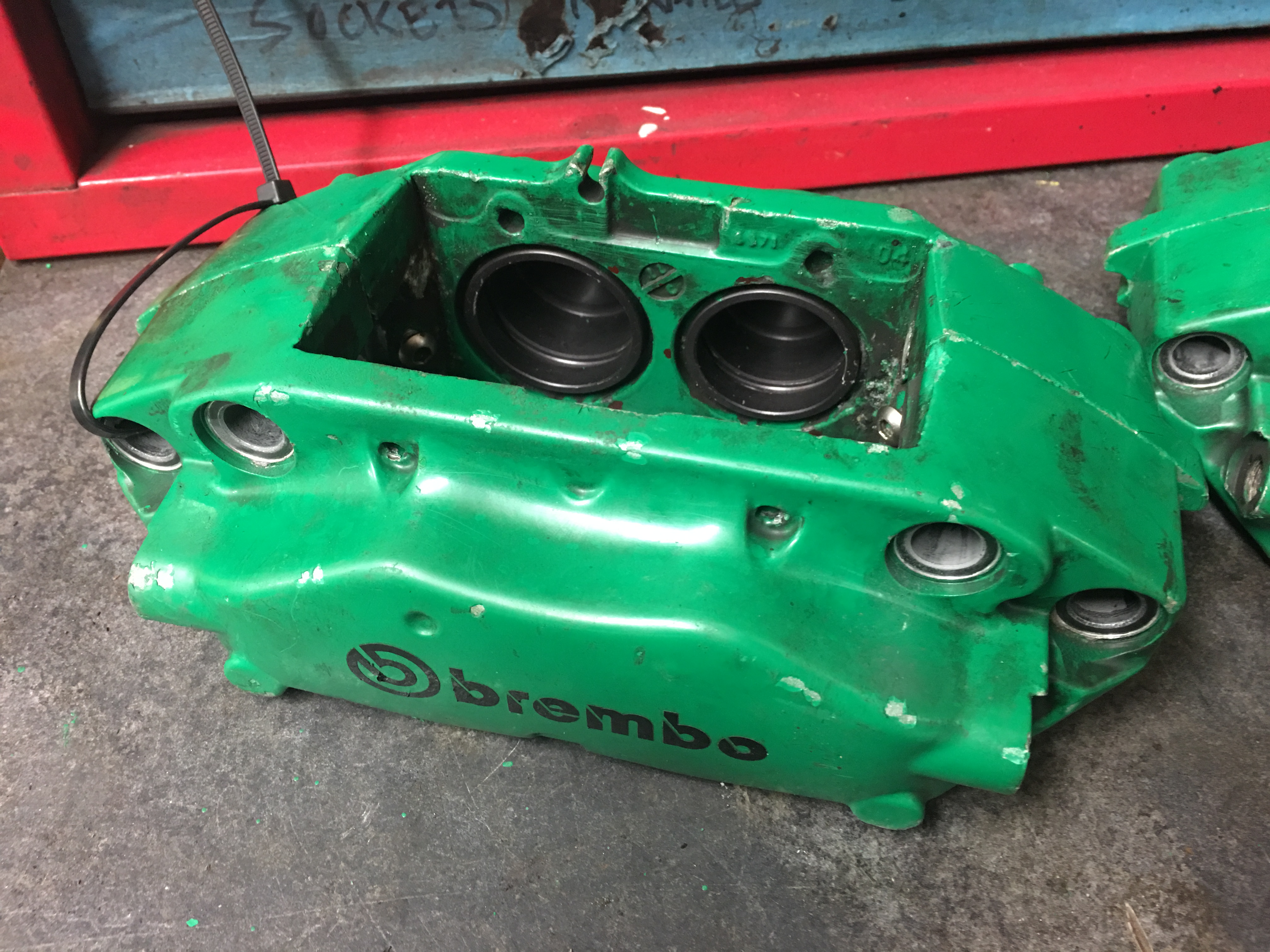

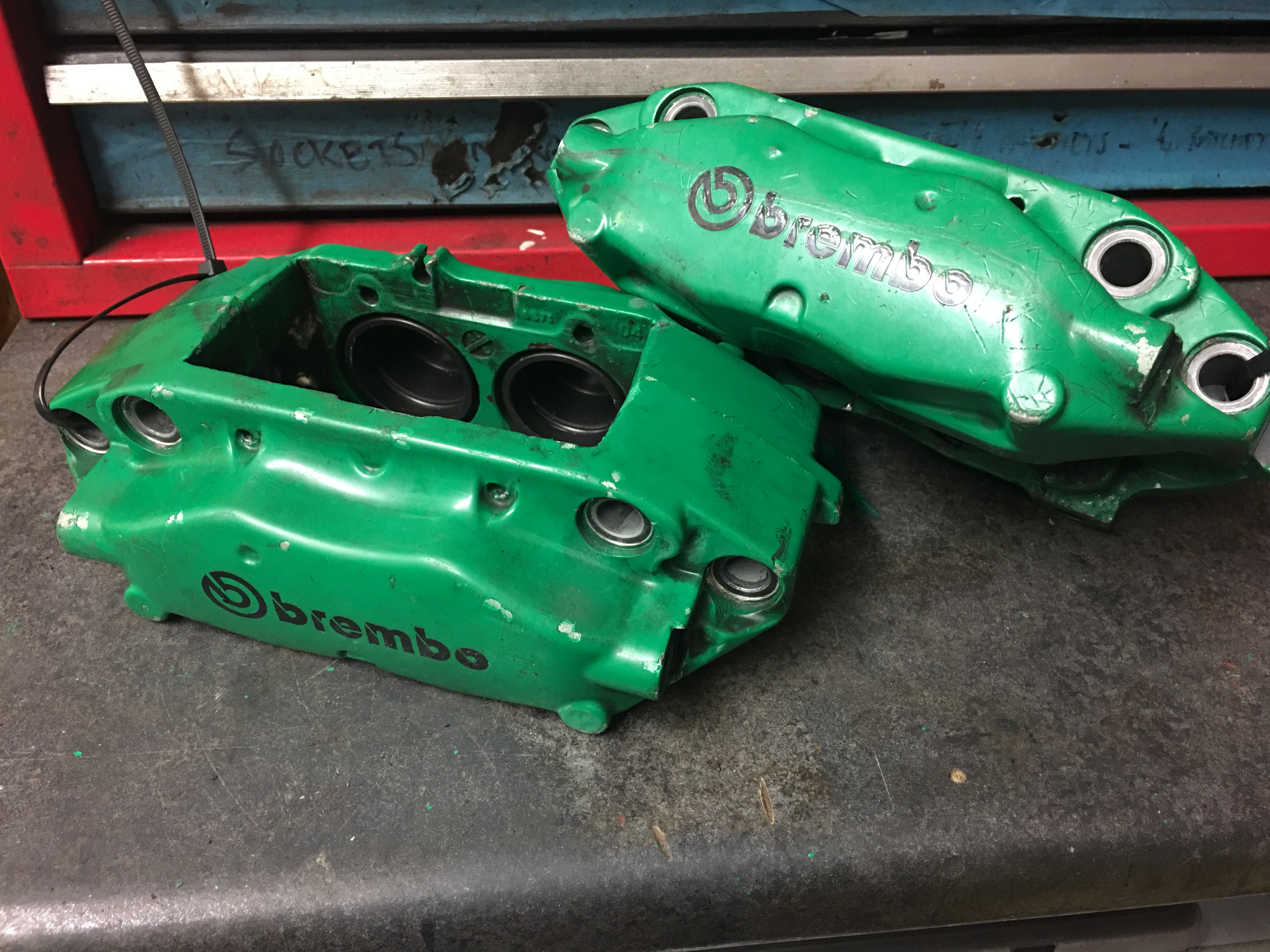

I’ve been collecting the odd bits here and there as times gone on, and I acquired a set of SEAT Leon Cupra 4 pot Brembo calipers/brackets/ 323mm discs a while ago.
I have stripped and derusted all the brackets in Bilt Hamber’s amazing Deox-C and they’re all painted up and ready, but the calipers needed some attention. They have been powder coated before but it’s not lasted well, so I have stripped every part of the caliper apart, split them into their halves and they’re off to be powder coated the correct Mint Green as the Porsche Cayenne 6 pots have been for the yellow G3 Fabia.
Every bit of hardware is being replaced, pistons, seals, dust covers, caliper joining bolts, link pipes, pad support plates, new HEL braided lines are here and some Ferodo DS2500 pads are ready to go in.

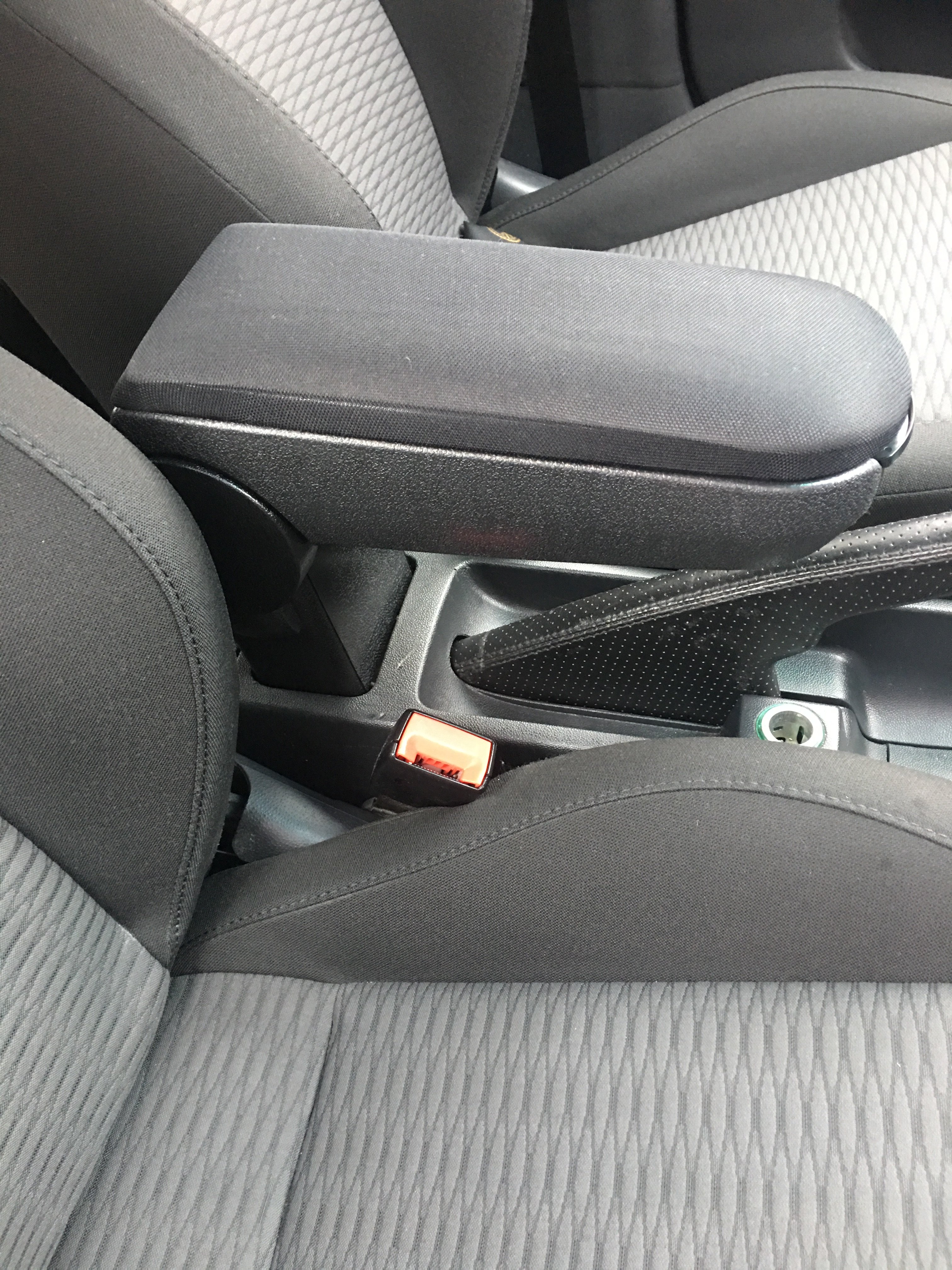

Comfort upgrade time!

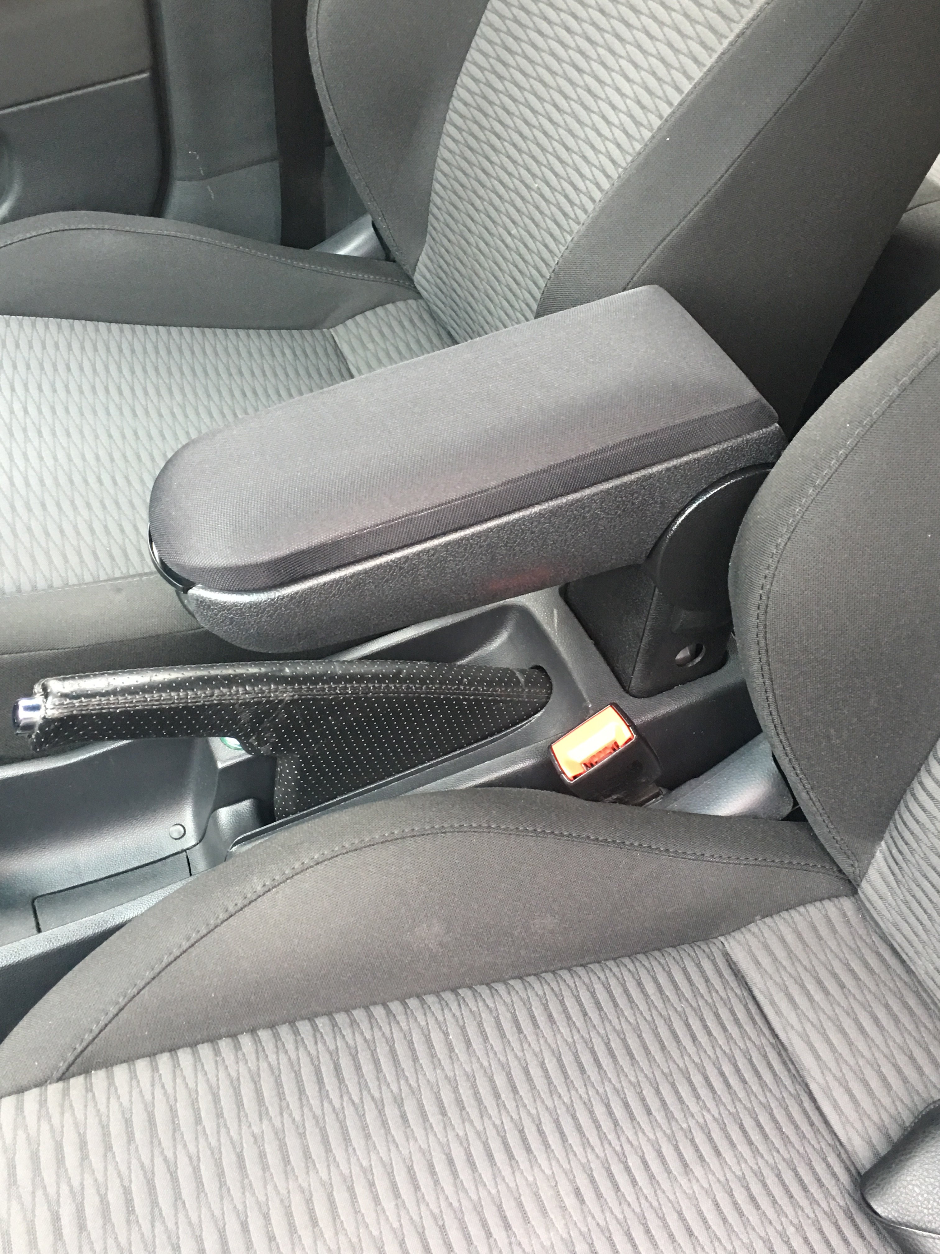

Having had cars in the past with centre armrests for the front seats, I found the Fabia a bit lacking in that area, so I bought some brackets off SeanW on here, a complete new golf mk4 armrest kit and set to work. Not too bad a job but the car is so much more comfortable on the long daily drive, possibly the best value mod I’ve ever done!!!

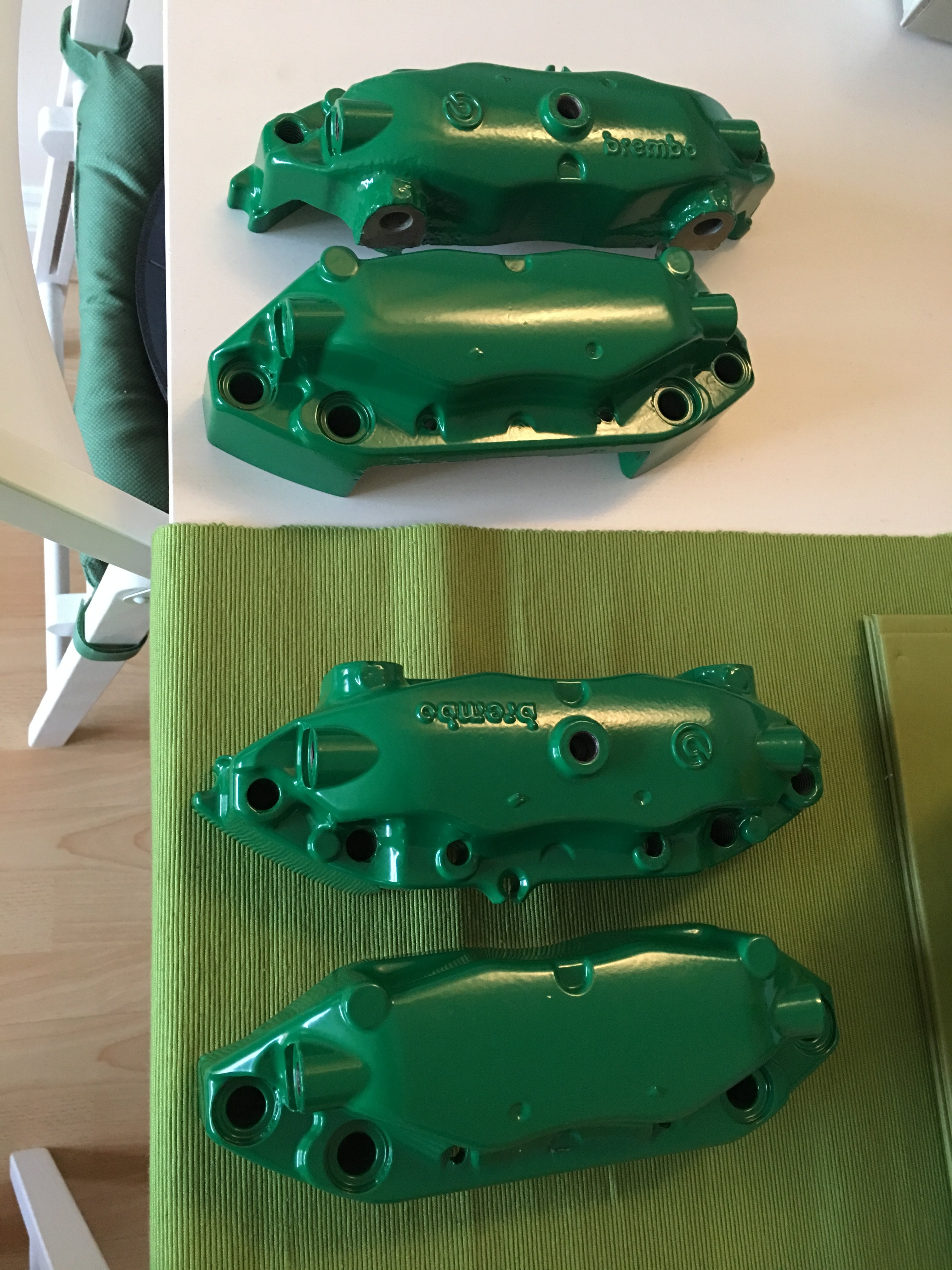

Collected the powdercoated Brembos up yesterday, done in mint green (RAL6029).

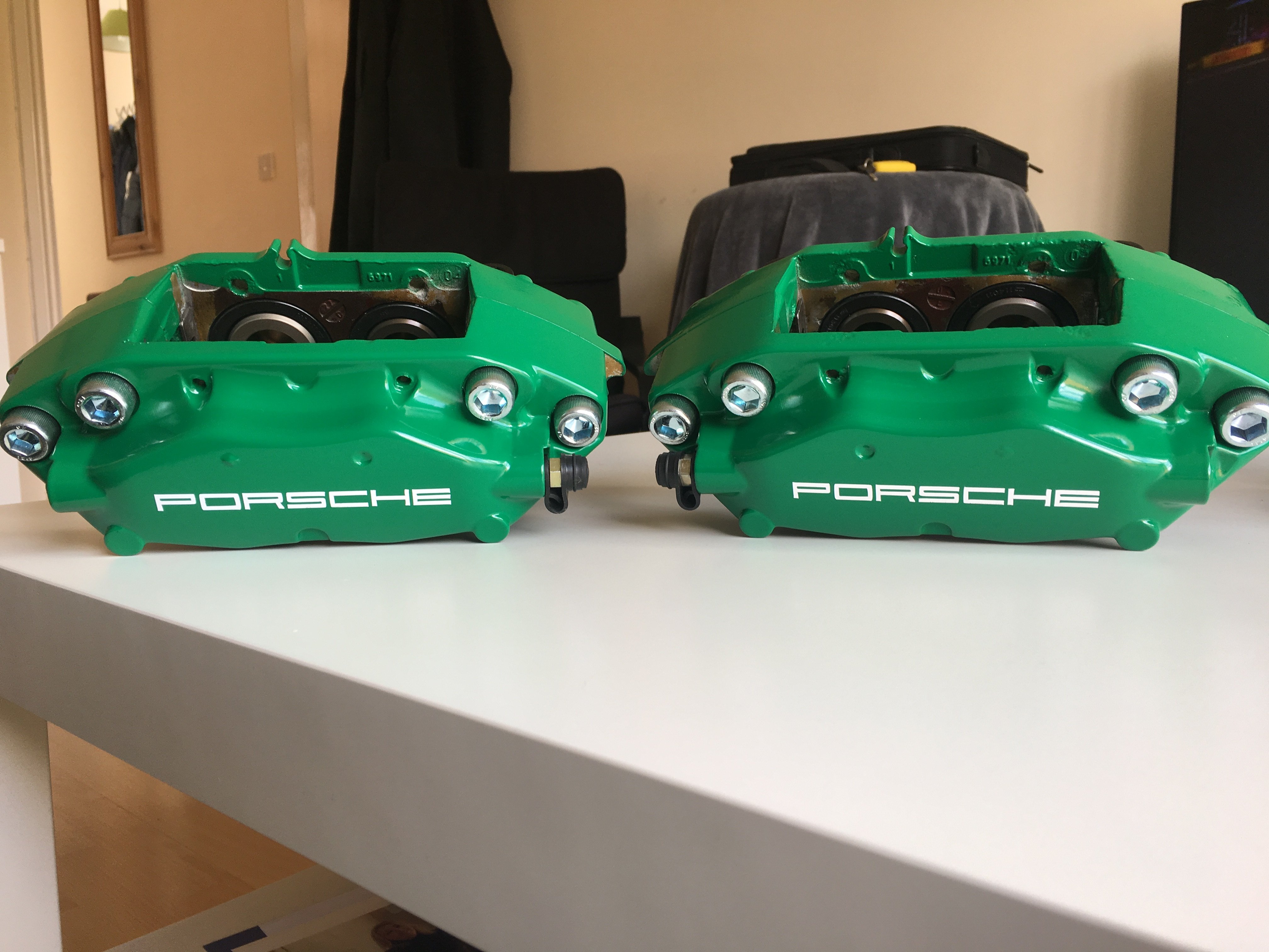

Had a nice hour or so today building them back up, used all new internals, seals, dust seals, pistons, wear plates, bleed nipples
Even put some stickers on to annoy our fellow group chat member - plus it’s kind of a homage to the monster Porsche calipers fitted to the Yellow G3 Fabia project lol
Got some new Ferodo DS2500 pads to go in and I’m trying to source a set of lower link pipes as the ones I’ve got are miles too big!

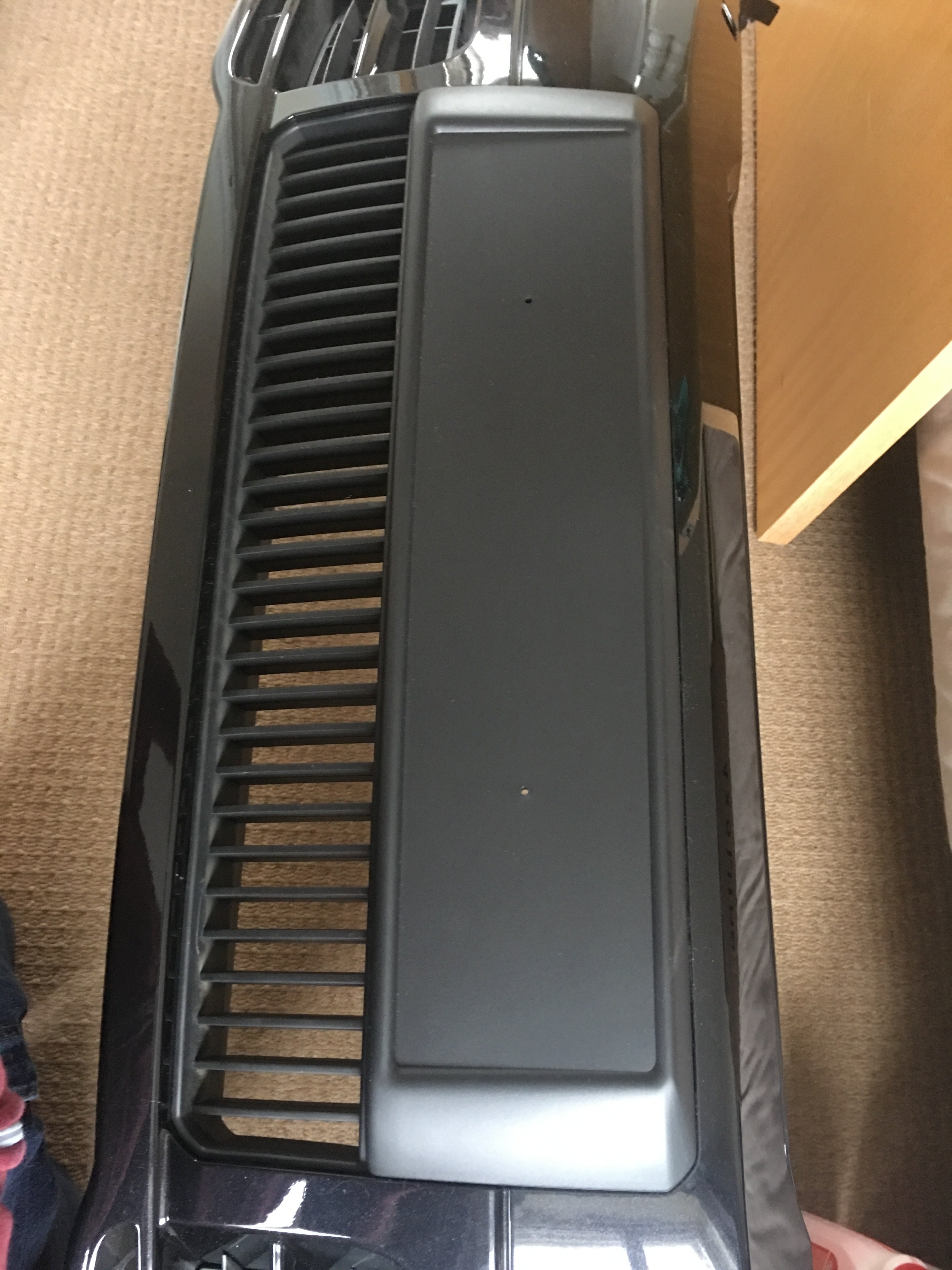

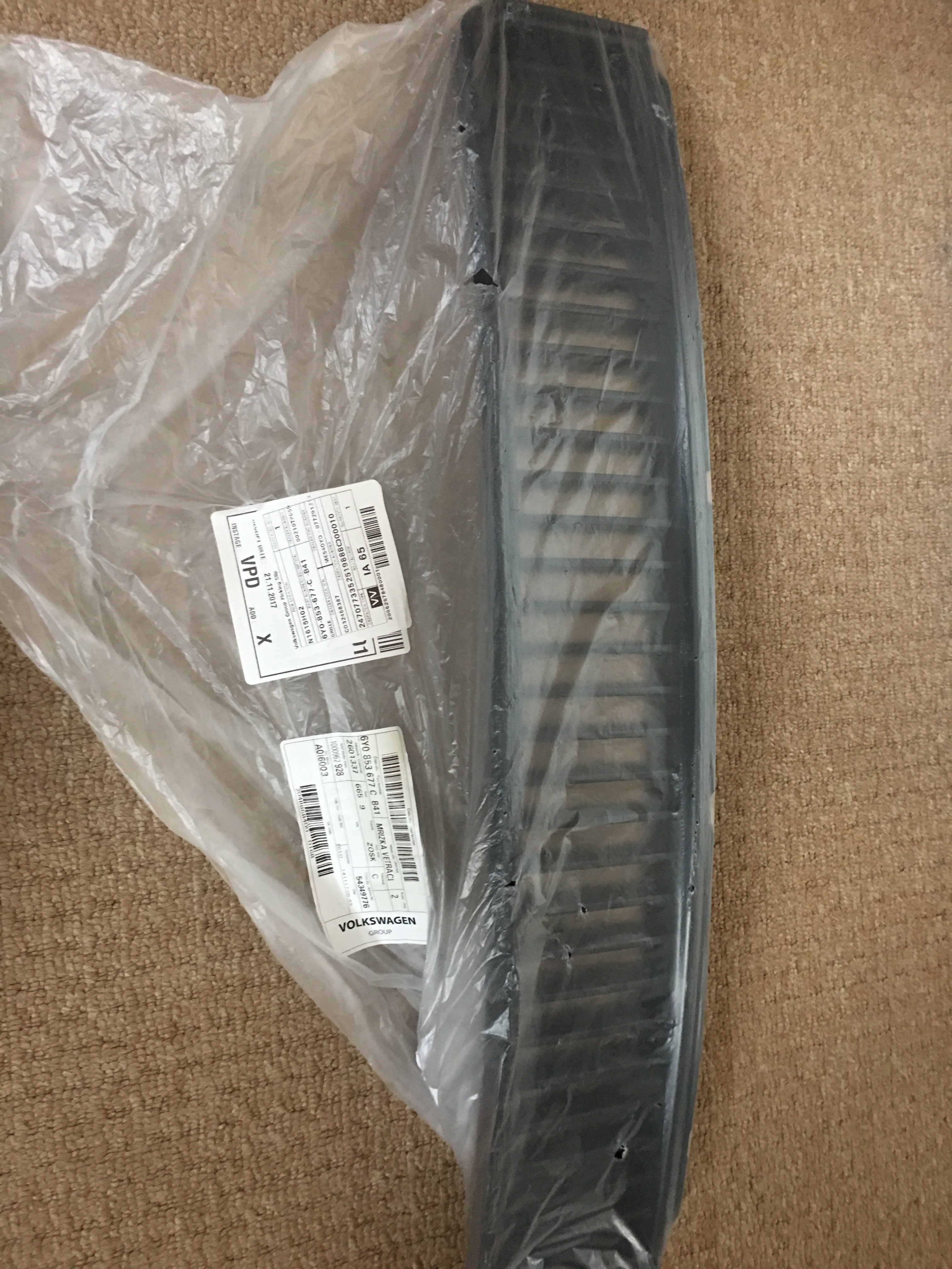

I’ve STILL not got round to fitting the brand new bumper, stuff just keeps getting in the way, anyway I’ve said before I’d had a brand new genuine bumper painted, well this weekend I’ve got the rest of the bits to finish the bumper off, namely a new number plate plinth and new lower grille.
I have had in “stock” for a while a very very clean plastic rad support panel as the one on the car has some crusty threaded inserts which have ripped out so I’ll be fitting all this at the same time, however one useful mod is concerning the lower front bumper three fixing points which are a pretty flimsy push fit spread rivit type affair, so I have drilled out the rad carrier holes to 9mm, fitted some M6 Rivnuts to it so I can bolt the bumper up solidly from underneath, didn’t get pics of that yet though!
more soon

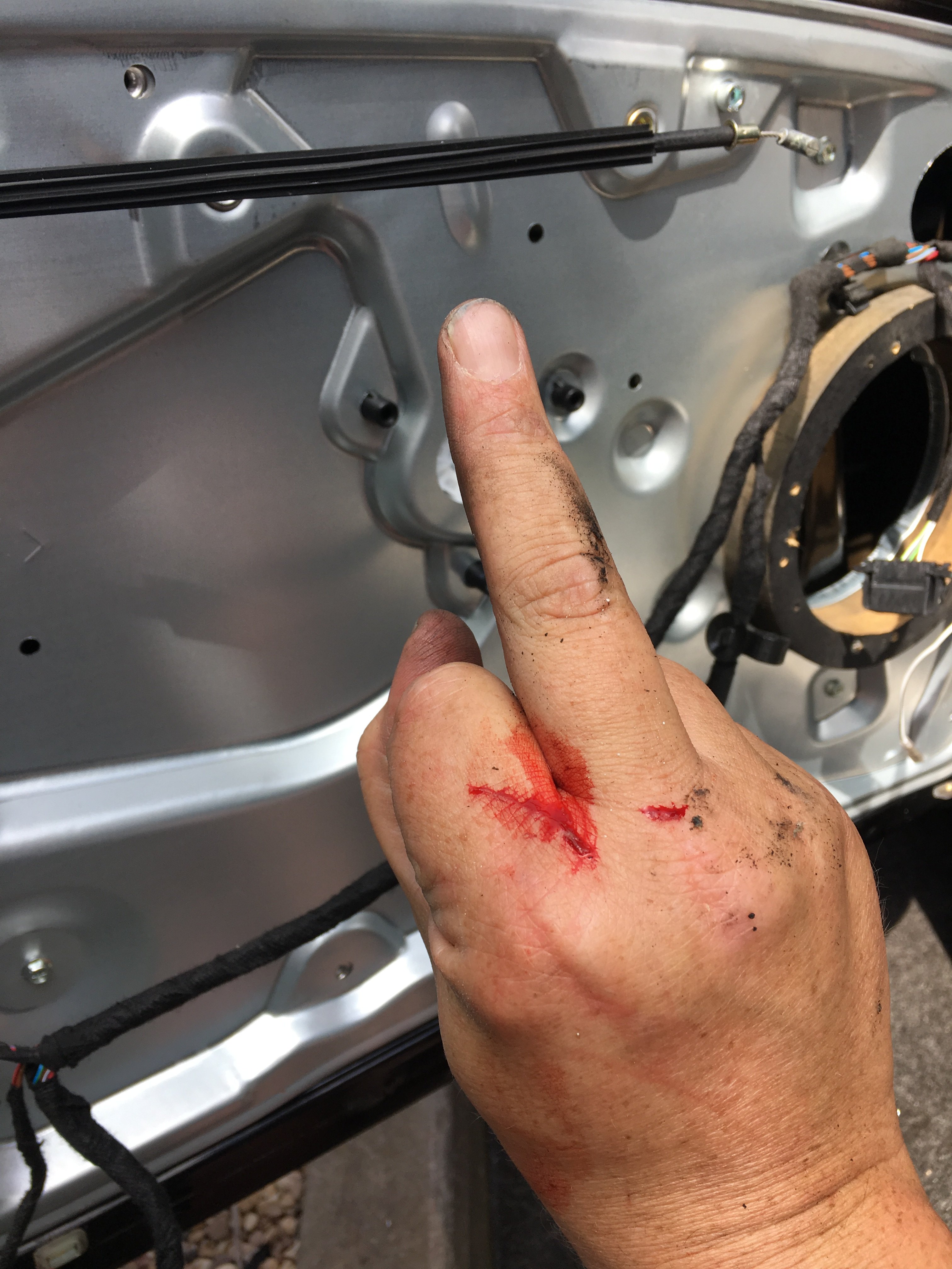

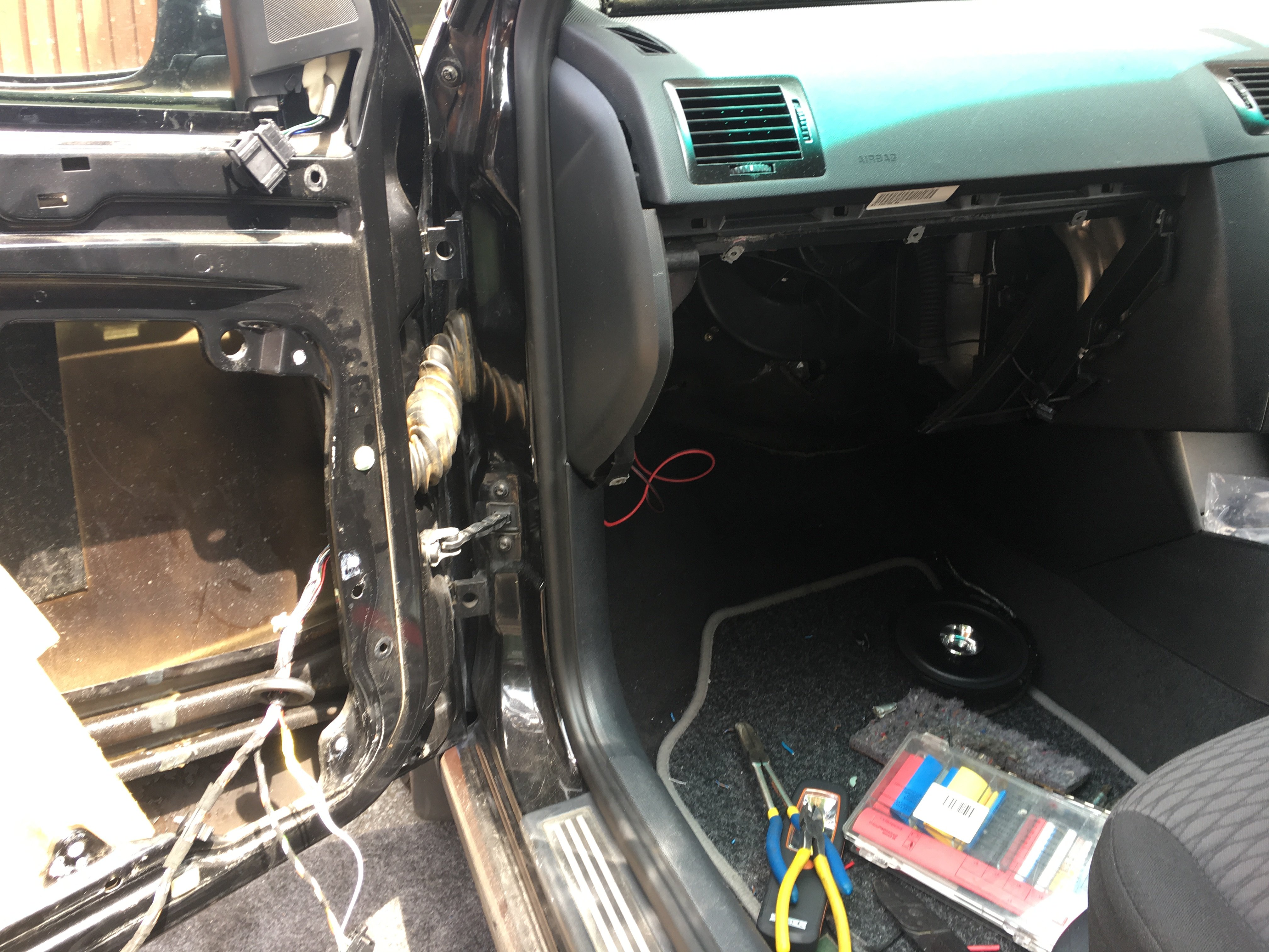

I felt obligated to do some repairs to the long suffering daily beater, approx 4 weeks ago the passenger window regulator decided to eat itself as they do so I’ve been rocking the “length of timber” holding the glass up for weeks. I sourced a new regulator and decided to use rivnuts to fit it instead of stupid rivits.
If you look back at the early pics, there had been a pro install stereo system which I got rid of so this was the ideal opportunity to fit the new pioneer front speaker and also soundproof the door skin with silent coat. Cue lots of soldering, wiring repairs and savaged hands...
This is for the pig who designed these regulators...

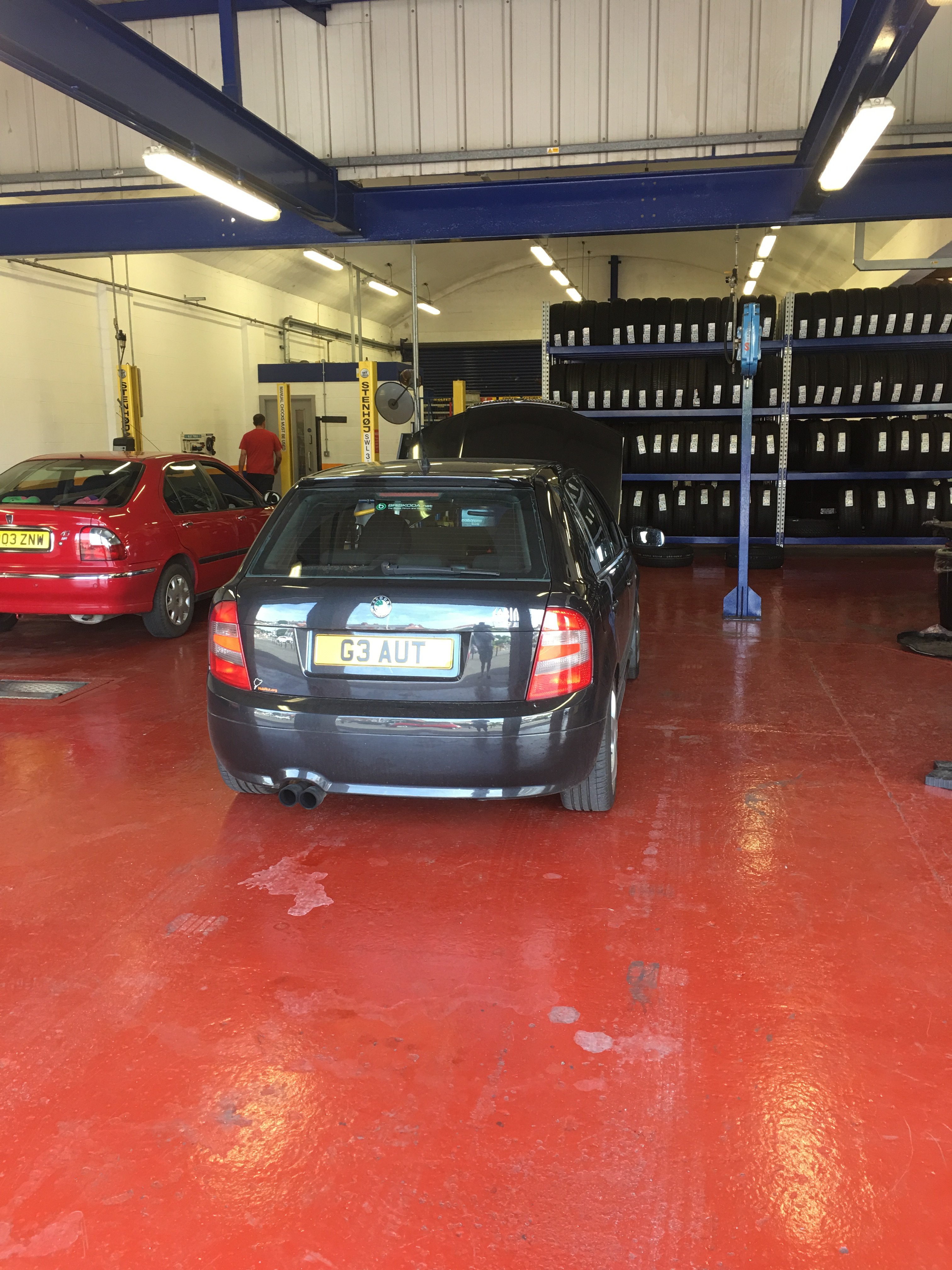

So got that all finished and decided to get the Air Con regassed, been 18m since I did the engine swap and fitted a new air con rad so about time I got it working...
The eagle eyed amongst my faithful readers will clock its Kwik Fit. Normally avoided like the plague but their air con service is competitive and they didn’t upsell me anything so all is good. And indeed now COLD!!

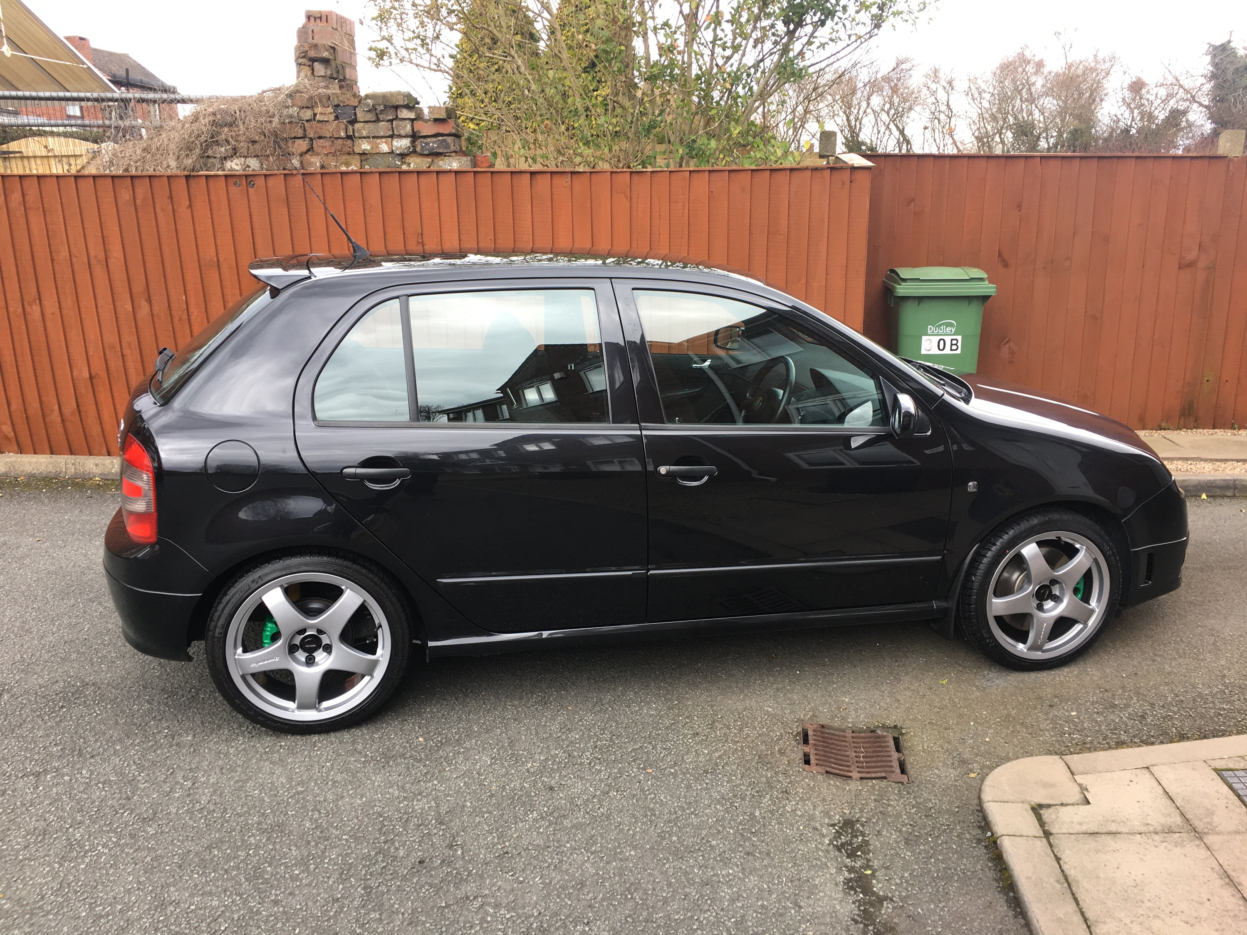

Busy old night working on “Triggers Broom” last night, in the space of 3 hours we had stripped and removed all the suspension, fitted new top mounts, new coilovers and all new front brakes, all bled perfectly and still had time for a chippy supper!
I decided that to get the car sitting right with some adjustability coilovers were the way forward. Some research lead me towards some Stance + Ultra ones which had good reviews in the states. Initial findings are the ride comfort is good, the ride height is spot on and they are not crashy etc.
Fitted the SEAT Leon Cupra R brembos and 323mm discs with braided HEL brake hoses. Yes I know they’re not Porsche calipers, the decals are there purely as a nod to Secret Kev as his hatred for anything “scene” is legendary.
D82B79EE-9D89-4797-A684-7A49BD69E68B_zps
Im going to use the car for a week (600 miles) to let the springs settle then I’ll adjust the height to exactly where I want it.
Looks better than before I think?
28ABF97D-0BDA-45B5-A2F7-F9F840DDA45E_zps
