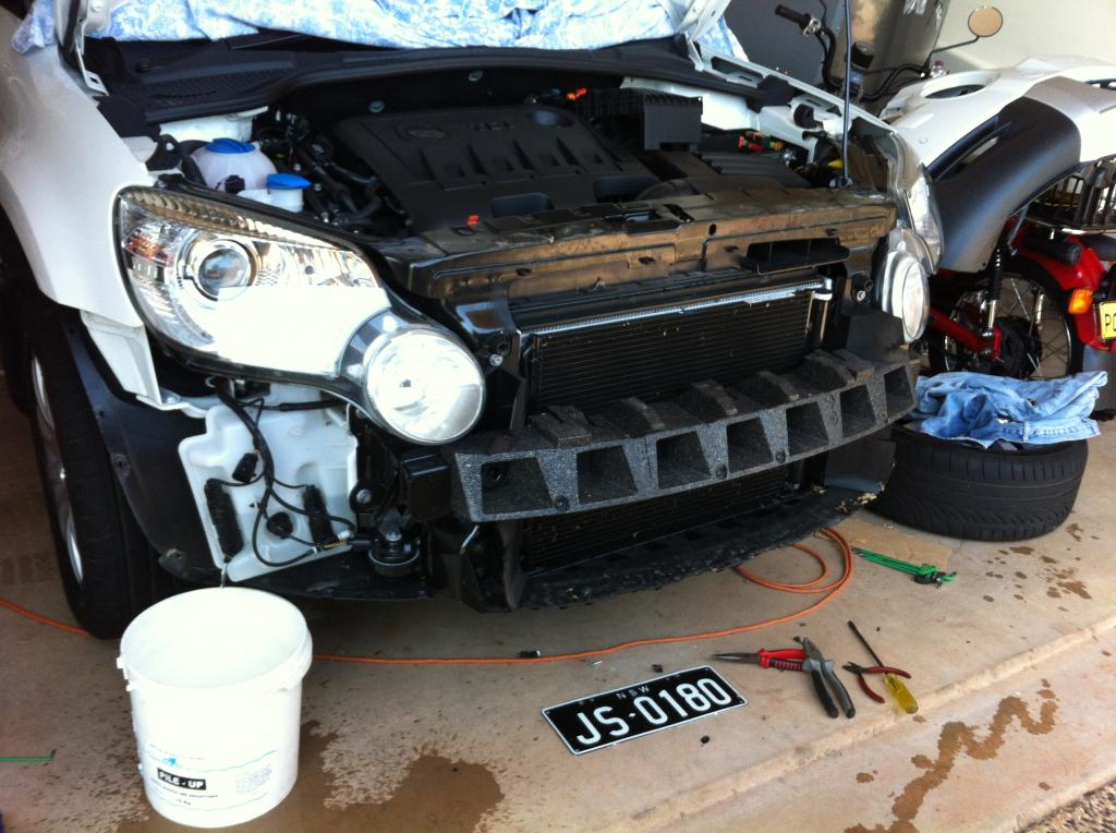

I wonder if these two pictures might might help in some way?
If I remember correctly, I downloaded them from a previous thread by one of our good Australian members friends quite some time ago. For the life of me I cannot remember when or who - but thanks go to them anyway...........Tony
That certainly does help 'Great Yeti'.
There seems to be two pumps: I'm guessing one for headlight washers (on the NS) and one for the front & rear screens (bi-directional pump on the OS). Can anyone confirm?
If this is correct, then which pipe is for the front screen or is it likely that the pump has failed in one direction only?
It looks like it will have to be a bumper off job to get to the pumps.

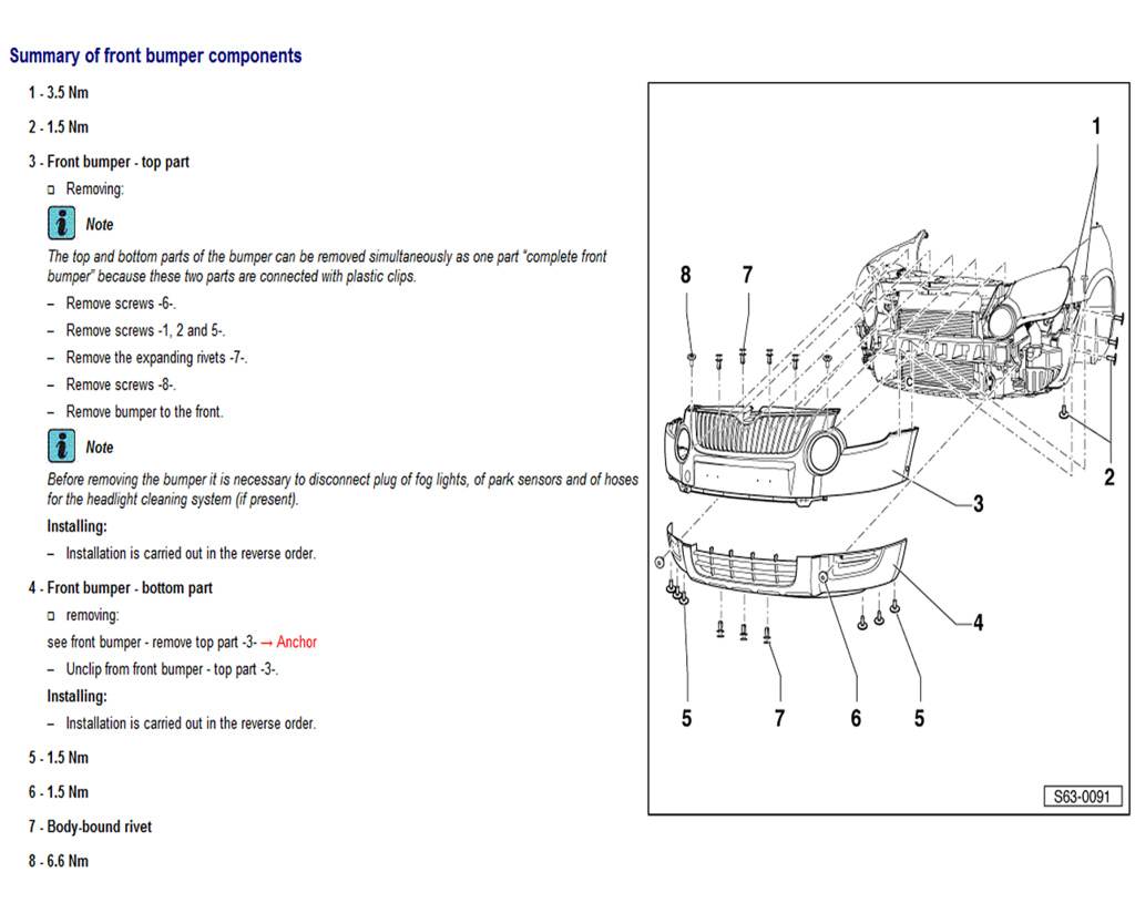

Typical - almost finished removing the bumper using this diagram as a guide and cannot for the life of me work out how to access the screws / bolts #1 on the diagram.
I'm not even sure I'm looking at the right ones as there are two pairs in the same area... I think it's the upper ones and might be able to get to the by bending the wheel arch cover back enough to get a hand and spanner in!
Anyone got any tips on getting these out?

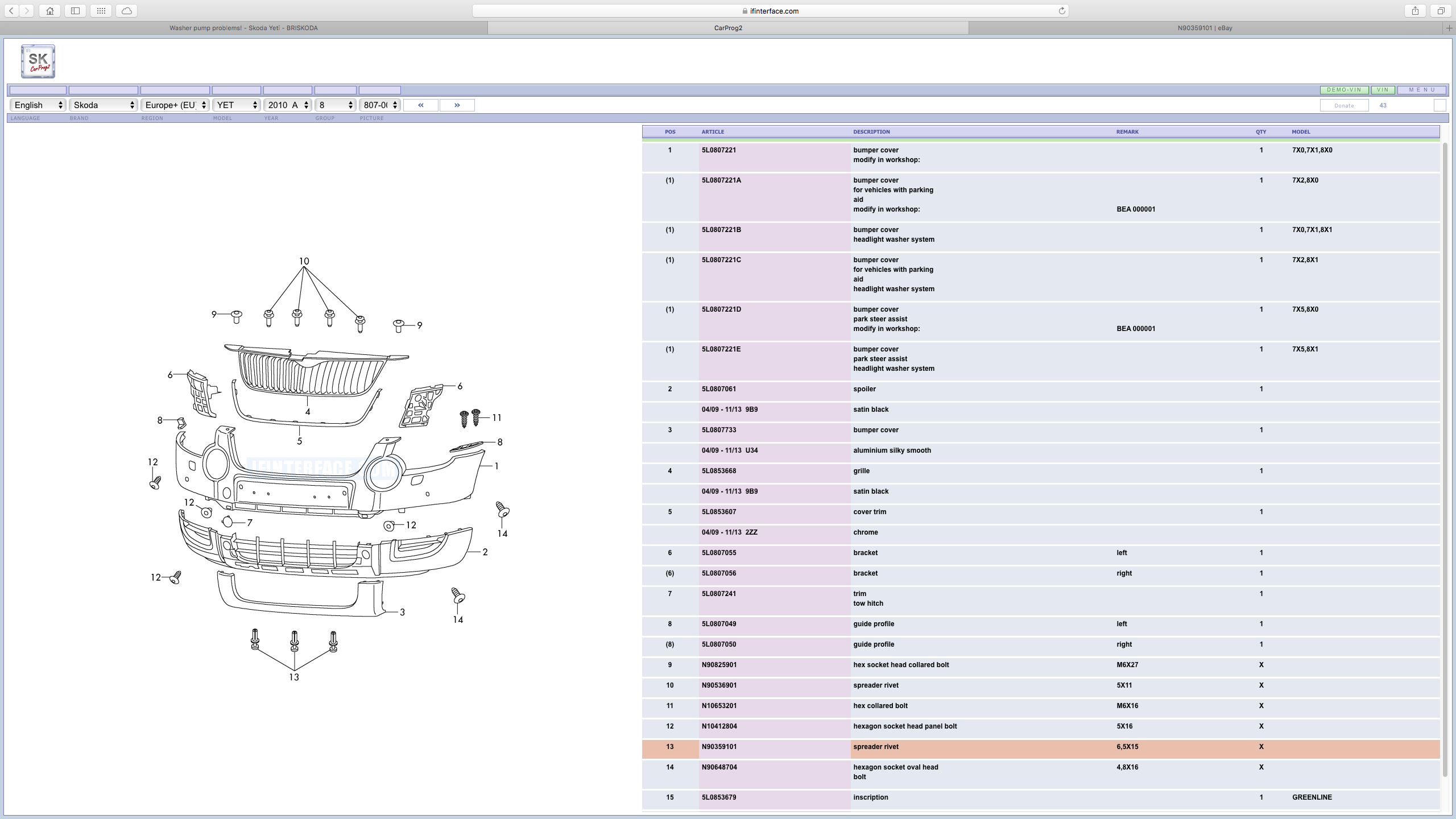

Just in case anyone needs it, here's the part numbers off a 2010 / pre-FL Yeti.
Spreader rivets are highlighted as the heads of these ones were damaged in removal (pulled with pliers as I do not have a tool that can get under the heads and apply sufficient force to extract them).
Is there an official removal tool for these?
