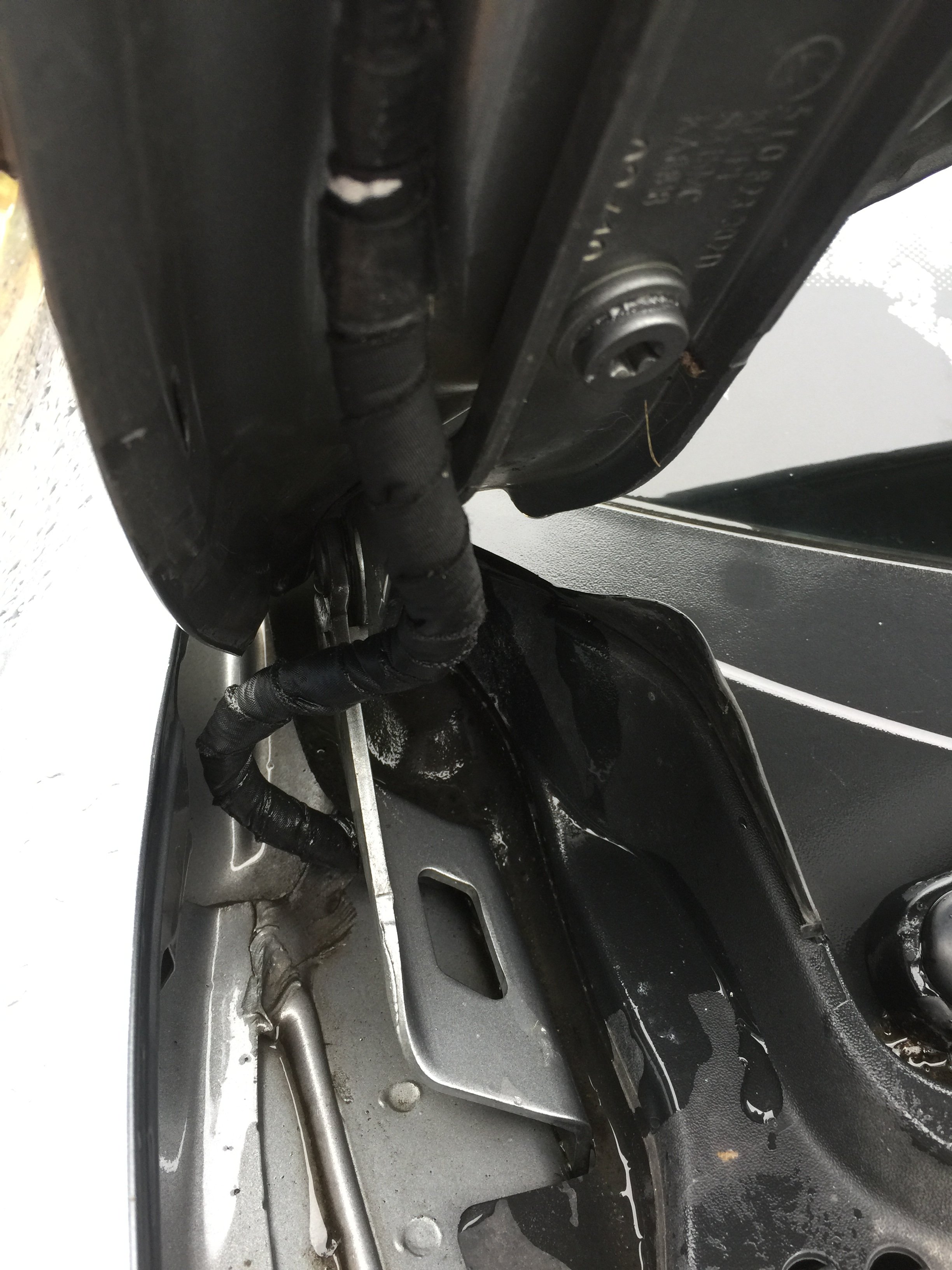

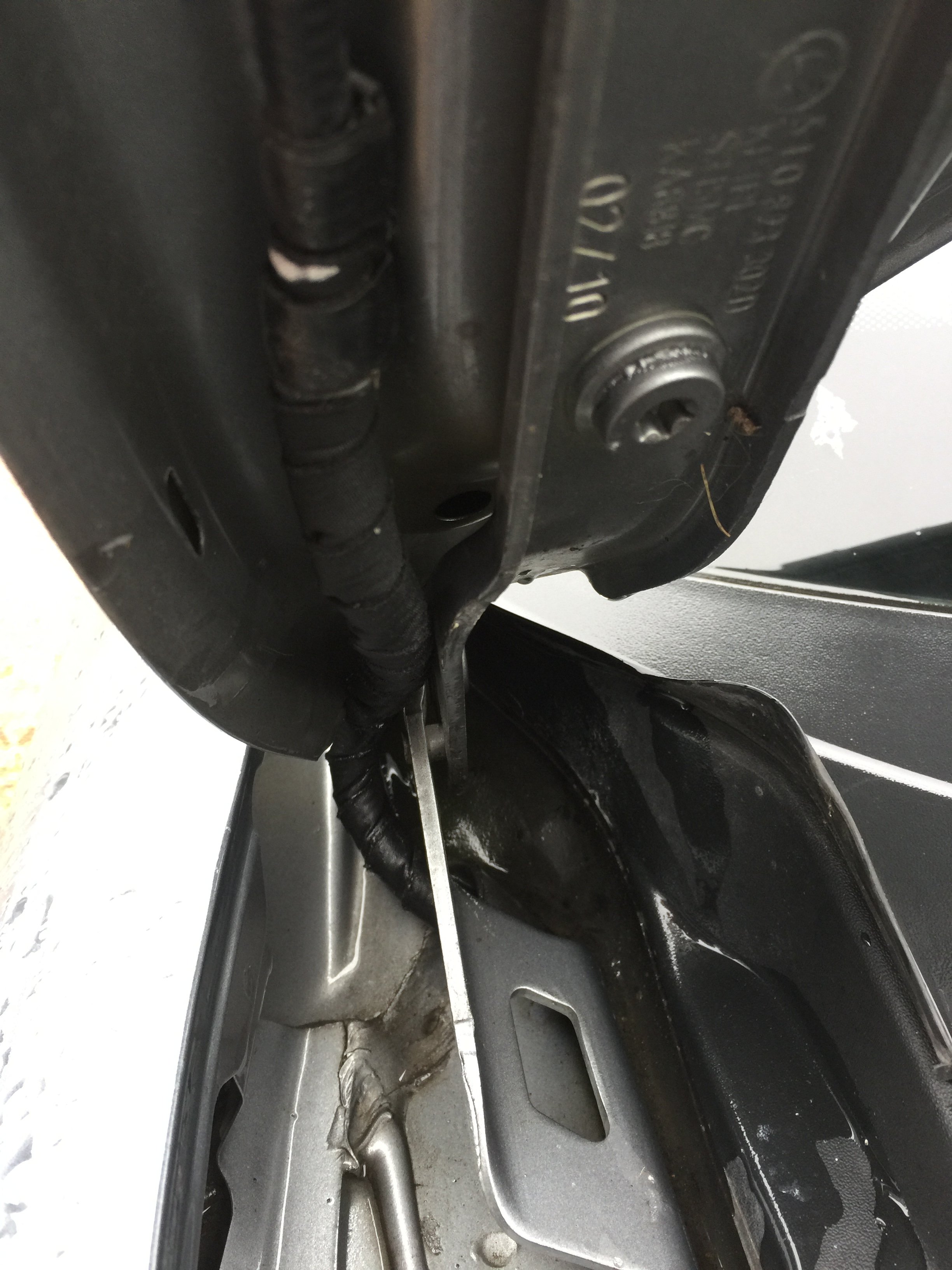

I found the problem this morning fairly quickly. I attached a funnel to the washer fluid pipe by the bonnet and disconnected the other end from the washer bottle. Theory being that water 'should' at least trickle through as air got through last night.
When I started pouring water in the funnel backed up very quickly suggesting that the blockage was very close to the bonnet end of the pipe.
A bit of flexing the pipe and feeling it showed a deformity near the bonnet hinge.
Basically at some point the flexible pipe work by the hinge had come away from the SIDE of the hinge and was sat UNDER the hinge and had become compressed by the hinge when the bonnet was closed.
A bit of manipulation at the compressed section and water was able to flow smoothly through the pipe again.
If you own a Yeti, I'd advise you to keep an eye on this pipe to ensure that it stays down the side of the hinge and doesn't get squashed.
So so I didn't need to buy a new pump or take off the front bumper! But if I hadn't I doubt that I would have discovered where the problem was.
Now to put it all back together once it has stopped raining...
