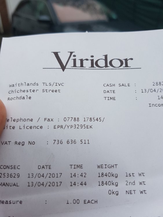

  • For interest, I'm taking my car to the local public weighbridge this week to find out what it actually weighs. Will post up with findings asap.

  • Thanks for your thoughts on this. The 280 combi is 1560kg excluding driver so in my case add another 75kg to give the minimum actual running weight of the car. Add Mrs Yves in, the two children plus
Add Mrs Yves in, the two children plus luggage and we are up at 1850kg ish for the car giving more flexibility on what can be towed.

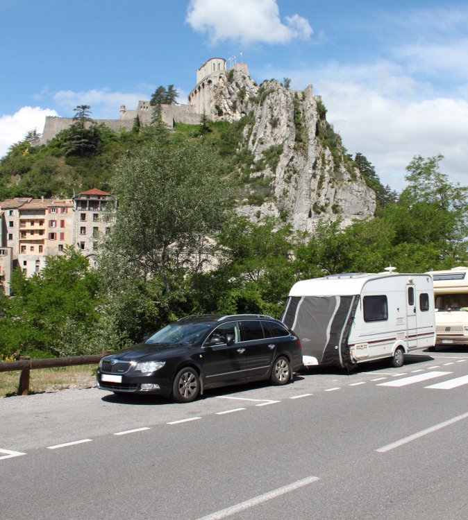

We tow a Bailey Unicorn 3 Cadiz, with the upgraded MTPLM of 1550kg with our Superb 3, which is a 2.0 TDi SEL Exec 190 4x4 DSG Combi. Its a great tow car, solid, surefooted, and plenty of torque. Best tow car we have had.
Nice outfit inofski. Have you played around with the loading of both units? what works best for you?

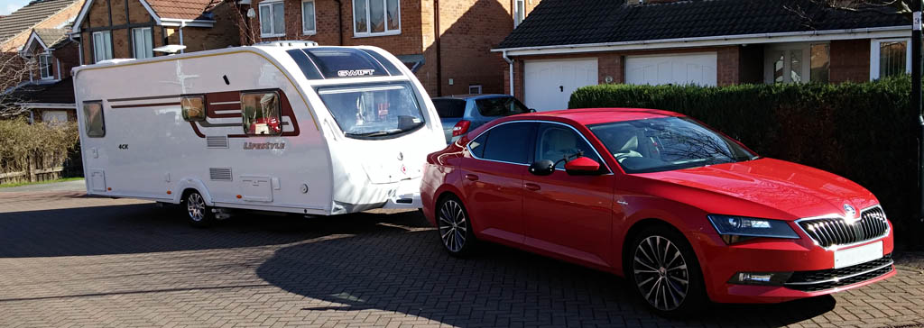

280 hatchback here and almost 50% of the miles since new have been towing our 4 berth 2014 Sprite. The van has an MTPLM of 1350kg and I average 22mpg when towing. Estimated 300 mile range from the tank.
Apart from high fuel consumption (to be expected) I can't fault it. For purely scientific purposes *ahem* I timed a 0-60 run at 10 seconds using a GPS enabled dashcam. I don't dawdle when towing.
Previous car was a 170 DSG combi and though that was a great towcar the 280 is even better. Of particular note is how little the rear sinks even with an 85kg noseweight (90kg max) and heavy mobility scooter in the boot.

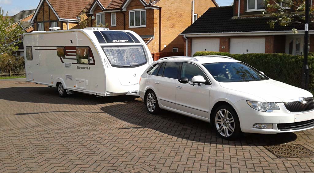

I have a Superb 150 bhp diesel DSG estate with factory fit towbar. I tow a Bailey Pageant coming in at 1420kg MPTLM. Unfortunately I have only managed just over 100 miles ordinance getting the car 5 weeks ago but initial impressions look good.
