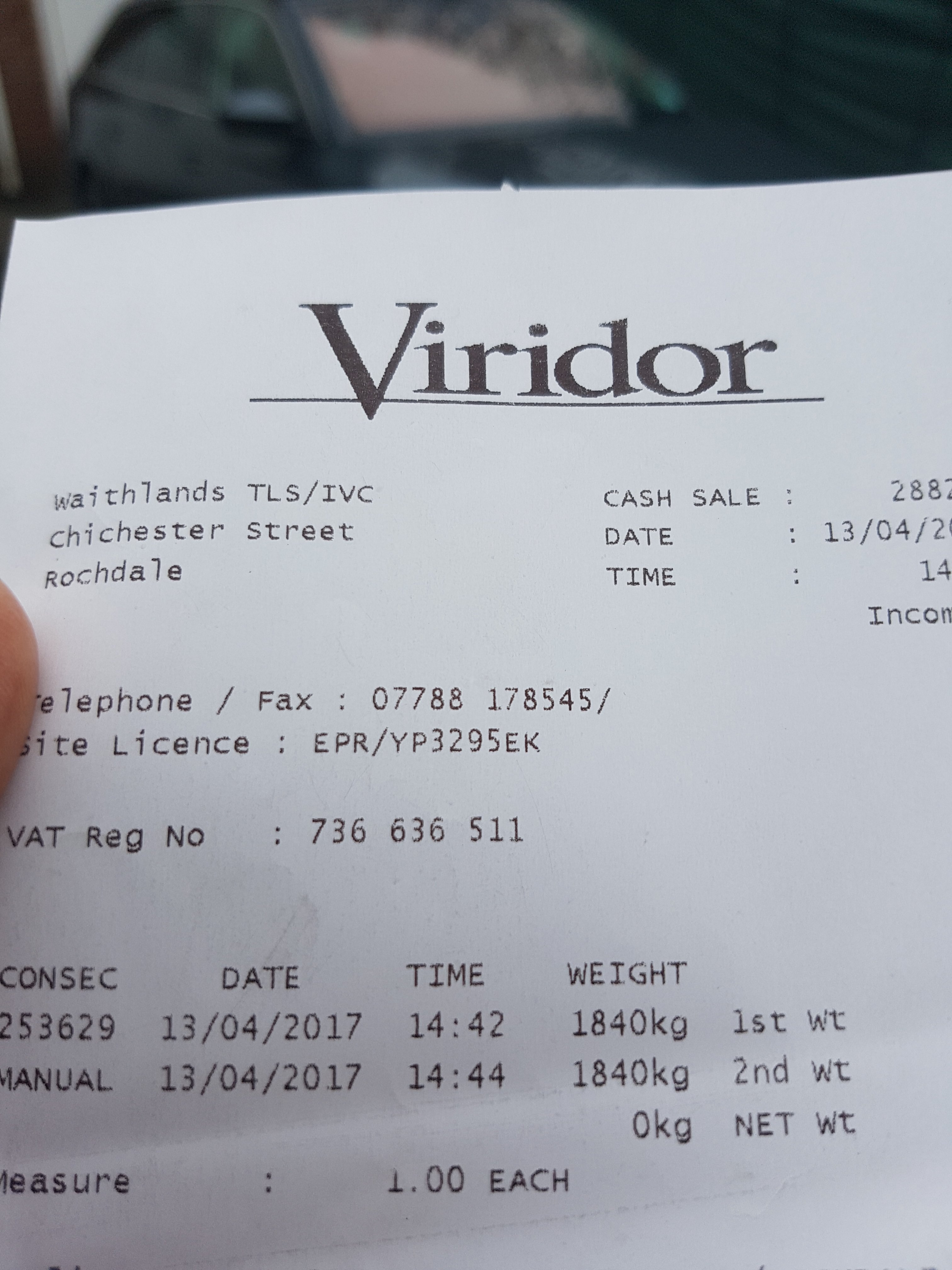

How to calculate the kerb weight of your car without resorting to weighing it! as the VAG published kerb weights are entirely useless! & can't be relied on as they are based on the base spec, manual gearbox & smallest available engine of each car as delivered in Germany!
First, all VAG vehicles are individually weighed as they come off the assembly line, & in the UK its noted on the V5c (reg doc) page 2 under mass in service.
Second, find the fuel tank capacity, add the weight of fuel to fill the tank (in my case 54.91kg, as my tank capacity is 66ltrs  (when they come off the assembly line there's approx 2 ltrs of fuel in the tank). Unleaded petrol = .737kg per litre. Diesel .832kg per litre.
Third. add the weight of any PERMANENTLY fixed after market accessories such as tow bar, changing puncture repair kit with spare wheel & tool kit.
Lastly add 75kg for the driver, apologies if your weight is under or over that but that's the internationally recognised "standard" weight of a car driver!
So my car: Mass in running order 1635kg, fuel 55kg (as near as damn it!), Tow bar & electrics 45kg, full size spare wheel & tool kit (replaced the useless puncture repair kit) 30kg & me, a nice trim 75kg (I wish!!!!!!) making a total kerbside weight of 1840kg, difference between mass in service & actual 205kg that's 4cwt or 448lbs in old money!
If I was a novice tower then my safe MTPLM would be 1564kg, but as I've been towing for over 40 years, I consider myself to be an experienced tower, when I'm towing a caravan I try not to exceed the car's kerbside weight, but a loaded braked trailer maybe slightly more but not exceeding the car's max of 2200kg
After hearing a lot of bullsh1t from a caravan salesman recently, re what my car was or was not capable of towing, he even told me that I couldn't tow a caravan who's MTPLM (Maximum Technically Permitted Laden Mass (fully loaded weight, for those non caravanners out there) exceeded my car's kerb weight, and to add insult to injury told me that my outfit (car & Caravan) couldn't exceed 3500kg's, so in his opinion I was towing my current caravan with this car illegally!!!! What a 1st class ****!. I have a B=E license & passed my test way, way before 1st January 1997! (if anyone's interested here's a link to the to the Northern Ireland DVA, regarding driving licences & what you can & can't tow with each type of driving test passed, don't worry that its Northern Ireland, as the same rules apply all over the UK, its just that the NI DVA (as opposed to our DVLA) explain it so much better!).
So I finally got around to having my car weighed on a certificated weighbridge & the results are in!
I got my calculations re the after market items weight wrong (don't tell my wife that I'm admitting I was wrong....I'll never hear the end of it!!!!)
Kerb weight of car in running order, excluding driver is.......................1720kg, + 75kg allowance for the driver = 1795kg & not 1840 kg as previously estimated, but still 160kg over the V5's weight!

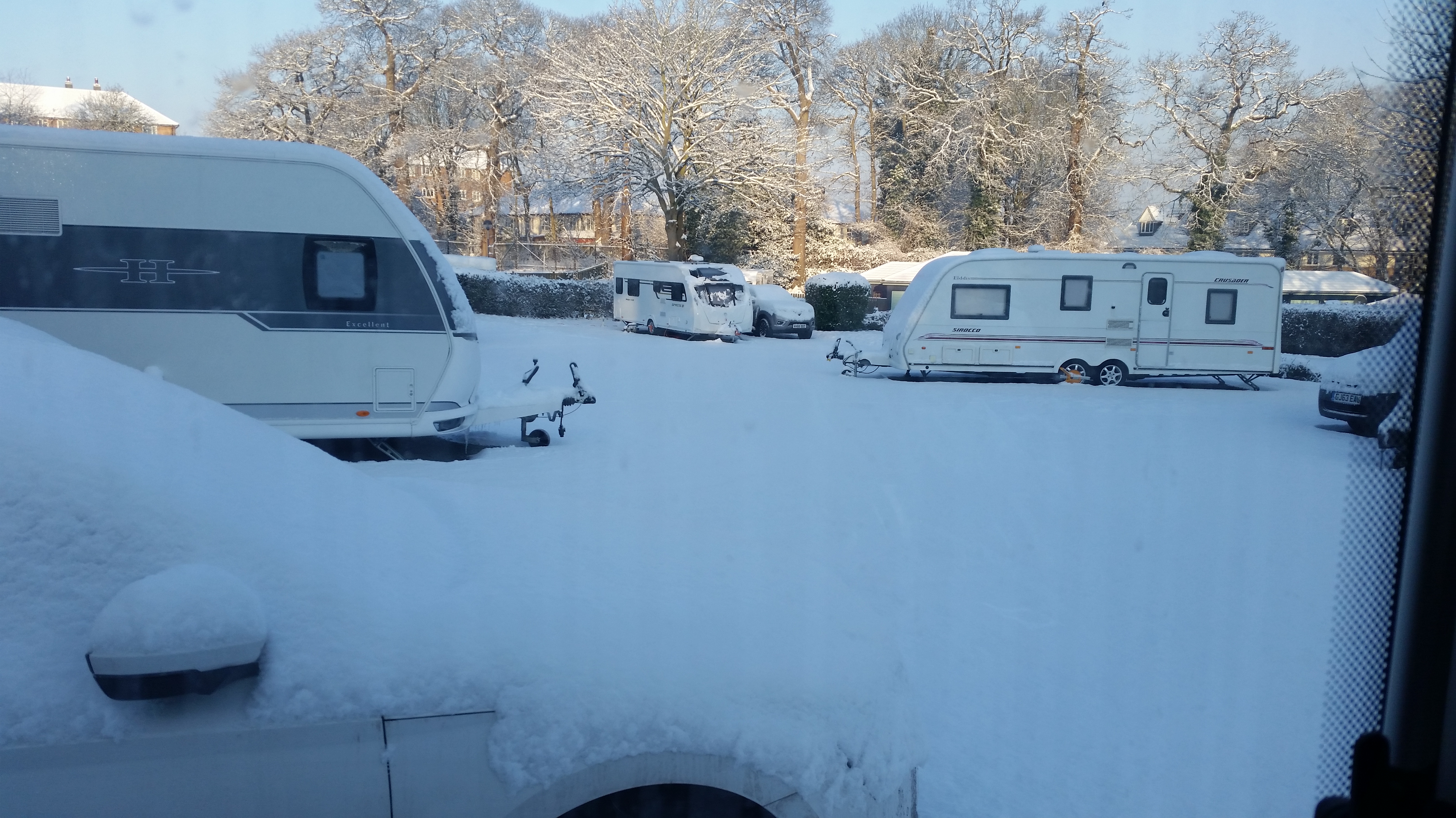

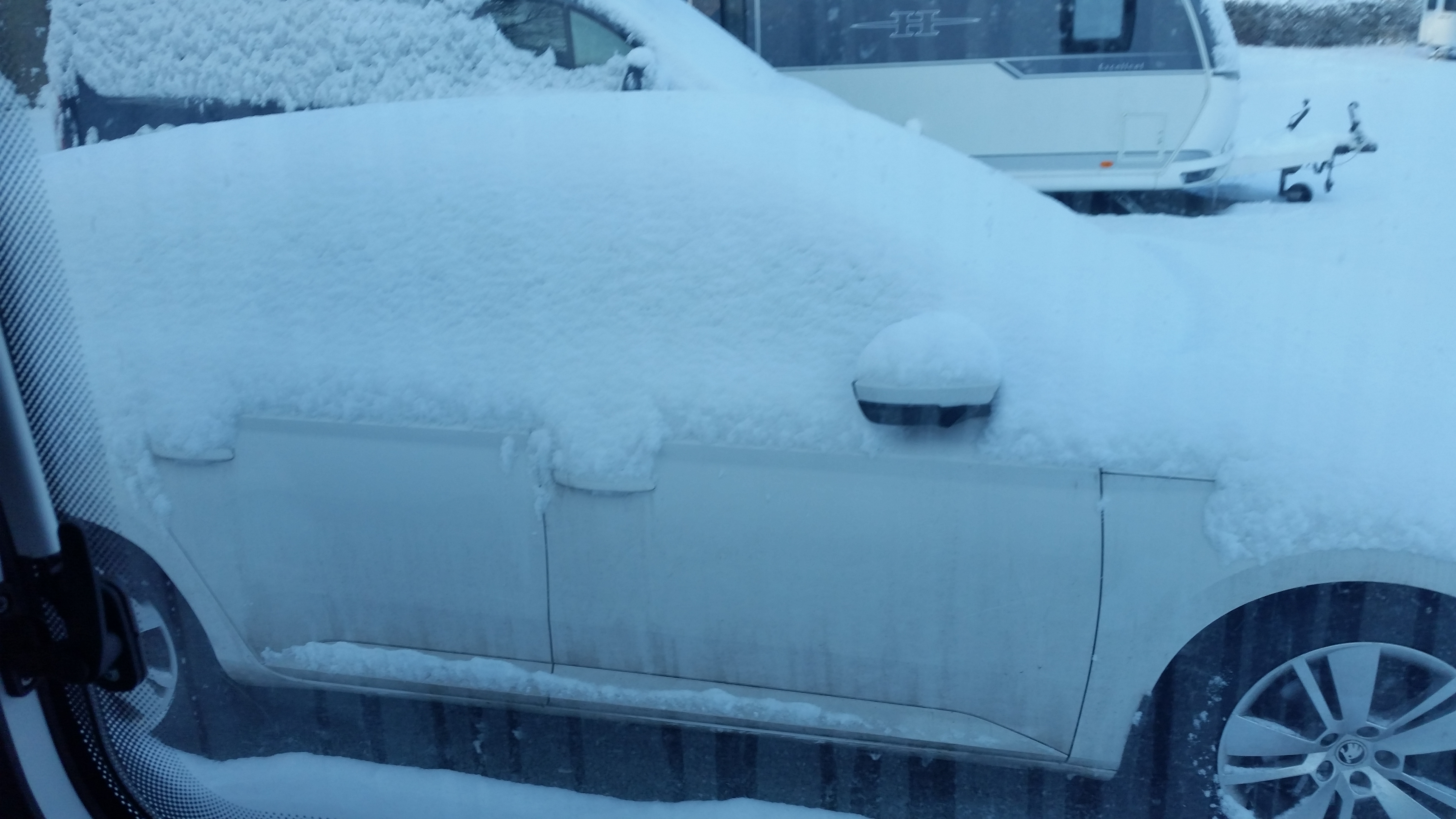

If there are any lingering doubts as to how good the MK3 Superb is for towing, let me tell you about a recent trip with the caravan.
Tuesday 27th Feb, towed the van from Littlehampton, west sussex to the Caravan & motorhome club site in Abbey Wood South east London.  Snowing lightly when I left home,  with about 2 inches (5cm) of lying snow. When I got to junc 10 on the M23 Blizard conditions! Snow settling on the motorway & visibility about 200 metres. This lasted until the M25/M26 split, then it became light snow again. Arrived at the camp site & then it came down with a vengance, barely got pitched up & by the time I had there was about 4 to 6 inches of snow on the car.
Commuted to Deptford for 3 days, What a joke! London Borough of Greenwich had not gritted or cleared snow on the roads for the first 2 days, so a journey of 7 miles took over 1 1/2 hrs each way!
Left camp site on Saturday, to return home.
Why you may ask, was I doing towing in the snow, well I'm involved in a charity that's based in Deptford & I'd pre arranged to carry out a Health & Safety pre annual audit with the CEO (who happens to be a very old friend of mine & he'd driven up from Cornwall on the Tuesday) so I couldn't really cry off because of the weather!
Some things to note: Access to the camp site from the A2 means what ever route you choose theres a hill involved! the camp site is at the bottom of a hill (& even the club site travel instructions state Do NOT approch from Knee Hill!) & the site slopes with the contours of the hill. The road the camp site is in is a side road & is NEVER gritted (how do I know? I lived in Abbey wood for over 25 years & at one time lived approx 200 yards from the site!)
So, impressions of the Superb as a tow car, in what could be said as the worst winter weather since early in 2010 (I had a Kia Sorrento then), based on over 45 years of towing (& quite a number of years driving trucks, inc heavy recovery whilst in the Army) A fantastic tow car! the only thing I'd change in the snowy conditions, the tyres, to a decent set of Mud & Snow or all terrain ones, however, I must say that the car performed superbly (pun intended!) & at now time did I feel unsafe!
