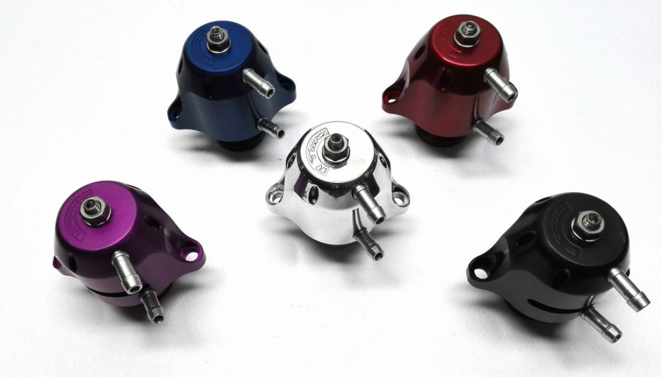

hi guys bit perplexed with this one i noticed my BOV/recirculation valve just stopped working one day on my skoda fabia vrs , I'm getting a vacuum from the back of the manifold and as i rev it looses suction slightly, it then goes to a solenoid valve which in turn forms two pipes one for the top of the valve and one for the bottom, the valve will not open and is just surging air back through the turbo as cool as this sounds i really want to avoid this, i think i may not be getting a signal to the solonoid as ive ordered a new solenoid fitted it today and still no luck has anyone had similar problems ?

so after a little VAG com and some replacement parts it appears the solenoid packed up causing the ecu to shut the signal to the solenoid so even after it was replaced it needed to be reset to work again luckily i have a good friend with vagcom who got me out of the ****!!!! so if anyone else's packs up this was my solution might have to upgrade to this from tmg performance what does everyone think :P
