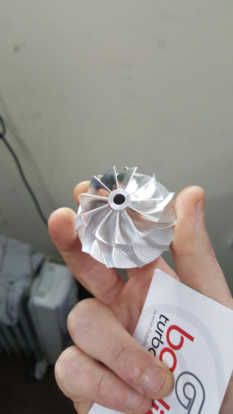

I have had this done professionaly by bayliss turbo they put in a billet 36.3 49mm wheel with extended tips and was flared out to 52 mm . its an 11 blade wheel so spools really fast with 360 bearings .quote Ali from Brum wraps ask for Lee or Scott.you can see my wheel its posted up under turbo on performance upgrades I use the name Giro

Bayliss should be able to do this for round about 350 pounds its very good price they also give a 2years warranty which indicates they are confident in their product..my car is is running 233.17 bhp on a 1752 which is decent for local driving and motorway.
