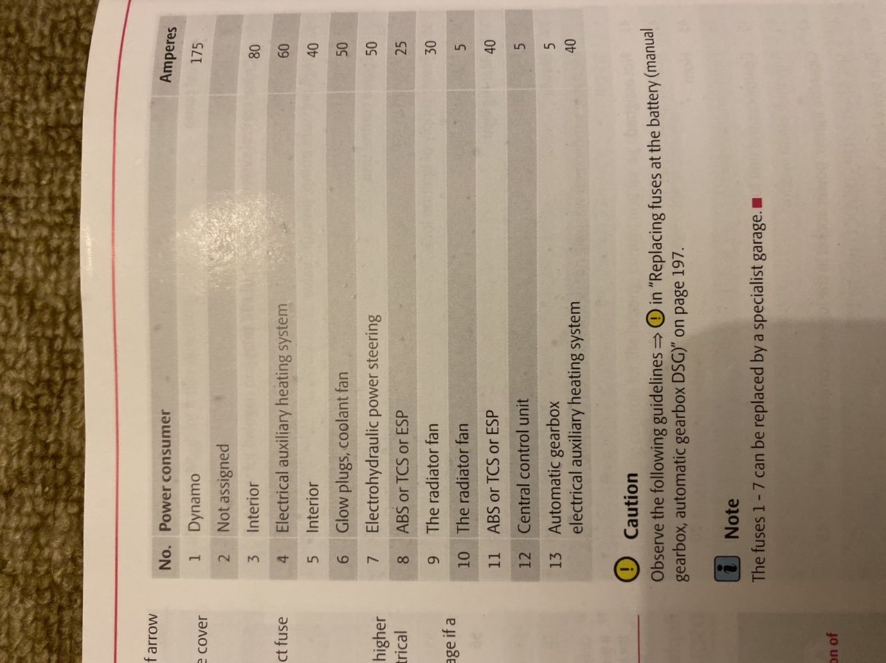

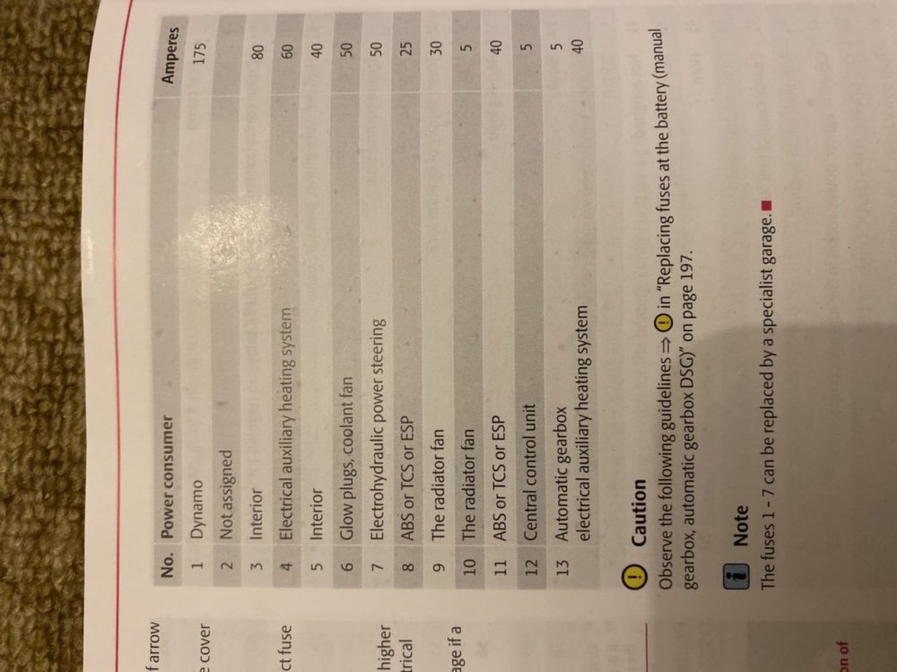

Wino just checked the book again and this is what it says
5 amp for automatic gearbox and 40amp if its the heater

Yep, as I said somewhere on the first page.
Deja vu?
  • Sponsor
My second post in this thread said 40A for heater or 5A for gearbox electrics.
Ahh yeah yeah
