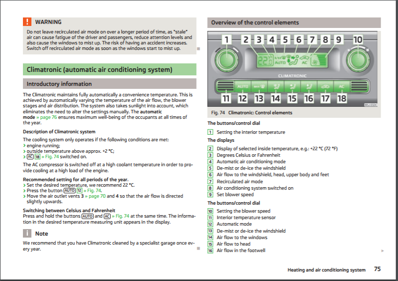

post-5783-0-12922700-1482363434_thumb.pngI've been searching Google today and have found an online manual which shows a climatronic unit in a Roomster with a dedicated 'Demist or defrost windshield' button
My 2007 Roomster doesn't have this - does anyone know what this does (activate heater?)
It just ramps up the fan speed, directs the majority of the flow through the windscreen vent and enables air-con (to dehumidify).
Nothing fancy just a shortcut button to save pressing multiple buttons to achieve the same result.
