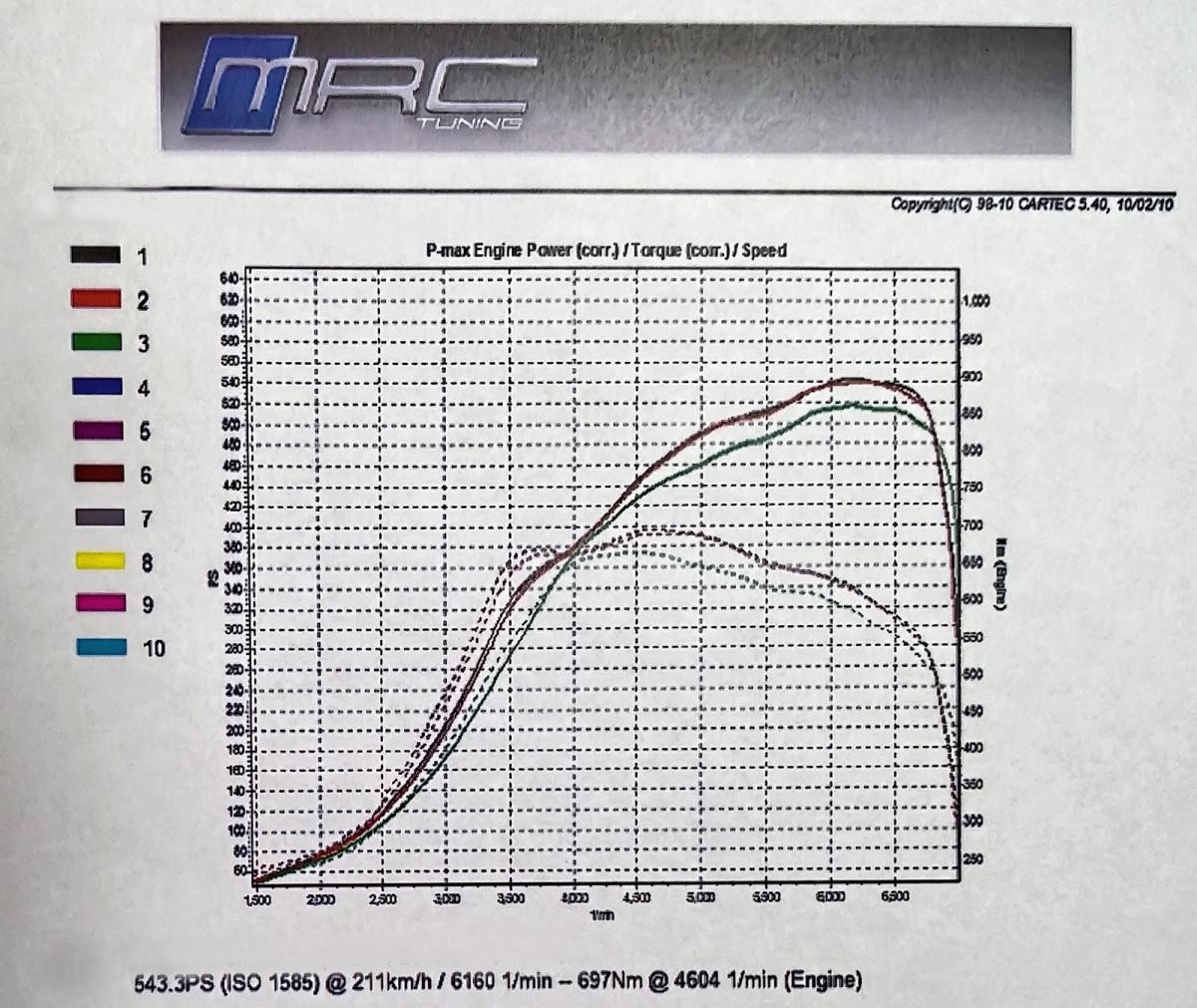

Wagner intercooler replaced the Forge one and map tweaked to suit #MRC
543ps and better spool !

@superbtte; Impressive build that defines what a true sleeper is. Did you get an explanation of the difference in spool and the powerband with wagner vs forge intercooler?

Good to see you are following the thread :) I think the difference in spool is possibly the ability to allow more timing due to the larger size /better cooling of the Wagner intercooler but don't quote me on that!
