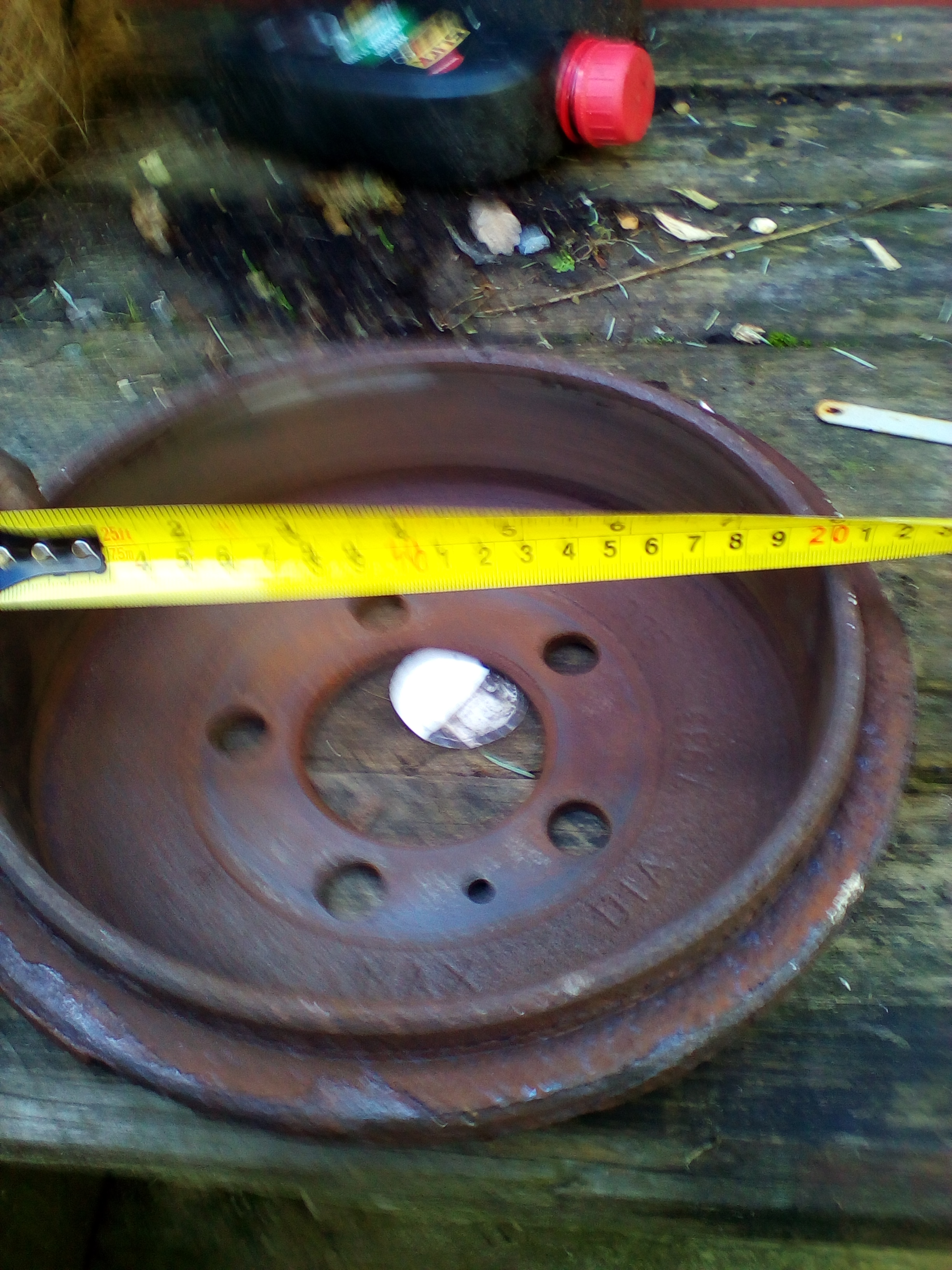

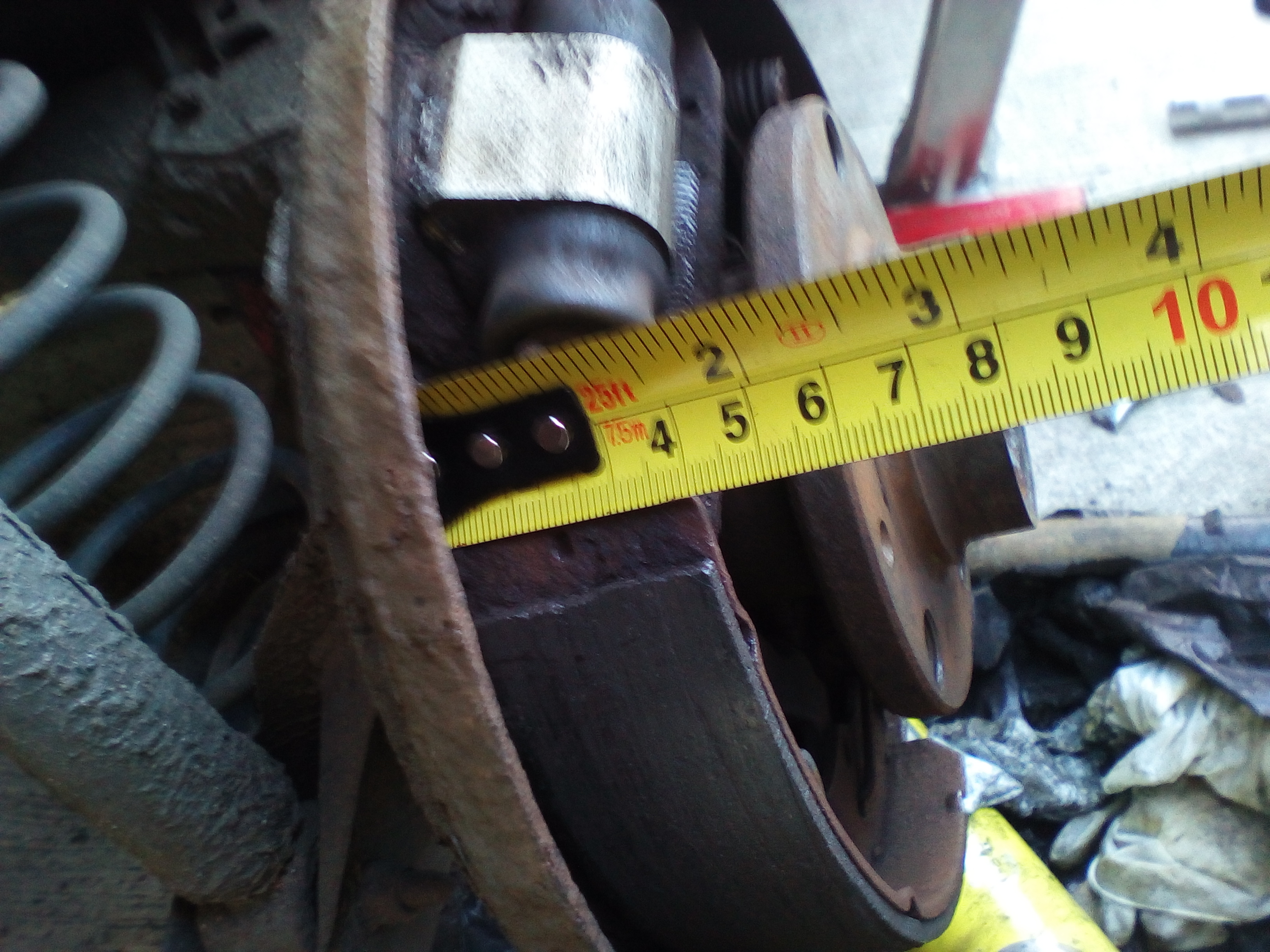

Had same it was rust build up on drum... Any one know what type shoe and drum is for a mk1 fabia classic estate 1.9sdi I'm having a right tail chase going on trying to get the sets for my Skoda... Its a 51 plate 2001
Thanks in advance for any help photos of my setup

All parts/part numbers should be shown here: https://skoda.7zap.com/en/cz/fabia/fab/2001-225/6/609-609020/
Item 3 is worth considering as a replacement, they are little plastic discs that mount into the backplate and give a low-friction surface for the edges of the shoes to move on. If your car has never had replacements, they may have worn to virtually nothing by now.  Cheap but probably only available from VAG dealership or TPS. Maybe worth trying the part number in ebay/google. 6 on each backplate, 3 for each shoe.
