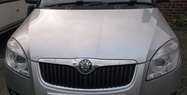

Best post a photo of your headlamps on here, someone will put you right.

Back later with photo.... :)

Here's the photo of my headlights.  Just in case someone might know which they are!
Do they look cross-eyed to you? They do to me! :)
Same as mine, pre-FL single h7 projectors (not cornering) with a shutter that provides the dip/full facility.
I concur. HID's will give the best 'bang for buck' improvement in these lights.
Actually likewise; as long as they're specified for "H7 replacement" to get the arc in the right place, plasma discharge units will work great with projector lights.
