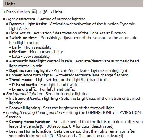

As a favour, can someone with a working Bi-xenon/AFS system take a look at the light settings and see how it compares to mine in the picture above
Mine is the same Q102 except my switch on is set to LATE.
Exactly the same. (Just with the addition of Dynamic Light Assist and I set my Switch-on time to late, neither of which has anything to do with AFS).
