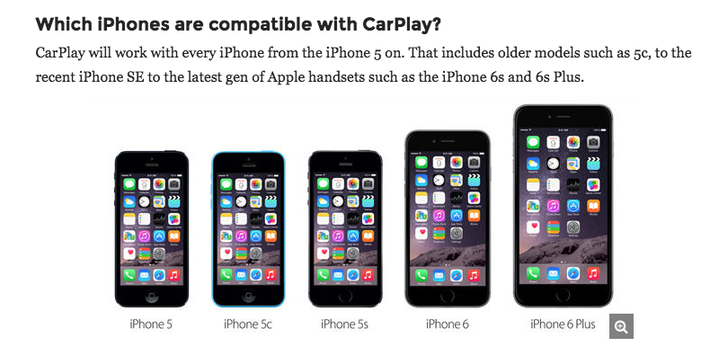

Hope this answers the question.
Yup, says it should work but it doesn't! :(
