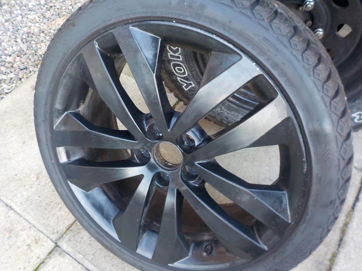

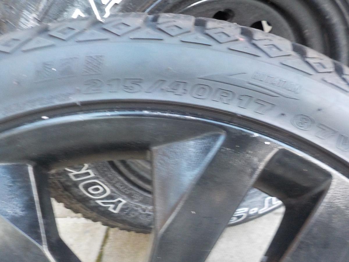

Last winter on my Mk2 Fabia vRS i used 215/40 R 17 Maxxis AP2 All Seasons (M&S marked) up and down the A90 / A96 and to the Lecht & Glenshee when there was snow on the roads & car parks.
They were excellent, as good as any Full Snow tyres i have used over the years. Good in the Wet, and fine across the A93 & passed the Lecht on dry suuny spirited driving days.

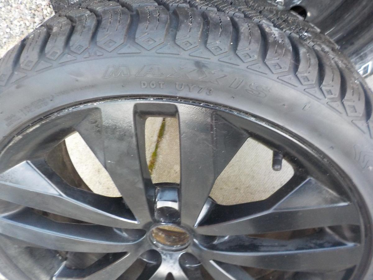

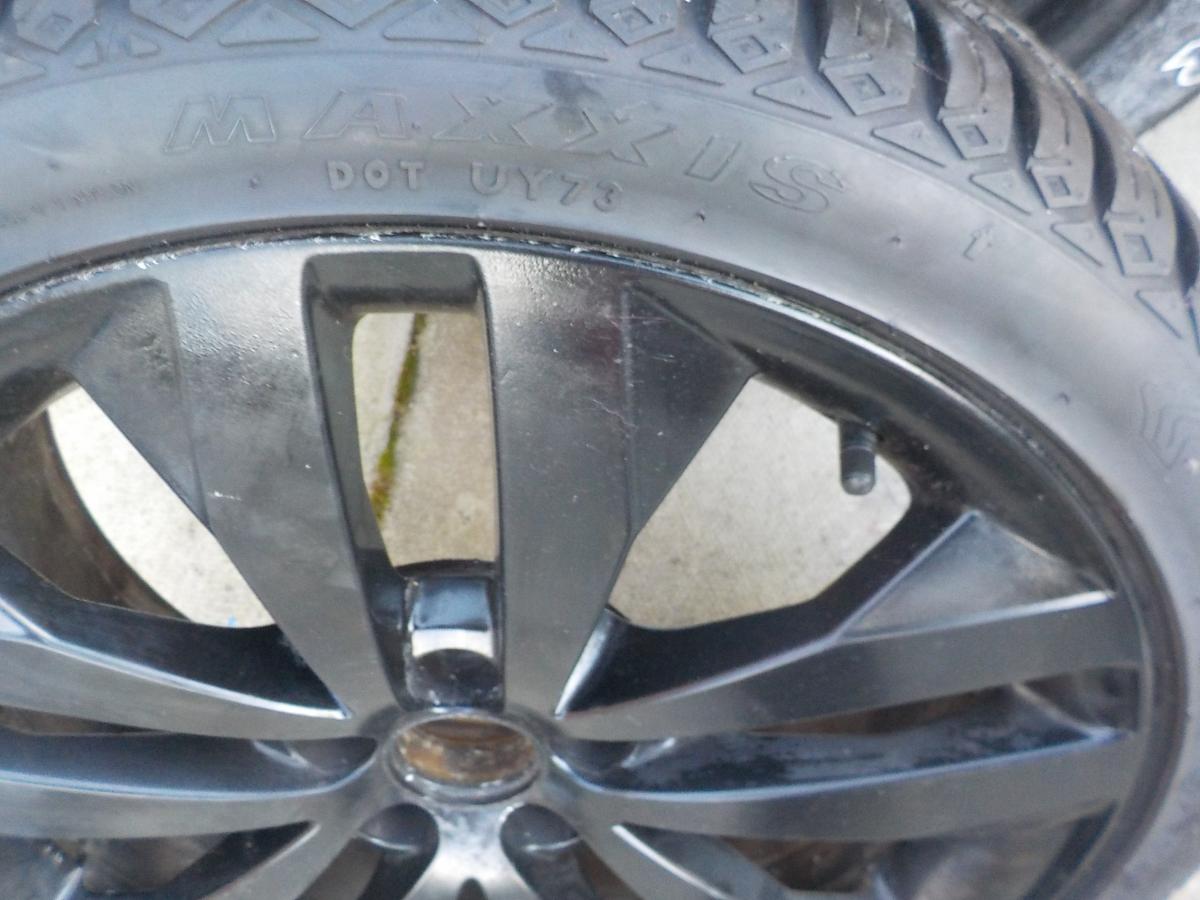

I did get a bulge on one with a Pot Hole and Maxxis replaced with a New Pair of tyres and did not ask for a pair back.
Just away to put them back on the car today for this winter.
If you can get a set of 17" Alloys cheap then you could run the 215/40 R 17 until May, or even all year if you wanted.
Or go 205/45 R 17

Picture 2nd from the right shows the bulge on the right hand side.
I will get that tyre off and paint up the rim with Plastikote after a bit of a sanding / clean up..
