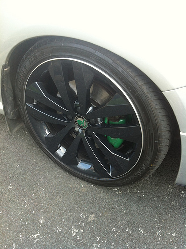

Not so easy actually to sort out the non painted polished edge (Lacquered / coated) on the Black Gigaro, so often painting to match the rest of the wheel is easier and cheaper. (on all 4 wheels.)
Picture from google images.
(Mine only ever look this good for a short period of time, and often look cr4p after new tyres have been fitted a couple of times.)

The Colour match is simply, not an issue, the Cut Rim without colour is not so simple, but yes a competent refurbisher will do them.

I was told by 2 different wheel refurbish companies that they wouldn't be able to get the alloy back to looking like it did out of the factory. Something about the diamond cut polished lip around the edge.
I was told the same as yourself Millsy, The guy said he'd give it a good go but that it wouldn't be like new. These alloys do appear on ebay from time to time and can sell relatively cheap or sometimes not at all...
I've had many show wheels over the years and you can definitely repair it to look original.
I would look for someone that does work for "scene" cars
Most will say no as it's not a straight forward in/out job

They can, the wheels are re-profiled / Machined.
But seeing as they are rather crap wheels in the first place and you can get them cheap it is hardly worth the expense.
I have Dark Chrome Gigaro sitting that have never been on the road that are covered in White Worm, and Black Gigaro that have the Edges looking crap even after
i polished the edges and re-lacquered.
The point really is how much do you want to spend getting wheels made of chocolate looking as they did but with some alloy removed on the outer lip.
A quick spray of Plastikote for use in the winter does them no harm really if clean and moisture / salt free free before doing.
