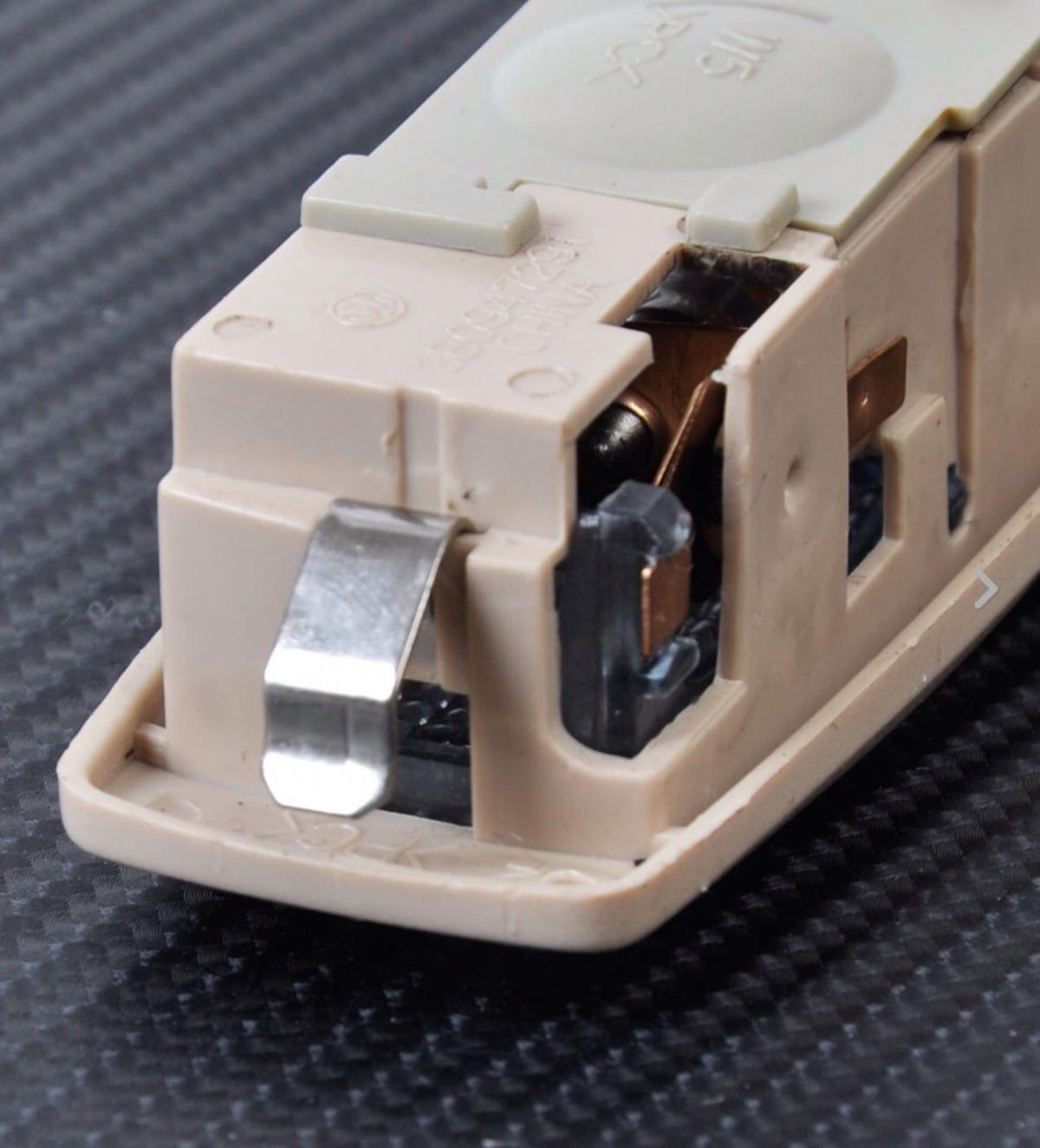

Hi found this pic when  I wanted to change mine to LEDs - so much better!
Good luck
I recently switched to LED's but the small metal clip in the photo below gave me horrendous problems. As Dithane says, make sure the screwdriver engages between clip and metal carrier at the end with the circle mark and the unit will pop out. I actually broke he clip in the process of removal (started at the wrong end and got wild with it) and had to order a new light unit.post-133523-0-44077600-1481025653_thumb.jpg

Rear indoor lights were not so hard at all, just be sure to push the clip between the plastic light housing and the metal rim. The metal rim is supposed to stay attached to the roof while the light housing comes detached. 1 x 36mm festoon bulb a side.

Once you push the right part inside the housing, the whole light becomes loose and doesn't need force to be pulled out, but finding the right place to push with the flat screwdriver was the trickiest part.
Well I already read through the thread and studied the pic or I would not have asked the question, so where is the right place to push?
