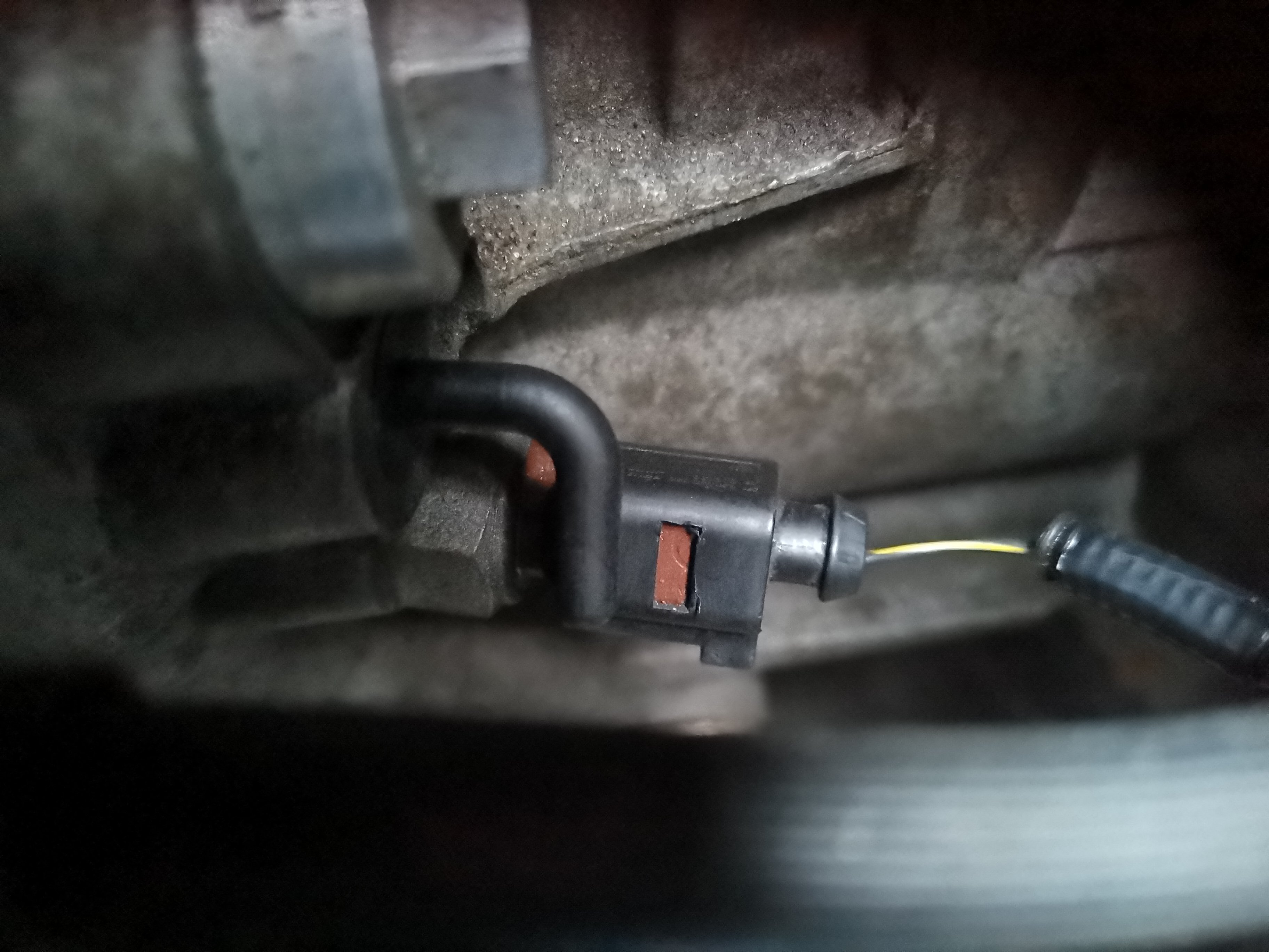

Having similar problem, so would like to check that this is the reverse switch I'm looking for before going further.
Is the connection a straight 'pull-off' or is there a clip on it?
06 plate 2.0 Tdi
fuse, bulb checked and ok
Update in that this is the switch, as when I wiggle the wires, (with ignition on and in reverse) the reversing lights do work.
My follow up question, is how do you get the electrical clip off??? I seem to recall that there's some clip you need to push in, as pulling understandably doen't work.
Wondered what is the knack / technique to do this??

Push the body of the connector firmly towards the switch then lift the latch at the top with a thumbnail. When you hear that click free, pull the body of the connector off.
The initial pushing makes it much less likely that the latch will snap, as it relieves the load on the flimsy plastic.
Thanks; a case of easy why you know how! Fo me it was more of a 'pull back' on the latch than a lift.
The wires had worn through at the point of them leaving the protective sleeve. I guess there comes a point after 13 years and 230k miles of flexing then

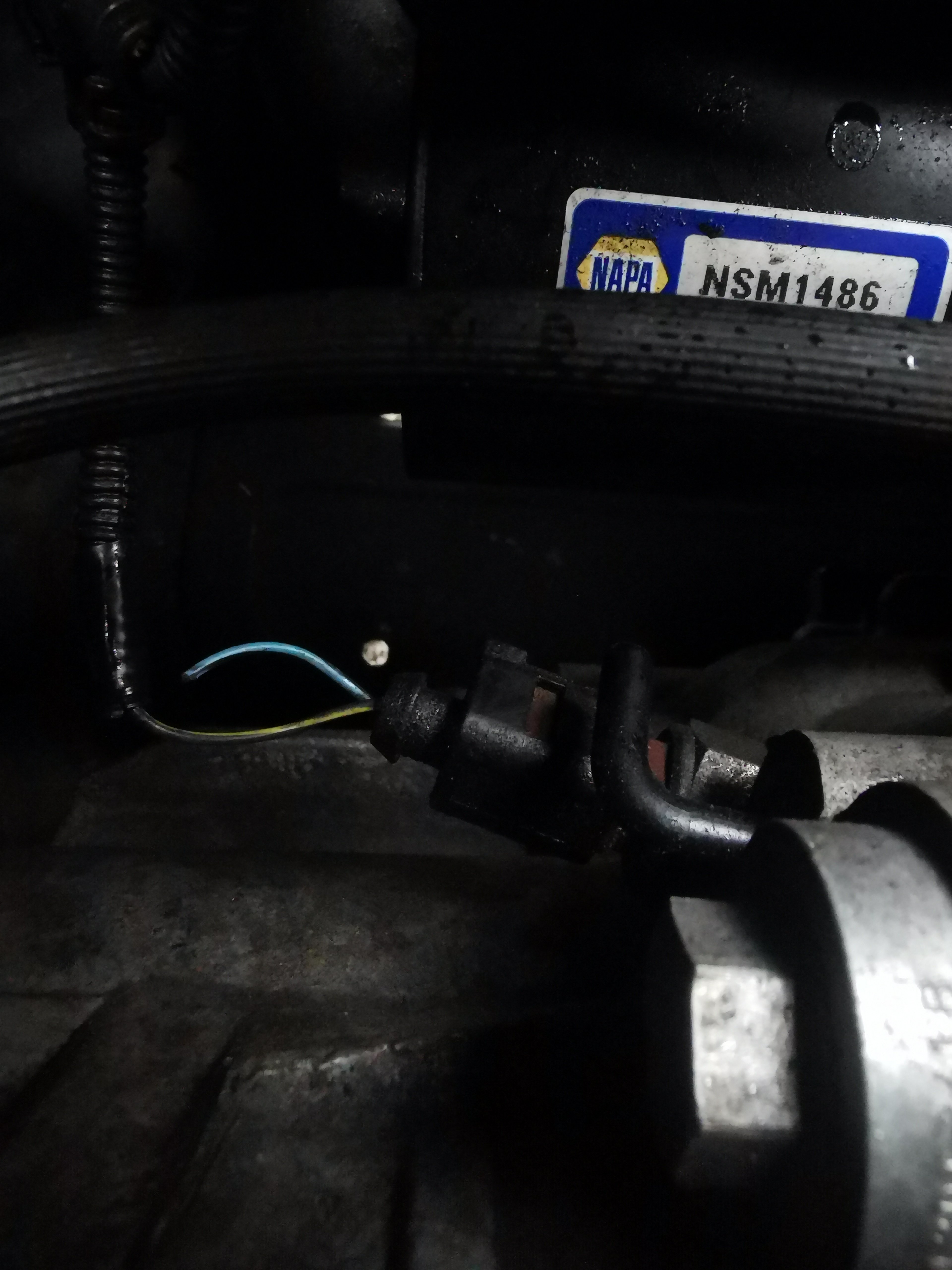

Apologies about a beginners question, how do I fix that? Would need to take the wire out to solder it at home - what's the way of doing it? The other end is inside plastic protector so can't actually find it

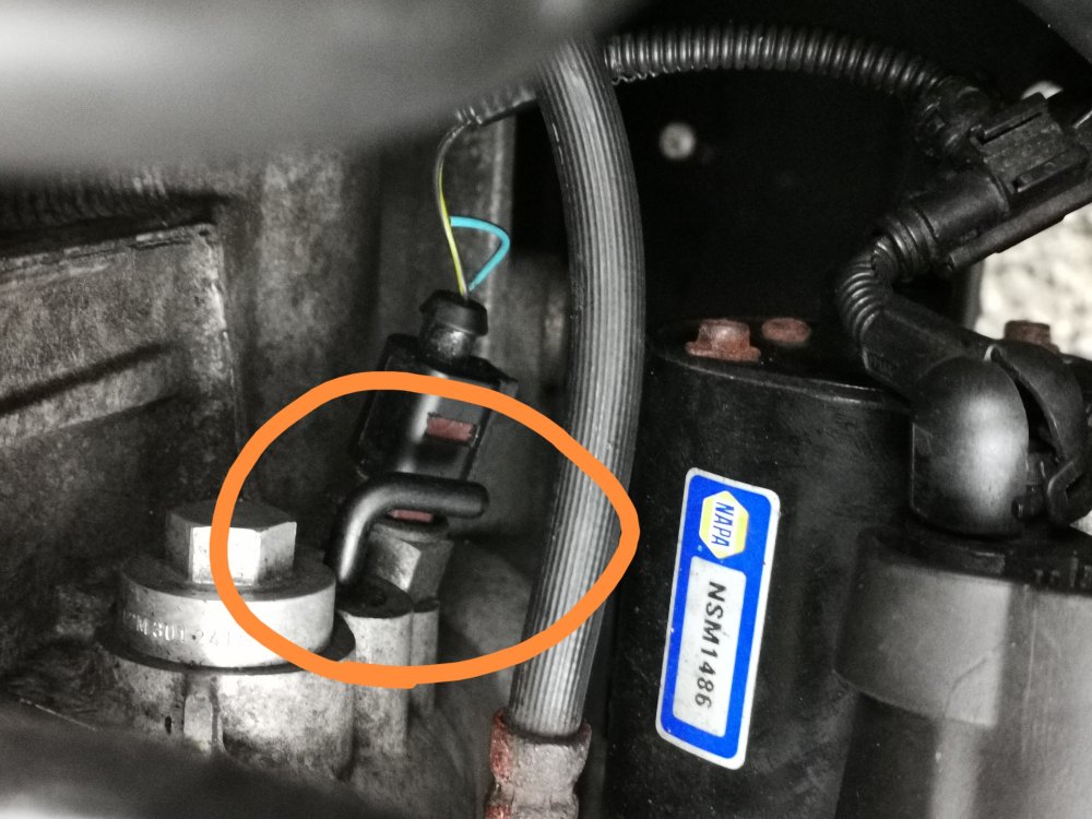

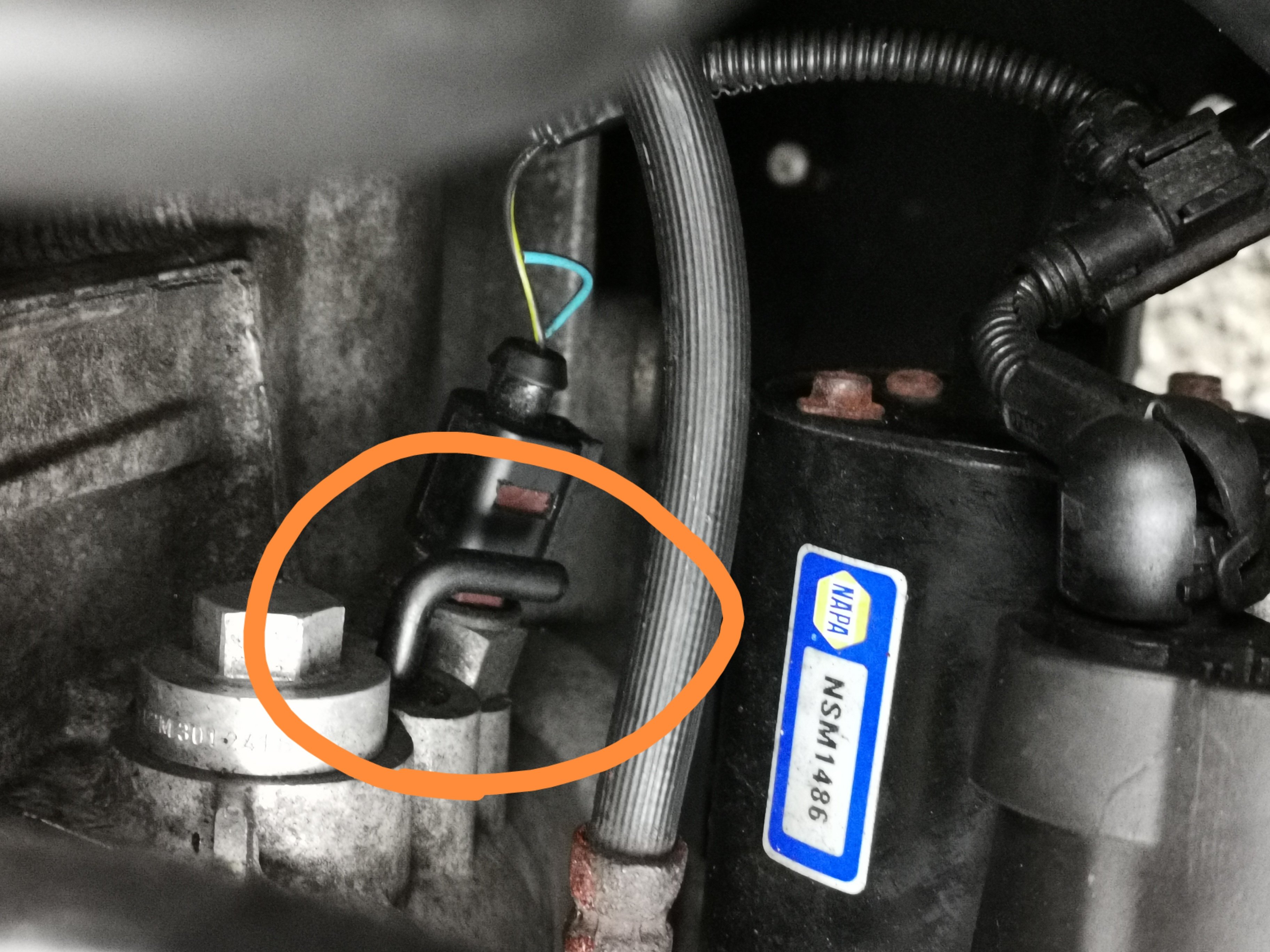

Also out of curiosity, what is this?
Also how do you remove the actual reverse light switch? Kinda hard to get a hold of it
Do you mean the connector, or the switch itself which is screwed into the gearbox?  If you mean the connector, the method is described in my post on 21/07/19 above.
The bit you've circled is a lever for locking the gear selector in a certain position used when resetting the cables.

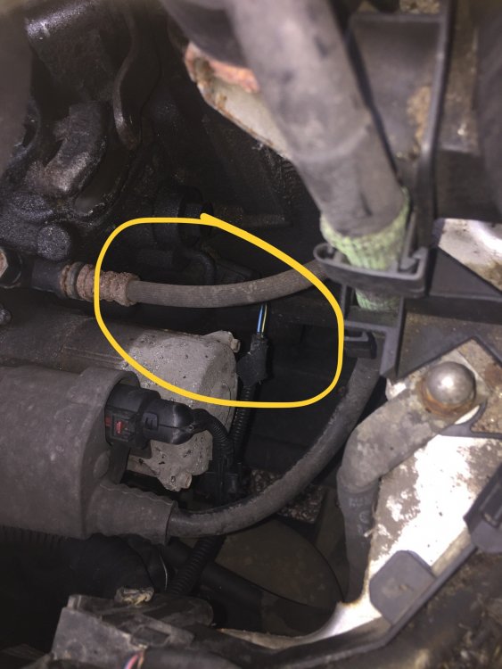

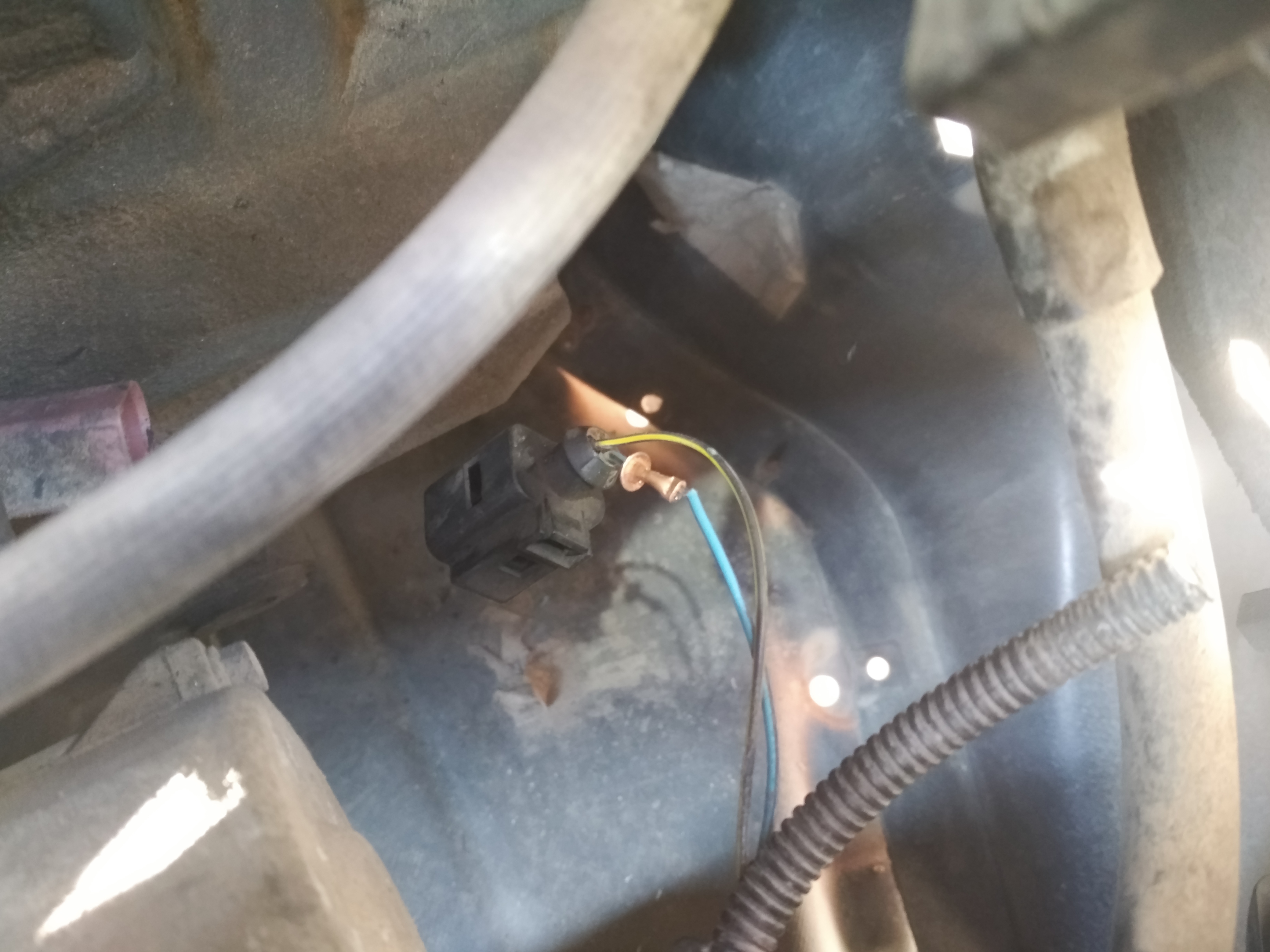

Probably the switch and the connector, as the blue wire actually snapped and no i don't even have the end of it to solder 🙄
Is it easier to access the switch itself from the bottom of the car?
There is some play at the lever, is that normal? I didn't want to mess with it not knowing what it is.
Many thanks

Yeah, its normal for that lever to be movable, leave it alone.
I very much doubt the reverse switch is any problem itself, the broken wire is obviously going to make it not work.
Unwrap the black tape at the end of the plastic conduit tube, and then you will be able to split that tube apart and find the other end of the wire. Until the wire is fixed, there is no point in worrying about the switch.
You can prove the fault is just the wiring if you strip back both ends of the broken section until you have clean copper, twist them together tightly and wrap some tape around. That should be enough to see it work, then you can think about making an improved, more weatherproof joint at your convenience.
The blu e wire has snapped off completely - I'd actually need to add some wire over there, so need to unplug it but the latch is actually at the bottom 🤔
  • Sponsor
The other end of the blue wire is in the black tubing surely?

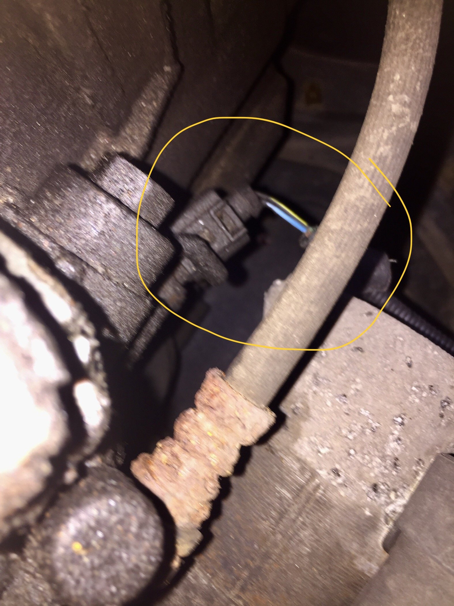

Best picture I can get
  • Sponsor
Just here where my blue arrow points to:
  • Sponsor
Ah, were those pictures not your car?
Yes, access may well be easier from below. It might be easiest for you to buy a replacement connector with wire tails pre-fitted, then join them into the loom.

The connector plug is probably still saveable.
