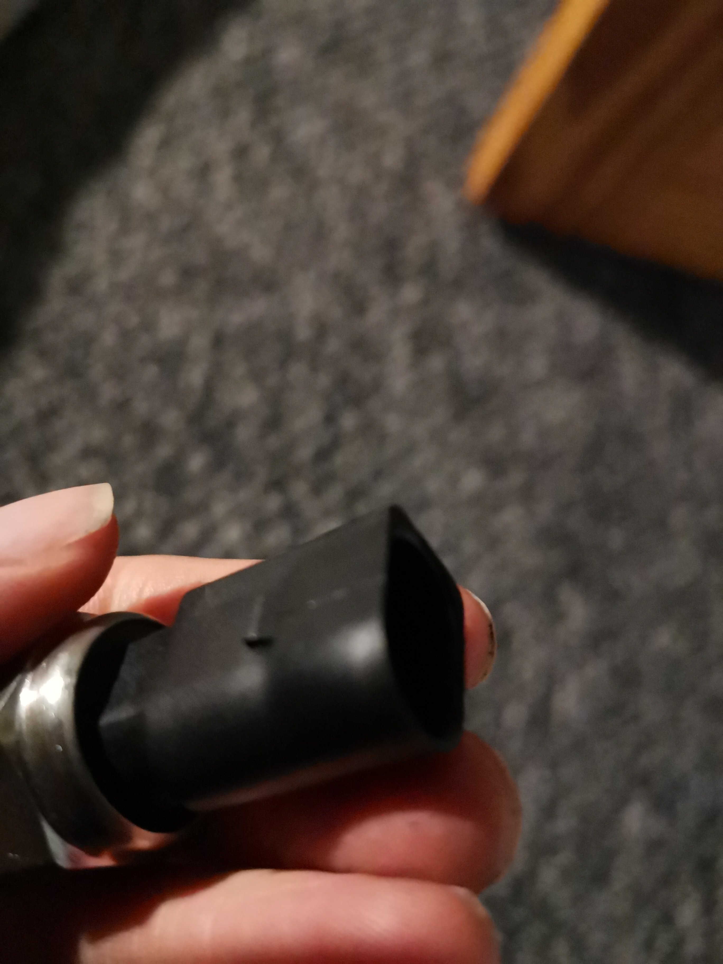

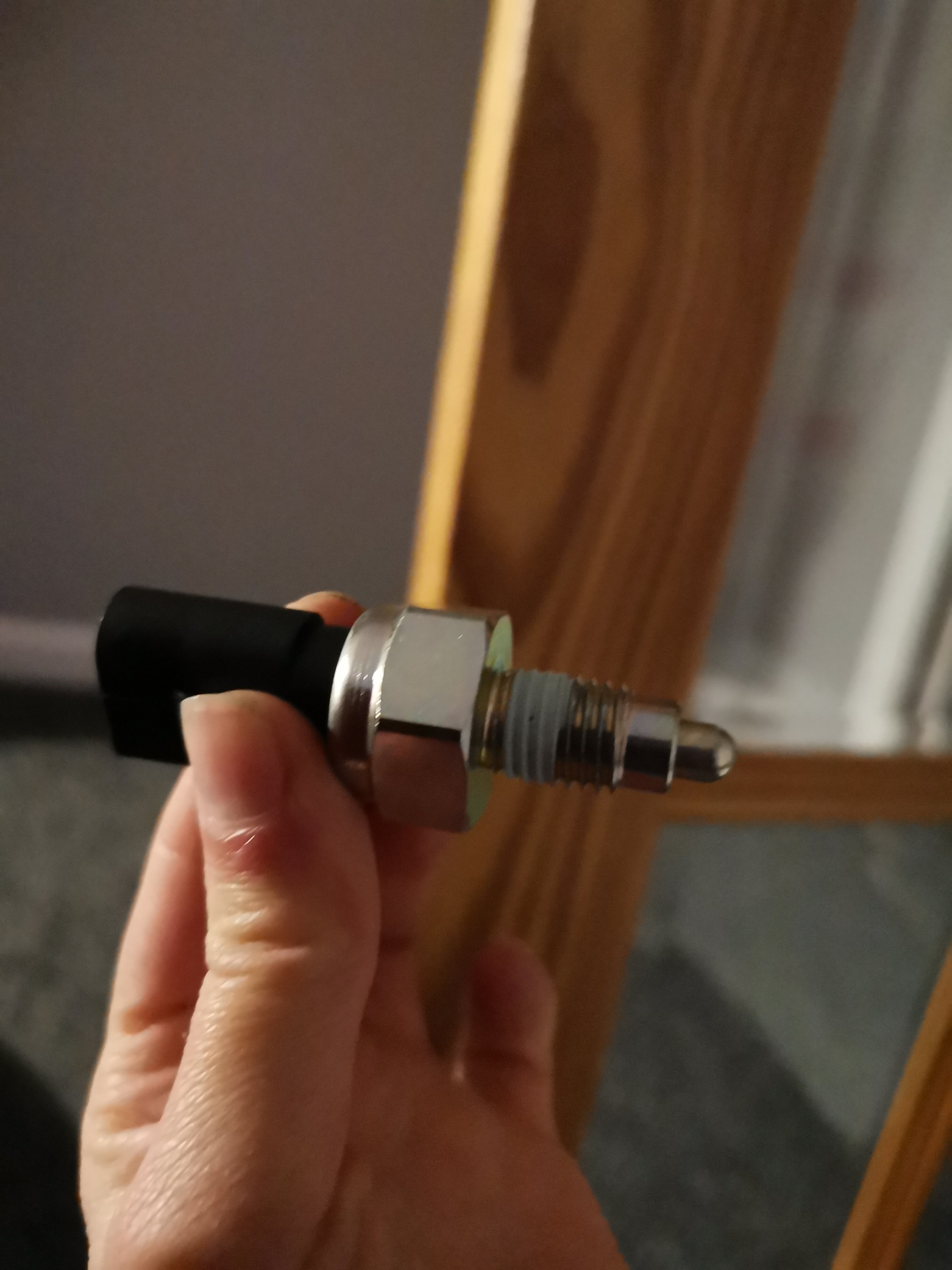

Also this is the switch I bought (not saying I'm going to fit it) but it doesn't look complicated to plug in, how come is it so hard to unplug the current one?

Are you following the suggestion about pushing the connector body firmly onto the switch before trying to release the latch, that's the 'secret'?
Look up youtube videos on "VW connector removal" if you can't picture what I mean.

I was , there was some play there but not enough, I was scared to break it. i have small hands and little confidence . thank you, I've watched and will practice on something more accessible, airflow meter sensor perhaps 😅

Personally I find a flat screwdriver that just fits widthways under the latch is best for releasing, then twisted gently through a small angle to lift the latch in a very controllable, limited way. Minimises danger of breaking it.

If i unscrewed the whole switch, would it not be easier to remove the connector? is it worth a shot with a spanner?
