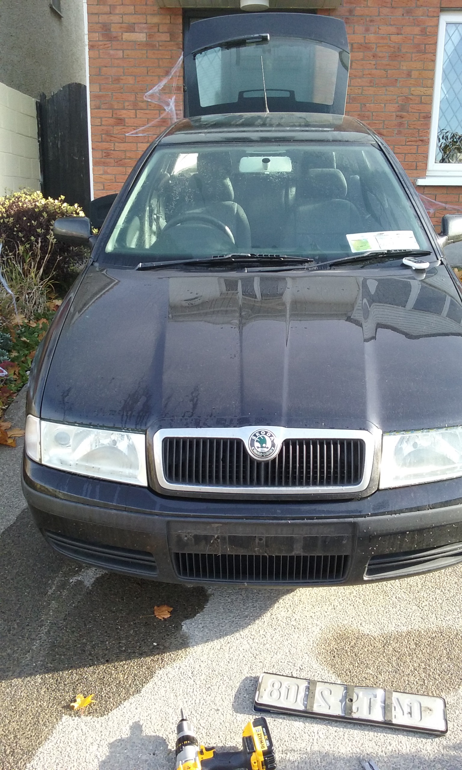

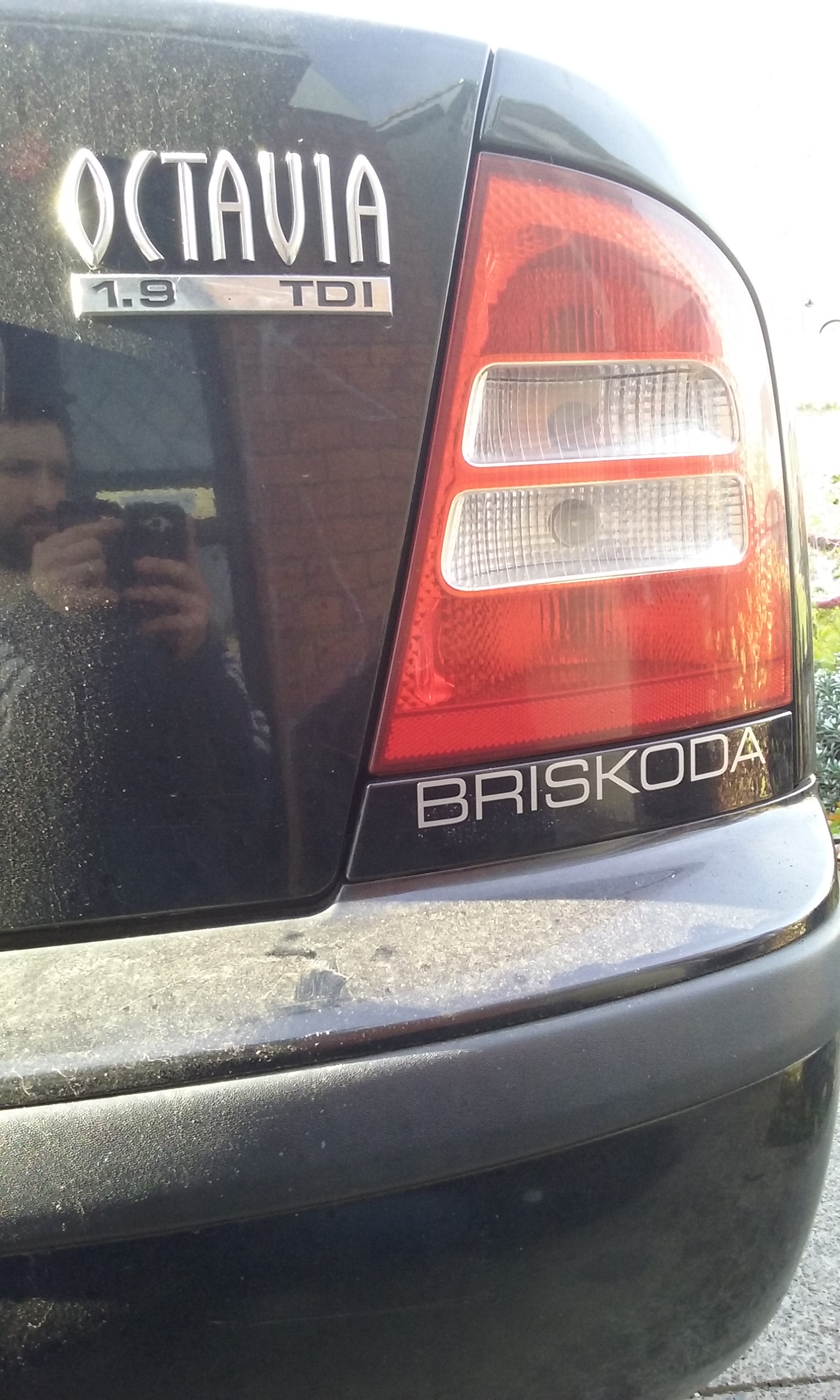

Pressed Plates came off as a souvenir   Brisky Sticker stayed on for the leaving

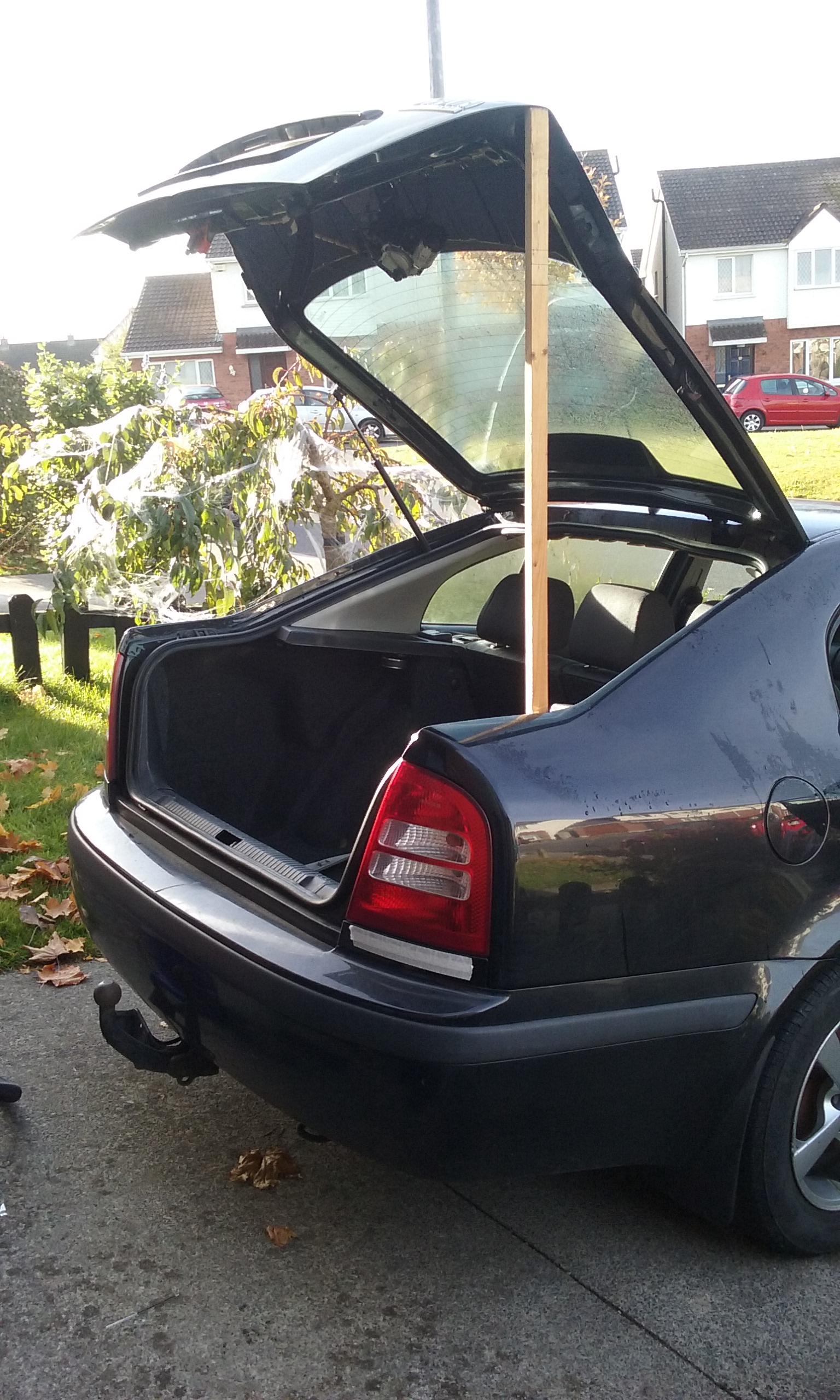

A Vital Piece of Lumber in the Octy's last days...

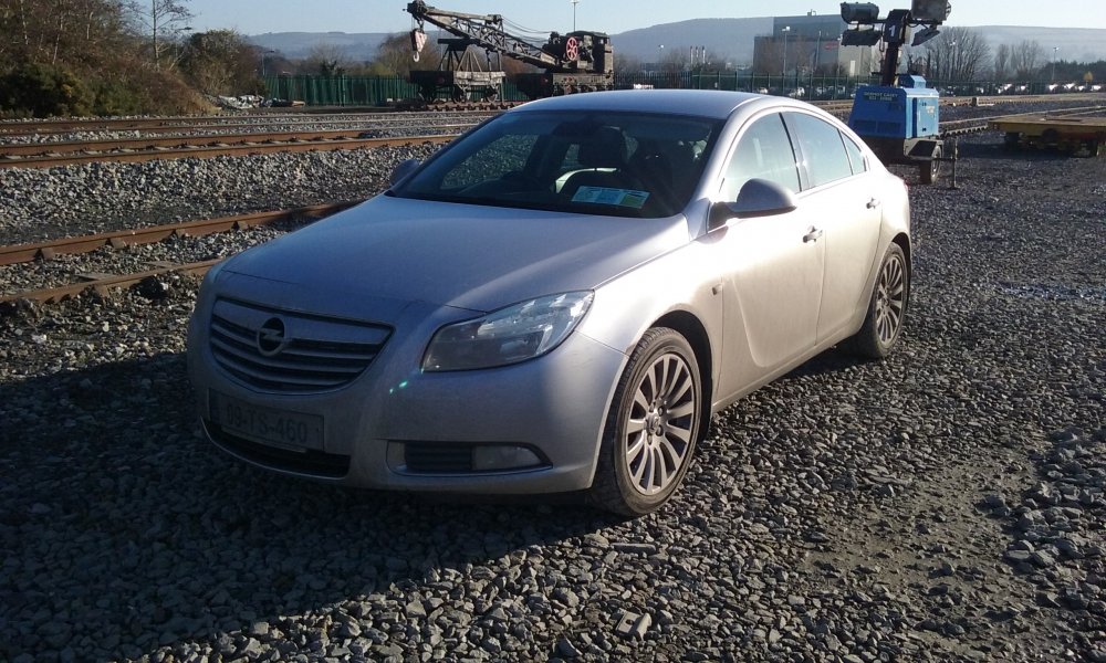

So, the first actual photos i got to take in daylight of the Insignia were about 3 weeks into ownership..
Took them at work in one of our compounds.
Jaysus, 23 days of ownership and its the same colour as the ballast...

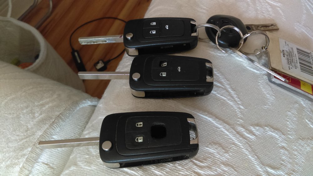

I have also ordered 2 new front bearing kits but theyve not arrived yet. One of thems definitely gone, but i cant gauge which side, so sod it, doing both... regular mech can do that job when hes back and they have arrived.

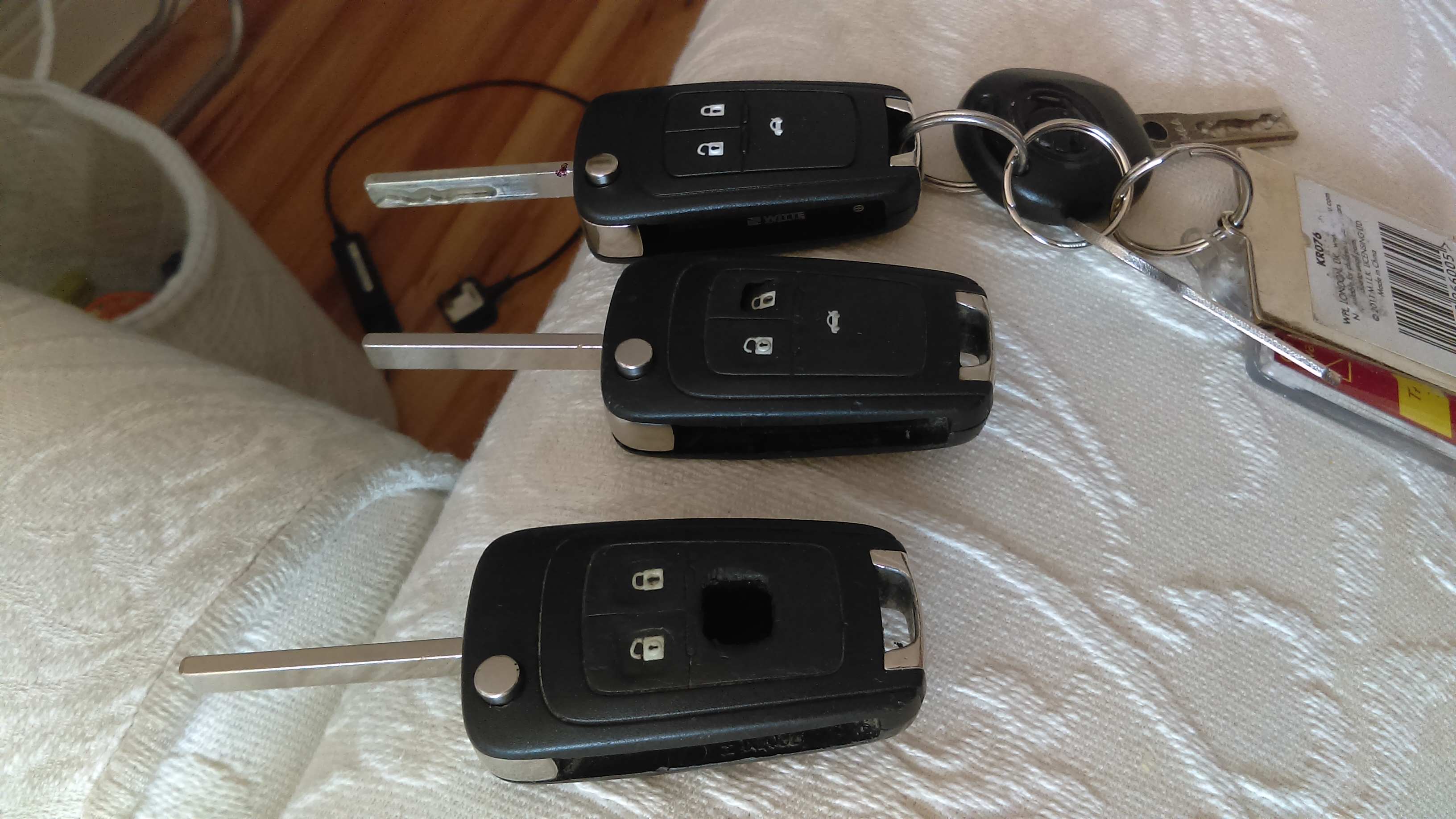

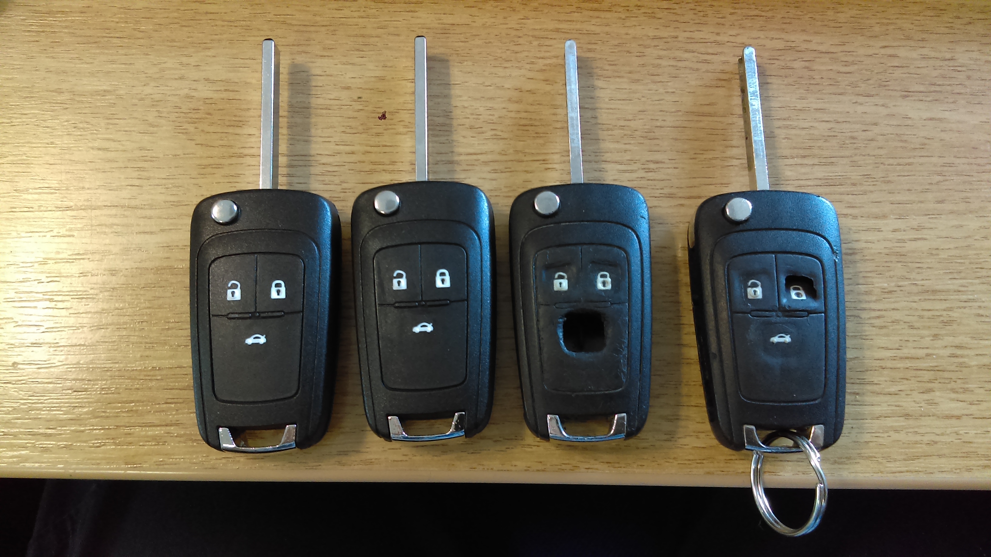

I had also got 2 new key cases as the existing ones were fairly knackered. 12quid off ebay, they even came with new blades and little opel inserts for the back.
Spot the difference...
Problem - got quoted 35quid per key to copy the blades?!?!
And couldnt swap them directly as the new keys have a slightly different spacing on the spring mechanism.
Bit the bullet last night and found a neat panel pin that fit..
Disassebled the keys and squeezed out the little split pin retainers in the shafts, swapped the blades over and put them back together.
I now have 2 perfect keys, and saved meself 70quid in 15mins..
