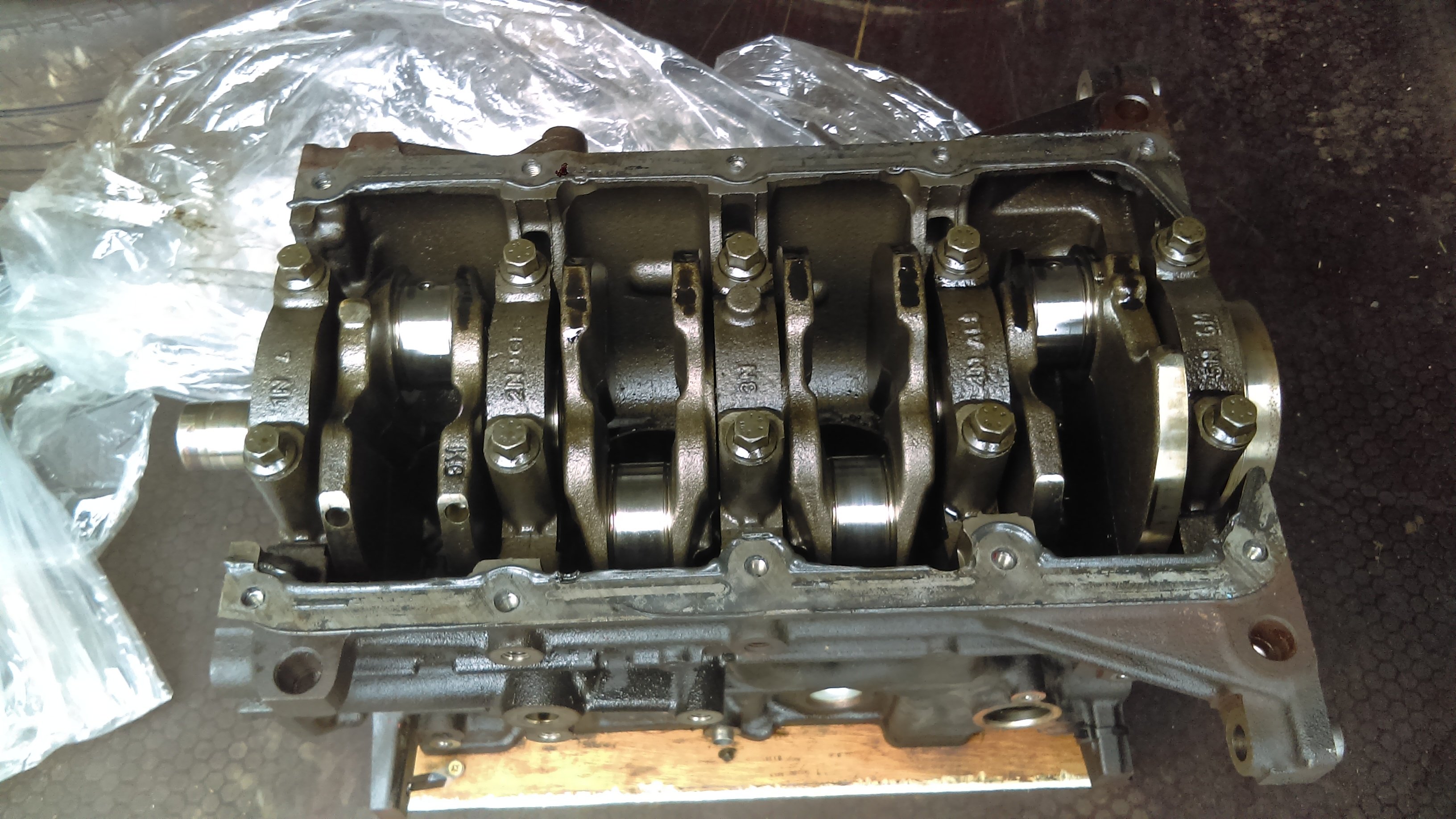

It turns out it wasnt the piston bearings. It was the main shaft bearings (3&4 left to right in the pic) so the block may actually be damaged also.
He is sending it to a re-conditioner in Poland as they have a way of fixing the block wear and i think fit a thicker bearing ring which no-one here is doing.

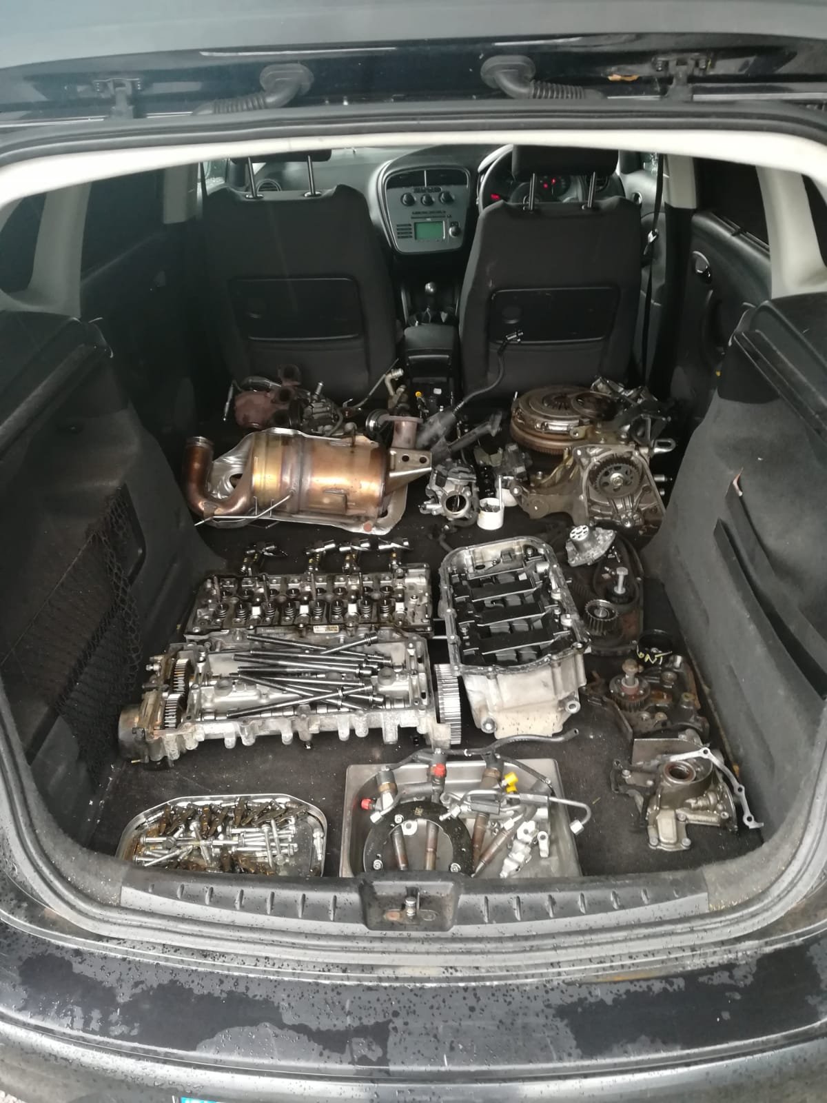

The rest of the engine is in the back of a seat altea
Fair play to him, but I'm really surprised that's worth doing.
Gaz
@V6TDI
Well, he is Polish, and he sends stuff over and back regularly, iften buys new parts from Poland as they are cheaper than here for identical bits. He got my Sachs/LUK clutch and DMF kit shipped for 150e less than the same kit here.
The guys there will assess the block, and if its salvageable they'll repair and return. Then he can rebuild the engine, and sell the insignia, make a few quid profit for himself.
If the block is too far gone, he'll strip the rest of the car as spares, and make a few quid that way.
He doesnt want to just buy a 2nd hand engine as he is very very particular and takes pride in what he does, so doesnt want to put an engine in it that may go the same way in 6months for a new owner who would be less than impressed. So if he if got a replacement, he would be stripping that all the way back too and refurbing, so it works out for him a lot less labour intensive.. and saves the cost of an engine..
