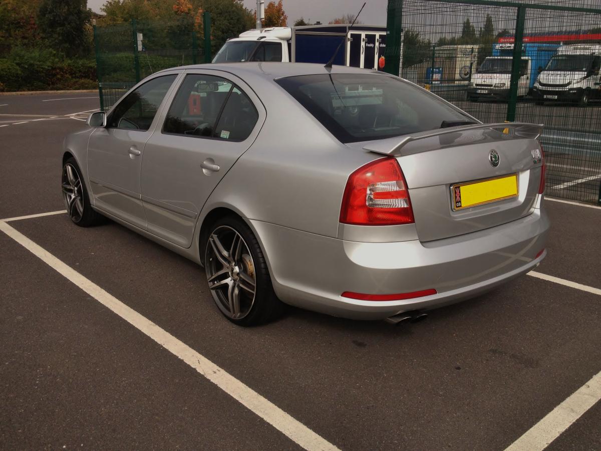

I purchased this VRS - for £6000 - IT IS LIKE NEW !!!! it has 56,000 miles on the clock - FSH.
It now runs perfect  - just with the EPC light on - but I am not comfortable with it - SO NOW selling my PRIDE & JOY
If anybody is interested they can have it for £3000.
