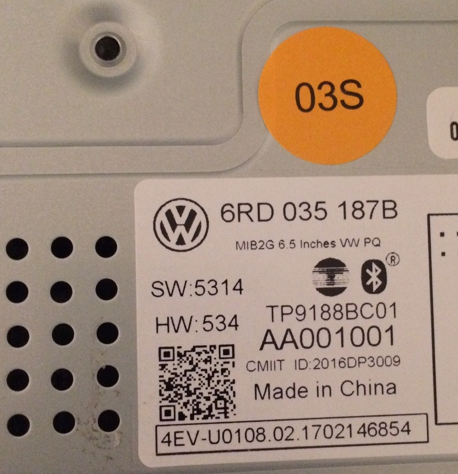

  • I have a VW 6RD 035 187B currently fitted in my Rapid.   Plugs directly in & no code required. ( just needs a 2 into 1 antenna lead apapter.) This one has Apple Carplay and green ba

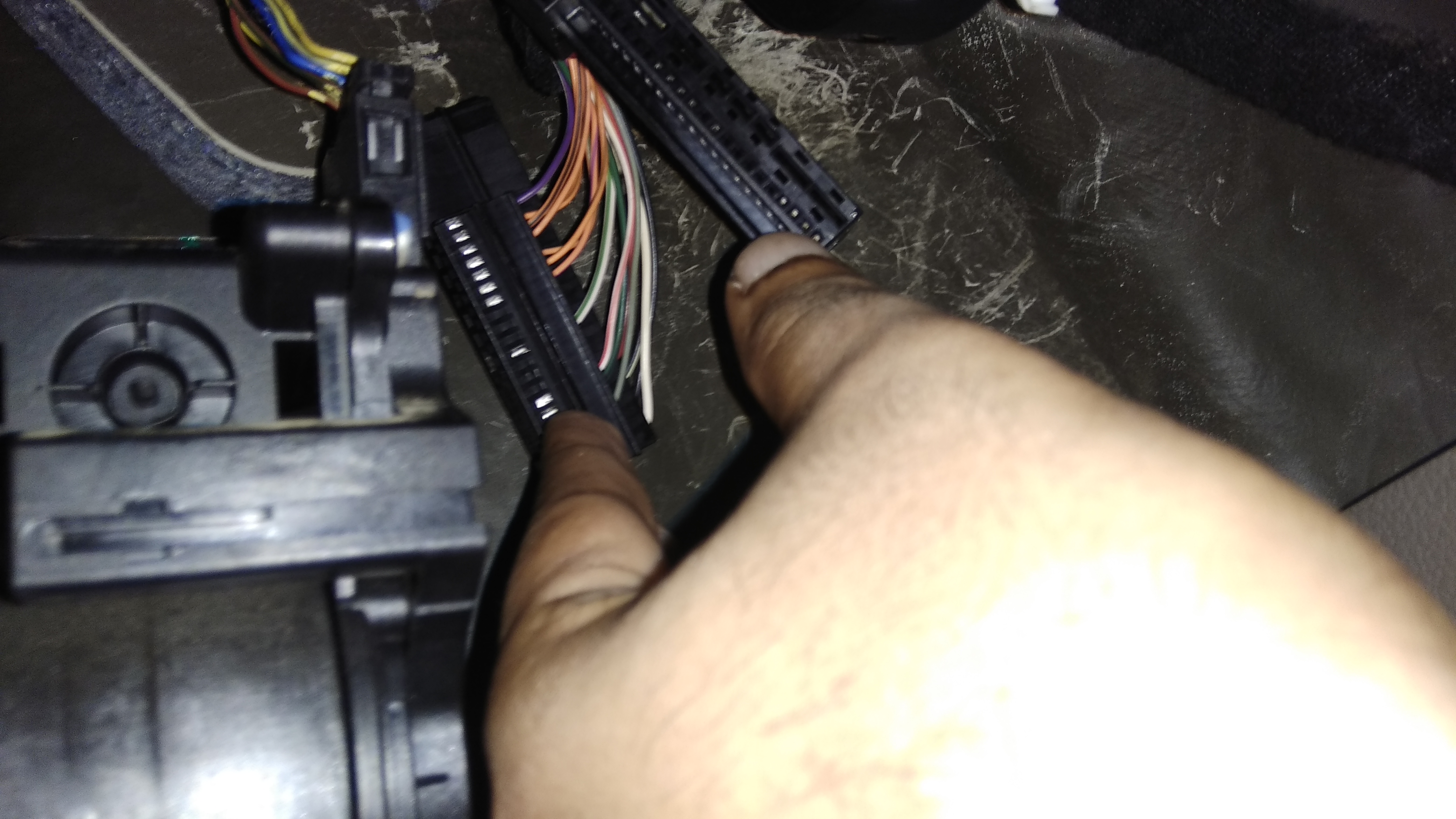

I have opened the BCM connector and to my surprise i  found 20 and 21 Pin are already connected with Orange wires.  Now wondering what is the solution now?

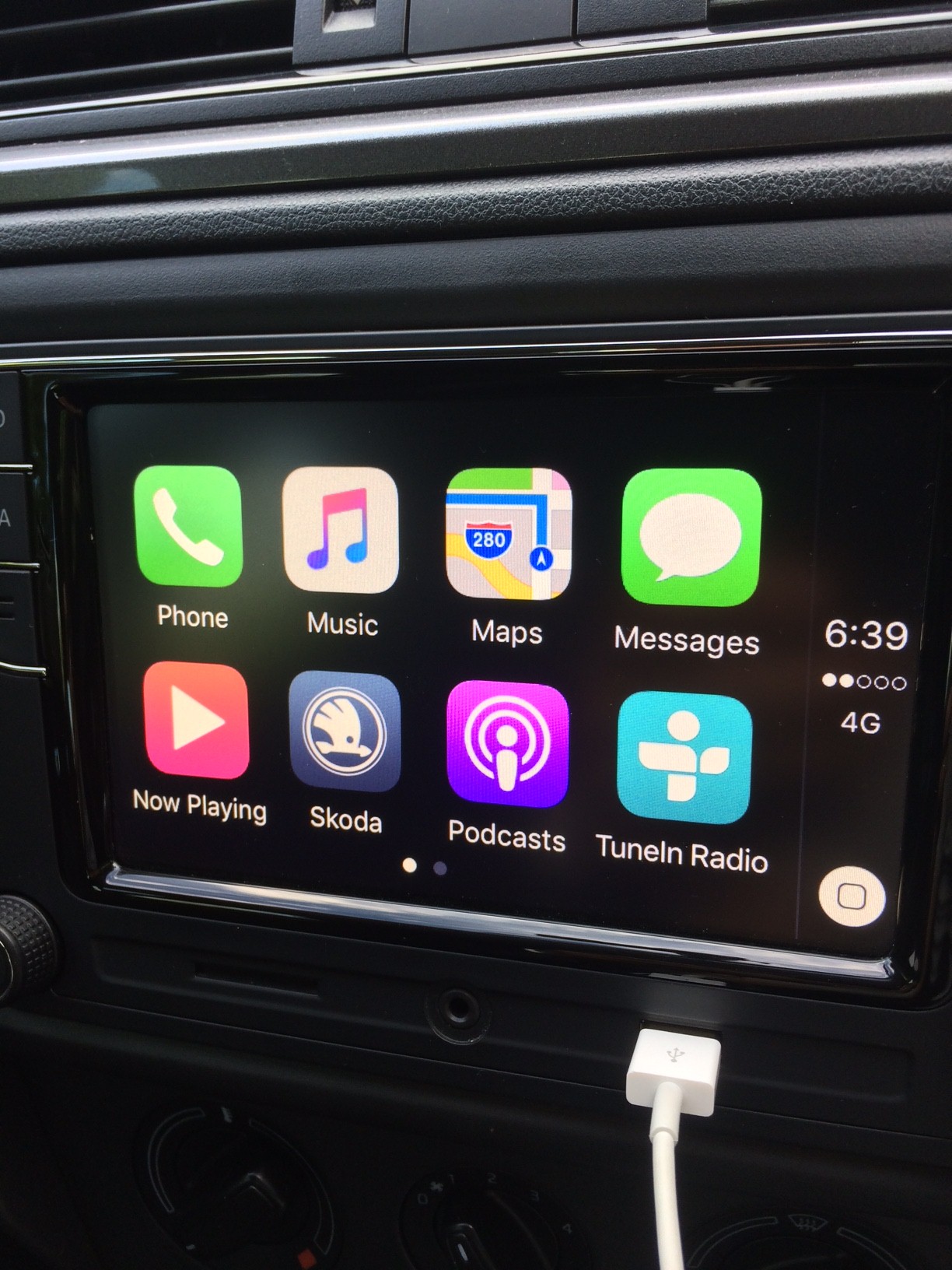

This one has Apple Carplay and green back lit buttons & also the Skoda logo on start up.
Multi function steering wheel works with it.
Supports rear vision camera too. (default on.. to code off set byte 3 to 00 [40 is on])

Apple Carplay works well. Haven't tried android phone.

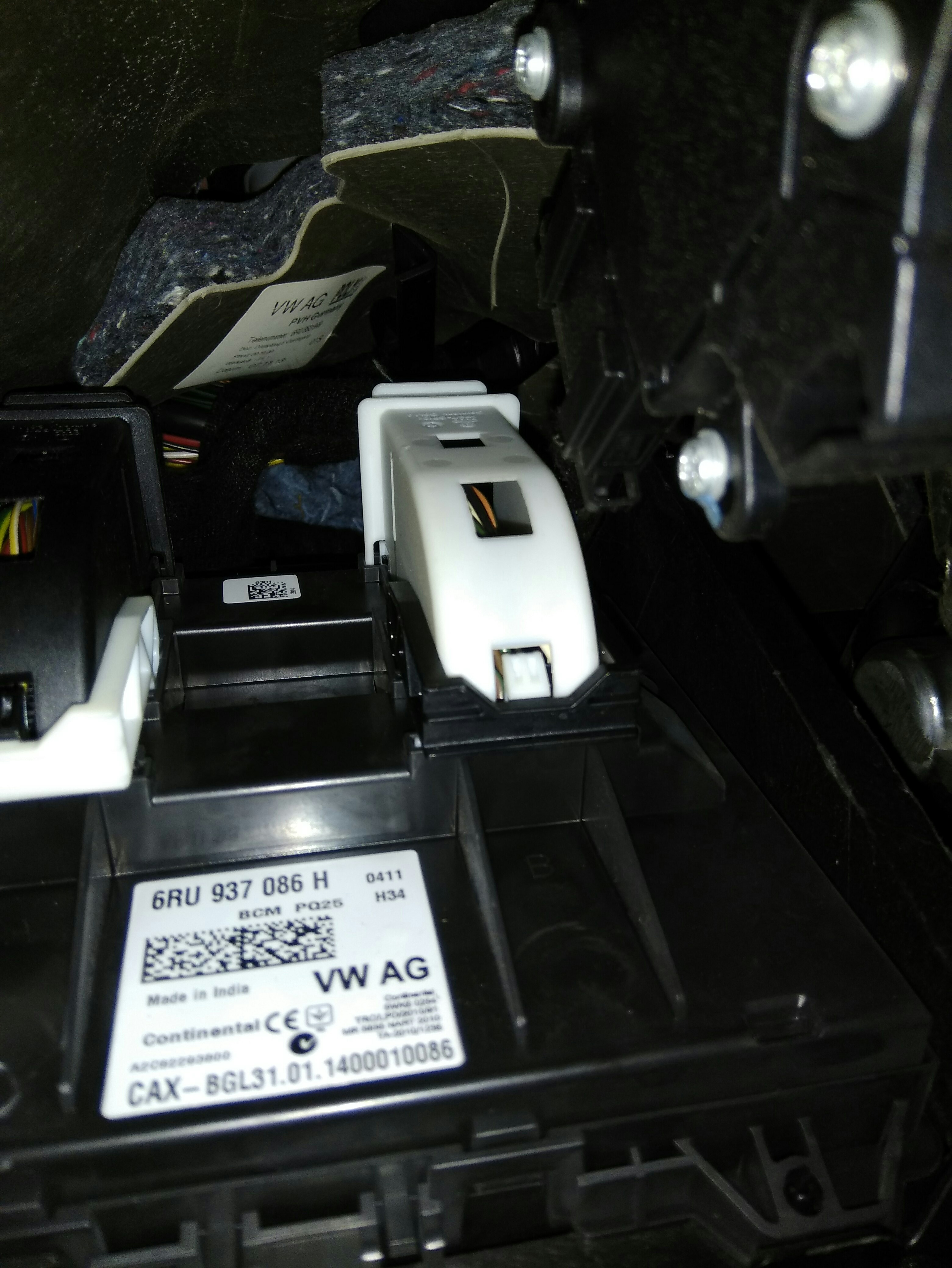

Hi Aromal,
Sorry for the delayed response. Could you please share me the pic of BCM ? also pic of BCM part number.

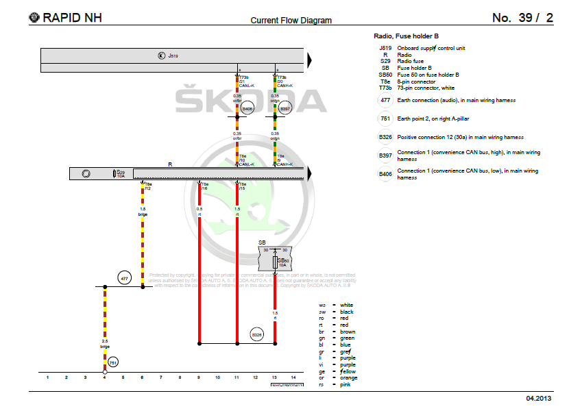

Yes it can be done. Mine, i replaced RCN 320 with RCD330g plus. Everything works perfectly, Steering controls works fine.
Exisitng can connection on the iso didnt work for me. I had to connect CAN from ISO quadlock to BCM
I would suggest to know your BCM pinout config before doing anything. As Aromal faced issue in connecting

Thanks for the excellent information. This is really helpful. Mine is the 2015 ambition with steering wheel controls and black MFD.  I faced the same issue with Harman rcd330 unit with the CAN connected to the ISO. Looks like I need to use the convenience CAN  from the BCM. I am guessing that the slot on the BCM will be empty in my case too as it is an Ambition variant.  In case of Aromal who has a elegance variant the slot on the BCM may be already connected to the climate control. He can probably tap it from there with the usual caution ofcourse. The plan now after your confirmation is for me to test with 5 inch variant I have and then migrate to the plus variant. The plan is to buy the noname version. I am really sorry to trouble you but you don't happen to have information on how to access the BCM do you? The connector pin  on the CAN necessary?  Thanks once again for the reply. Really appreciate it.  One more thing if Aromal is using the desay version it is likely the steering wheel controls may not work. Not sure though.

On 8/7/2017 at 14:11, Manoj1135 said:
Hi Aromal,
Here is the Pic of BCM and Connector assignments.  Hope you can read it.

I managed to get the Harman Rcd330g working today on my Skoda Rapid based on the inputs from Manoj. I got the CAN connected to pin no 20 and 21.  The steering wheel controls work except for the Volume knob.  I am able to mute using the volume knob though.  The guys at AliExpress informed me that the behaviour would be the same with the Desay version. They recommend  the Noname version for Skoda and state that all steering controls will work.

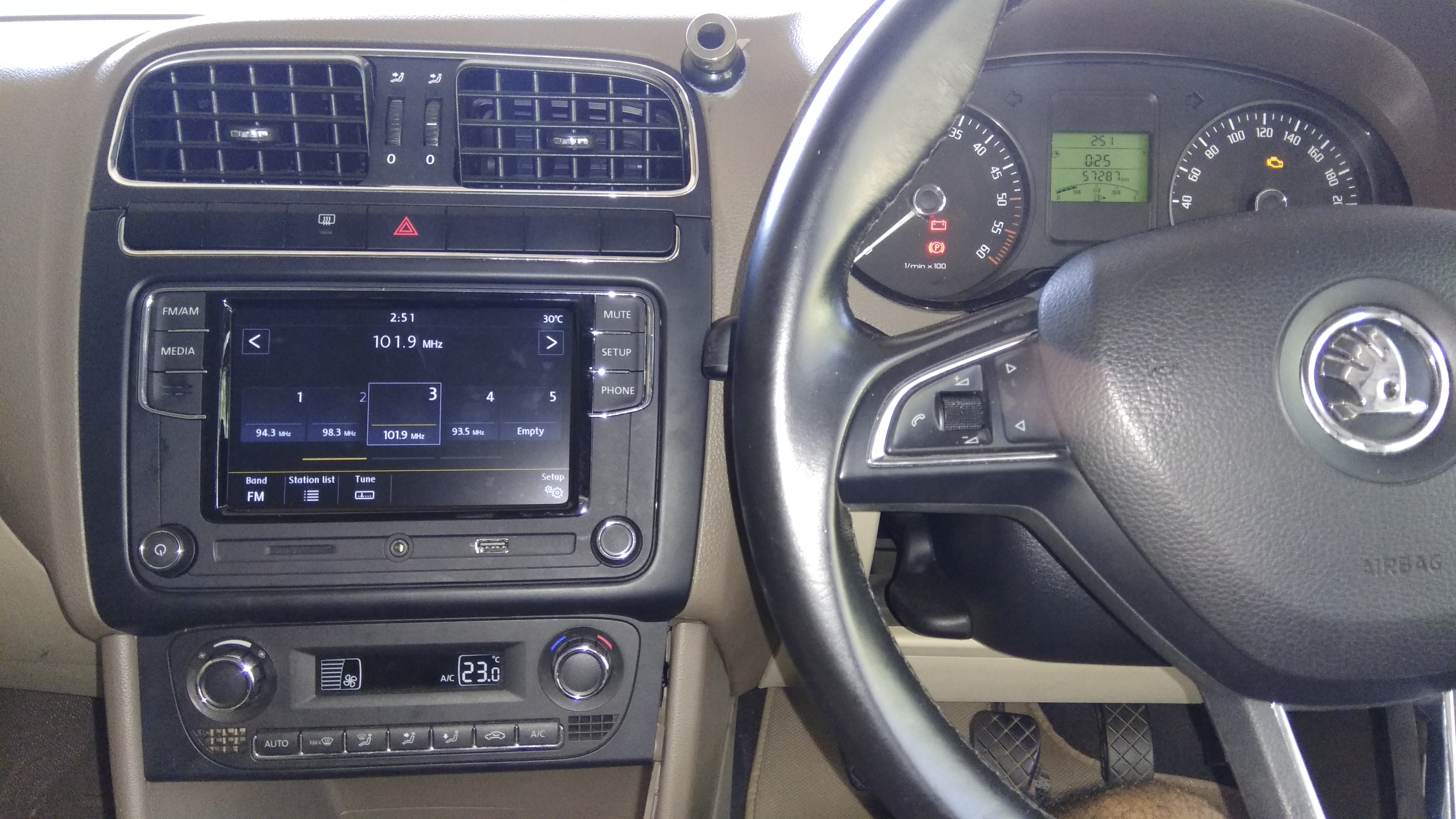

Finally i have installed the rcd330 plus after tapping CAN  from ACC. Here is the pic.
Awesome... Congratulations..
