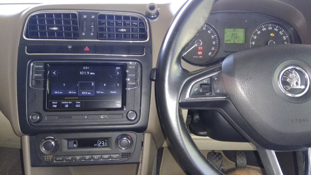

I Have retro fitted RCD330  to my Skoda Rapid Automatic ( Elegance Petrol ) using a CANBUS Adapter bluetooth, Music , radio everything works fine except the Time which is not sync with the car time. could anybody help How can we fix this
Thank you.

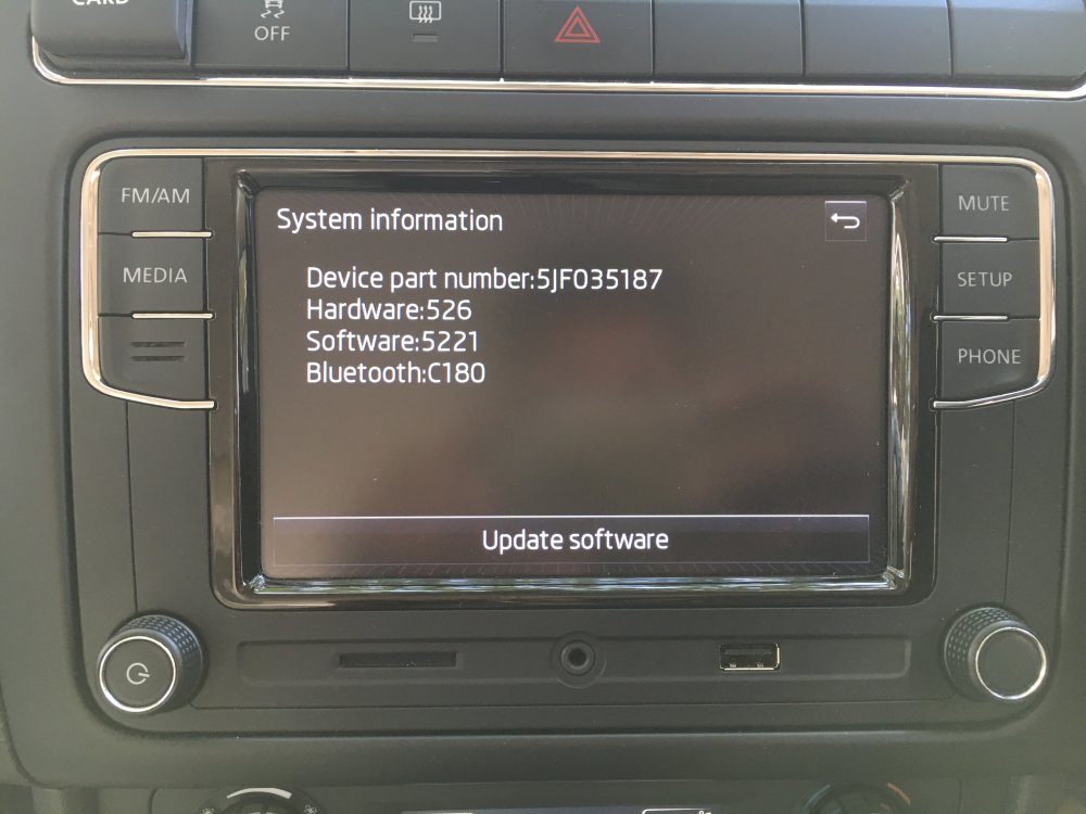

I bought a Skoda Rapid 2017 AT edition which comes with Mirrorlink. Is there any way that I can get the Smart-link(Android Auto and CarPlay) capability?
The new Rapid comes with Smartlink enabled. Can I upgrade the software in my headunit to get the Smartlink capability?
I have attached the hardware and software versions.

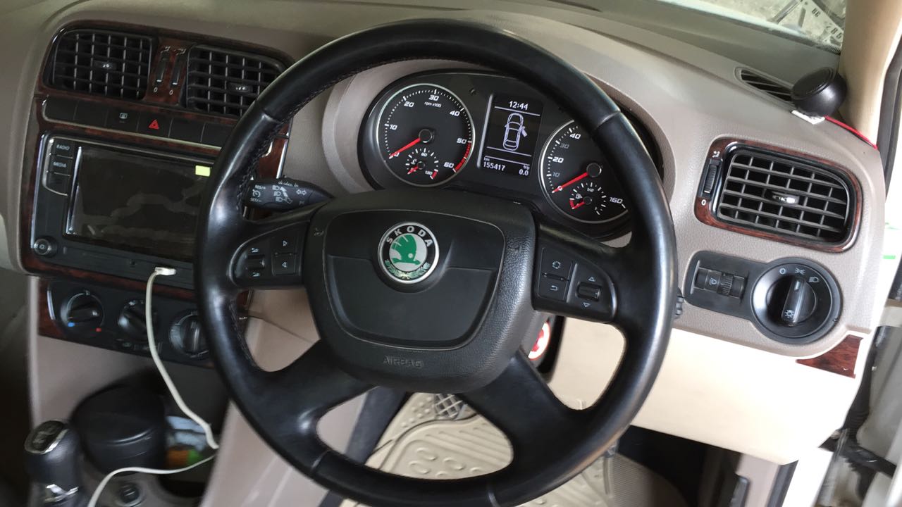

Hi,
Can somebody help me, my Volume control key is not working on MFSW
I have retrofired Multi Function Steering Wheel (MFSW) of My Skoda Rapid Ambition 1.6 TDi 2012 Model.
I have also upgraded my Normal HU to RCD330 Pluse Deasy, skoda green version (Prat No. 6RD035187B) .
Also done all connection with ISO -Quad lock including BCM. And installed MFSW which from skoda Subparb or Octavia.
I can make all control working except volume control + as well as - key. Since mute button is working same key  but only volume control is not working I know key module fully functional and working fine. I also swapped with other key control module to check. but same issue with that also.
is any one know why my volume key is not working. I have attached image of my steering wheel.
Regards
Amol

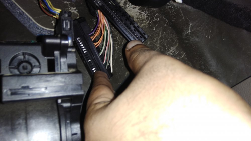

Have you upgraded gateway ? Checked pin configurations ?
Thanks for your reply,
Gateway! you mean BCM?
Yes I upgraded my BCM as well as.  my old BCM was 6RU 937 086 B PQ25 & now I am upreared to 6RO 937 087R. Also about Pin configuration, I connected can connection on pin 20 & 21 from with connector on BCM.

I feel some VCDS coding is required not sure though, Also pin 20 and 21 were for PQ25 series BCM.  I'm not sure same pins used in 6RO 937 087R,
