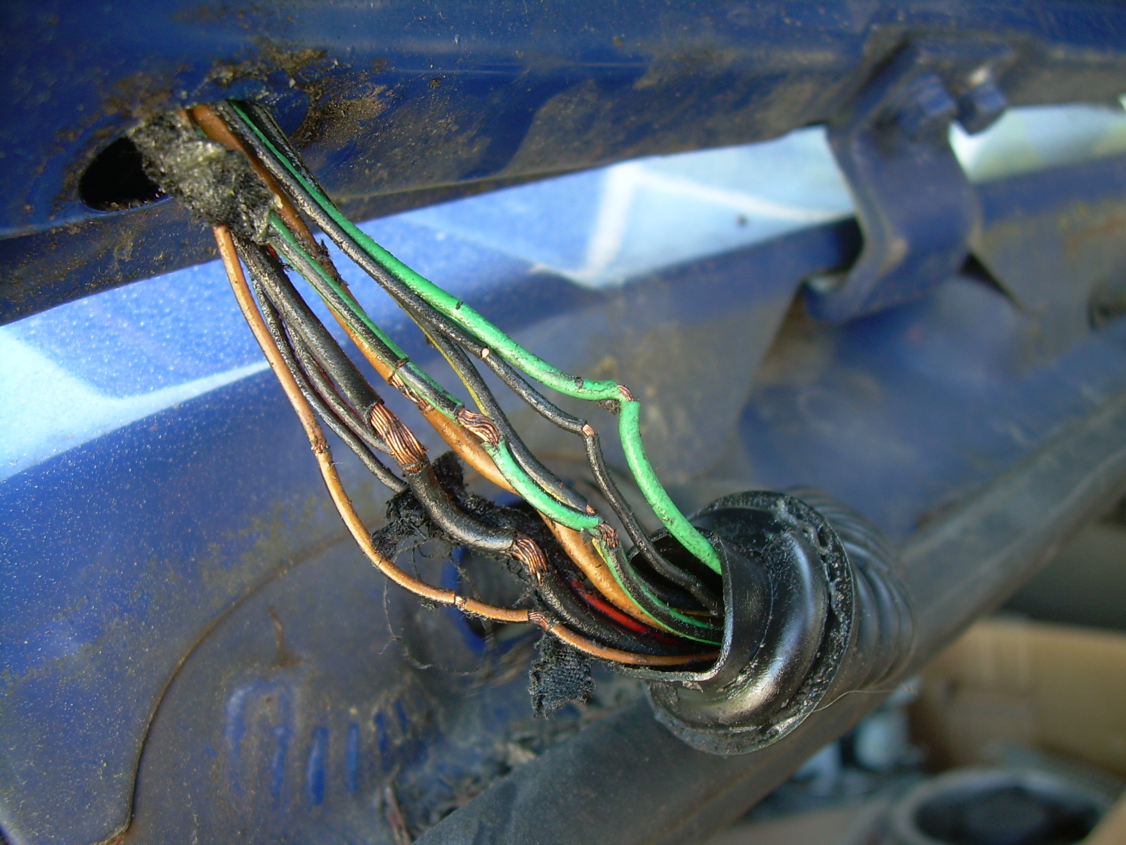

Hello RichardoM and all You others. Of cause I did not measure the resistance from the wire to the ABS unit, as RichardoM kindly asked me to do. I am lazy, and it looked, as if everything was all-right, but it was not! Suddently I got blown fuses again, and I ended up, disconnecting the multiconnector, sited behind the car left side back light cluster, the connector carrying all the connections to the back door, carrying the currents for the high brake light, the numberplate light and the back windscreen wiper. Now I have been driving with that connector disconnected for some 10 days, and I have not had any blown fuses. Now I suspect a fault to be, right where all the wires goes through the rubber-tube out to the back-door. It is dammed cold and rainy now, so I'll wait some days, before I go further with the repair. I promise I will write You the result. All the best wishes for You all from Denmark
Oh yeah, the rubber boot of the tail lid... Well known cause for electrical faults. Most probable it's the black/red wire that has cracked insulation and touches the ground.
  • 1 year later...

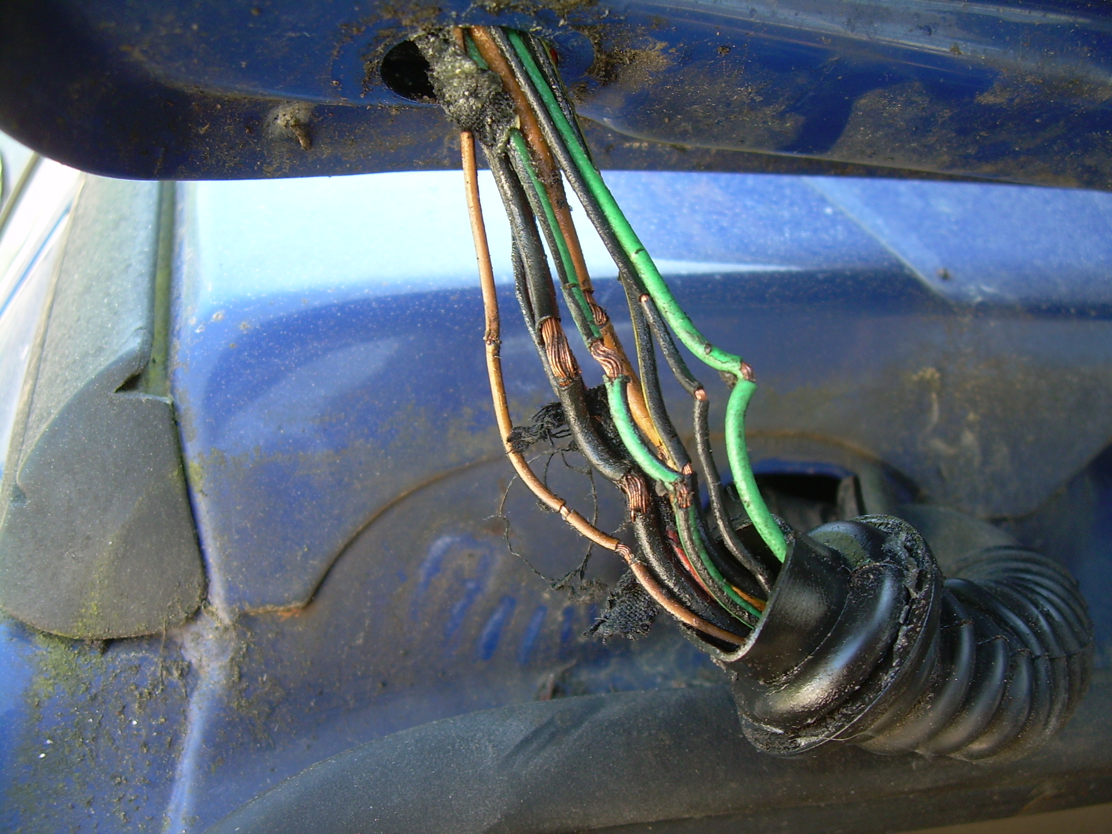

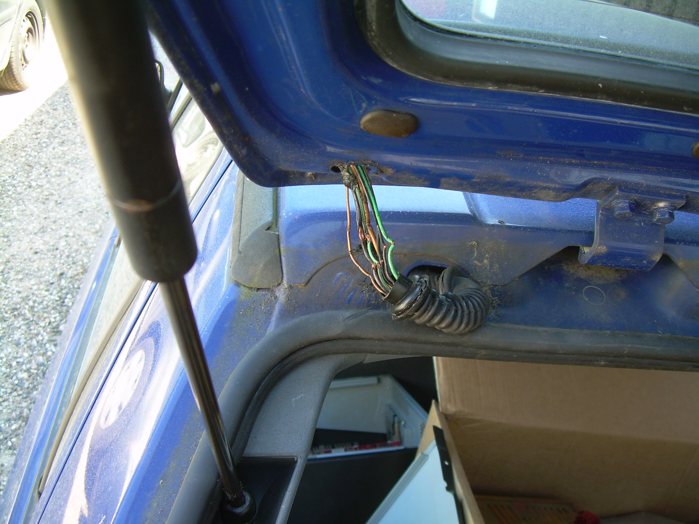

Hello everybody, who took time to read my questions, and give me suggestions. As I am a lazy ******, I first now did something with the fault. I sprayed the rubber hose between the roof and my tailgate, for making the flexible hose soft again. Now I have taken the hose out of the holes, and I found the fault. I made a lo-quality repair, by putting insulating tape around each wire, and at last, around all the wires. All things now functions in my tailgate, and no fuses blows. See pictures. Thank You to all of You, for advises.
@SoerenfromDenmark - I'm seeing an electrical fire waiting to happen there.
Exactly, @KenONeill. Hopefully he'll have the fire extinguisher ready.

Are there any unfused feeds there?
