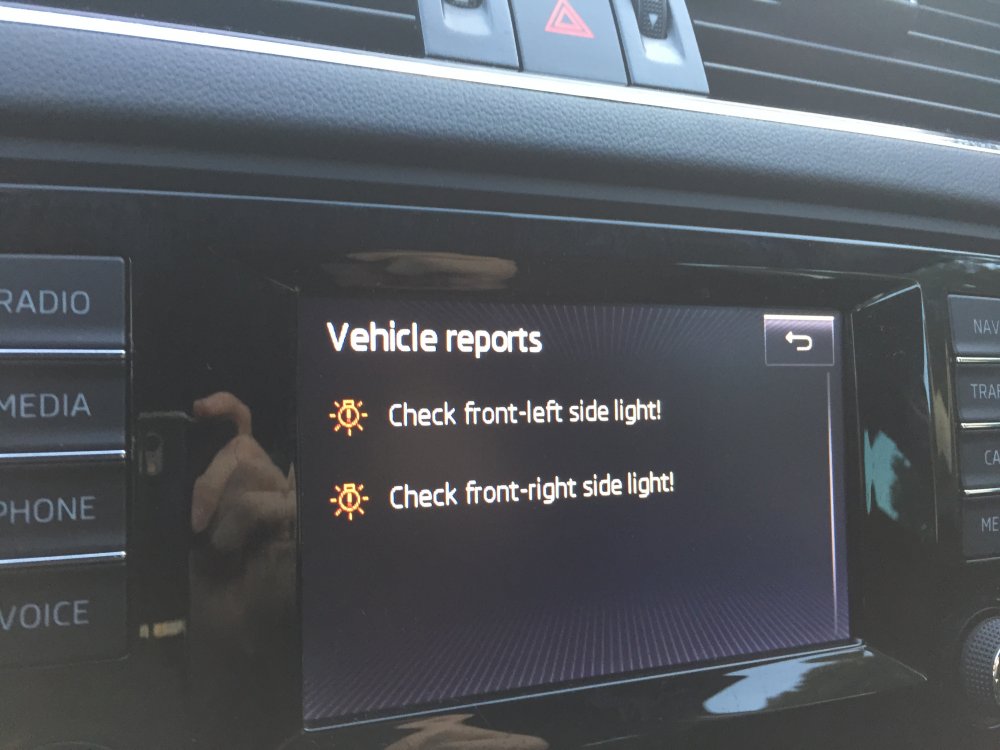

I have a 2014 L&K with Xenons.
After a long saga I have two new headlight units and one new side light. They where letting in water after a front end shunt. Apprently they got hairline cracks that killed the LEDs..
I am now getting an intermittent 'check right hand side light message'.
First of all, when you have Xenons with LEDs what is meant by the side light? It is not the LEDs as they had there own message. Is it te two lights at the bottom of the bumper? These are the ones that turn on when you turn left and right. Both appear fine.
I cant see anything wrong when the warning goes on. It also sorts itself out after a bit of a run.
Any suggestions?
I have VCDS if needed.
Thanks

Side lights are the 501 bulbs. The picture below shows the side light position symbol.

It does still have 501 type sidelight bulbs in each side, despite the LED DRLs dimming in "sidelight" mode.
Have you physically checked this is still working? The holder twists out from the back of the headlamp unit to reveal the 501 bulb in holder.

Unfortunately this isn't true. There is - as someone else has said - a 501 bulb. It's located behind that large silver reflector type object in the light cluster.
Should at least be an easy fix then!
Yeah I replaced my sidelight bulb with an LED, it's very easy to access. The big circular cover beside the headlight bulb cover, so the innermost cover if that makes sense.
Thanks All
I can confirm that the side light and the LED DRLs are completely different. They are definately not LED like the DRLs. I will probably replace them with LEDs as I have some from doing my numberplate. I take it I will need to code the as well?
The side lights are simple to get to and just the push in type. fixed for 50p!

As the L & K use the same head light cluster as the Vrs the DRL's are also the side lights, they dim when the dipped headlights come on. If they are not used as side lights then they must go out and another bulb used to become side lights. But the DRL's don't go out on dipped headlights.  If you go into the light settings in the Car menu on the radio and untick the DRL box to turn them off they don't come on as DRL's ( dipped headlights off ) but come on as side lights when the dipped head lights come on.
Therefor they are Sidelight

I beg to disagree with a lot of these comments on here that the DRL are the side lights!
DRL lights are on regardless of moving the light switch to a position, now when you select side lights from the picture in the #2 post, then the DRL's dim & the side lights (501) bulbs come on, the reason for the DRL's to dim when you select the side lights is because another bulb has been told to turn on, dipped beam is still not on at this point as they are your main xenon D3s bulbs!
So by selecting side lights, which is a stage before dipped beam, the DRL's dim anyway.
Edit: This is if you have the DRL option ticked in the car menu settings.
Edited by BATVANVRS
The Octavia is unique by having a W5W sidelight bulb in addition to dimmed LED DRL's for the side light (and dipped headlight) function.
Both the MkII Superb and Yeti utilise the LED DRL's for both the DRL and sidelight function, there is no W5W bulb, the dimmed DRL performs the role of side lights by itself.
Not sure why Skoda fitted the W5W bulb on the Octavia, it is all but redundant, in that even with the DRL's dimmed you can barely see it.
What happens when the parking lights are turned on, does just the W5W bulb light up or does the DRL still light up too (dimmed)? If the latter then the W5W bulb is even more redundant.

DRL & side lights light up (DRL & 501 bulb) you can easily tell by looking at the claw within the light that the 501 bulb is lit but this is if you actually use the light switch to position to side lights & lock the car! but then I presume you guys are probably talking about using the headlight assist lever? which in this case would be parking mode you guys refer too?
