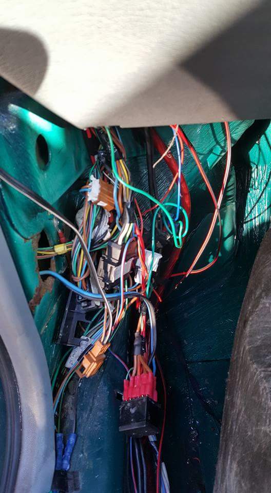

RicardoM, do you know where exactly the wires come out at the back by the panels?
Thanks as usual :thumbup:
Sorry I meant where do they come out for the rear speakers? As in, where are the wires run too? And how far do they require extending?
Thanks RicardoM!
Hi there the rear speaker wires are in the kick panels on brown plugs into broke a estate and have some wires the will plug in them long enough to reach the parcel shelf
There's a the brown plug for the rear speakers... its the one at bottom near the relays excuse the the rest off the wires that's all the extras....

That wiring mess explains a lot...
Sheffy
Since you don't have a Felicia estate, the wiring for the rear speakers is not present. On Felicia hatchback the wiring for the rear speakers goes only as far as the A pillar (see photos - 2-pin brown connectors). I think the photos are from TeflonTom's car.
There's the brown plug for the rear speakers... excuse the the rest off the wires that's all the extras.... heated seats abs 4 electric windows... leaking screen hence mess hand built not your average felicia any ways... as above that's what I am on about it have the wires removed from a L&K if you wanted a plug and play option for your rear speakers... all UK cars have the same loom unless it's a abs model
