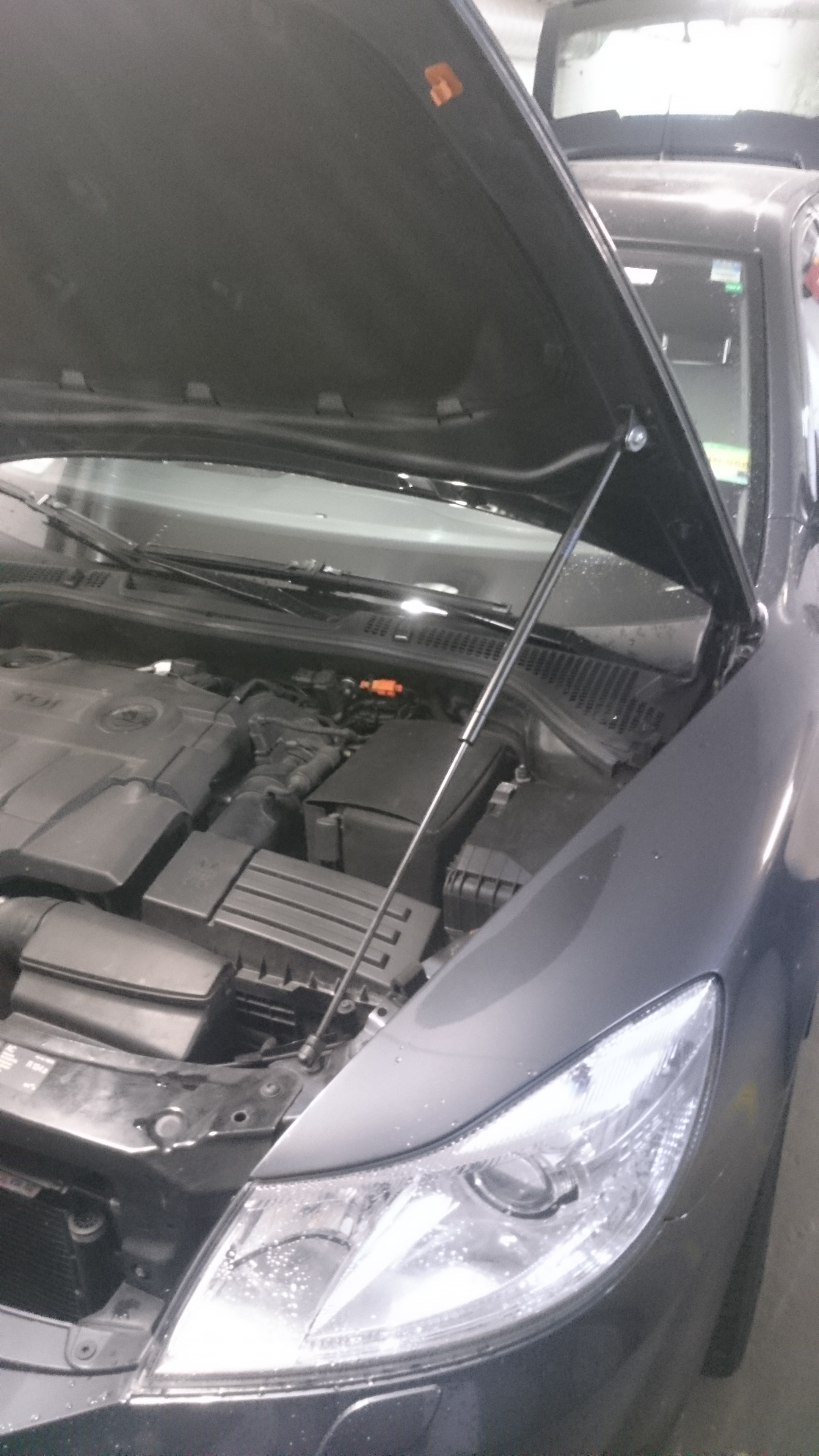

I have on my FL a home made kit :) You need a hood damper from an Audi A4 B7. Two ball headed screw, some screw pads and thats it. :) On the upper part better to put it from outside not like on the photo, i turned it too after the photo was taken... :)
