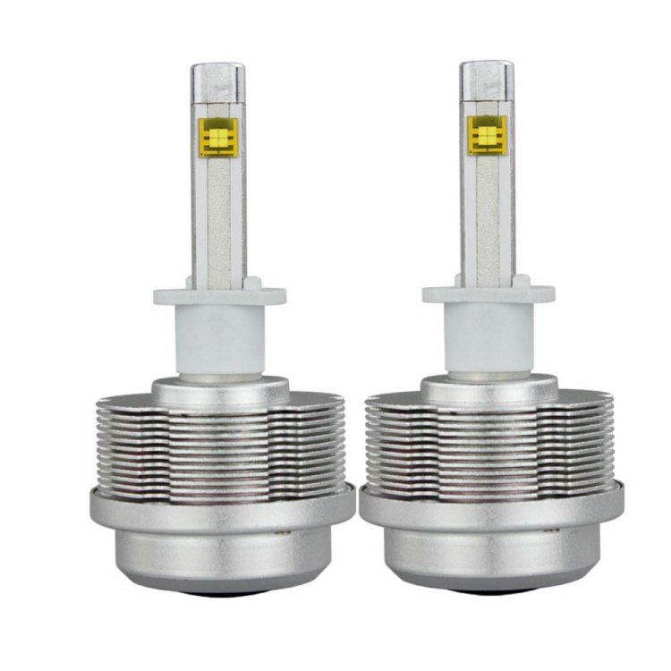

The only downside is they are quite bulky so not sure if they will fit in behind the headlight covers?
hot-sale-H1-Generation-2S-LED-Car-Headlight-ETI-Flip-Chips-12V-Car-Headlight-30W-3600LM.jpg
