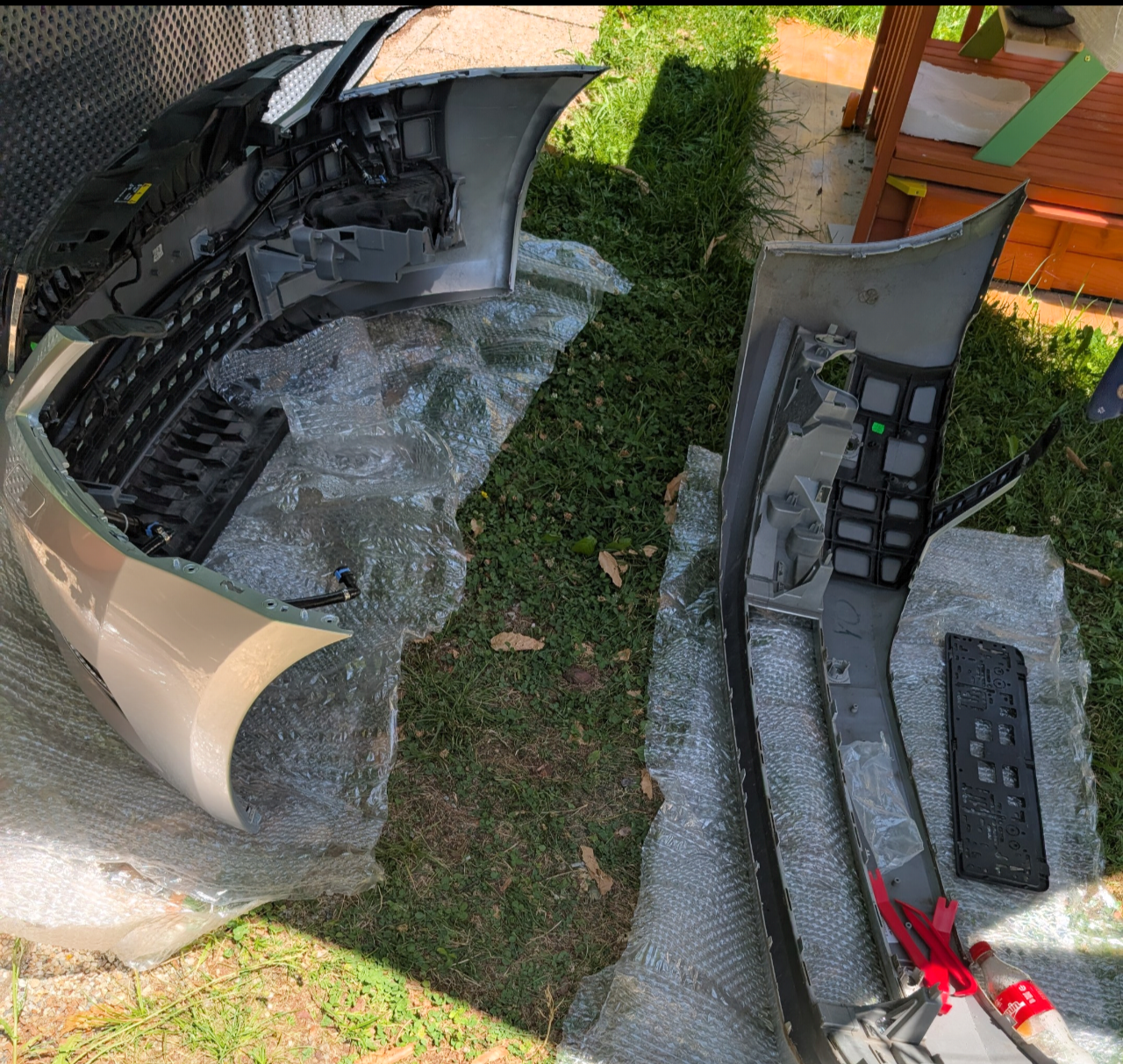

- Removing the entire old bumper
- Removing the headlights
- Removing the old washer fluid container

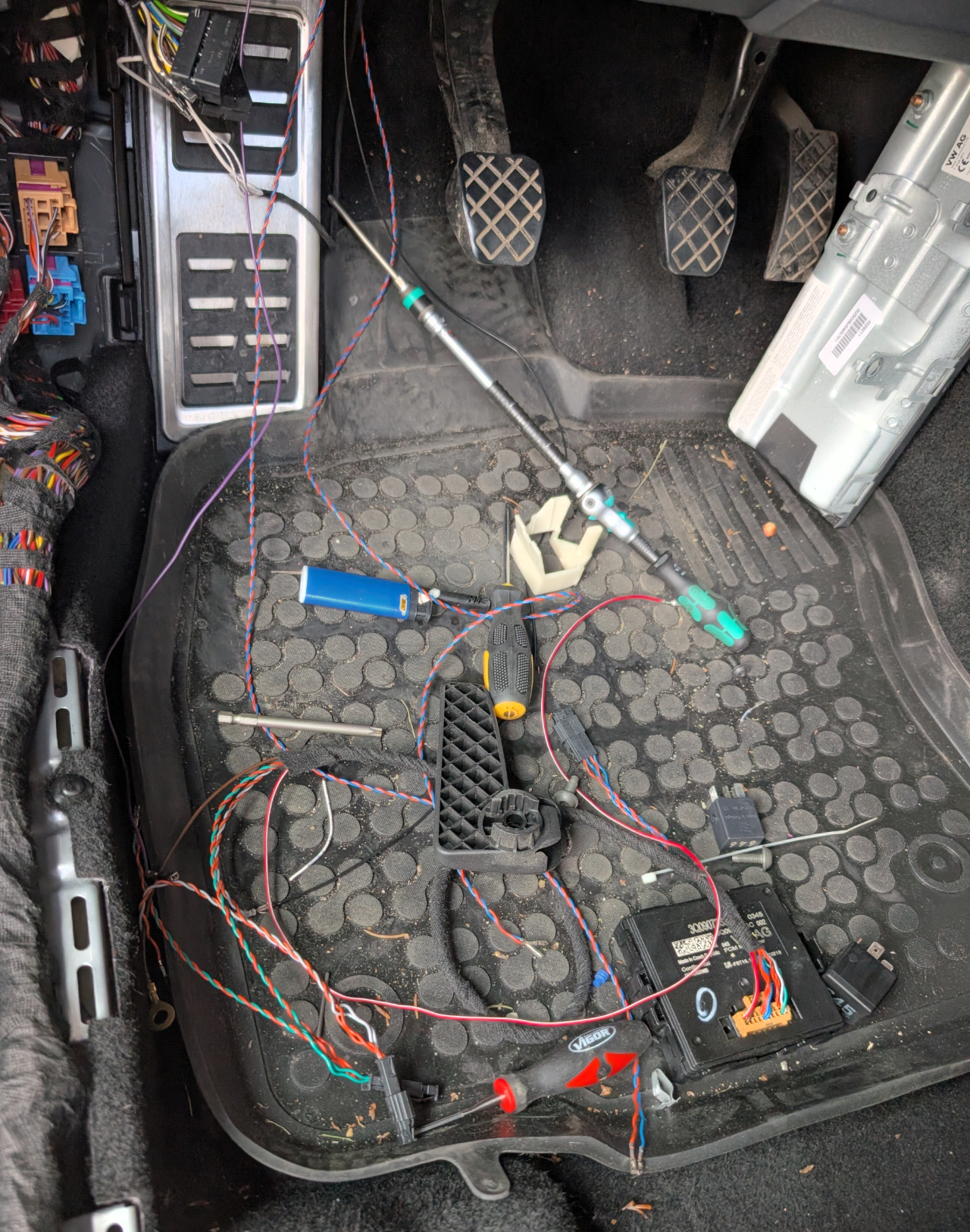

- Installing the wiring harness from the headlights to the bulkhead and controlling the headlight washer system

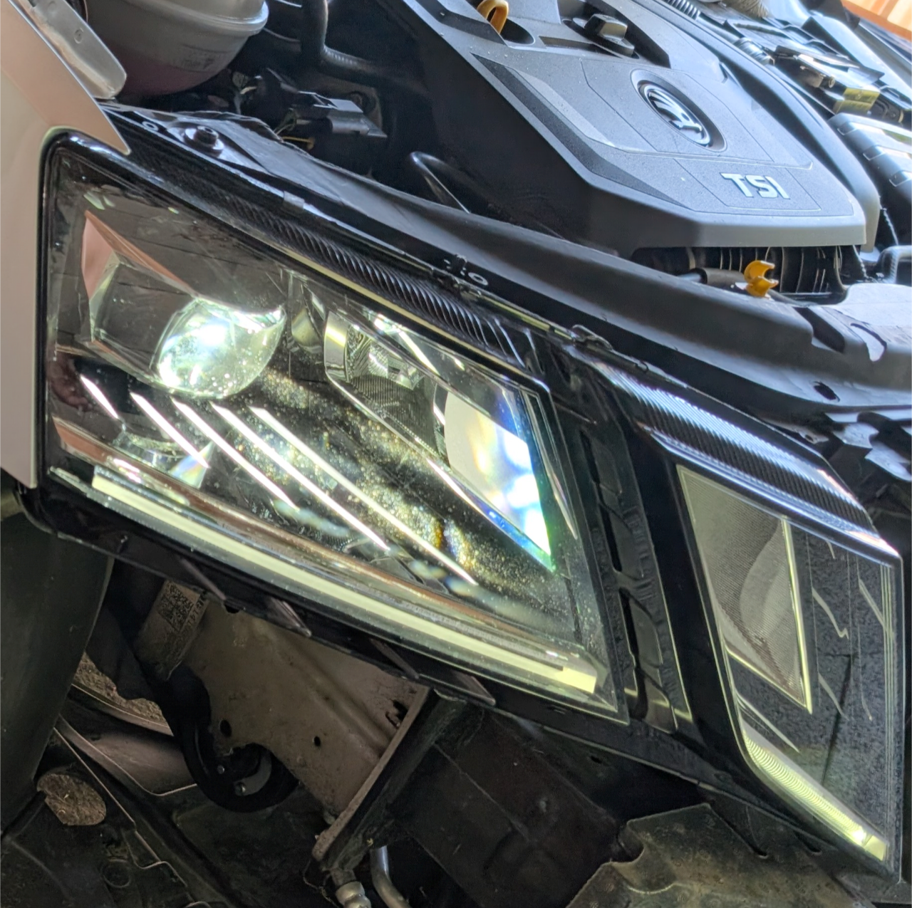

- Then I roughly installed and secured the LED headlights.

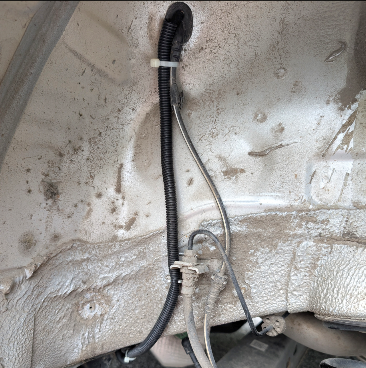

The wiring harness consists of the left headlight, right headlight, rear axle level sensor, and the 4B control unit.
The wiring harnesses are routed in a slotted corrugated tube for protection.

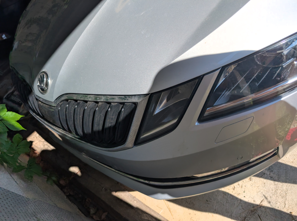

What's the situation today? The headlights are already wired correctly. Then the old bumper was completely disassembled, and the parts were installed on the new one with the headlight cleaning system. Today, the bumper was test-fitted and connected. The error log was erased, and except for the message that the axle sensor is faulty,

So, today the conversion was technically completed. 🥳

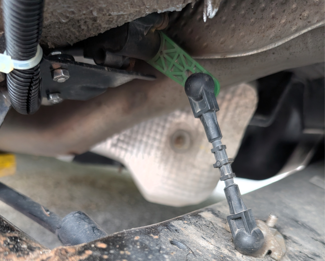

The rear axle sensor was installed, wired, and connected.
