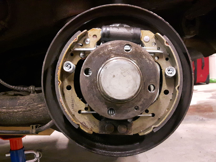

I have finally done both rear brakes. Replaced all parts, except the drum.

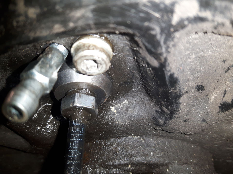

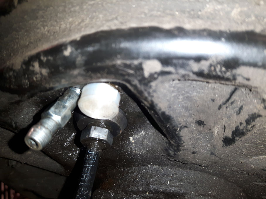

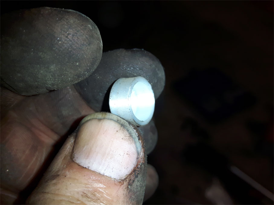

I did also print out a dust cap for the torx screw that holds the pistons in place. The printed material is flexible and fits tight to the head of that screw - just to prevent dirt stacking up in there till next repair. I had some hard time cleaning this before the torx key (30 size) fitted well. Don't need to do that next time.

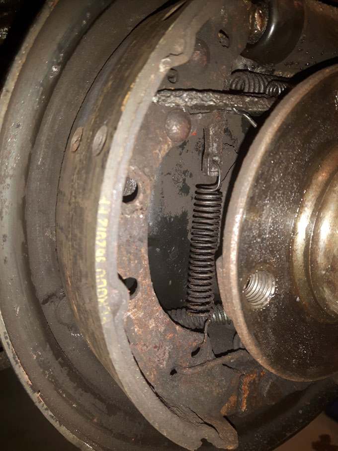

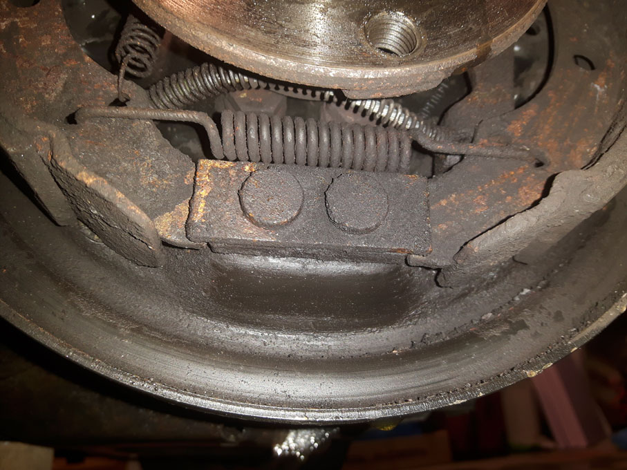

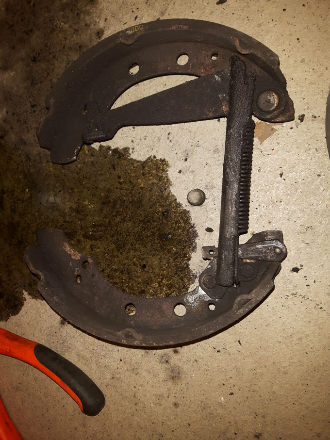

I did it easiest in this order:
1: Removed the piston by unscrew the torx and the braking tube.
2: Removed the two small nails that goes through the shoes, with those springs and caps.
3: Forced the lower part out before removing the bottom spring. Surprisingly easy with a little force.
4: Removed the upper small spring.
5: Pulled rest of the assambly easily out.
6: Unhook the hand brake wire.

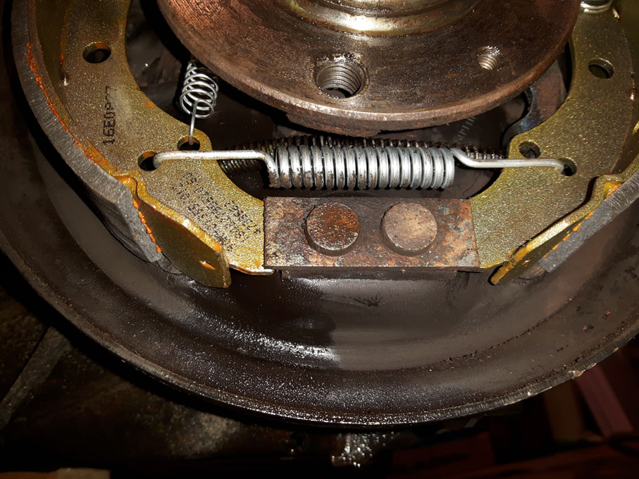

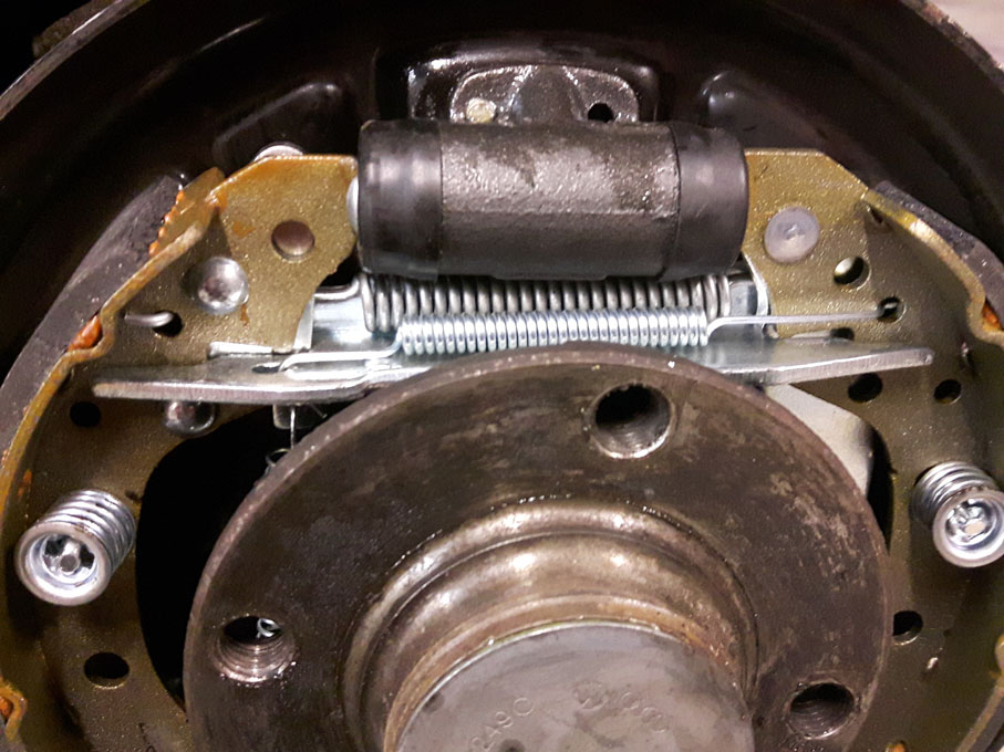

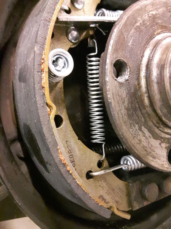

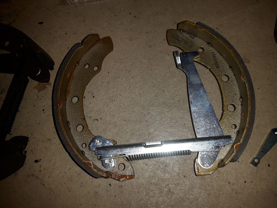

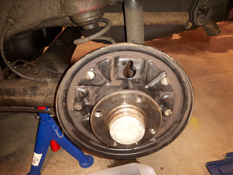

Fitting new parts in this order:
1: Fitted the upper horizontal bar with the large upper spring into one shoe first. I used a screw clamp to pull the shoe in right place.
2: Put the adjustment wedge in place. (You can do this later, but then you need to force the shoes apart to make enough space to put that part in place).
3: Fitted the next shoe into the other side of the bar. Take care of the hand brake lever, and how you fit this lever into the upper bar.
4: Fitted the small upper spring (in front), and the adjustment wedge spring.
5: Hook in the hand brake wire. Somewhat hard, but possible.
6: Put this assambly in place.
7: Hooked on the lower large spring.
8: Forced the shoes back in to place at the bottom.
9: Hook on the adjustment wedge spring into the shoe.
10: Fitted the nails, springs and caps.
11: Fitted the piston.
Before putting the drum back on, push up the adjustment wedge as far as possible to make enough space for the drum to fit easily. As soon as you push the braking pedal, the wedge refit itself into position.
Important!
Put back the drum BEFORE you do any attemt to remove air from the braking fluid. If not, the pistons will pop out while in great tension from the upper springs. Not good.
