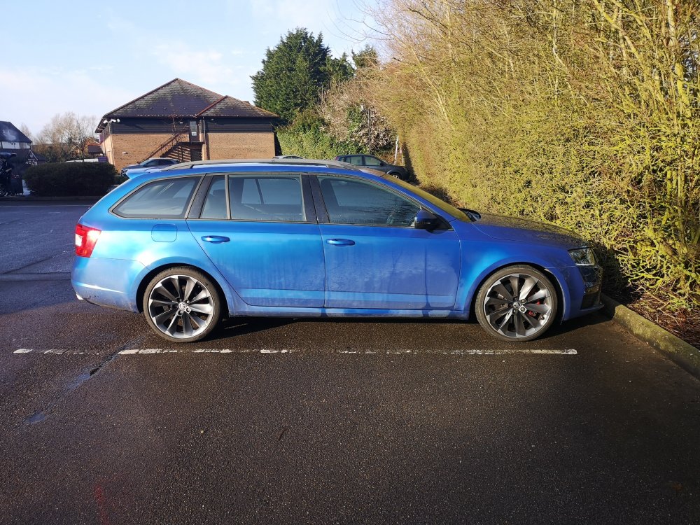

I went with the gun metal grey supernova's and lowered 20mm and 225/35 tyres. Look smart on the car and I've only recently started seeing these wheels on supurbs but not Octavias. Not the best picture but you get the idea. People always comment that they like the wheels. Im pretty sure you could lower 40mm with no issues but I don't know for definite.
Very neat 👍.
Good to see your cars as dirty as mine, wash one day, same again next. 🙄
This looks very nice. My octy is same color and as dirty as yours 😄 You have eibach pro kit springs? Any rubbing? you think there is still some room under wheel arches for 235 tyres? :)
Plenty of room still for wider tyres. The arches are nowhere near rubbing. I was refurbing my house the last couple of years so had loads of weight in the back getting materials and taking stuff to the tip and no issues even when fully loaded. It was the Eibach springs that drop 20 at the front and 10 at the back i believe. They're a good compromise between looks and functionality.
